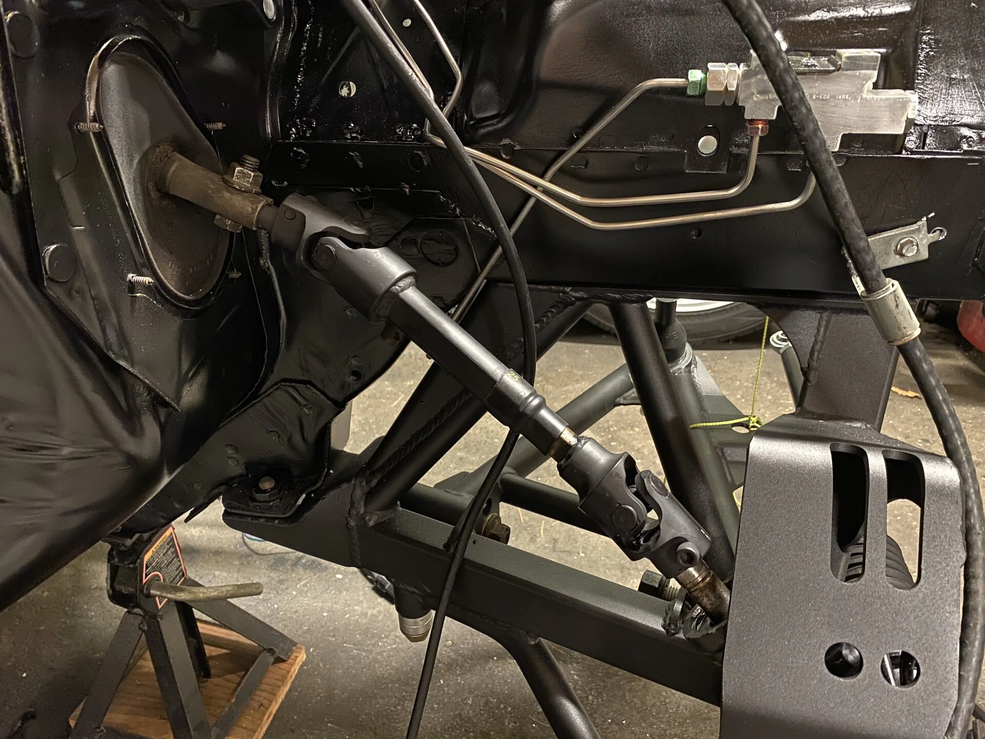

Rack bolts and prothane grease showed up. I was able to torque the A-arms in place, and install the steering rack. Done! That also allowed me to install the Max Motorsports hybrid steering shaft. MUCH easier to install this without an engine in place than it was the first time around.

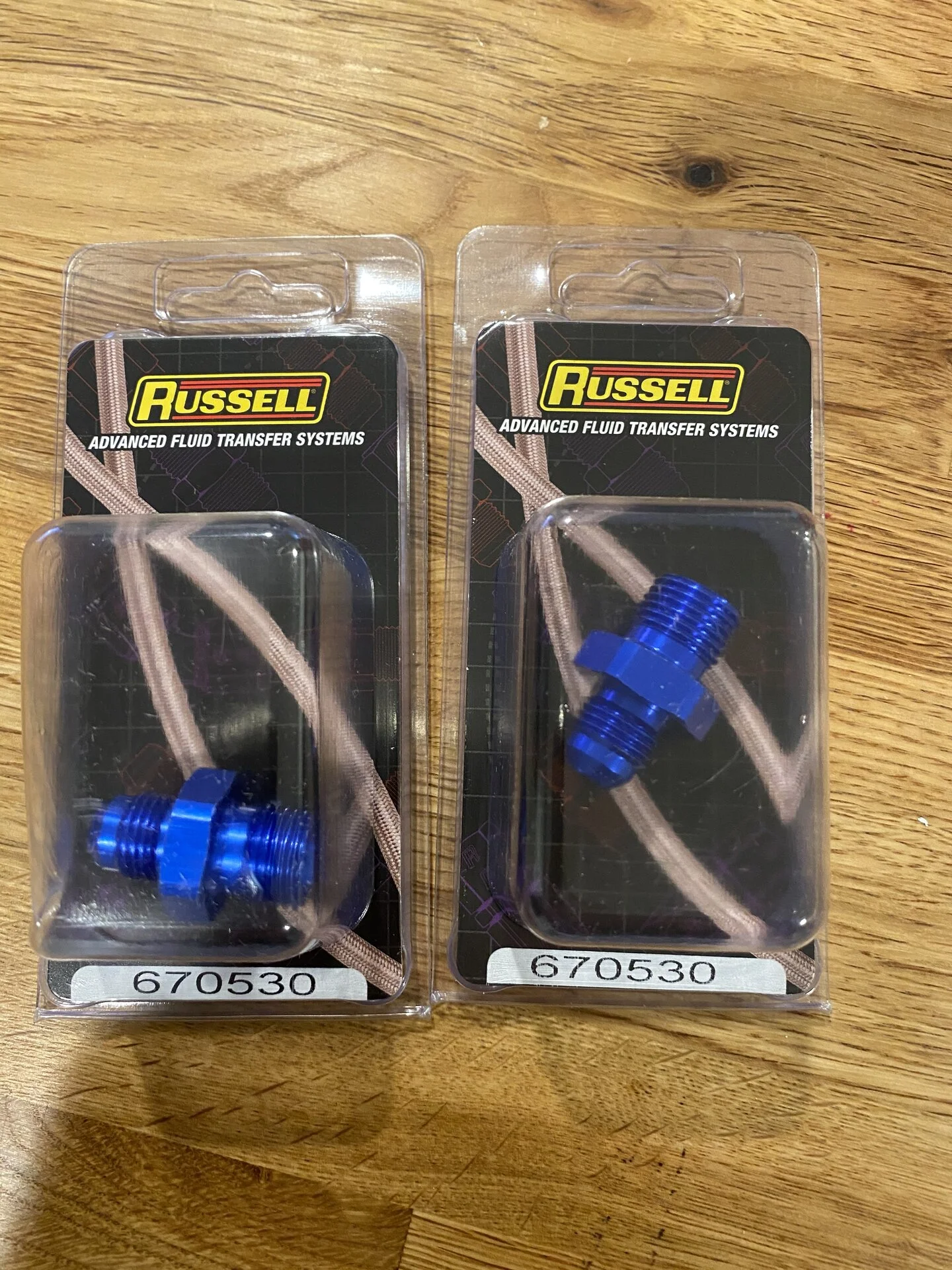

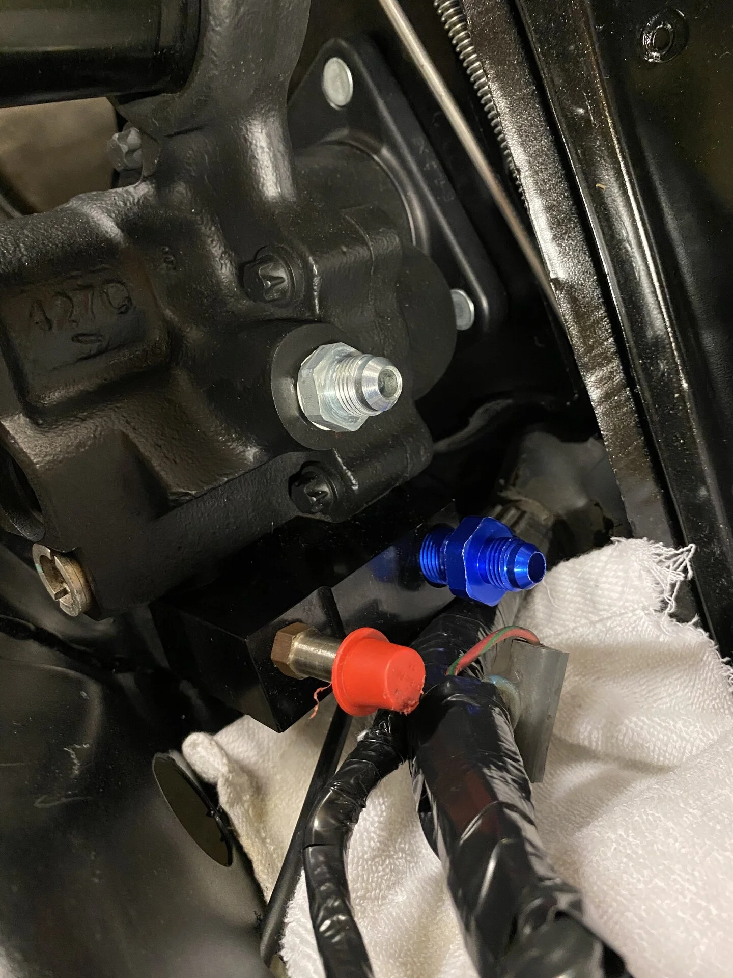

Moving on, some of my hydroboost fittings came in. These were listed on that famous hydroboost jog floating around. Russel 670530

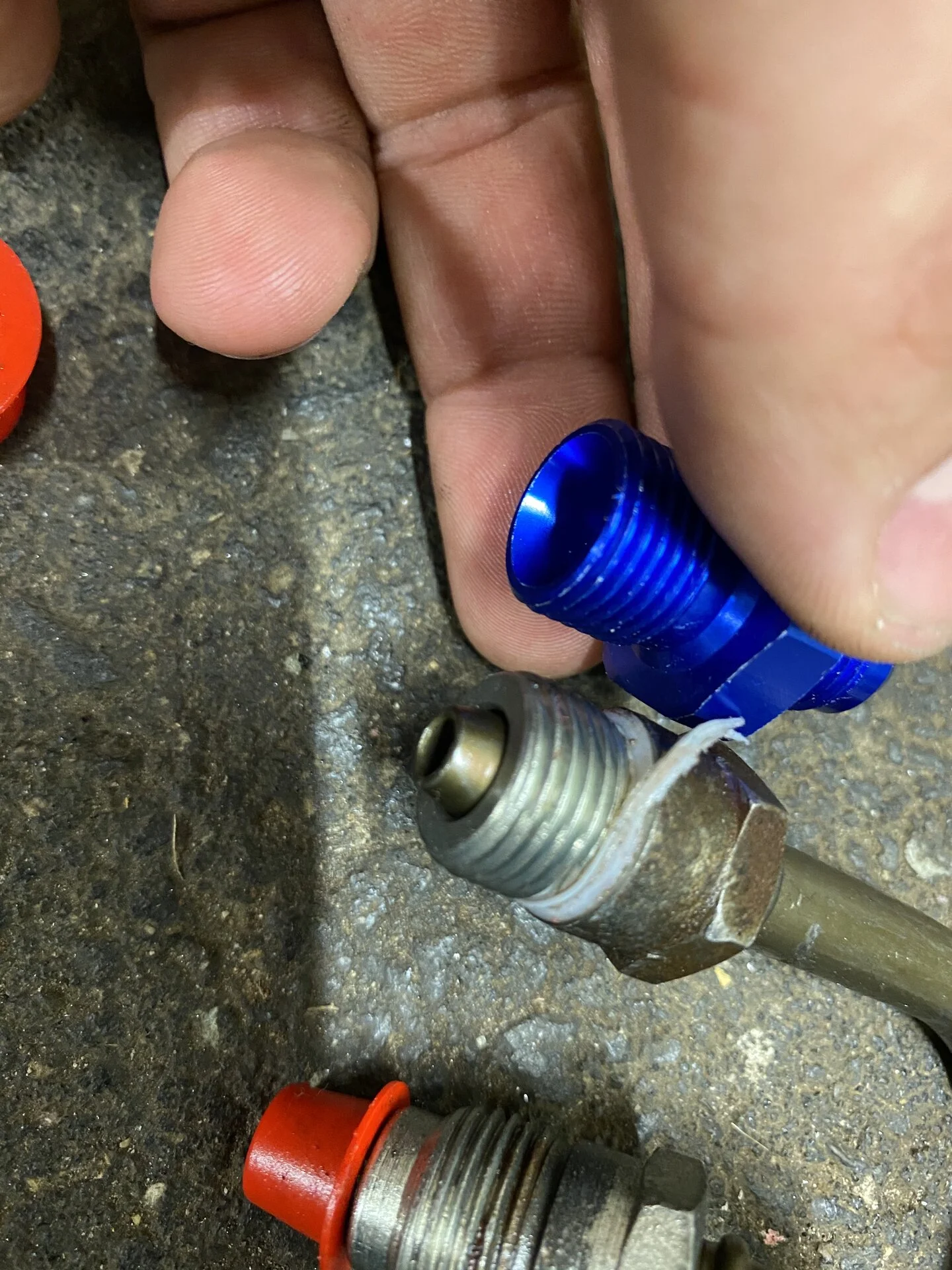

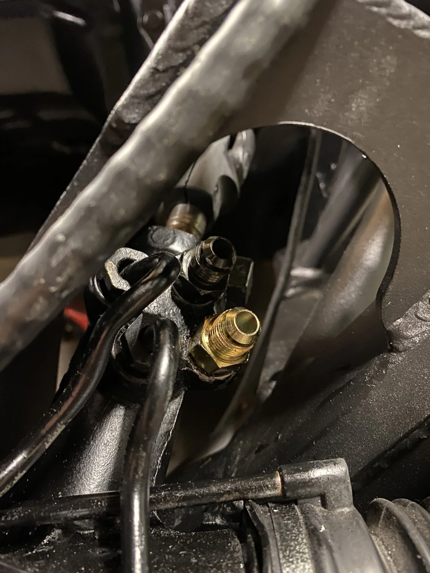

Hmm, right off the bat they are slightly different. These were listed as being compatible for the pump and the hydroboost, but there are differences. Here's the hydrobooster fitting

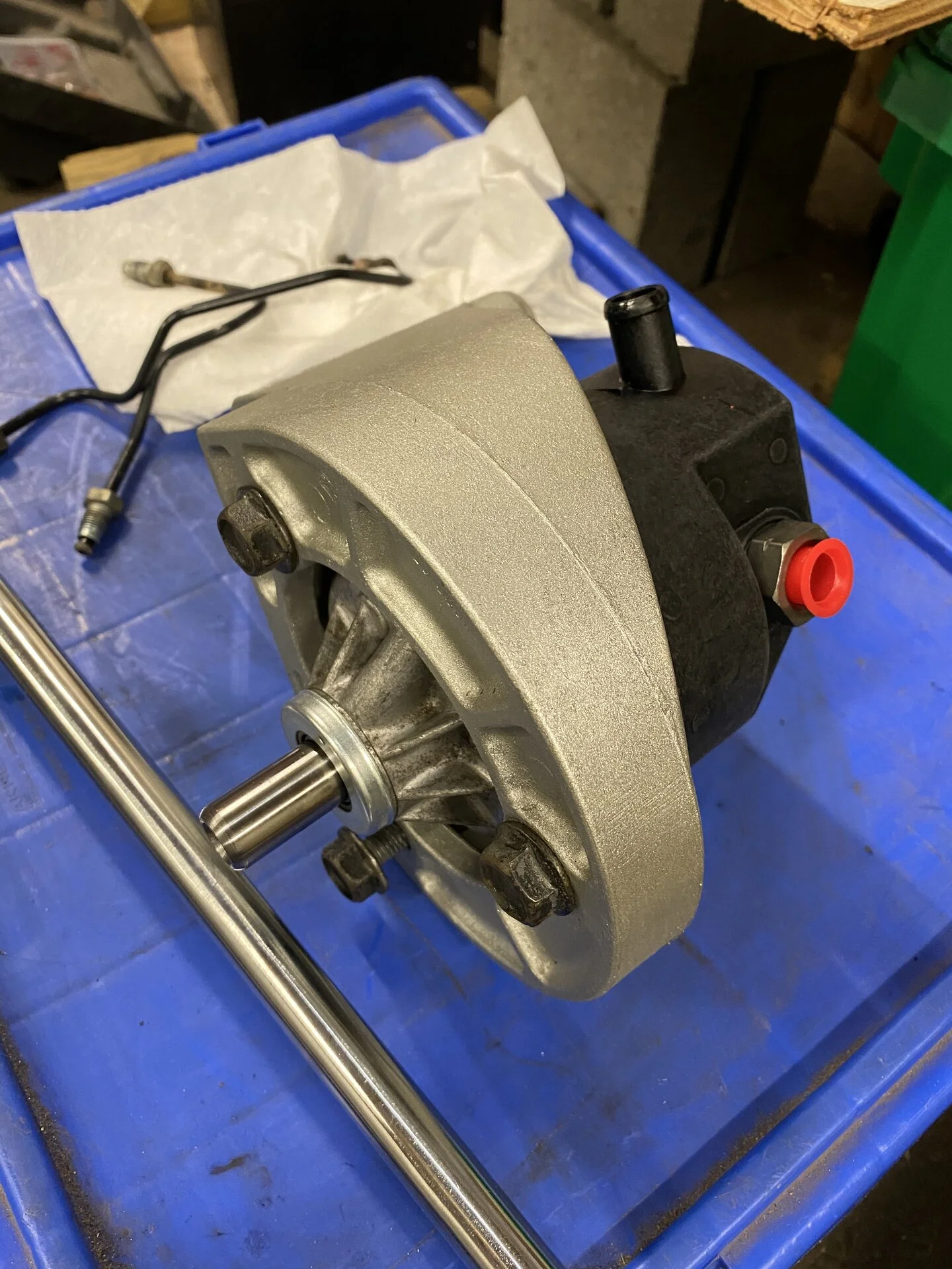

And heres the PS pump
This is where it would install. The other Russel fitting i got (silver one) seems to work out fine and be correct. This one doesn't seem to seal properly and relys on the threads. Or perhaps I could install a teflon O-ring?

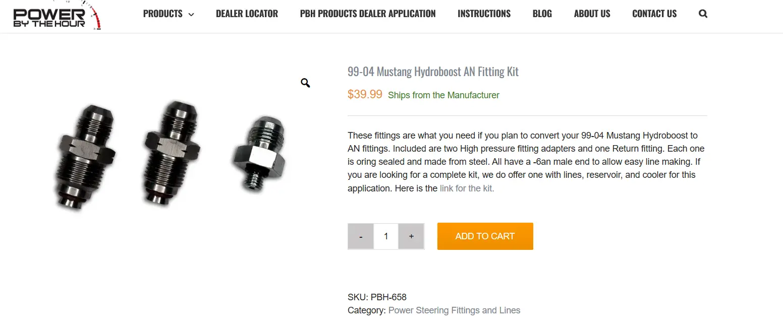

I hop on teh googal, and see Power by the Hour has the right fittings. I guess i could just return all these fittings to Amazon (was almost $30 in fittings anyway) and get the right stuff.
Those fittings look to be high quality anyway. Problem is, I need one more of that middle fitting. I don't want to buy another kit for it, so the search continues....

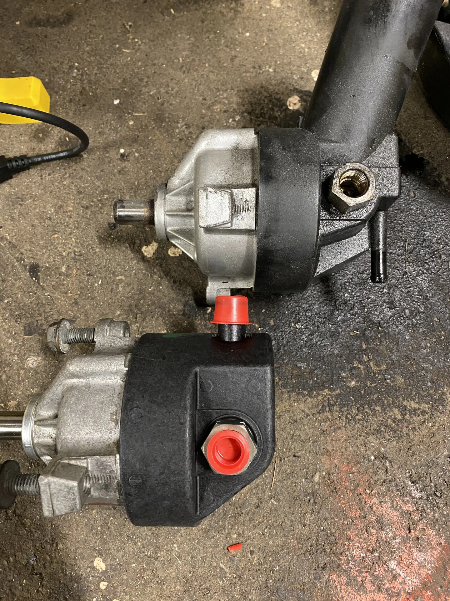

Decided to investigate the 1990 escort PS pump.
apparently the main difference is the low pressure return line is on top and slightly bigger in OD. Other than that, same pump without the reservior.
i plan on mounting the hydroboost reservior....somewhere
Yes, I will clean up those bolts prior to final assembly.
I'm following this one too. That escort PS pump is the same one a bunch of folks use in autocross. It's a good option to remember. Its a shame stuff doesn't swap around within the Ford brand like it used to. I really enjoy finding stuff to modify with thats Ford specific from another vehicle. Seems to always be cheaper that way.

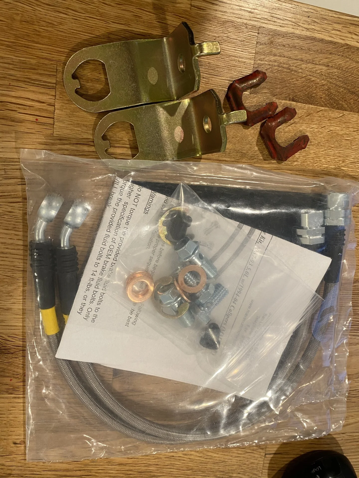

Some new parts today.

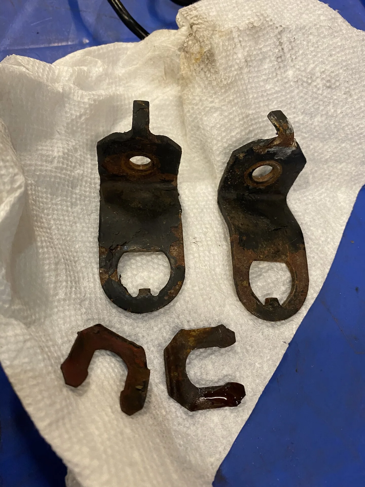

I was going to try to refurb these, but they were pretty nasty. I also trashed my SS hoses. Some questionable bends in them so I decided to buy new stuff. Brake stuff...I prefer to be safe
new hose mounts and MM front lines

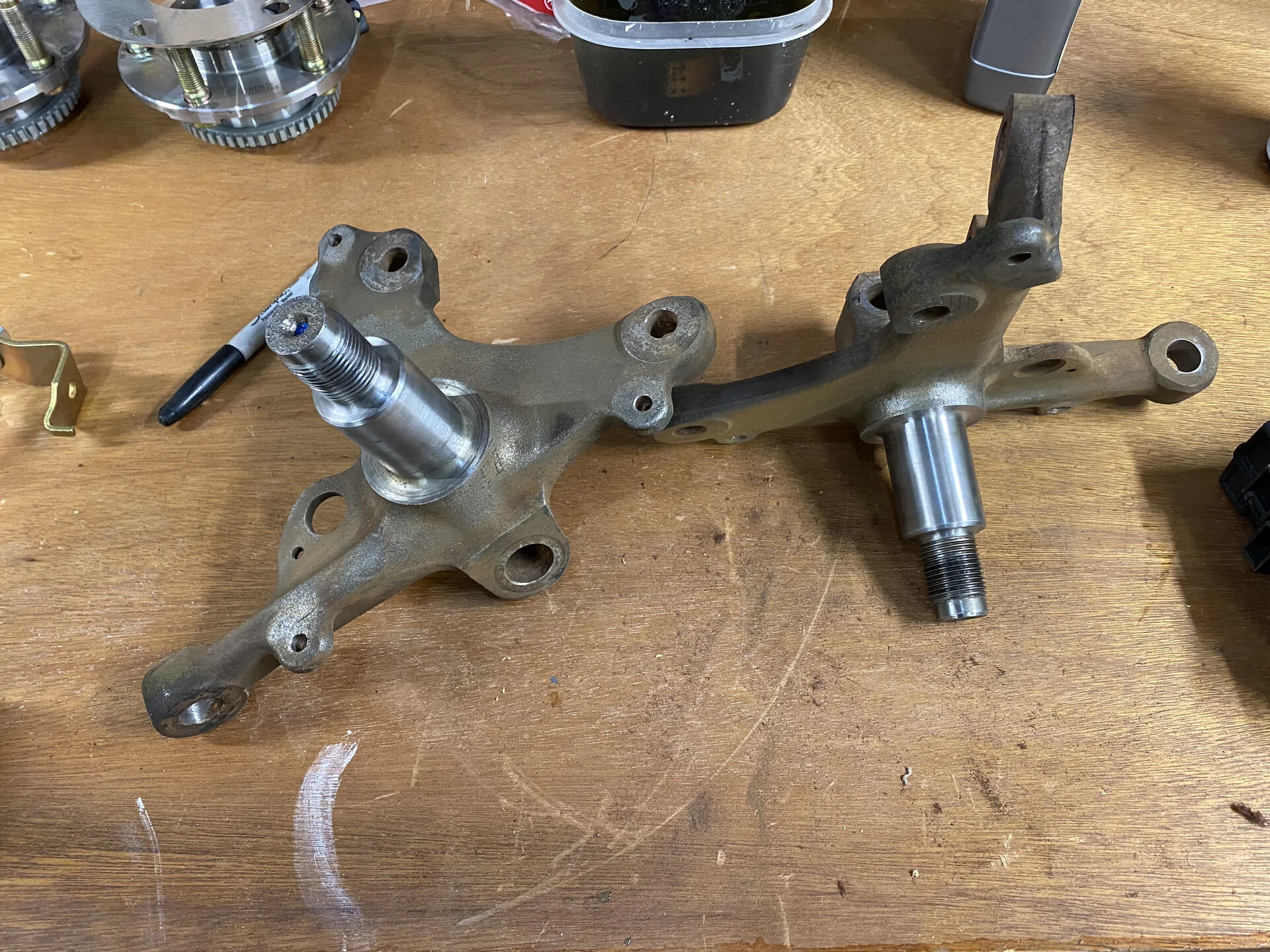

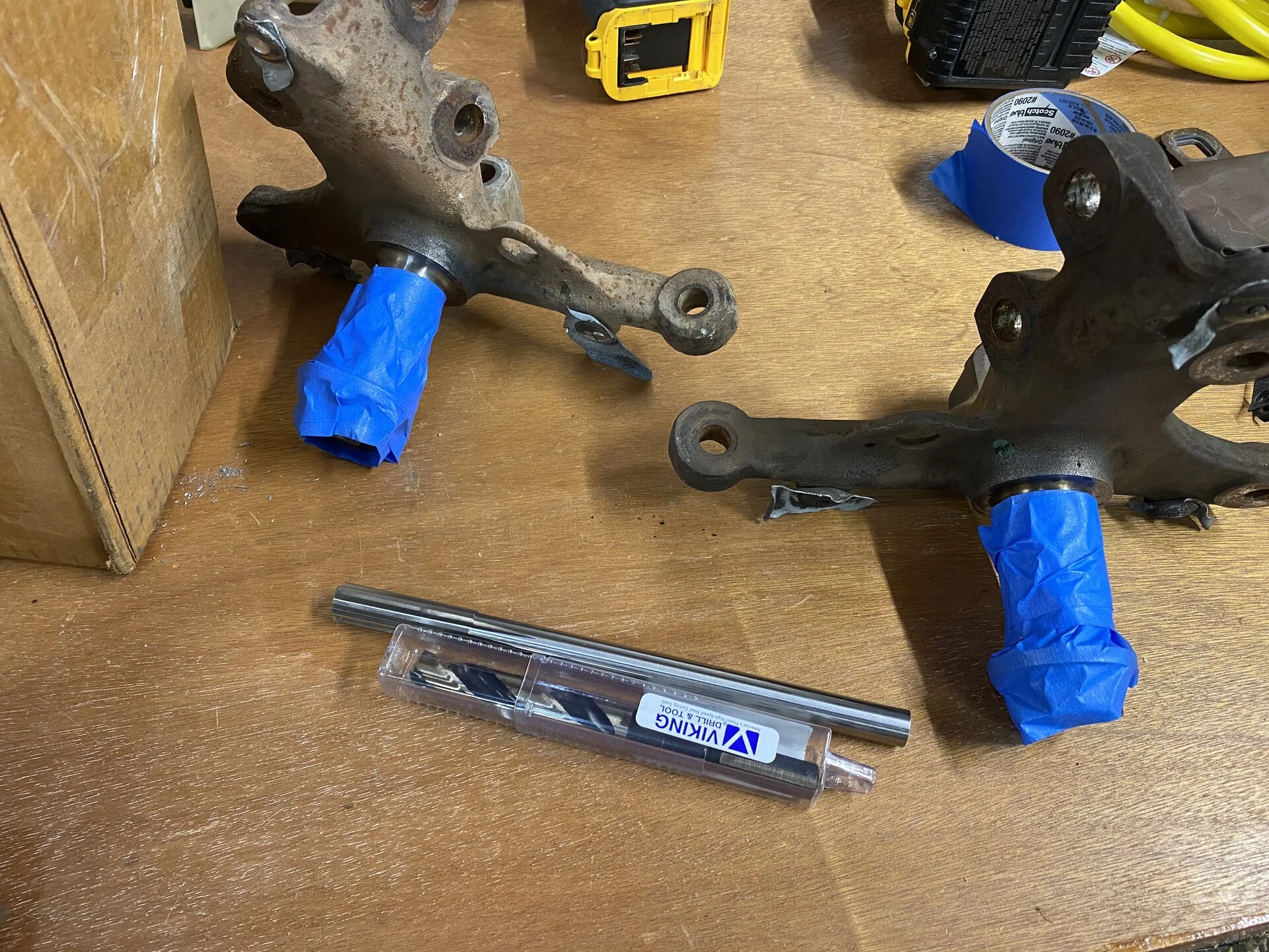

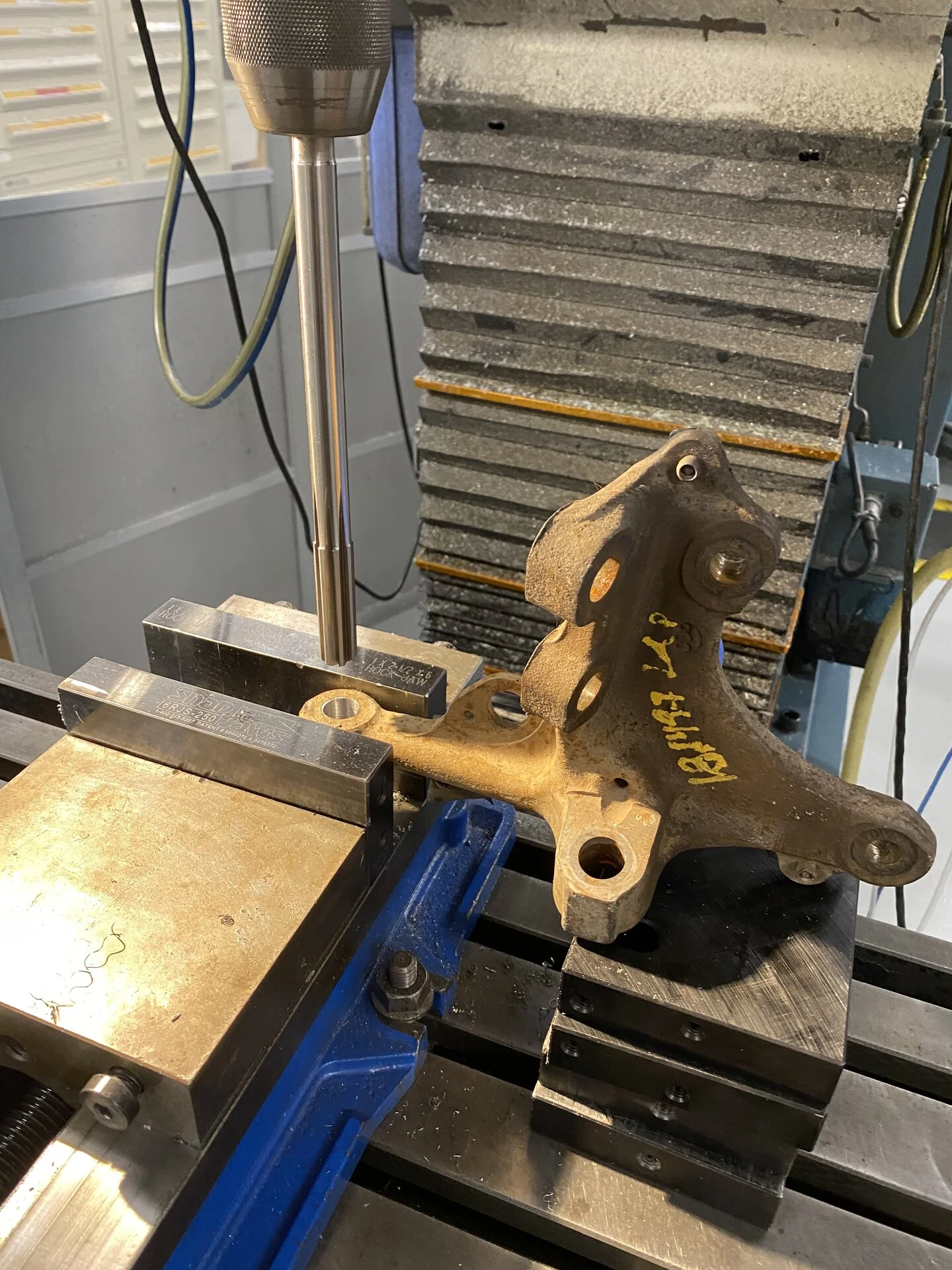

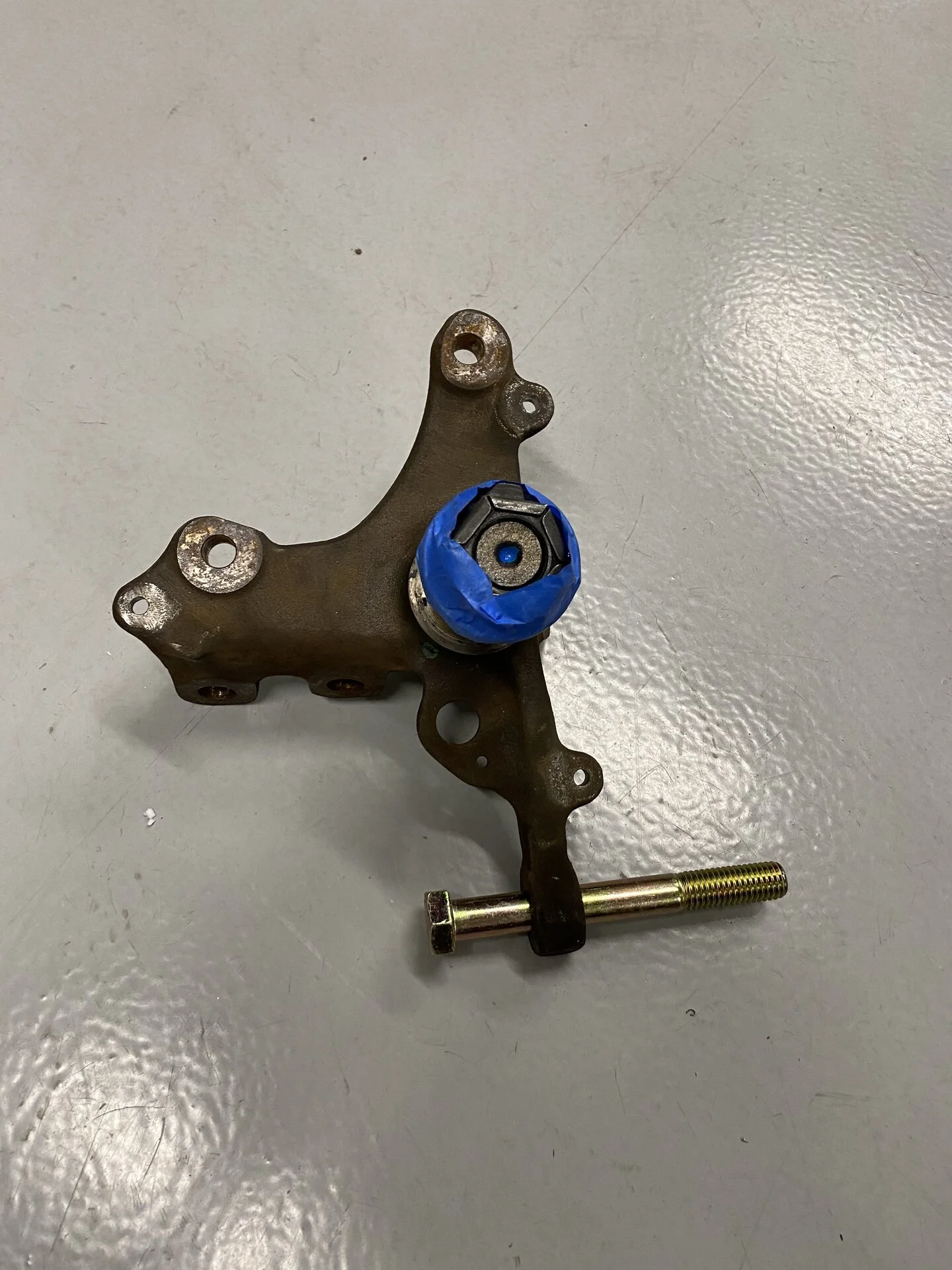

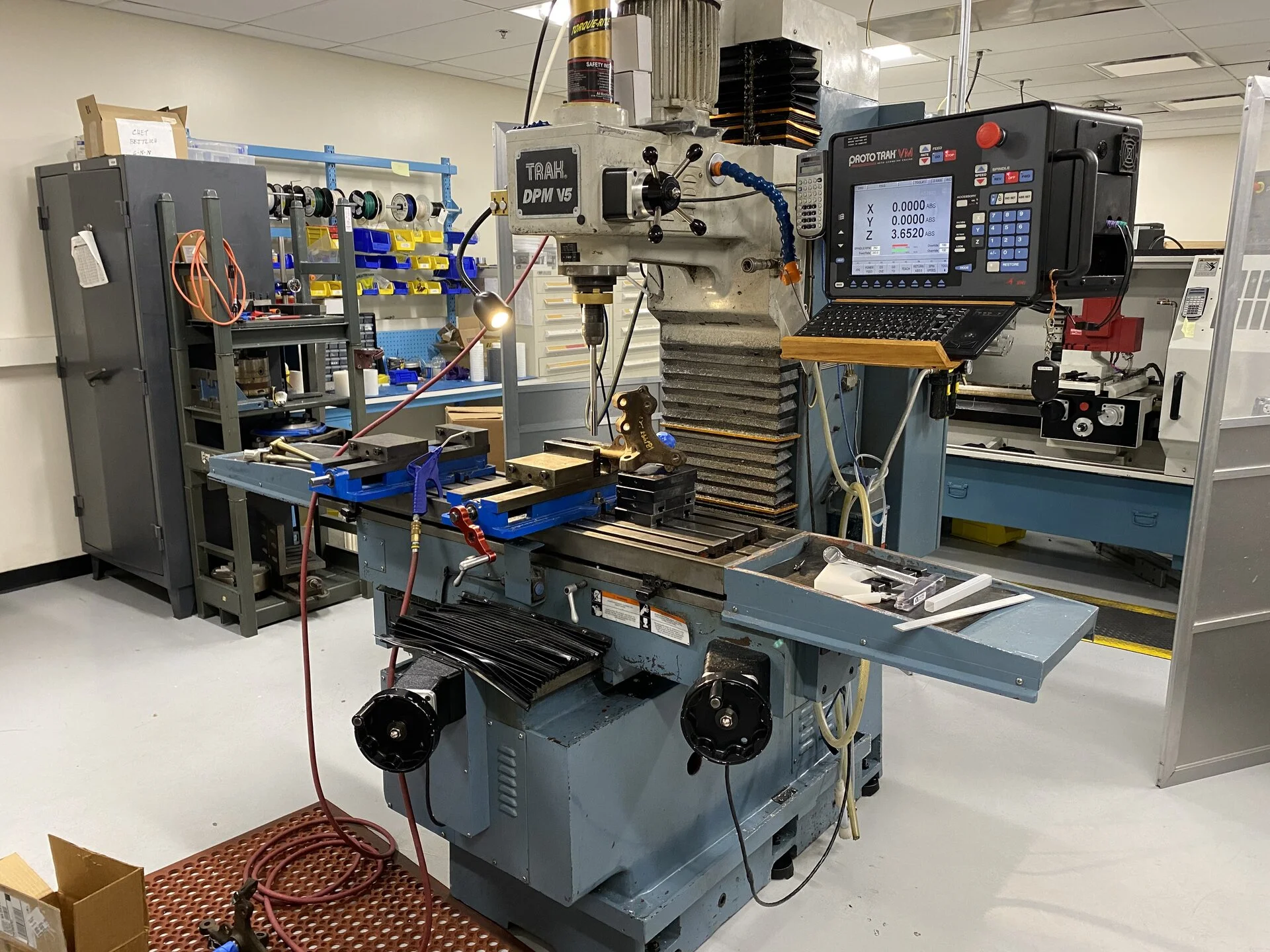

This weekends goal. I can’t make major progress until I do this.
wity the MM k member, it’s highly recommended to run 96+ spindles and a bolt through bumpsteer kit. So, I need to machine the spindles. I need to see if I can get shop access this weekend to get it done. Got my drill bit and ream ready

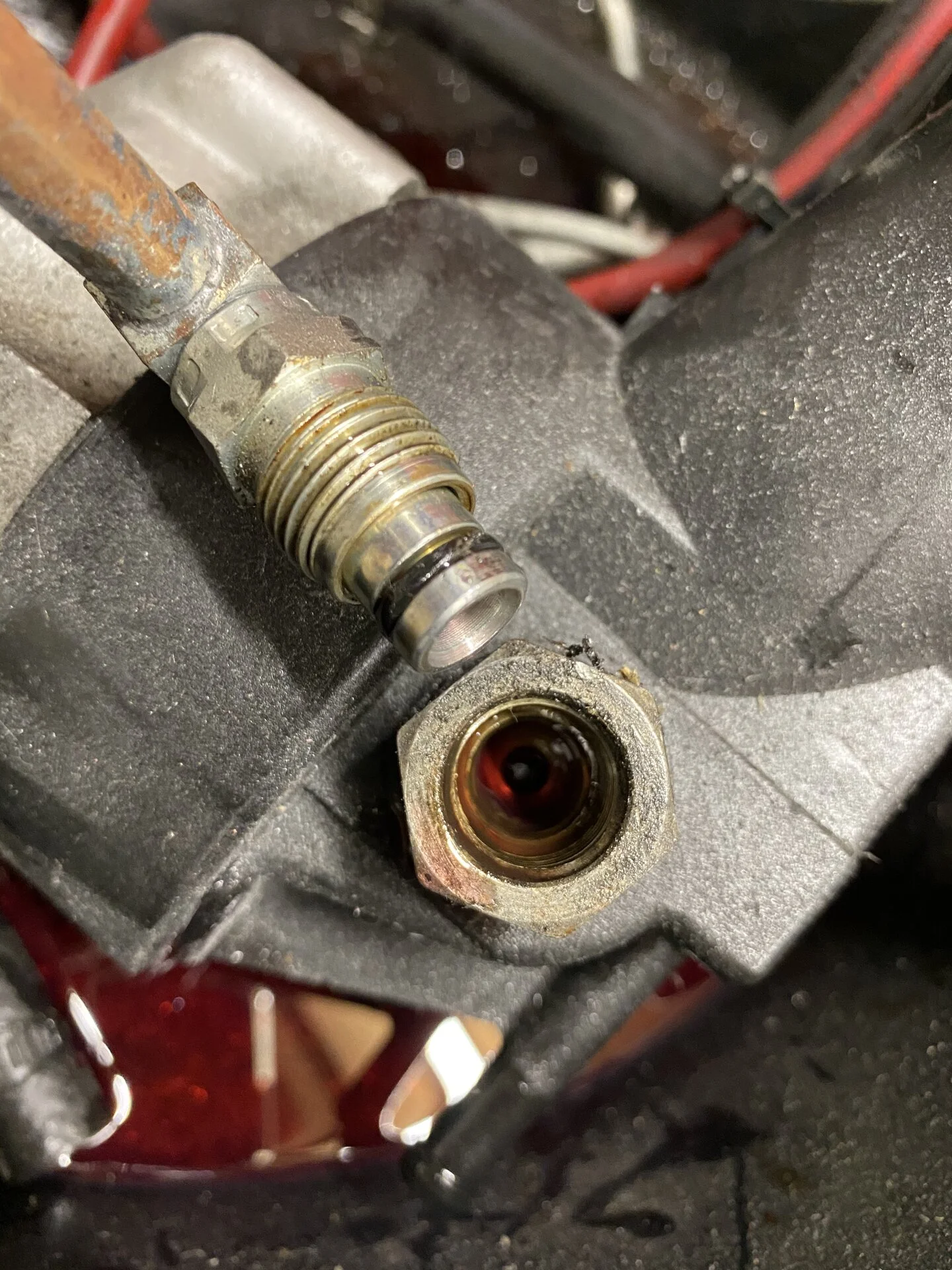

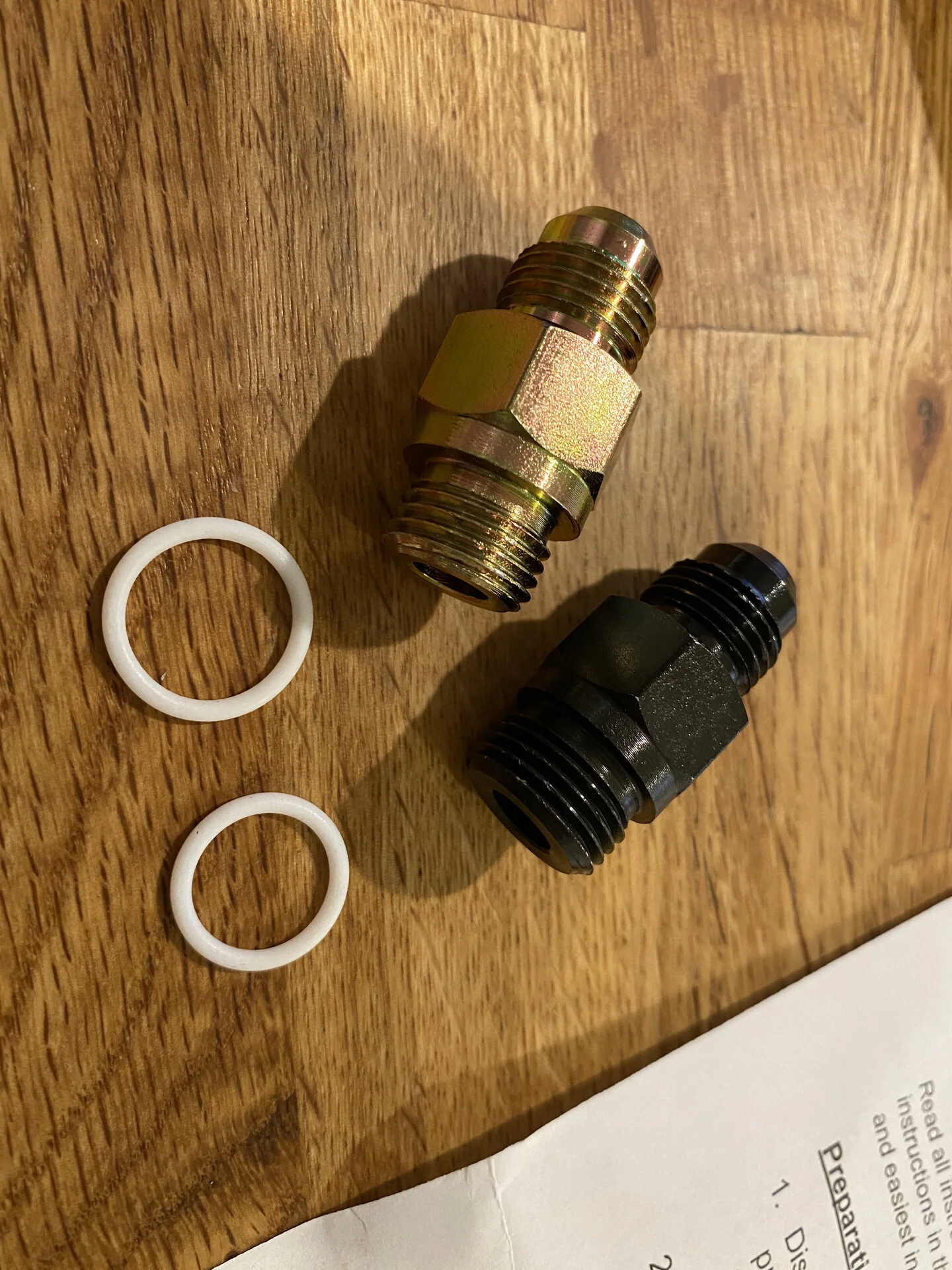

Installed the MM fittings, then realized I forgot the hydraulic sealant so out they came again. Removing them buggered up the Teflon o ring, so I need to get new ones. I was not amused.
I’ll likely have to pull the rack off because proper torque is critical. Any more and it ruins the o ring. Prob is I can’t torque it like this. Rack needs to come off. Fortunately at this stage, that’s easy
Decided to do something easy so I worked on cleaning up the spindles. Got them to this point abs decided an evaporust dip might be worthwhile.
I should powdercoat these, but I feel like it’s a lot of time abs effort for something I’ll never see. I painted my 94-95 spindkes and it held up well.

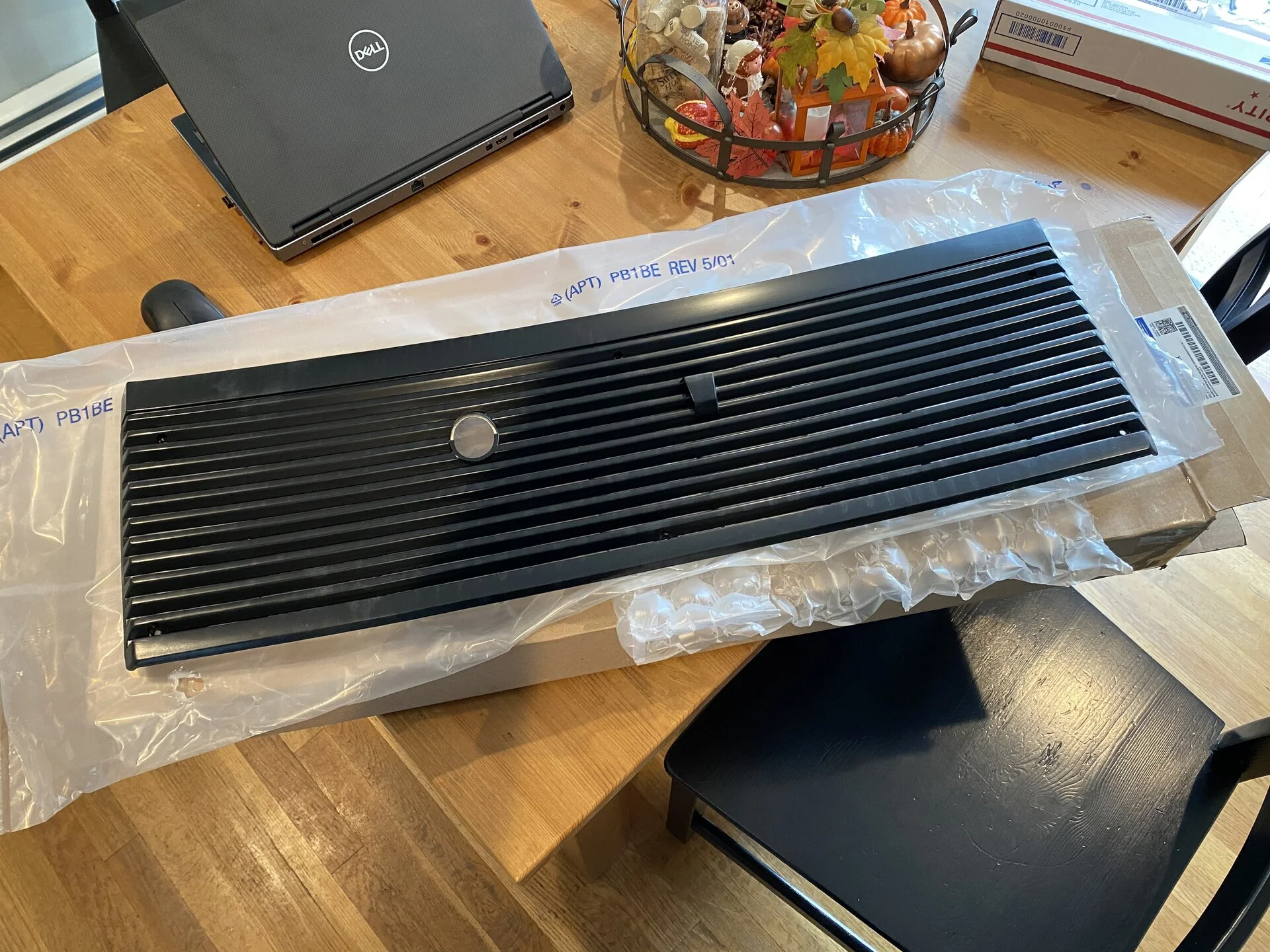

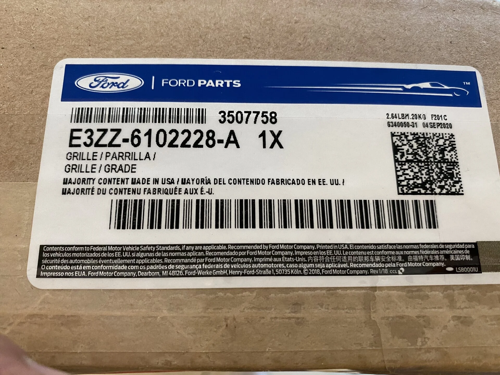

I mounted a fuel pressure guage in my cowl a long time ago. I removed it. SInce I had a hole in the grill, I needed a new one. I hopped on Tasca Ford Parts and it's amazing how much cheaper these are there vs anywhere else. LMR wanted $100ish for the OEM ford grill. I think i got it from Tasca for $70 shipped. Still in production as far as i can tell. Label is 2018 dated.
E3ZZ-6102228-a

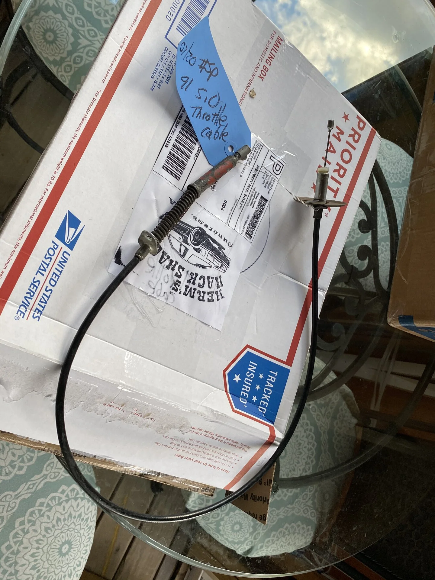

Also, new throttle cable showed up. Much better shape than mine and should clean up nicely. I don't know who Herm is, but i've bought a lot of parts from his shack.
