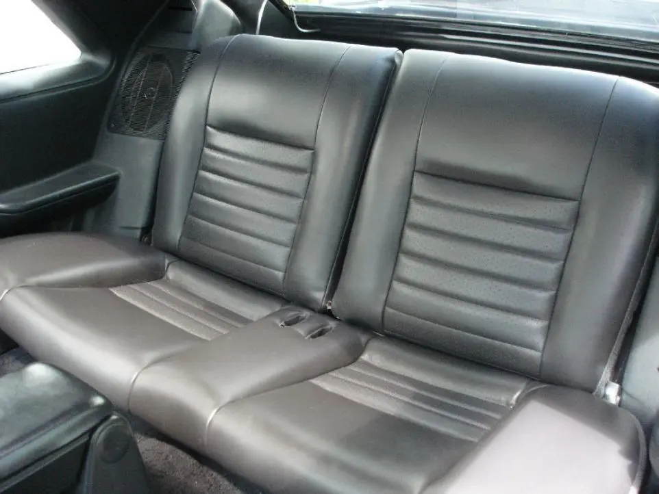

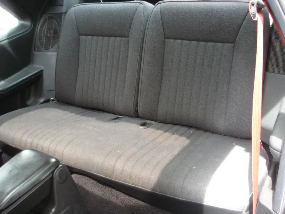

BTW, i was there today to take out my black back seat and begin installing my '04 GT leather seat. I sold my black seats to my friend for $50 and his old blue seats (cuz i needed the frames)
Out with the old seat and in with the new seat...almost. Still need to finish the seatbacks

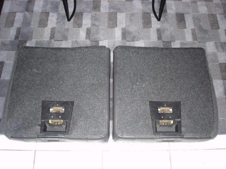

I'm getting the seatbacks from my buddy today, so during the week i'll snap some pics of me modifying the SN95 seats to fix.
I sold my OEM black rear seat for $50 and the two seatbacks. I know i could have gotten way more, but this was a good friend.
I paid $100 for the '04 GT rear seat...so this is really a $50 mod for me :)

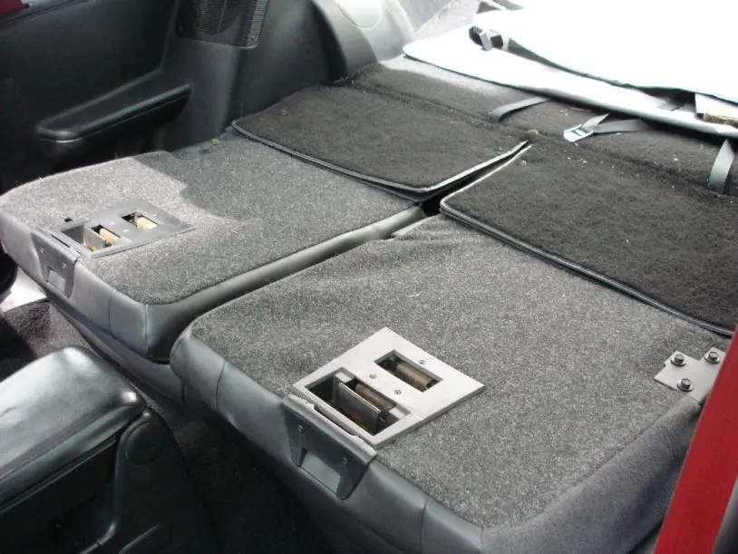

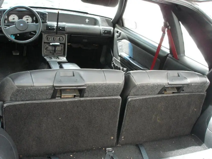

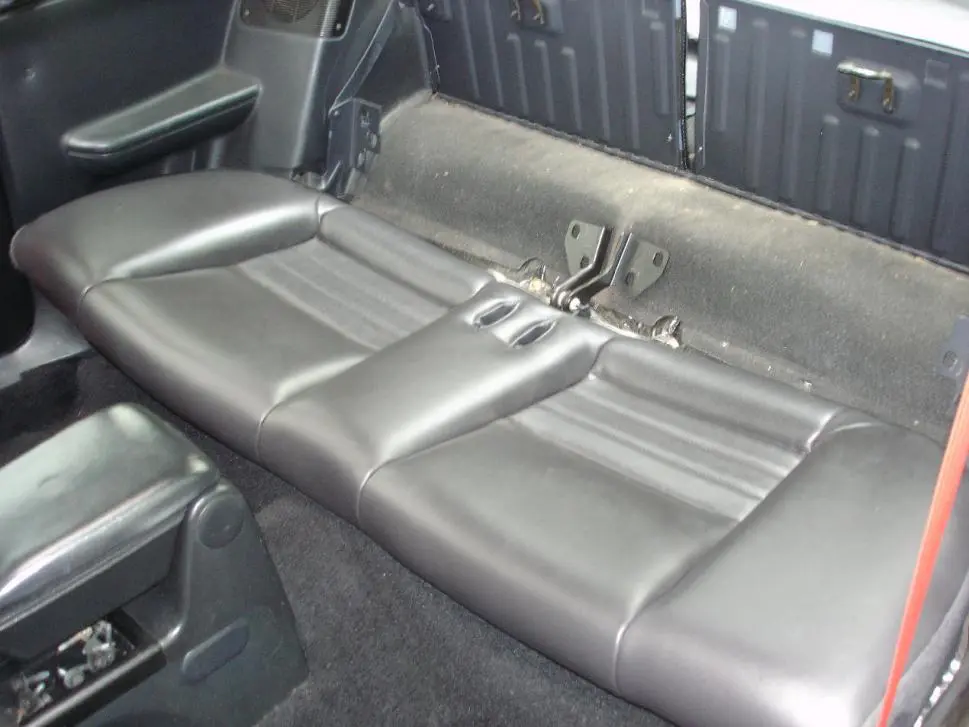

Looks good Mike! Did you leave the inner pivot points bolted on the plastic back, inside the covering, and cut new holes? I did mine that way and you don't see it at all. I wish I could cover the outer brackets, I have them bolted on the outside. I might use the black carpet from my original black LX seats like Iwashmycar did to cover them up.
I was planning on bolting them inside, but i left the pivots in the car. I forgot i would need them. When i go bolt the seats in, i'll install them behind the carpet and cut ne holes.
I'm not worried about the outer brackets being seen as i never fold my seats down anyway. Nobody will ever sit in the back seat either....but i just want it to look nice :)
I like the idea of installing the carpet on the rear, but i had no black carpet to use. I sold my OEM black seats to my friend and gutted his stock blue seats. I could buy material, but i want to see what the final product looks like first.
I also want to install the front small Sn95 headrests in the rear seats when i put my halos in the fronts...but how did you secure the rests? Did you just slip them in and that's it?

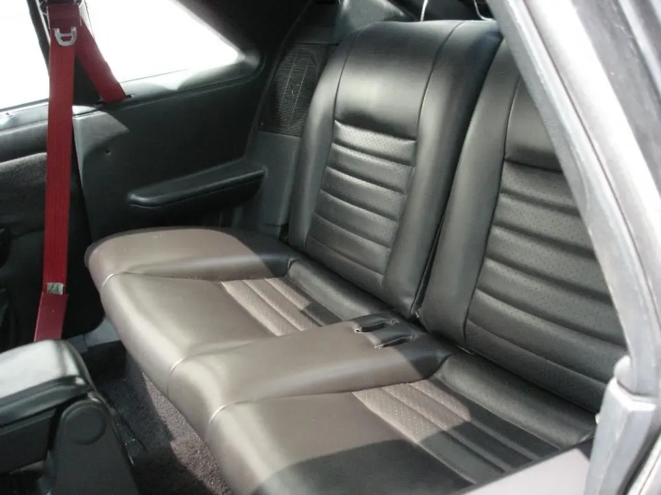

They retain full functionality just like Fox seats AND fold down like stock. Ignore the dirtyness...i'm still working on the interior as you can see :)
Color match is not that bad. I don't mind it.
The front headrests will slip right inside the slit on the plastic piece on the seats. I was able to insert it in between the plastic backing panel and the seat foam part. I thought about using some kind of bracket to make them "functional" but haven't done anything on it.

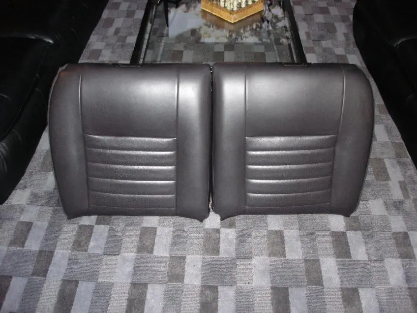

I had just wiped them down with this stuff i use on my GT's seats. It does an awesome job of getting wrinkles out and keeping the seats soft so i wanted to use it on these seats. I started working on the white spots. I got some off and then i stopped because i had to go finish changing the Water Pump on my GT before it started raining. I just finished up that job just now, so i'll work on the spots some more tonight while TS Hanna rages on outside
BTW...do you remember what year car they came out of?
Meguiars GOld Class Rich Leather conditioner/cleaner.
I'll prob put the seats int he car next weekend.

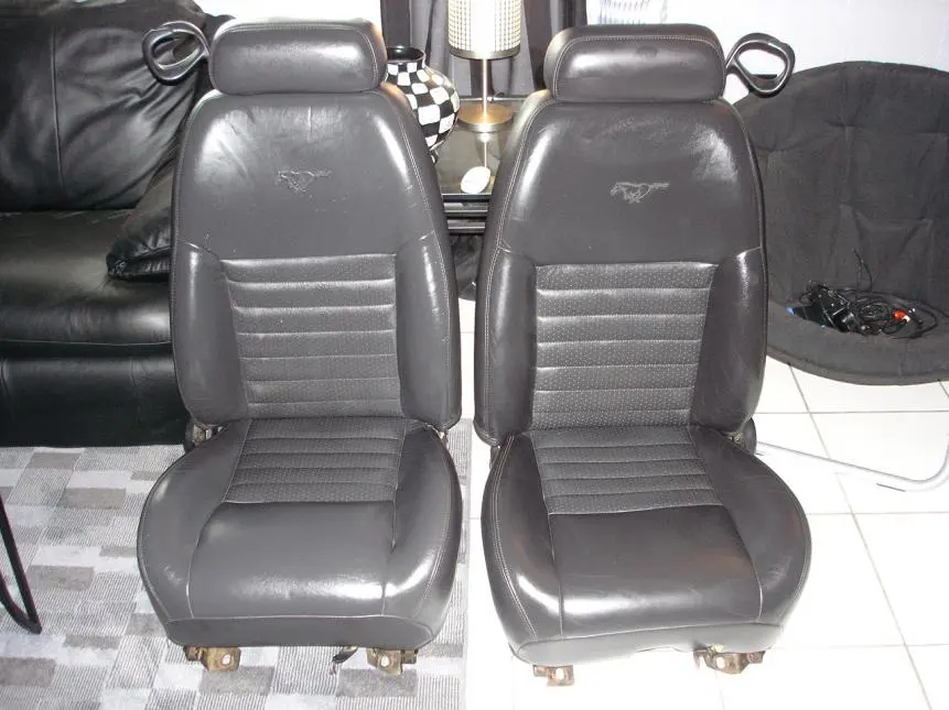

I have a set of halo headrests I want to put on these. I tried to see about getting them recovered in dark charcoal leather but it's way too expensive. I think for the meantime i'll pick up some DC dye and dye them
They look great Mike! I've used that same leather cleaner/conditioner on mine and they've held up well, but now I'll have to get mine worked on eventually. The perforated leather on my seat back split along the stitching, third row from the top! @#$% ! I just noticed it a couple of weeks ago. My windows are tinted, I use my sunshade and I keep the seats conditioned. I must have gotten a bad piece of leather on mine or something.
I need to hit my halos with another coat of dye. I've found it lasts a couple of years and then starts to crack a bit.
Those seats will look awsome Mike :nice:, we sure did get a ton of rain but not as much wind though. I was hanging out in the garage and cleaning some stuff on the stang and the water was flowing down my driveway like a river :D.
Sounds good Mike, I hope you do get all those white spots out... they bothered me, but I was worried about ruining the seats trying to get them off. I assume they are just some kind of paint... just not sure what.
The seats actually never made it in a car. They were from saleen back in 2001. Saleen used their own seats, takes out the stockers and sells them. I got mine from them, brand new, only sat on from people at Ford or Saleen. I have had them since 2000 or 2001, and did my best to avoid cracks and wrinkles. Tough when you have a car that needs clutch cables done, brake light switches, etc... They should look real good in your car though.
