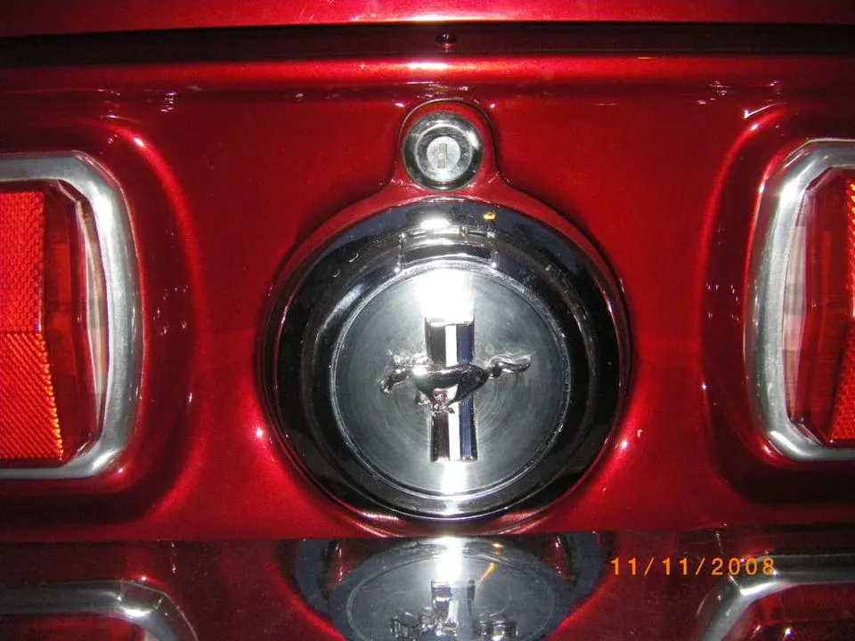

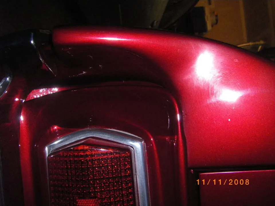

I have done the conversion on my car. The panel does stick out past the original panel so you do not have to hack up your car. The area where the old lights used to be I bent some sheet aluminum to the contour of the tail panel and then used sealer so there is not a worry about leaking. I filled the area around the gas cap by using a flip up gas cap. It fills the area nicely and if the tail light panel is painted the same color as the fiberglass panel you really have to look to see if it is one piece or not. I would do it again without hesitation. If you need a close up around the gas cap or any other part let me know and I will post some pics. One last thing, I am using a fiberglass panel from Mustang Unlimited and not Mustang Project.

Any close up pics of the gas cap area and the corners of the panel would be appreciated.

I used the Mustang Project Lights and their panel. You can see the most recent pics of my car at my cardomain site. I hope they are close enough for you to see the difference.
I made a stainless steel panel to cover up the original light holes so water would not get in. I also used the flip open gas cap and just installed the key switch. Everything to me looks like it did from the factory. Even the fit of the original style trunk lid was not very good (as expected).

On the rest of the pages, you 'might' find a close up picture in the areas you want or I can look tonight for some, but taking new ones will take me a bit of time as the car is 'backed' into the garage, and I an almost done with the passenger side... then I will turn it around.
Let me know if you have any other questions as well, but I would recommend highly their products and they look nice.
