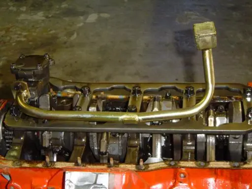

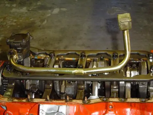

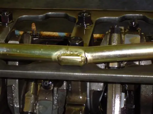

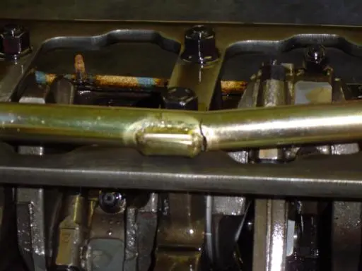

Well pulled the motor out today and got most of it disassembled. My no oil pressure was due to a broken oil pickup. Cracked in half right at the bracket that was welded on about half way down the pickup tube. The bracket holds the pickup down to the girddle via a nut. So far I have pulled the main caps and the bearings look good (just normal wear) as do the crank journals. I will be pulling the rod caps tommorrow. If all looks good I will get the crank polished, new bearings, new pickup and reassemble. I think I dodged a big one here!!! :rolleyes:

BTW, You don't see this parts failure too often and I hope I never see it again!
