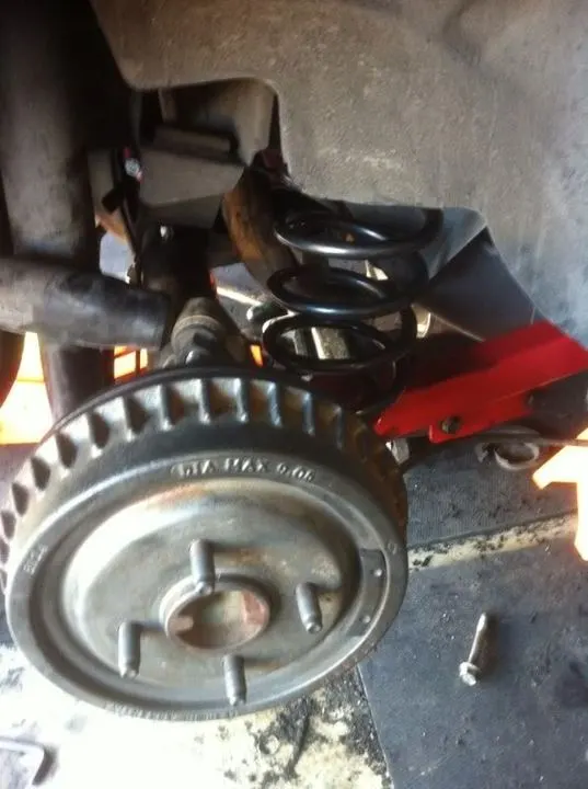

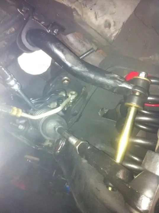

Well, started on my suspension today and I'm beat. Here are some pics. The rack & pinion is the biggest ############ pain in the ass to deal with. I couldn't screw in the pressure hose, so I am running to the parts store to return my old r&p core and order a new pressure hose. Looked like the threads were a little screwed up on the pressure hose:( The rack was $60 bucks with an $85 core, go figure. Everything else came off easy. Got the rack in, hose is holding me up. Once I get the hose in, I can assemble everything on the driver side, then start on the passenger.
Once I get the new rack in, I will install the new endlinks and bushings, eibach sportline springs, a=-arms with new ball joints and urethane control arm bushings. Also installed urethane rack bushings. All the old rubbers were trashed on this car. Looked all original.
Well, made some more progress tonight. Finished up the rack and installed a new return line as well as a pressure line. Finished up the driver side suspension. New a-arm with bushings, ball joint, tie rod end, eibach sportline spring, cc plate. Waiting on my tie rod endlinks and sway bar bushings from CJ Pony.
More progress........Installed the brakes and tightened up cotrol arms, spindle and tie rod end. Just waiting for my sway bar bushings and endlinks to come in. Then this side will be done. I also decided to just run the upper spring iso in front. I'll see how the car sits once I'm done with everything.
One thing I was curious about was, how should I adjust the cc plates until I take the car to the alignment shop?? I haven't tightened up yet because i wanted to see if the wheels were going to camber in or out. I was thinking since the cc plates will be loose the wheels would camber towards the engine. Also, do these get adjusted with the full weight of the car on the ground?

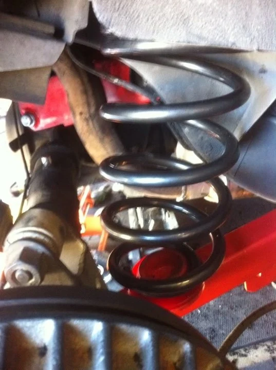

Well, way more progress today.
Front is all done.
Here is the rear.
All done.
The end result:)
One thing I did was, I only installed the upper isolators on the front springs. Just wanted to see how it would look. I really like it alot. Problem is, tires rub like crazy when I try to make a tight turn. The alignment is off like hell, so I'm thinking that might have something to do with it. I adjusted the cc plates all the way outward toward the outside of the fenders and the center part where the struts bolt to, all the way towards the front of the car. What do you guys think?
