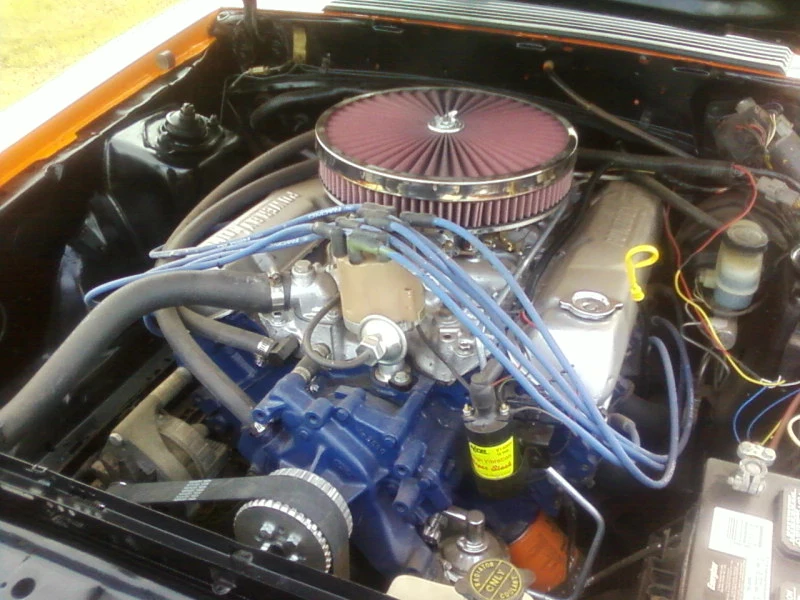

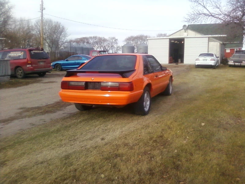

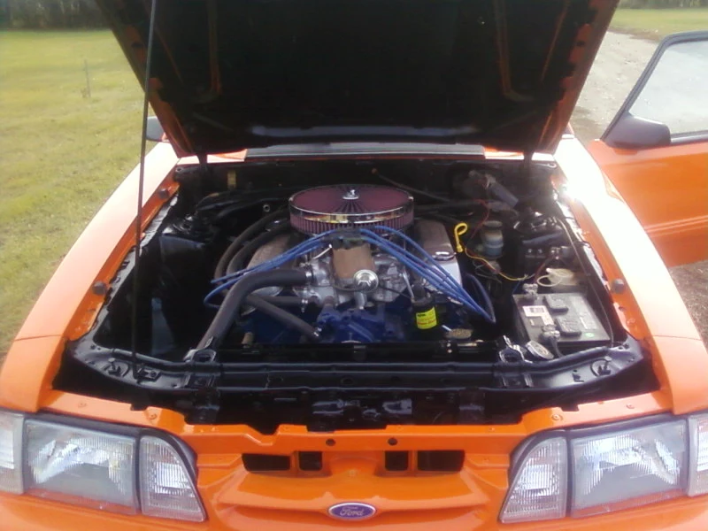

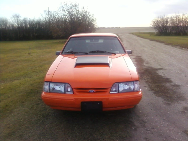

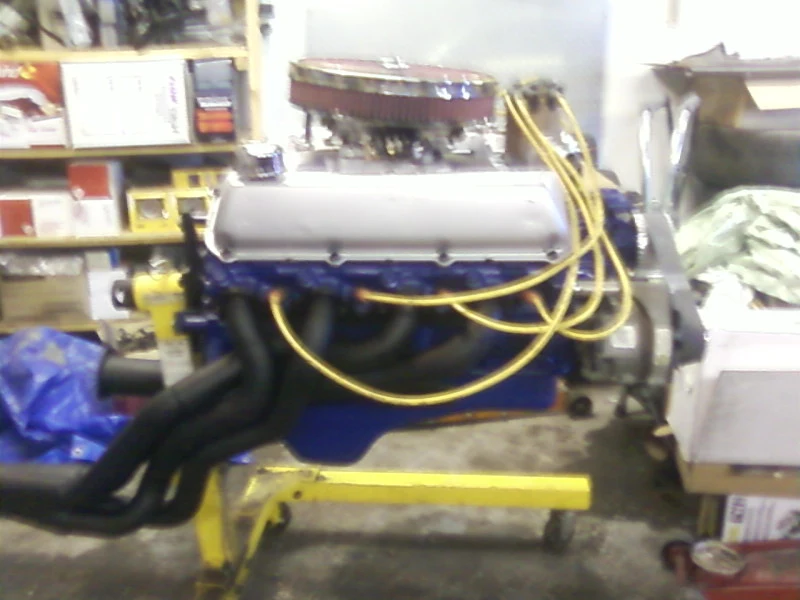

These are the pictures from my finished big block swap. The Motor is a 1970 429 thunderjet. The car has a very mild build.
Last Photo
The car was a 1989 mustang lx, with a 5.0 5 speed. It is now a 429 thunderjet, with a c6 mild converter, 3.27 rear gears. The motor is a stock rebuild with the following upgrades: 750 holley,accel ready to run ignition,electric fan,manual rack and pinion,drive belt pulleys, Hooker swap longtube headers, custom x pipe, flowmaster 2 chamber mufflers. The car is very fun.

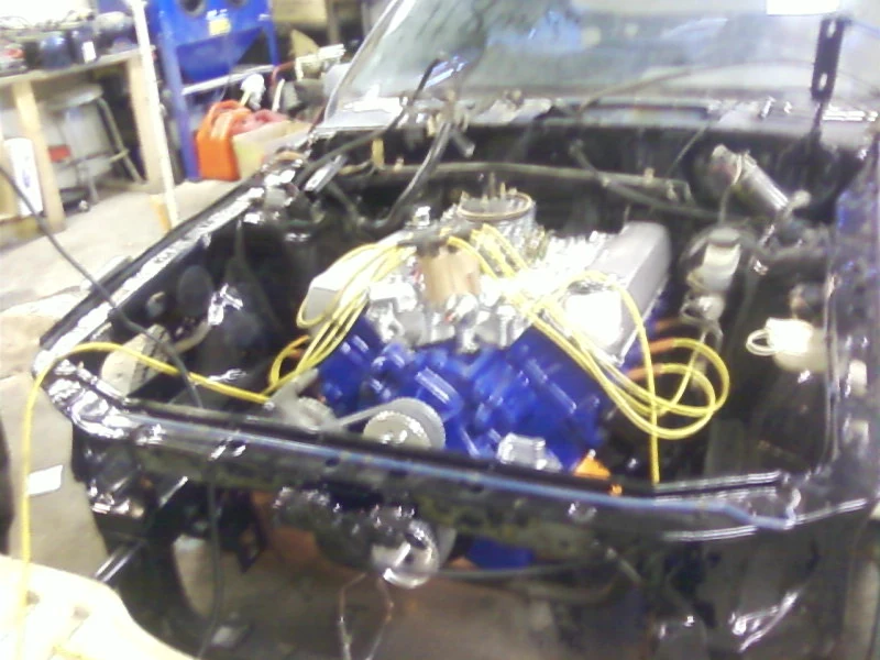

These were some of the mistakes problems I came across with this build.

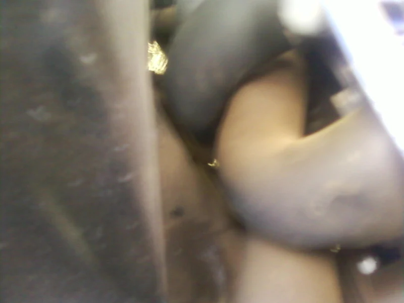

The Hooker swap headers were a poor choice. They took about 5 1/2 hrs per side to put in and required further fabrication. I would go with the CPR headers instead. These headers block access to the starter as well as the factory kmember, making a starter change a weekend project. I would deffinately use a tubular kmember and the cpr shorty headers to make a starter change easy.
Also if you get the "swap kit" Like I did from Ford remember the following things

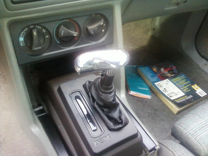

Lokar Throttle Cable and Return Spring and the Lokar Automatic Kickdown linkage. This in combination with an aftermarket shifter will save a lot of fuss.
For the fuel System I would recommend getting the stainless braided fuel pump to carb kit. I have a custom built line with a holley fuel rail and it leaked same with a mr gasket fuel rail, now Im using some custom built setup.

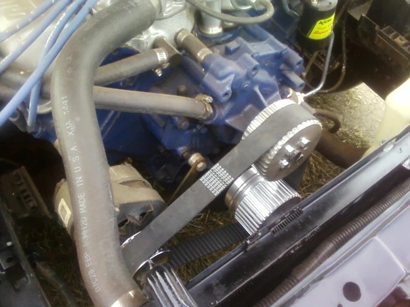

The drivebelt system and the electric fan were good choices as well as the manual steering added room. The X pipe and mufflers sound nice.

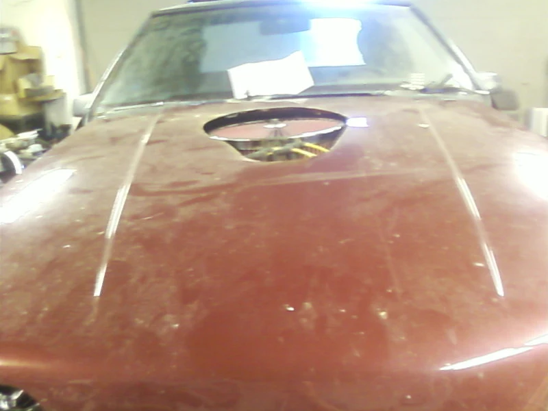

I have no Idea why people have 6 inch cowls on bigblocks im using the ford mounts and the factory intake manifold with a Kn drop base air cleaner and I still have an inch of room between the 82 GT scoop and the top of the air filter.
About the air filter/scoop. I often get the question does it have ram air ?, and my answer is maybe. I suppose the proper term should be it has a fresh air intake.
