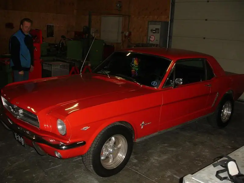

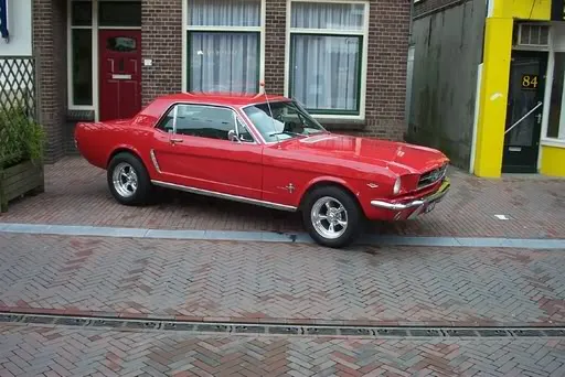

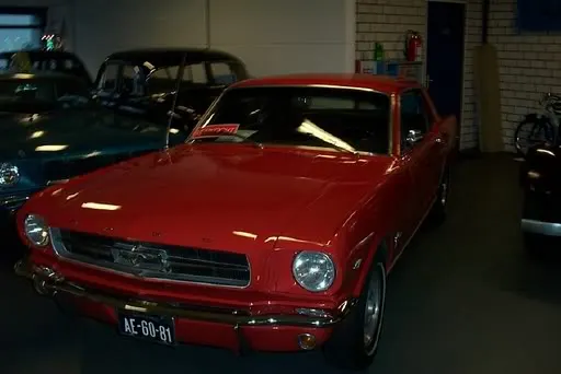

When i bought it, it was a 65 Mustang Coupe V8 (orginal V8 car) popy red with a C4 automatic Standard interior and hacked up dash for a stereo :notnice:
It was import from CA in 1999 and was a black plates car
In the years to come i fitted a Discbrake swap, some new wheels and a stainless dual exhaust. Also cleaned up the engine bay and fitted a couple chrome valve covers and aircleaner.

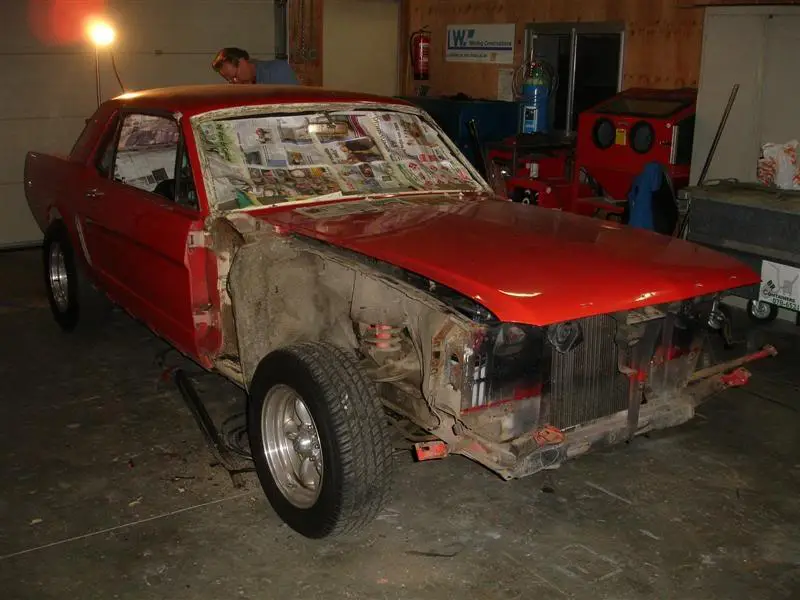

I was verry happy with the car, but the paint wasnt that great... it was sprayed over all the doorseals etc... so decided to strip the car.
Did the whole project with my dad who made countless of stainless steel brackets and other custom things :nice:

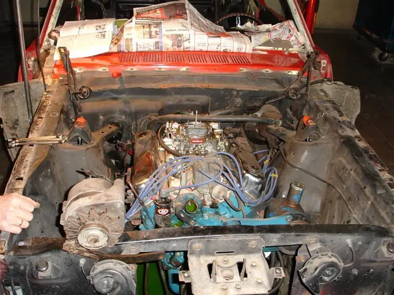

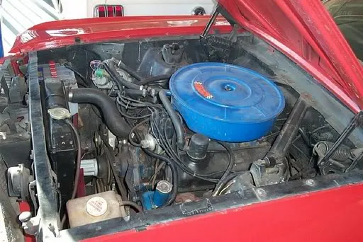

The engine bay had seen beter days ;)

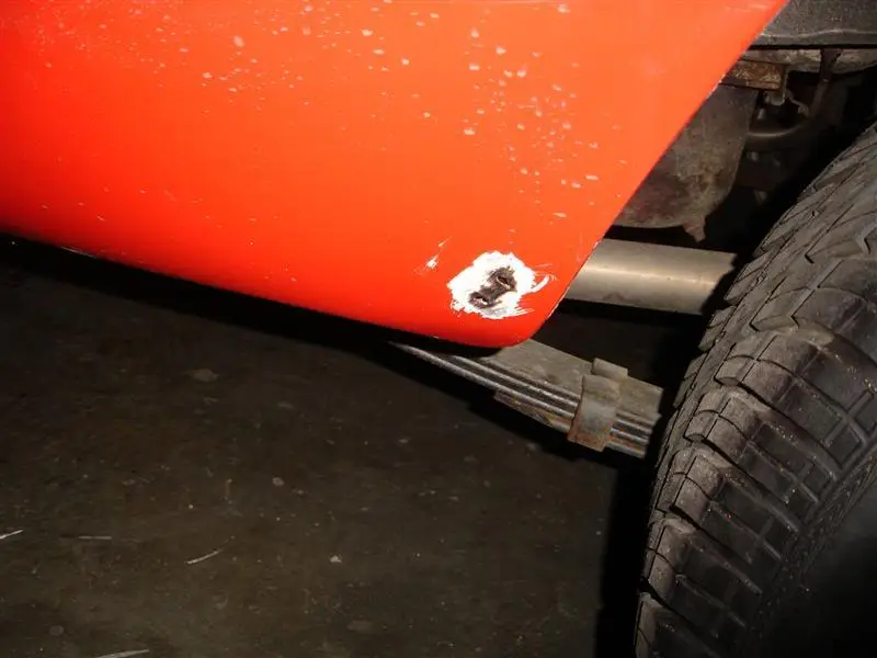

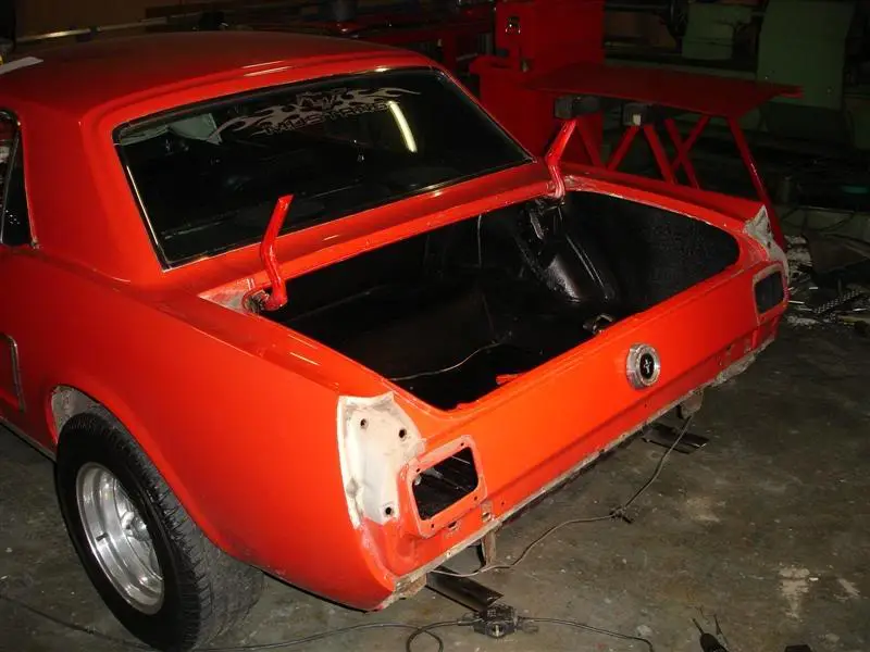

This was the only rust we could find on the whole car

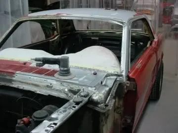

To be sure we sanded the car to the bare metal
Underneath the battery tray was some mild corrosion, to be sure we replaced it
Than it was time for primer and anti rust coatings.

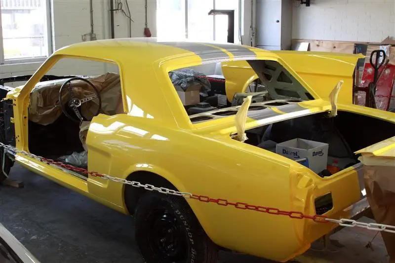

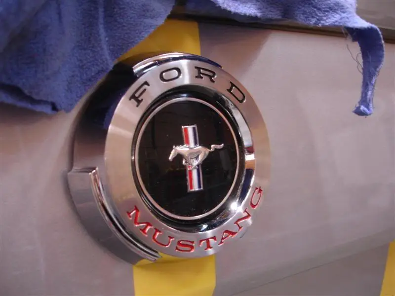

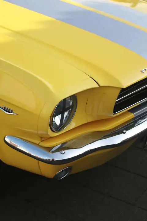

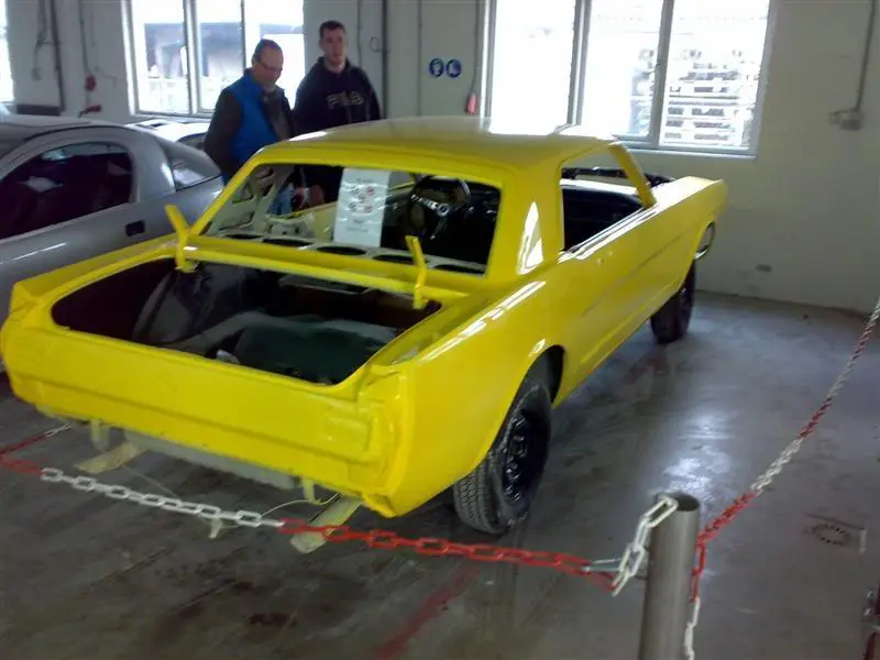

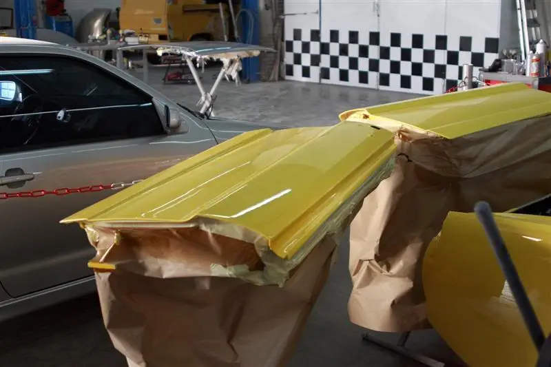

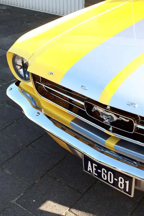

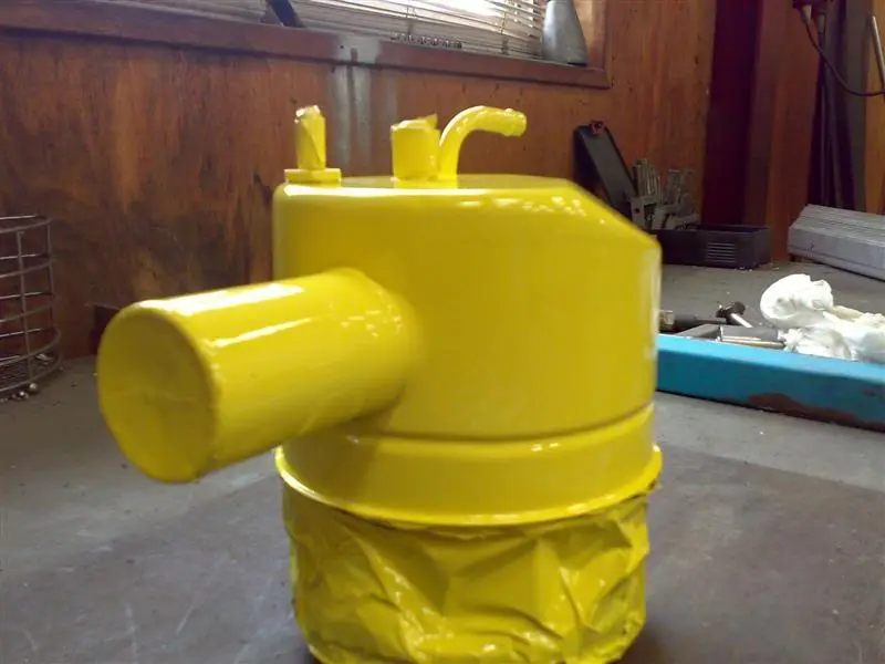

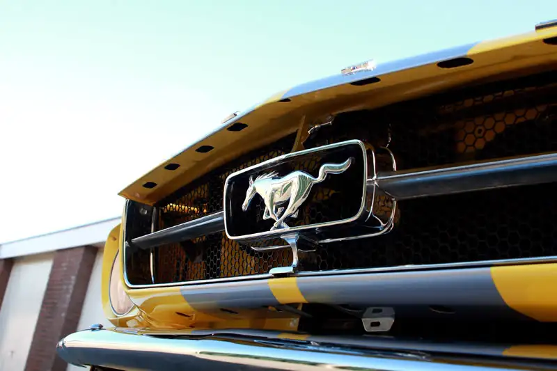

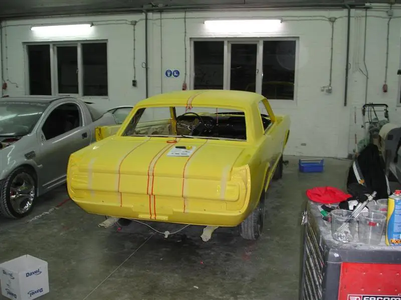

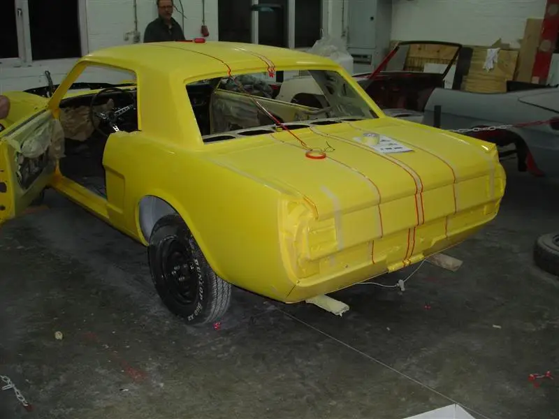

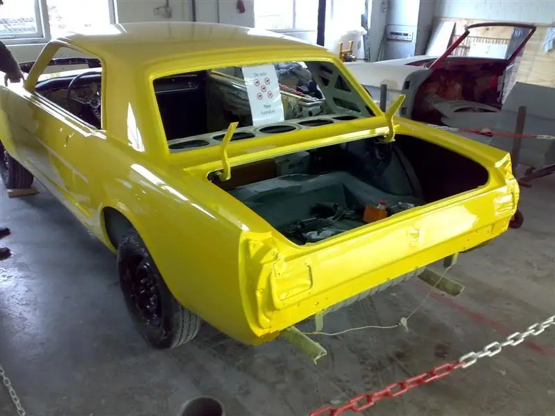

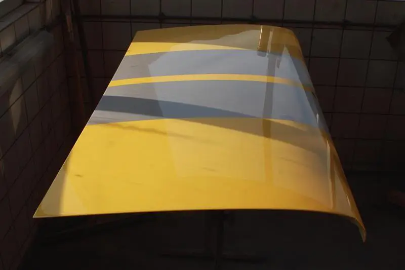

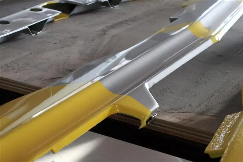

And then time for paint ! Wanted a custom color so we sprayed the car white, then a VW yellow and topped it of with some Pearlescent topcoat from honda with a twist ;) and sanded it all down, sprayed some stripes with a silver metallic and then sanded it some more so you couldnt feel the stripes and on went 6to 7 layers of clearcoat :nice:

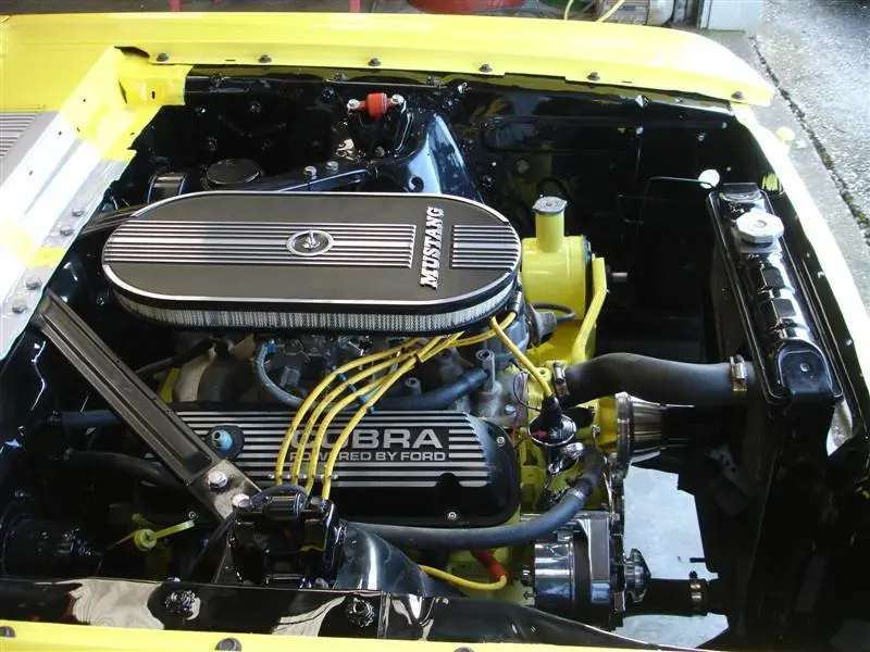

And the engine bay got some highgloss black

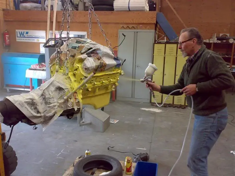

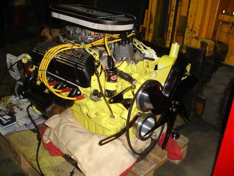

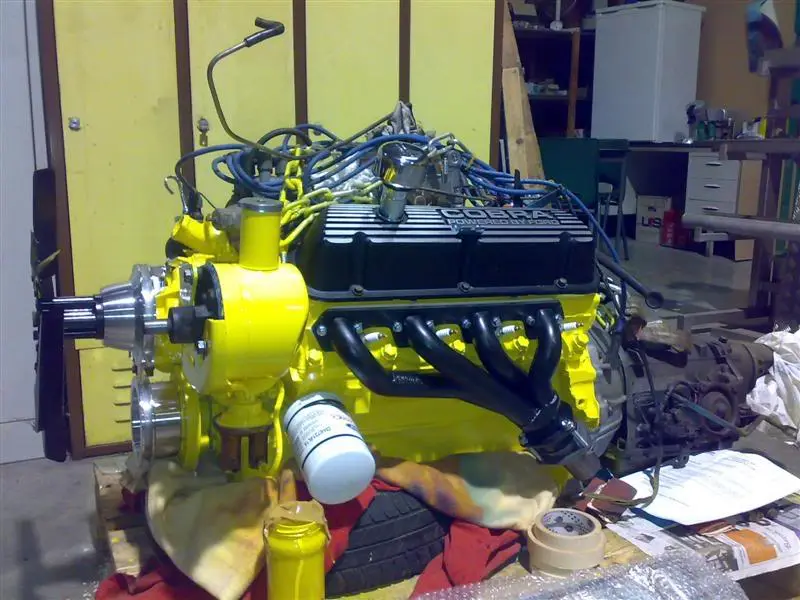

The engine also get a yellow paint job (this was the first engine)
In the meanwhile work was done on the car,
Engine was also ready to put in the car again

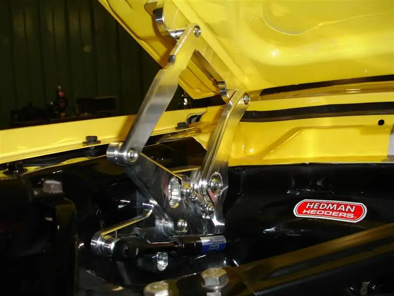

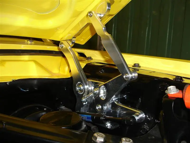

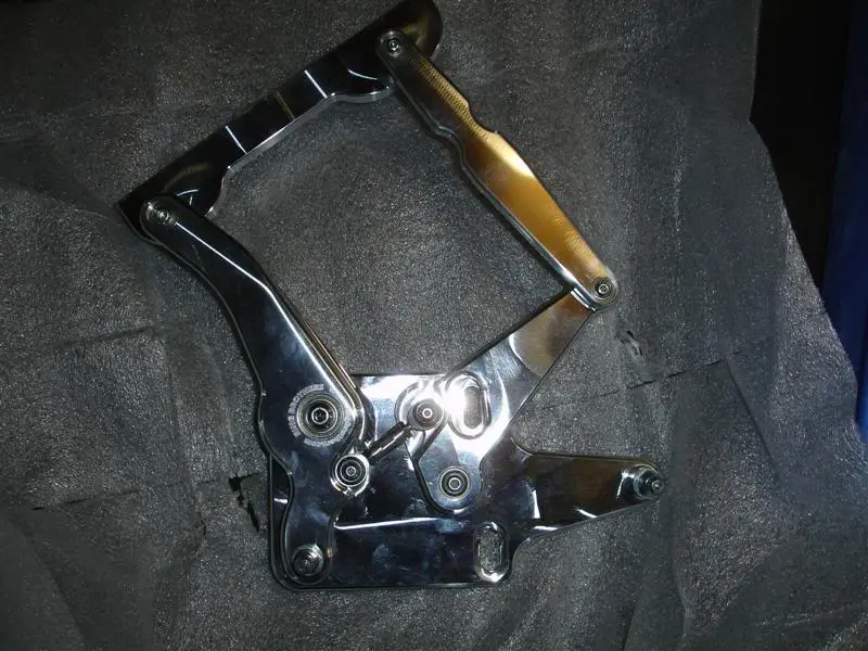

The original hood hinges where a crime to get right and my dad and i loved the look of the ring brother hinges. So we ordered a set of them

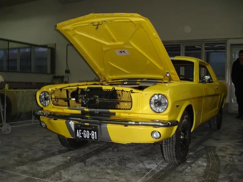

After some time we got the car rolling again and time to bring it home and start the last detail work (but there came much more work than we thought).

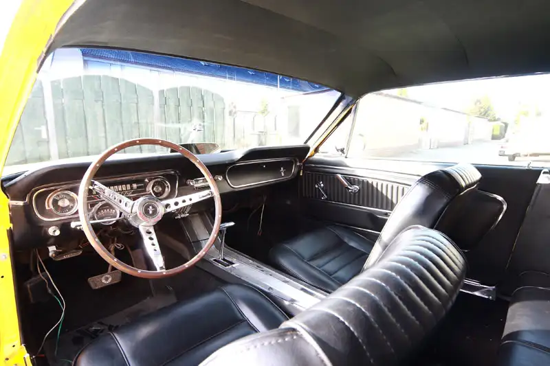

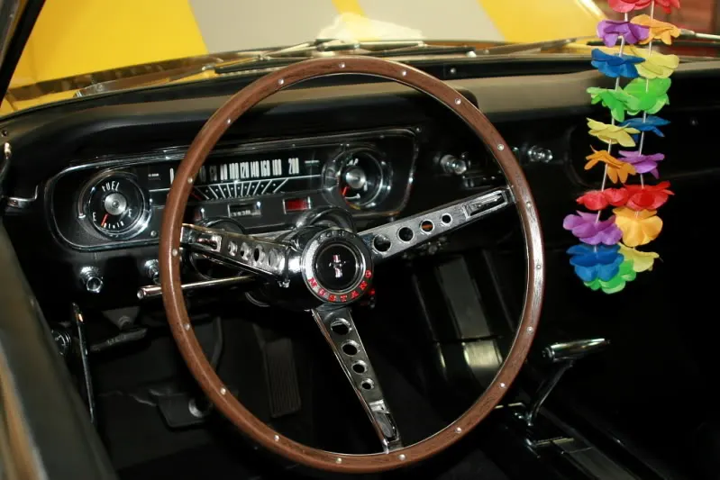

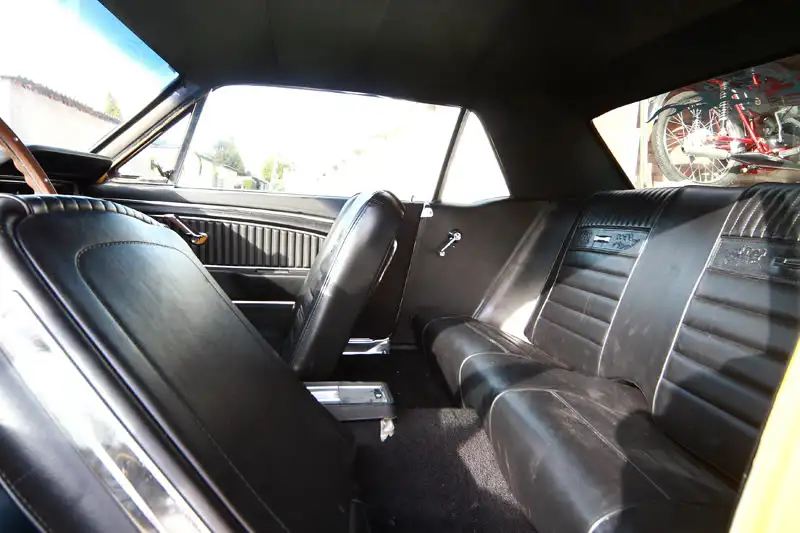

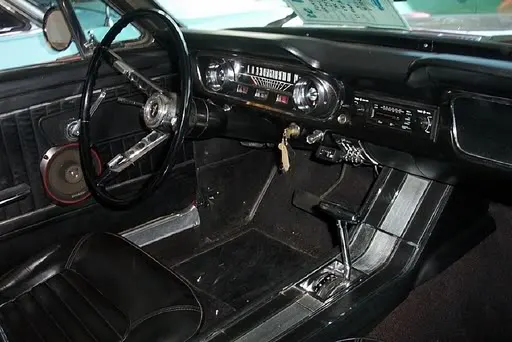

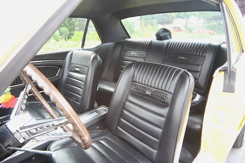

Also the interior got some upgrades with a Pony interior and steering wheel, the centre consule and rallye pack i already had.
Also put in the original AM radio and put a modern one in the glovecomparment !

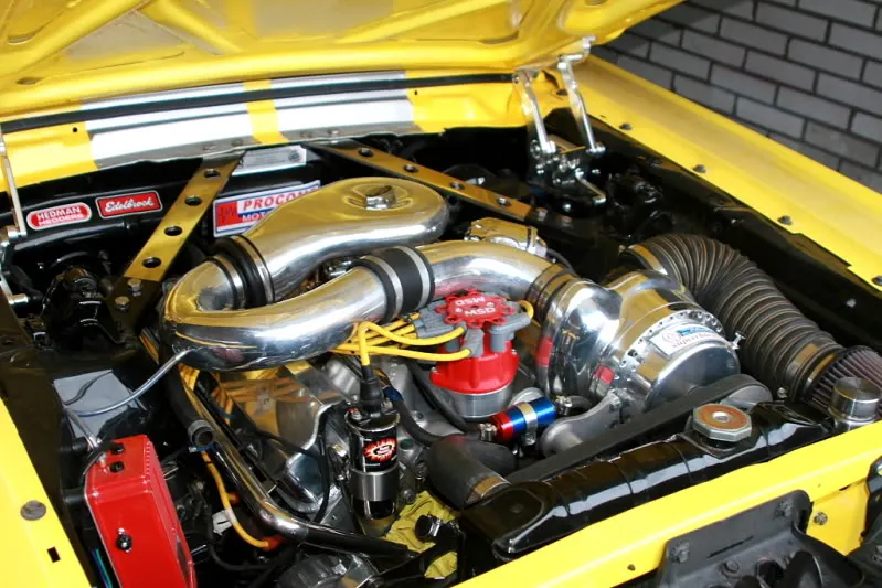

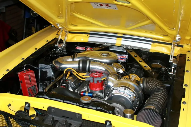

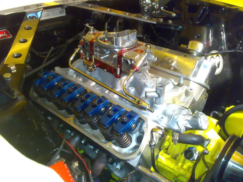

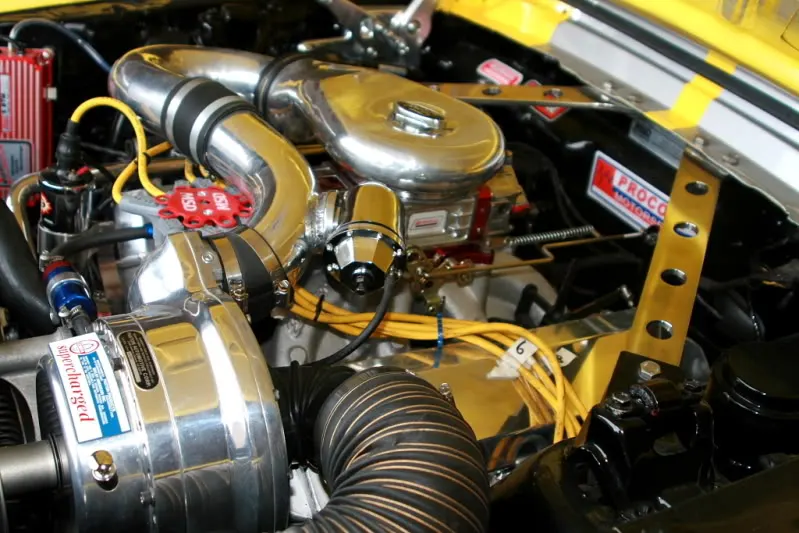

But then it was time for some engine modifications, before i ever driven the car ;)
The specs were:
331 Stroker
Scat rotating parts

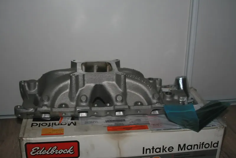

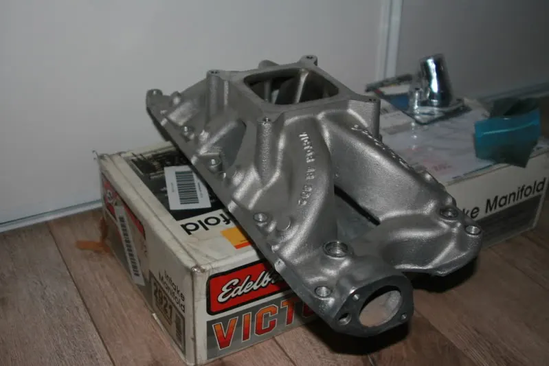

Victor JR Manifold

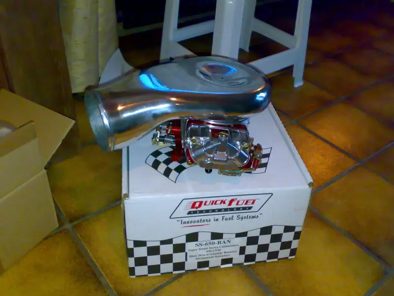

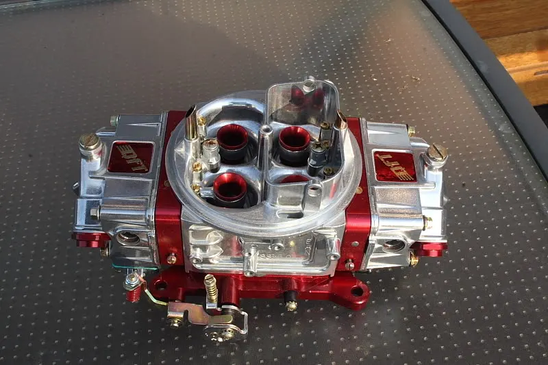

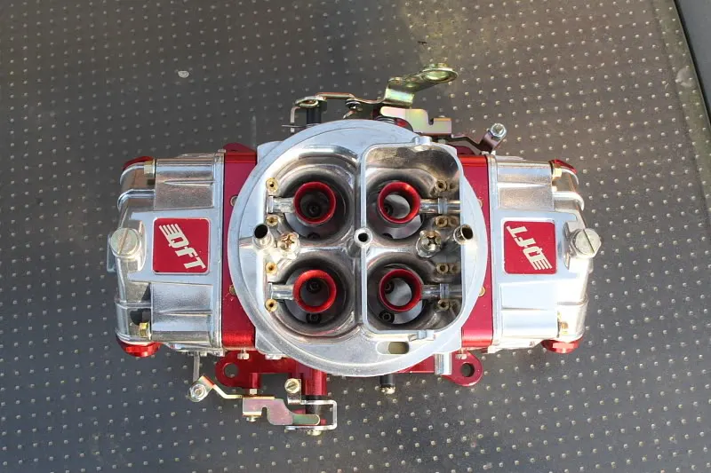

Holley Rebuild by QFT 650CFM blow thru carb
Paxton Supercharger with improved impeller
Heddman Headers
Ford motorsport cam
Trickflow Stage 3 ported heads
Ford motorsport roller rockers
MSD Distributor
MSD 6BTM box
Mallory Sparkplug wires
Underdrive pulleys
Rebuild C4 with 500+ HP upgrades
pg[/IMG]
tp://i27.photobucket.com/albums/c186/Hypertuningfotos/Mustang/23042009257.jpg[/IMG]

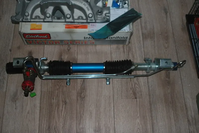

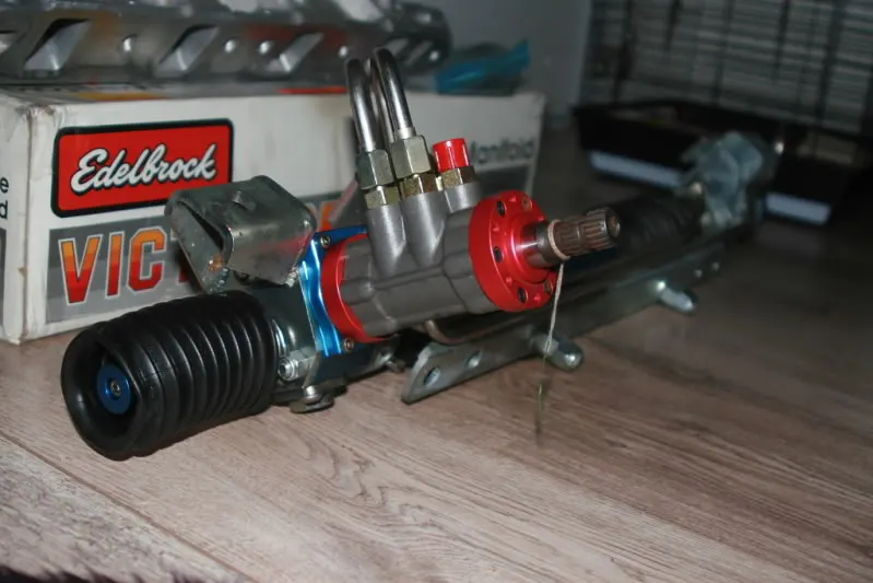

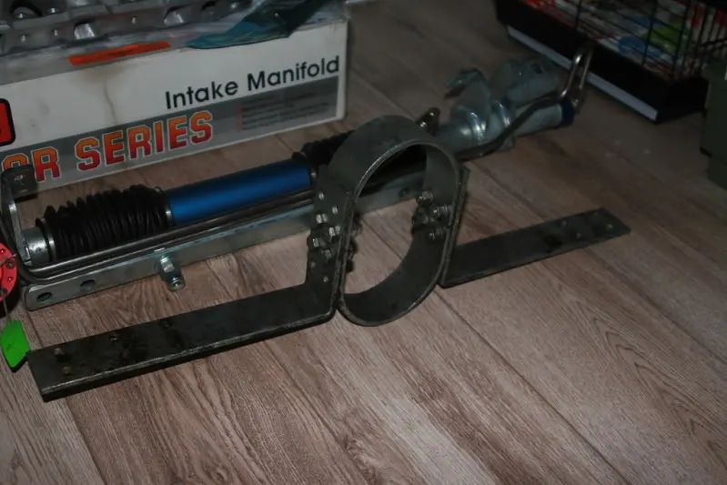

Now we had a healthy engine we also need some handling, so started with a TCP power rack
And for safety a Driveshaft loop
At the moment were working on a TCP coil over conversion for the front and a rebuild 8 inch rear axle with beter gears and limited slip diff.

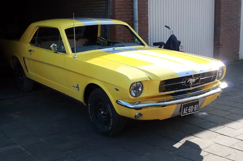

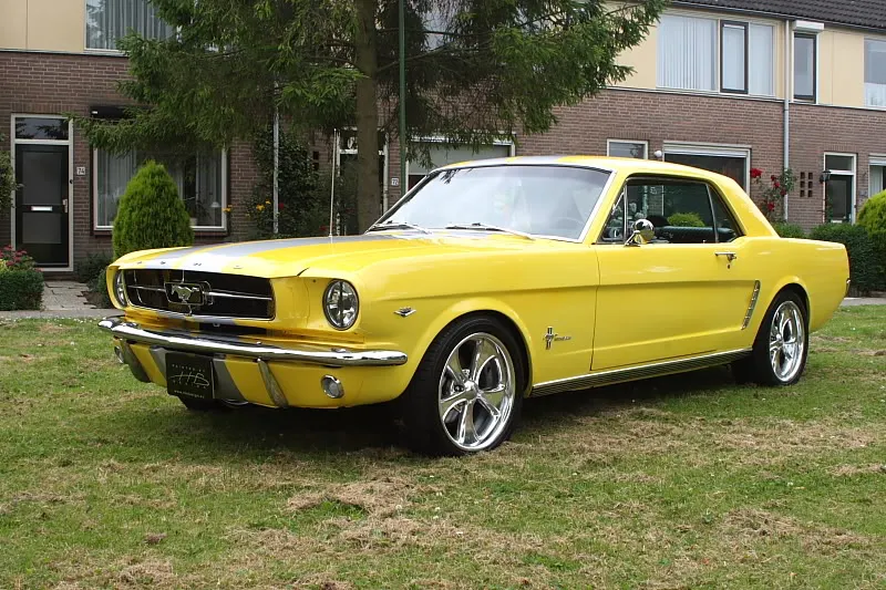

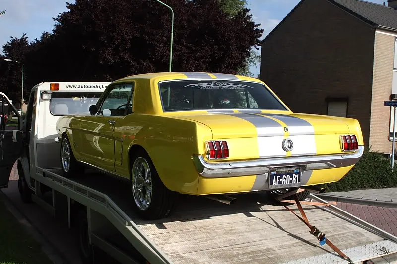

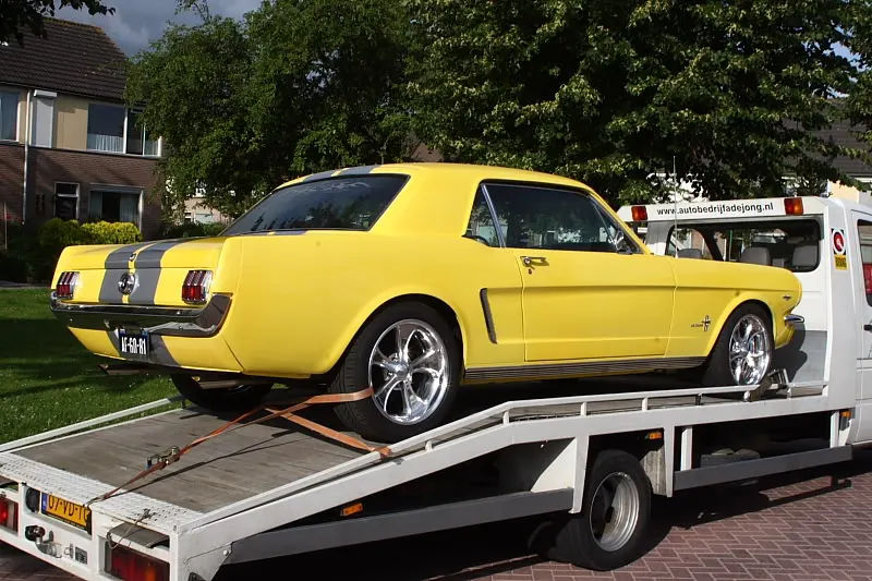

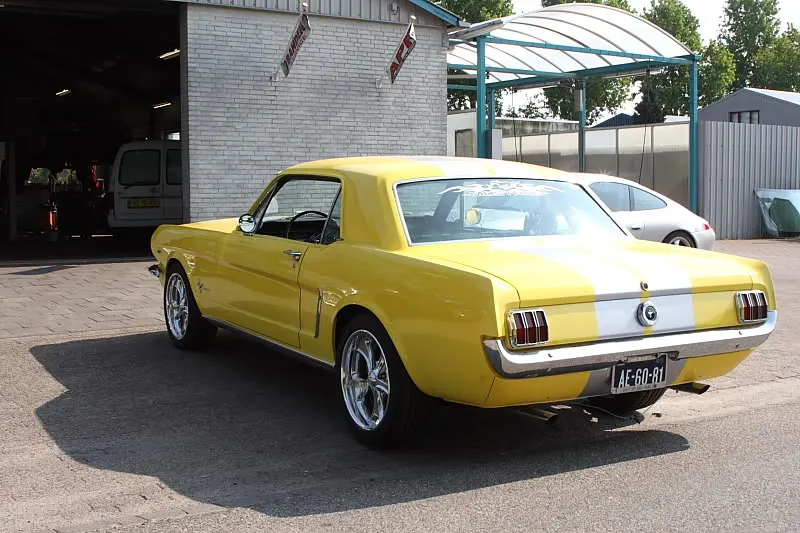

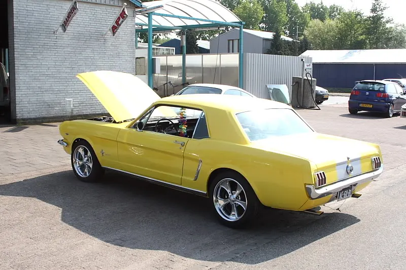

After all that work it was time to roll the car out for some photos

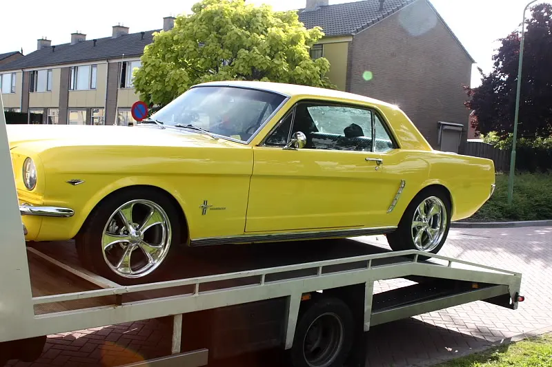

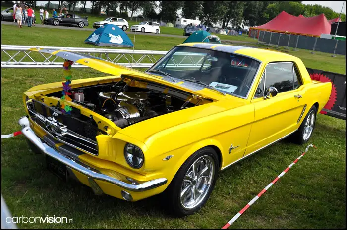

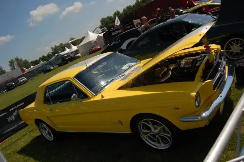

For the first car show it wasnt ready, so trailer queen it was :D
There i won best of show :nice: and the show after that it was almost finished i won another best of show ! Then the car got in the storage again for winter, wich is the present time.

Btw, I love the steering wheel, I love how you kept that look the same--I love that wheel.
Thanx, want to keep the interior as "classic" as possible ! Wanted a restomod but with a mix of the original car ! The most performance parts are not directly visible.

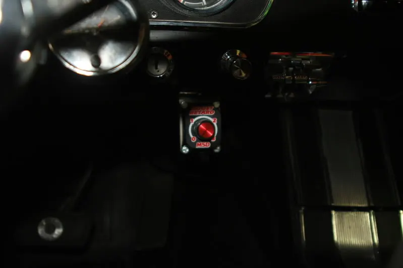

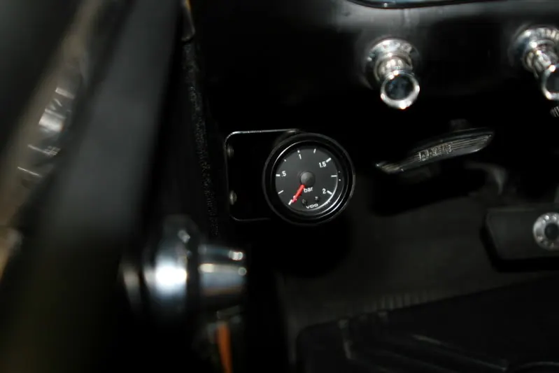

I was wondering about that red push button you have--is this thing running with nitrous wired up or whatever? That's kind of nuts. :P
And yea, you guys do have some pretty powerful juice--in California the max petrol here is grade 91.
@Grand Poobah: No the nitrous is going in this summer ;) that button is a dial button for my ignition. I'm running a MSD 6btm wich retards the ignition when boost going up, with the dial i can choose how much it retards per pound of boost !
I'm going to connect this on a MSD ignition computer so that i dont have a vacuum advance anymore but also computer controled so it acts quicker, anything to prevent engine knock !
