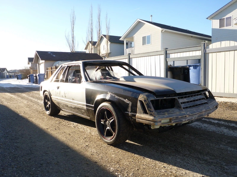

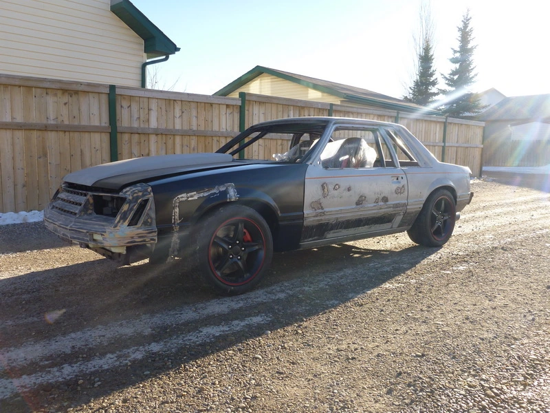

Got the door and fender on and the nose on, but not completely bolted up. I decided it was time for a photo shoot, so I pulled it outside into the alley where I could get full side shots.

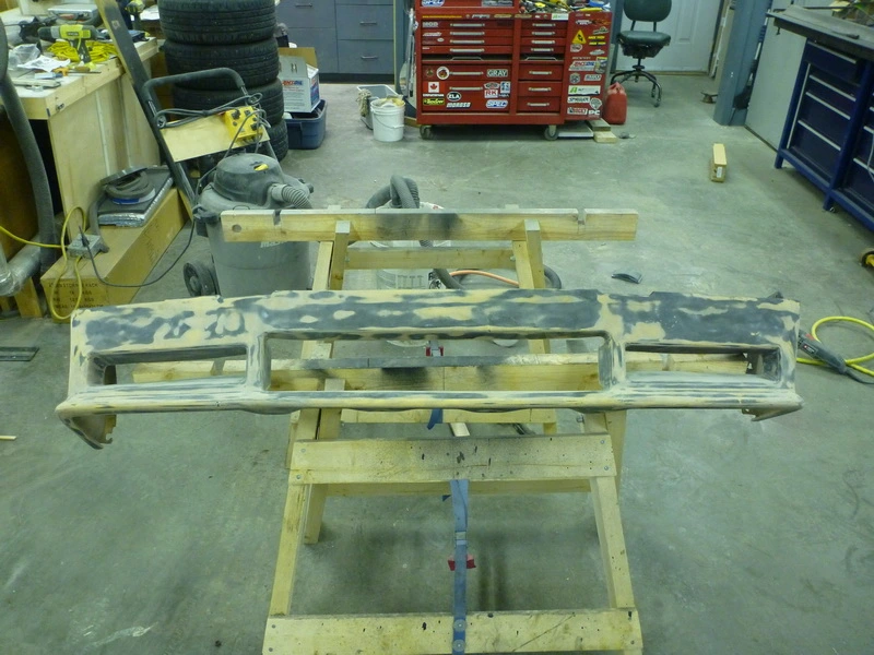

After that, I got busy at sanding the horrible paint of the air dam for the Pace car nose. I am amazed at how pliable the urethane is after getting that heavy layer of paint off. It was quite rigid with it on.

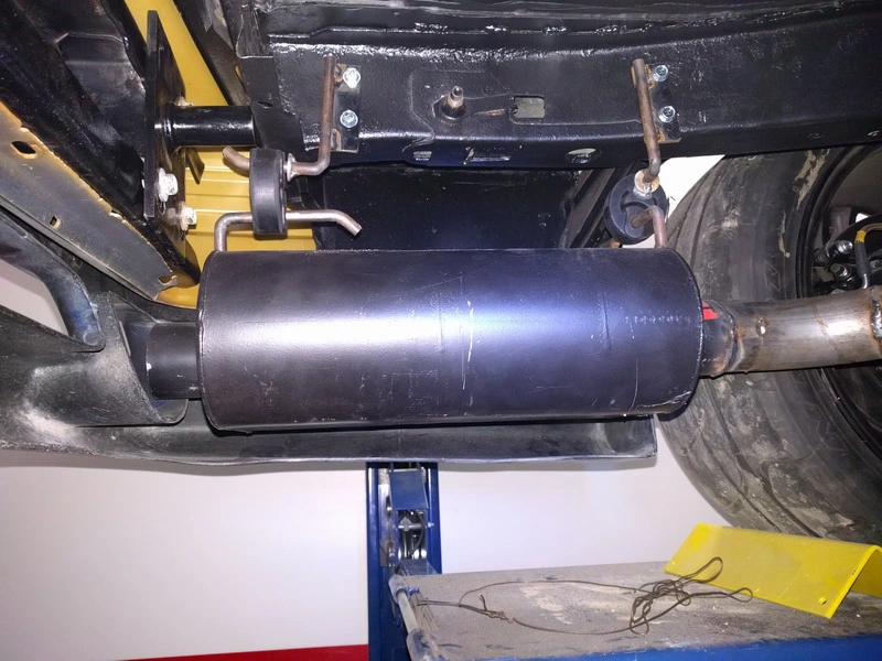

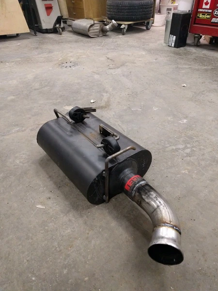

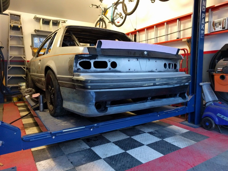

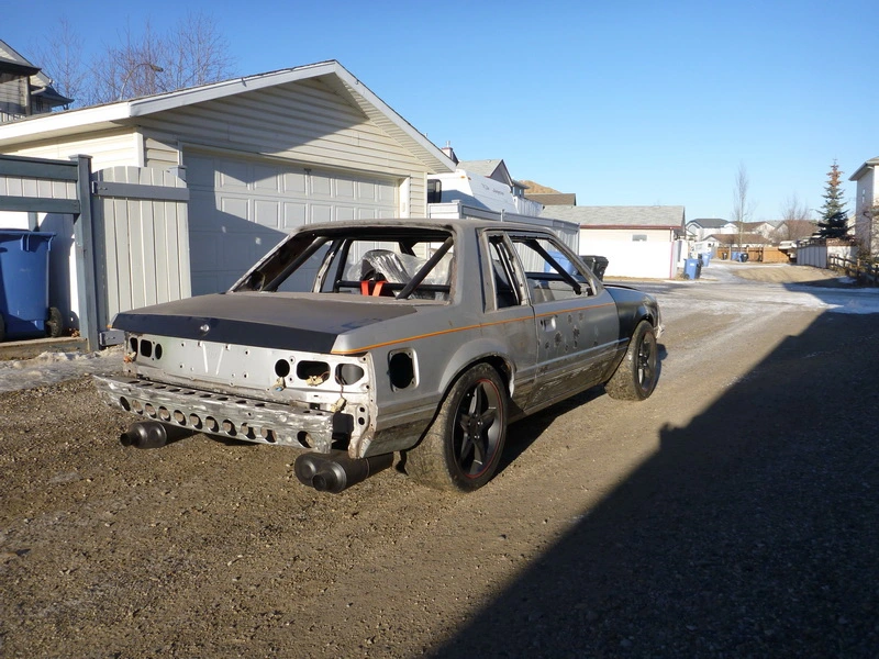

The reason for the mufflers at the rear is for weight transfer. I'm using a fuel cell in the trunk, so there is all that space underneath where the gas tank usually resides available so I figured I'd take advantage of it. Even if it's a small gain in balancing out the weight front to rear. Once I get more of the body work fitted up at the rear, the mufflers will be hidden out of sight as I'm using a Xenon rear skirt on the car as well as side skirts. The exhaust will exit out through the openings in the skirt, and thus I have not yet finished aligning the mufflers properly. Presently they are just hung with some mechanics wire.

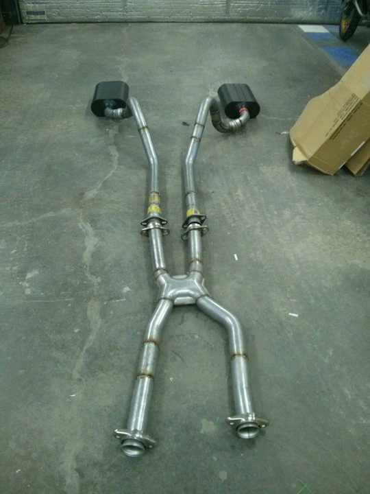

Here is the exhaust system ready to go on. I fabricated all the pipes back of the X pipe myself using pre-made bends and straight pipe. The X pipe was modified to fit around the MM torque arm.

You may want to switch to a different muffler design if you're going to stick with the rear-mount. I don't remember all of the exact science behind it, but Hot Rod or Car Craft did an article on designing exhaust systems a few years back, and stated that running a chambered muffler without any significant length of pipe after it robs you of some horsepower. Of course, if you're not going for all-out horsepower, feel free to ignore it, hell, I have too (with either the same or similar mufflers, Flowmaster Super 44s) a time or two in the interest of either fit or sound.
I'll have to do some searching on that then. I originally was going to use a pair of mufflers from a 2011 Mustang GT I picked up used. I got a deal on the Flowmasters and they are much smaller and lighter so I went with them instead. I am looking for a nice pair of resonator tips to use on the outlets, not sure if that will add the effect of additional pipe or not.
It's not a lot of power, about 20 hp iirc, but it was enough that they mentioned it.
I bet it will sound like a car with dumped flowmasters underneath... That being said, when I lost my tails on my '95 and tried dumps for a while, it really did feel a little more sluggish until I put the tails back on. I thought it was all in my head, but maybe not. But there is only one way to know, and its not like you cant change it if you dont like the sound or performance after driving it a bit.

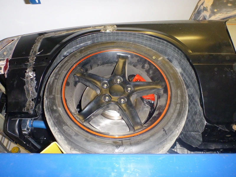

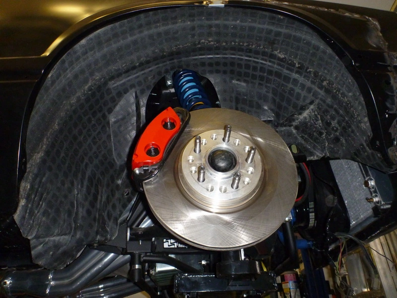

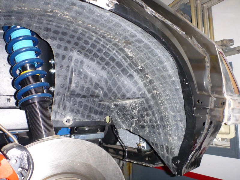

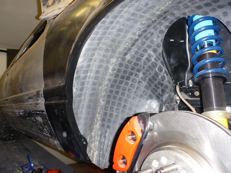

This afternoon I figured I'd have a go at the inner fenders to see how they might fit up to the modified fender. On a hunch I grabbed a pair of inner liners from a 94 Mustang thinking that they just might work with a bit of trimming. The 94 wheel opening is much larger than the what the Fox fenders have but the lower part of the fender is wider too. The lower part of the plastic was the part I had to trim the most. Basically I just held the plastic up in the fender opening and marked the outline of the fender. It took a couple of times to get the plastic trimmed down in all the right places to fit. Once I had them cut down they fit almost as if they were made for the car. I love it when a hunch pays off.

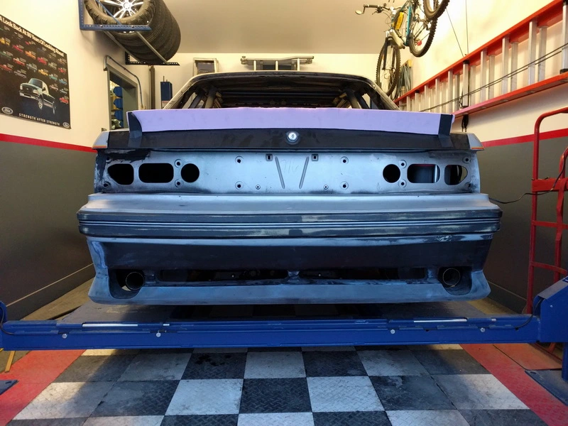

With the cover cleaned up I put it onto the car, then got to fitting up the xenon rear skirt. I am happy with how it looks on the car, it hides my rear hung mufflers nicely. I just need to get some better screws as the only ones I had on hand are hex head sheet metal screws. I'll have to find a source for good quality automotive trim screws as I need them for various other items as well. I also have the Xenon side skirts, I bought a complete kit used a while back, but I'm not really liking them as much. They are a bit beat up and don't seem to fit very well so I'm going look into something different for them.
Getting the bumper and valance in place was the thing that needed to happen so I could finish hanging the mufflers and exhaust system. Since the pipes exit through openings in the valance, I wanted to have it in place properly to line up the pipes. I spent today building exhaust hangers and getting the mufflers fitted correctly. The right one was actually good as I had it, the left one I had to trim the inlet pipe down as well as do a minor trim on the over axle pipe. It too is now fitting correctly, I just need to finish welding up the hangers for it and then getting the four hangers fastened to the car.

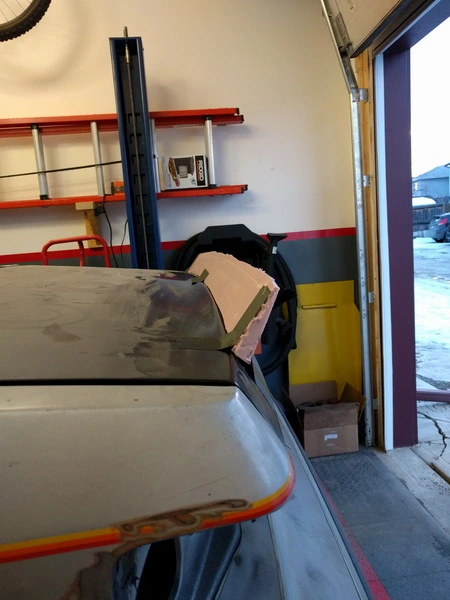

I'm also toying with building some sort of a spoiler for the rear. I like the three piece spoilers from the pace cars, but of course they are not going to fit on a coupe even if I did find one for a decent price. I'd hate to hack one up trying to fit it to the car, so the best bet seems to be to build something. I had a piece of foam insulation, so I cut a shape from it to see how it might look. Of course I would have it extend full width, but I do like the basic shape. Stay tuned on that.

To each their own of course, but if you are going to use a body kit, I think the only one that still looks timeless is a '93 cobra kit. I wonder how much of your mufflers would show from under one of those rear bumpers? At any rate, :cheers: to more work done.
The Cobra bumper is nice too, but not on my 79 as it would mean having mismatched body molding profiles on the car. I'm using a Pace car front end on it and want to keep the lines consistent all the way around the car which means keeping the original rear bumper cover.
I was kind of wondering how the rear was going to go together with the mufflers where you had them located. I was honestly afraid it was going to be some redneck/ricer thing going on but, after seeing what you did...:nice:. Looking good!

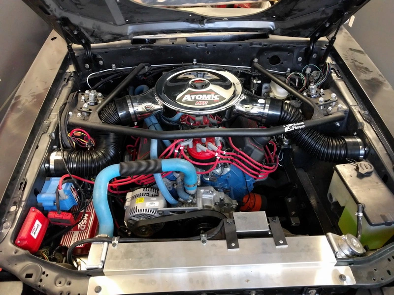

Got a call this morning and my Spectre air cleaner was finally in. I'd ordered it back in early November, but it was on back-order. Thanks to Darran (82GTforME) I scored the two air tubes that fit under the fender to draw the cold air up in trade for my fender liners. The air cleaner has flanges that mounted to the skirts in the engine compartment and flex tubes to connect to the air cleaner. It's kind of like an aftermarket version of the HO dual snorkel air cleaner. I did have to add an extension ring to the base to raise it up high enough off the MSD EFI throttle body. That was a fairly simple job to cut a strip of tin form it into a ring and weld it up. The right tube just barely tucks under the MM strut brace, but it looks pretty good I think. The EFI cam with a nice decal that I applied to the lid. I'm not usually one to put decals on anything other than my toolbox, but I liked the way this one looked. Kind of like those sixties muscle cars. Also grabbed a nice Ford logo wing nut to hold it on.
With that little item looked after, I got back to my original plan for the day, finishing off the mufflers. I got the left muffler finished off and welded up first off.
With that done, I got at fastening up the hangers onto the car and getting the final adjustments done to all the pieces.
Everything for the hangers I made except for the rubbers. I also made up a couple of tips to finish it all off out the back. I have been looking around for some nice chrome or stainless ones, but haven't found anything that would work yet, so i just cut a couple pieces of exhaust tubing, cleaned them up and gave them a coat of header paint. I'll bake the paint on tomorrow so I can get them on. I will still be on the lookout for something else, but these should do fine if I don't find any.
Thanks, the air cleaner is made by Spectre which is a division of K&N. It has a K&N type element in it. They make this style with different options on the angle of the inlets. I had to do some figuring and measuring to decide which one to get. It was special order so non-returnable if I got it wrong. I really wanted a cold air inlet style air cleaner rather than the typical open aftermarket style.
I like it, and Im sure its good for a couple extra ponies as well. Your muffler set up looks just like an axle back kit for my S197. Hopefully once you put your tips on it will sound the way you want it to.
