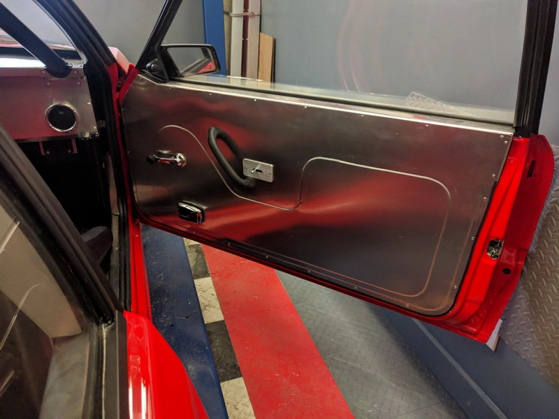

Made the new panel for the passenger door successfully today.

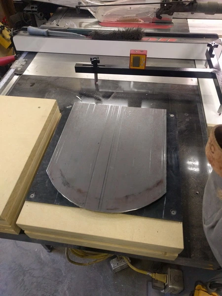

I think that's it for the aluminum work now.

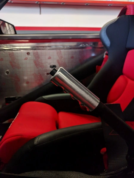

Yesterday I decided to make a handle for the park brake to match the shift knob I made some time ago.

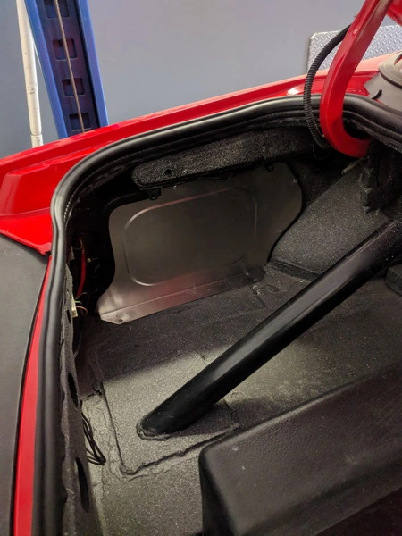

And lastly, a cover panel in the trunk to block off the quarter panel pocket. The other side is all ready blocked by the battery.

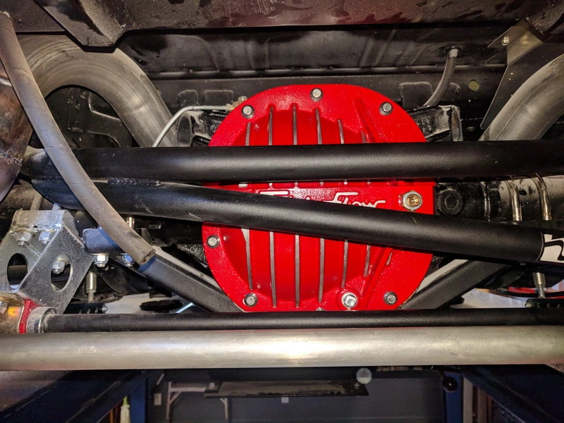

The next item on my hit list of tasks was to deal with a couple of annoying oil leaks. The first was easy, just a rear axle seal. The differential I got had a small ding in the end of the tube, and although I worked it out, it was enough of a deformity still to allow the oil to get past the outside of the seal. I pulled the axle and seal and used a coat of sealer to fill the gap with a new seal. Since I had the cover off, I added a new TrickFlow aluminum cover with support studs for the bearings. And of course I prettied it up with a bit of paint.

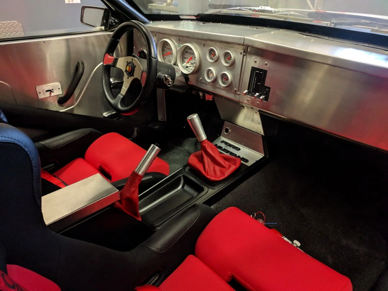

With the transmission back in, I was now able to finish up putting in the shifter boot and the console. Last task was to fabricate a transition piece from the dash to the console.
All that's left to do inside now is mount the fire extinguisher.

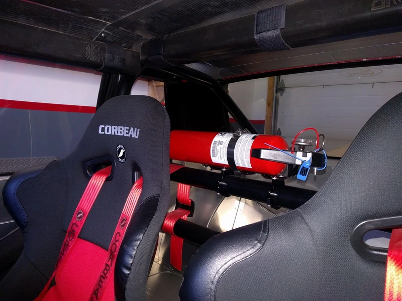

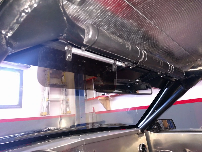

Last couple weeks I've been picking away at some minor detail items. Installed a Longacre rear view mirror and made up a small Plexiglas visor and put the roll bar padding on.
I had some rings to use for the visor, but did not like how they fitted up for that, so after making the rod to mount the visor to the mirror arm, I used the rings to mount the fire extinguisher instead.

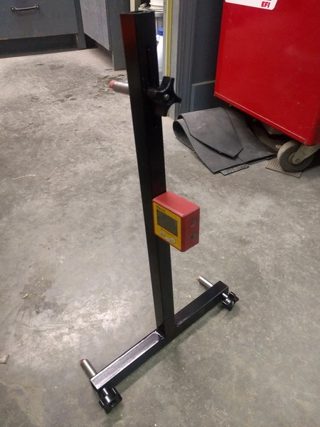

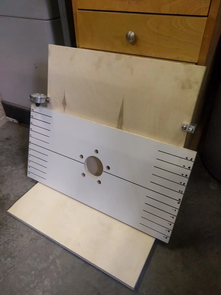

I spent a few days building some tools for doing the alignment too; caster/camber gauge, bump-steer gauge and some turn plates. I need to move the car off the lift and into the other bay of my garage to do the rest of the setup but winter keeps happening and making it impossible to move the car outside to make the switch.

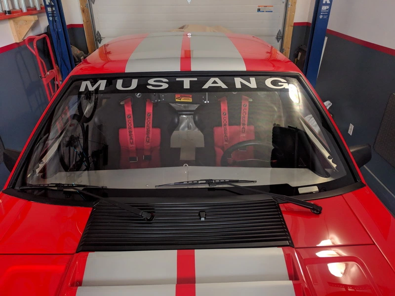

Ok, so where is your stangnet sticker?
I guess I need one, but I'd be adding it to the collection on my tool box, I will be keeping the car clean of decals (though I did add a small Ford oval decal on the top of the rear window too). The window banner was mainly to fill in the black out band at the top of the Optic Armor windshield.
I have had the car running a little, no rattles that have be detected thus far, but some driving time would do better at revealing any.

Can you please post the plans for the alignment tools you built please....
I can't trust these guys at the shop with my car and have always wanted to do it myself. With my OCD I would have to make it perfect. I am tired of the outside part of the tread of the tires getting worn out so quickly.
