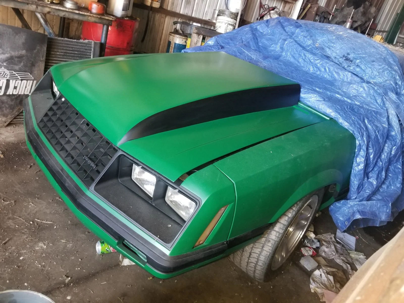

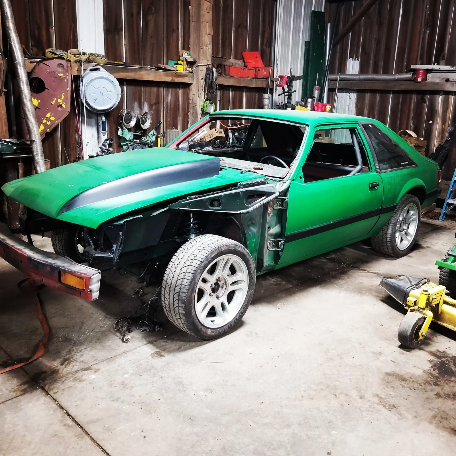

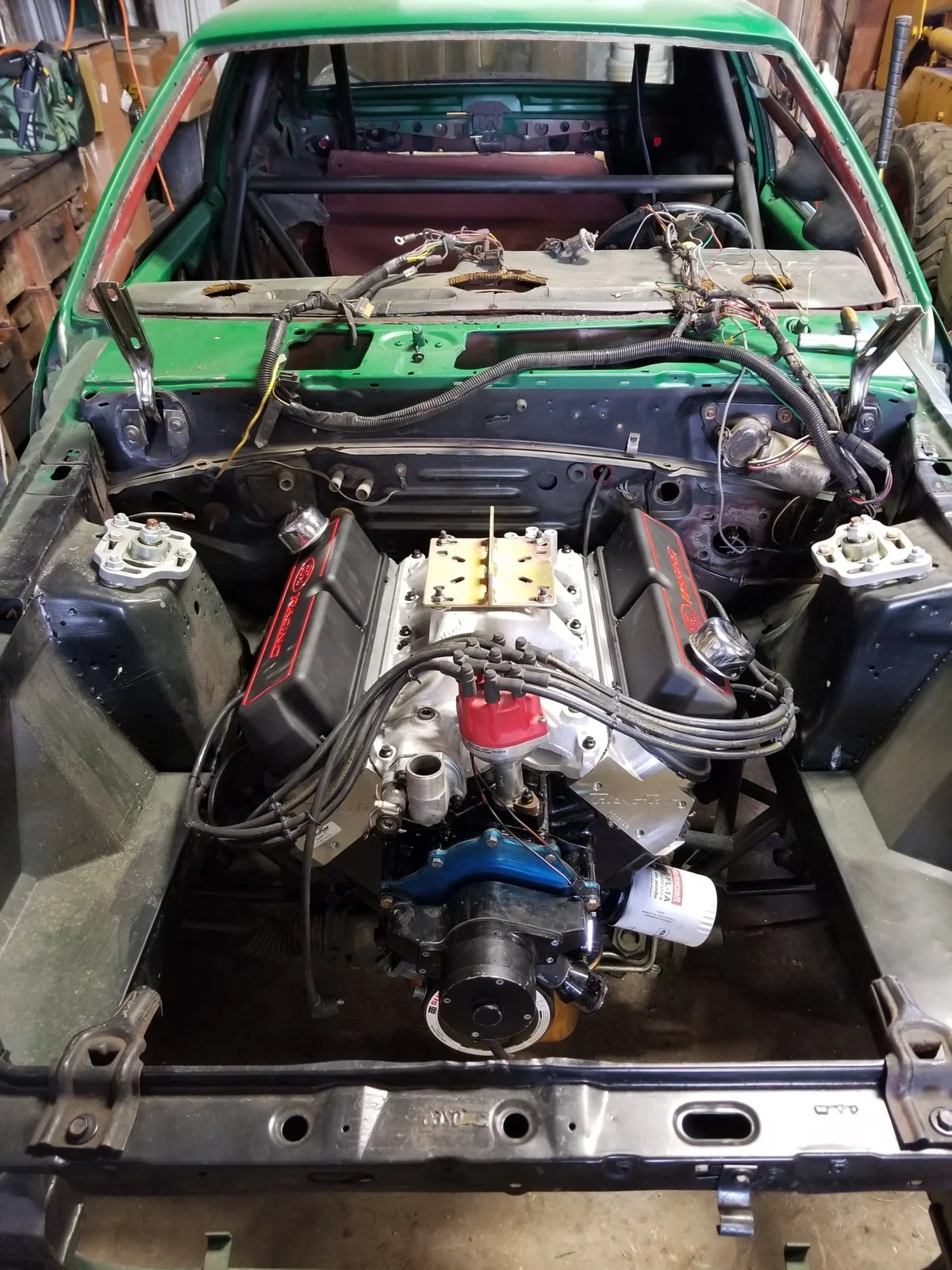

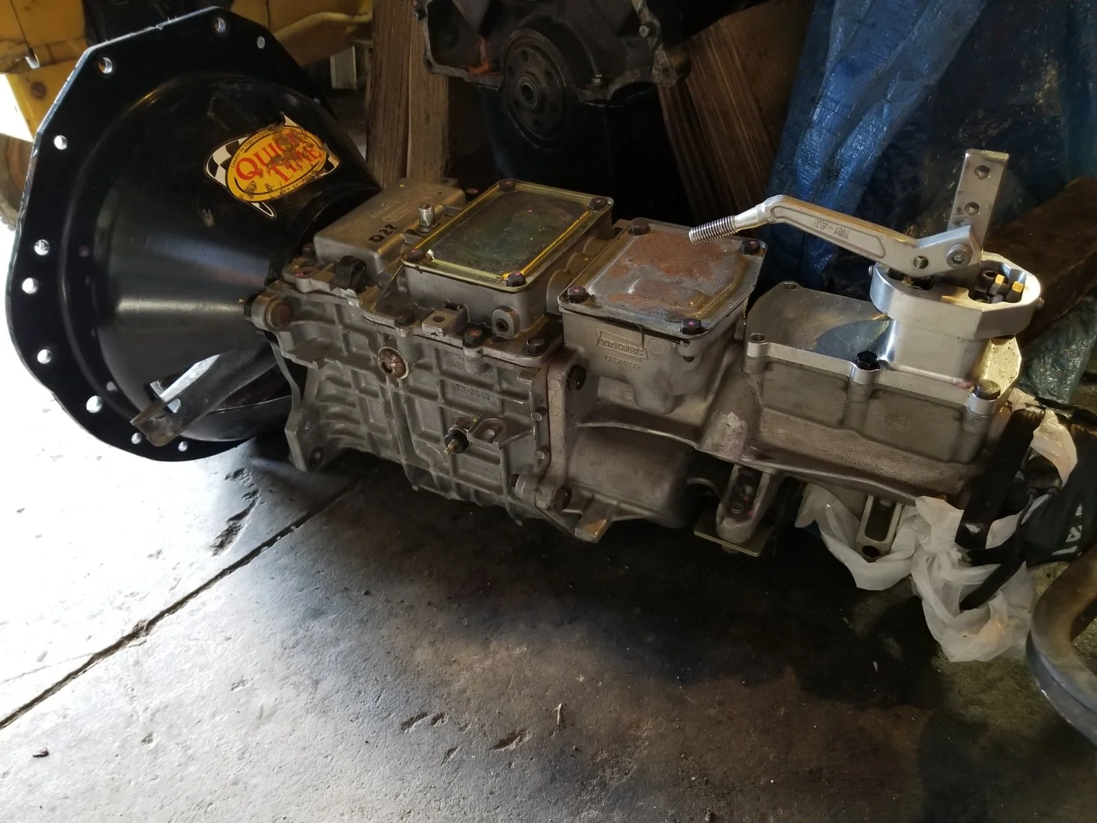

82 fox. Originally an 4cyl auto car. Putting a 351w bored and stroked yo a 408. 11.92-1 compression. Havent dynod yet. Thinking between 600-700 hp at the crank. Dont have a clutch yet. TKO 600 with a quick time bellhousing. Glenns performance 1000hp sumped fuel tank system to 780 Holley double pumper carb. Built 8.8 rear end with 3:73 gears and a ford racing tracklok diff. 31 spline mosier 5 lug axles. Disk brakes all around. Eibach drag launch rear springs. Strange 10 way adjustable rear struts. Strange 10way front covers on the front. AJE k member and A arms. Sub frame connectors and 8pt roll cage. Still need quite a bit of stuff. Just hoping to get some Input on parts I need and how to assemble it together to get it down the road safely.

With 12:1 comp you wont be running any boost. Maybe with 114 and wmeth or e85...
It's not that it cant be done the tuning window for detonation is very narrow as comp increases.
I see issues with 12:1 on pump gas in hot weather if the timing isn't conservative enough.
Well I was thinking of running AV gas with a water/meth system installed. And if I was to boost it, i would of course put some dishes pistons in. And I've heard good things about e85 as well. Gotta do some more research before I make any final decisions.
