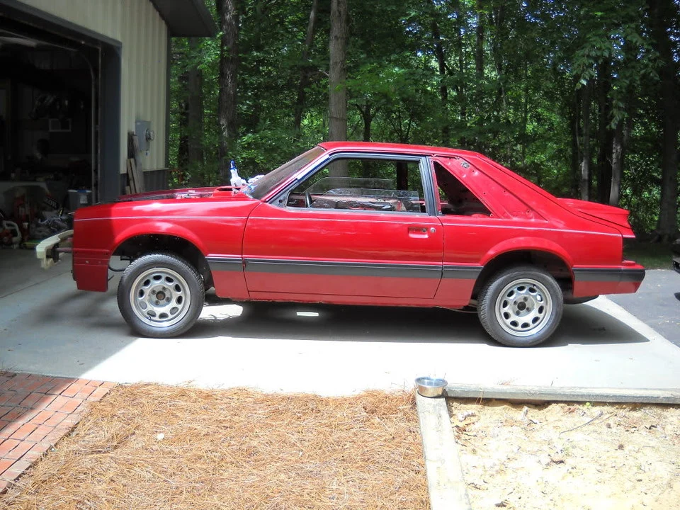

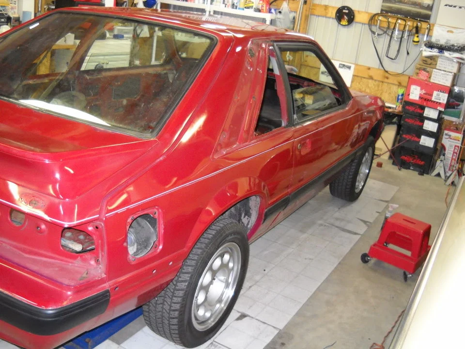

I have been working on the car a little bit every day this week doing little stuff, like painting moldings and spending some more time with the Porter Cable. I pushed it outside a few days ago to see how the paint looked, and to see if the 97 GT wheels would look good on it. They do! So, it will be going 5 lug.

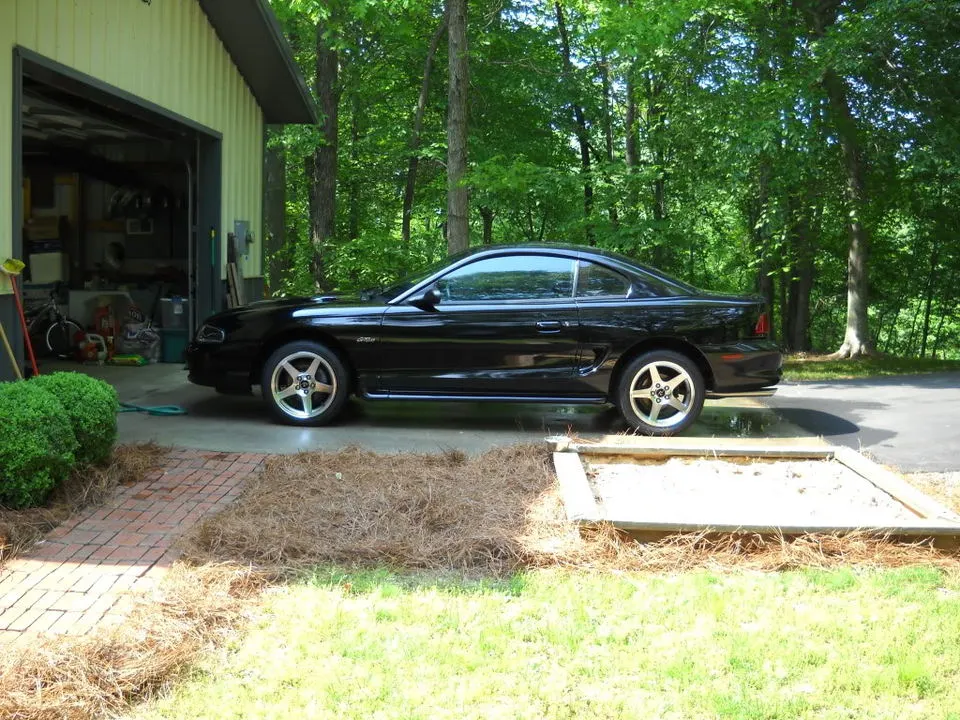

Heres a pic of the 97 Gt that I have had for a while now. Its 100% original. I love this car so much!

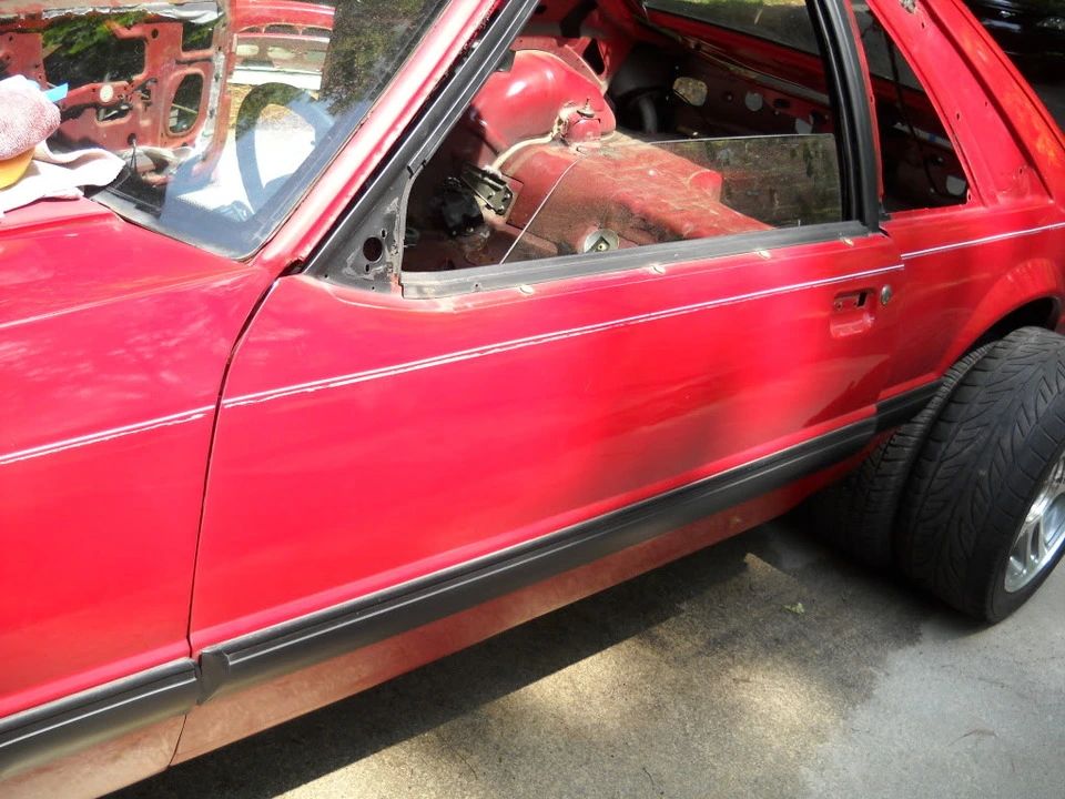

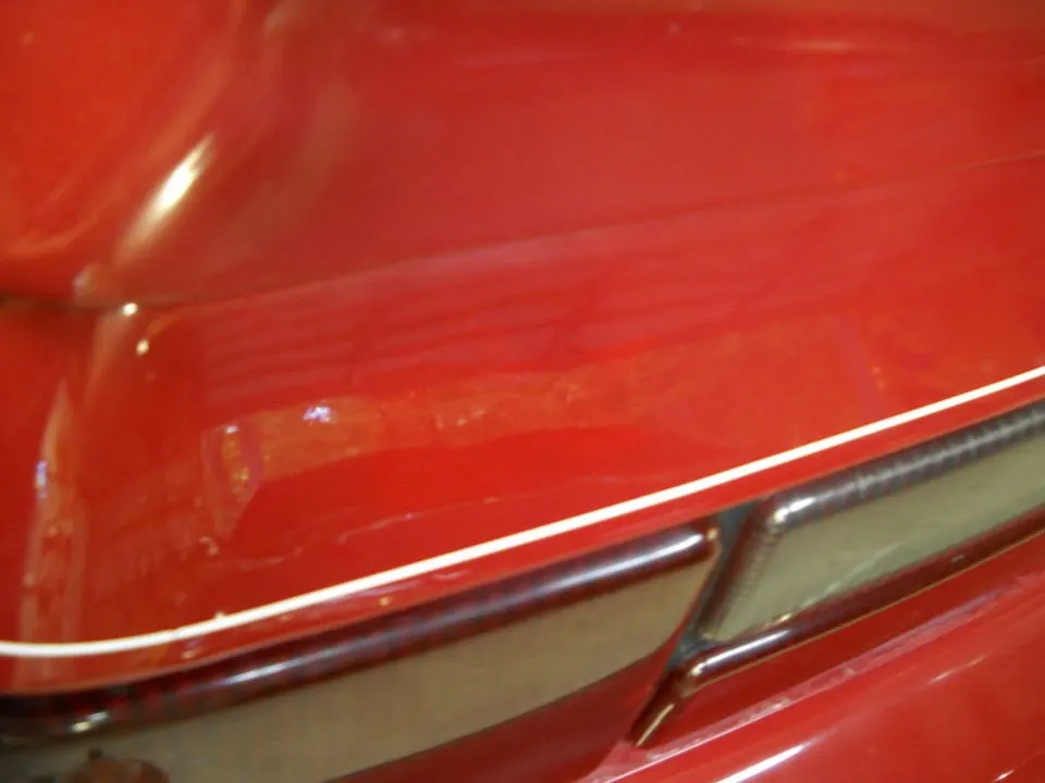

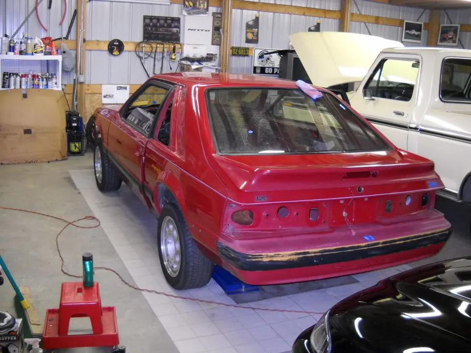

And a before and an after on the molding work...
Before.
After.
I also shaved off the LX emblem. It was in bad shape.
I also painted the door molding.

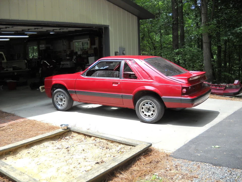

Heres today's progress...

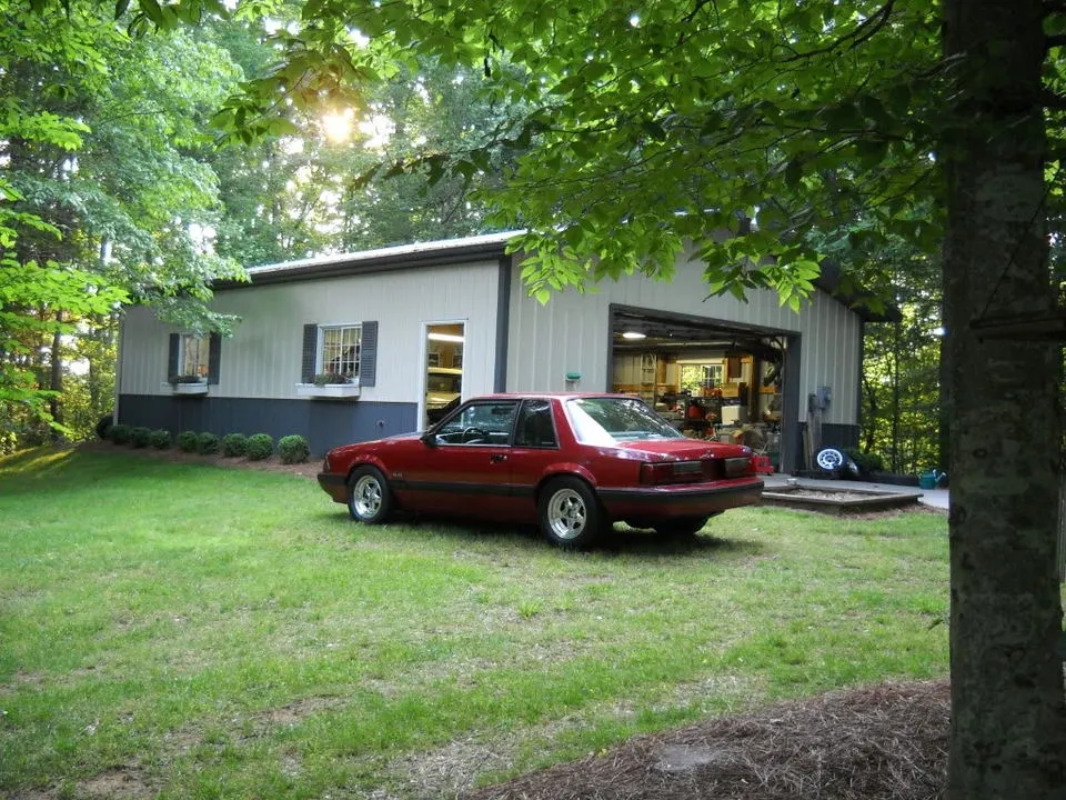

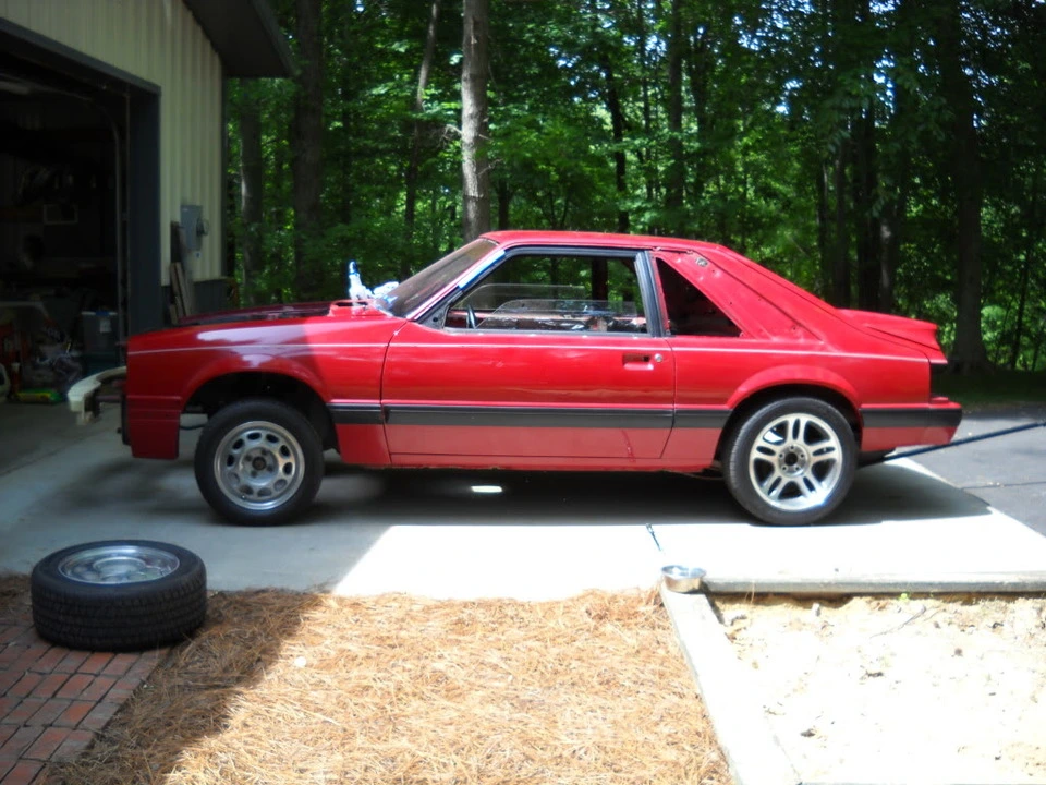

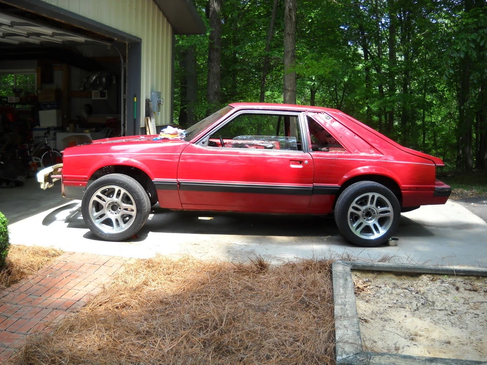

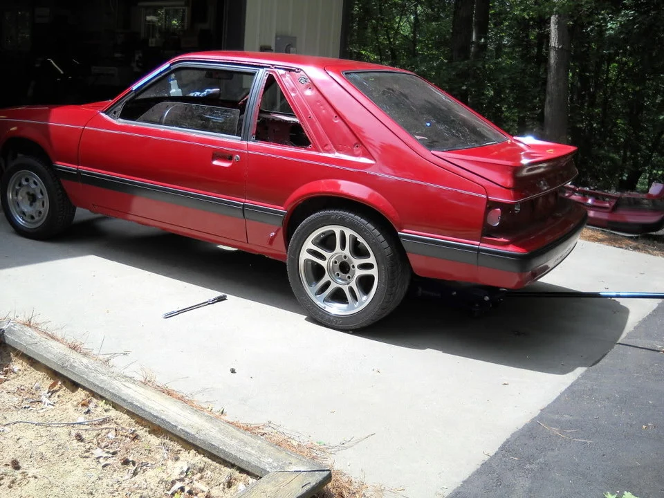

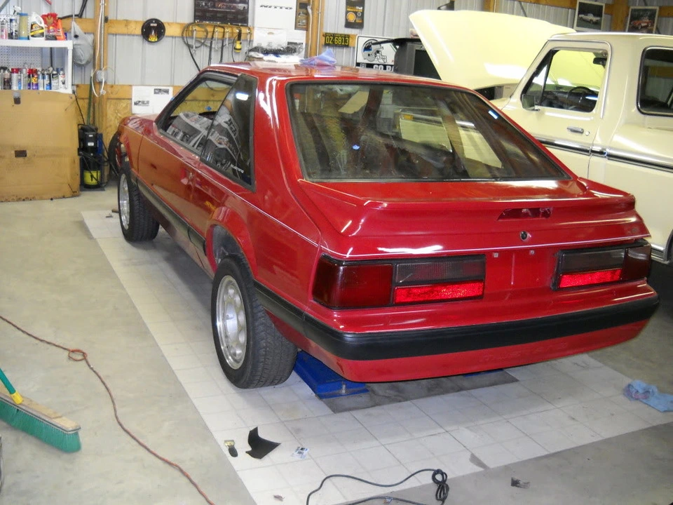

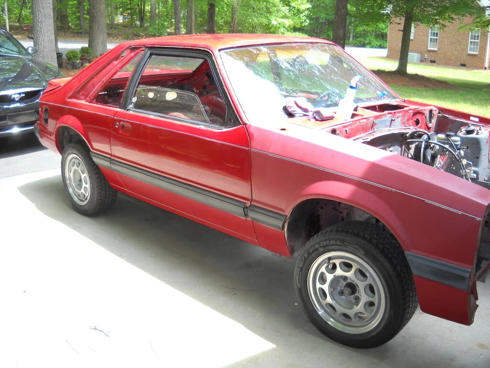

I got more polishing done on the passenger side. Later on in the day I finished the fender. Heres some pics of the car outside..

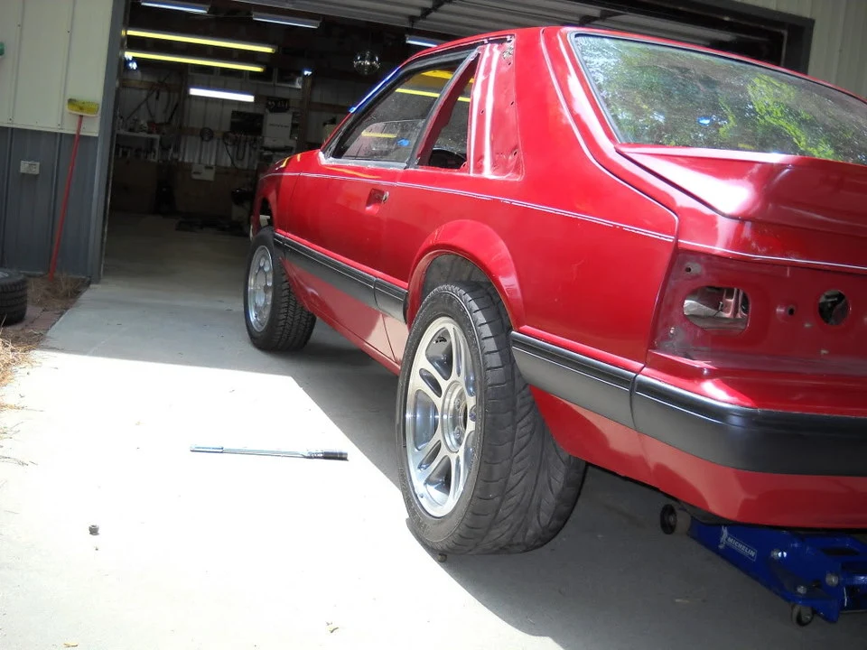

And with the 97 wheels mocked up under the car...
and heres the other side completely polished. I still have to go over the whole car with scratch/swirl remover and a nice wax. I think the color is going to pop with some good wax!

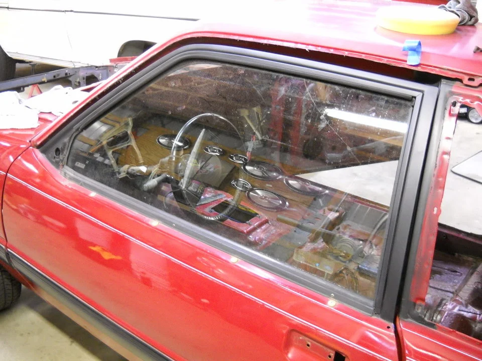

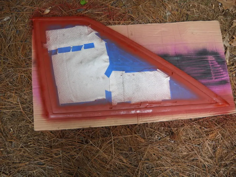

And I'm starting on the quarter windows. They are in TERRIBLE shape. So far I have done 4 heavy coats of primer and sanded in between each coat. This was after the first coat. I hope to finish this one tomorrow.

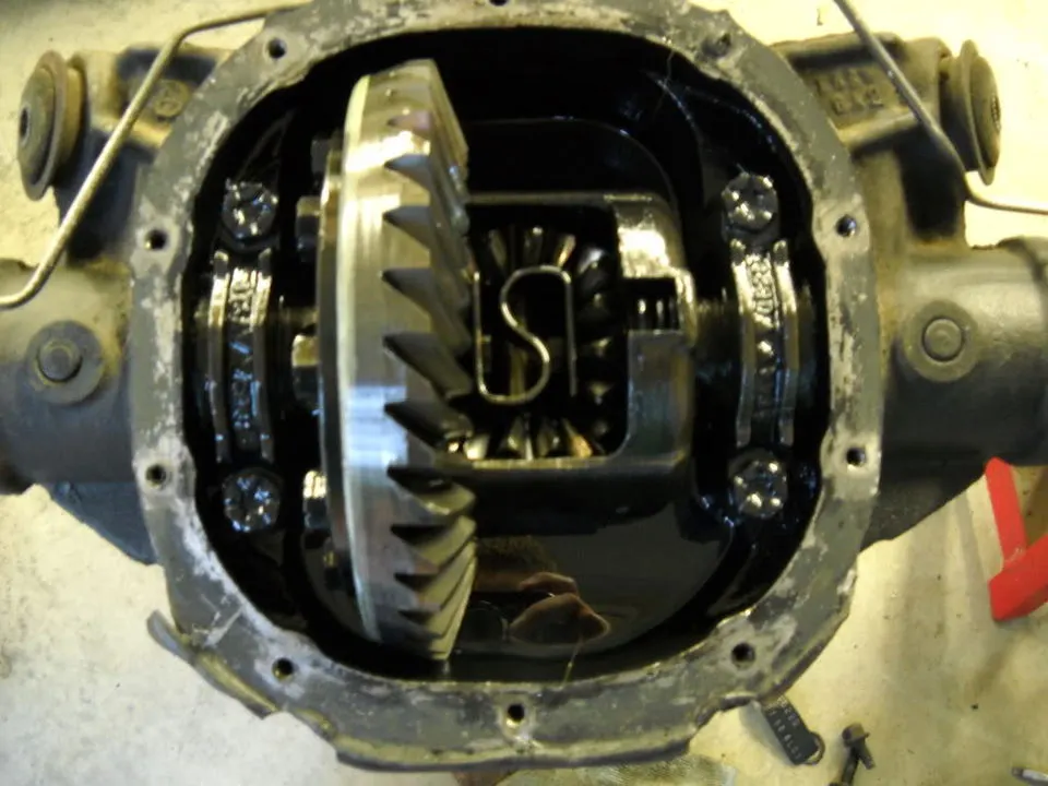

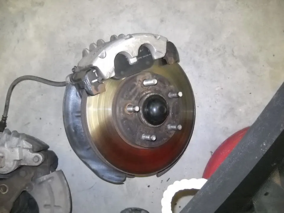

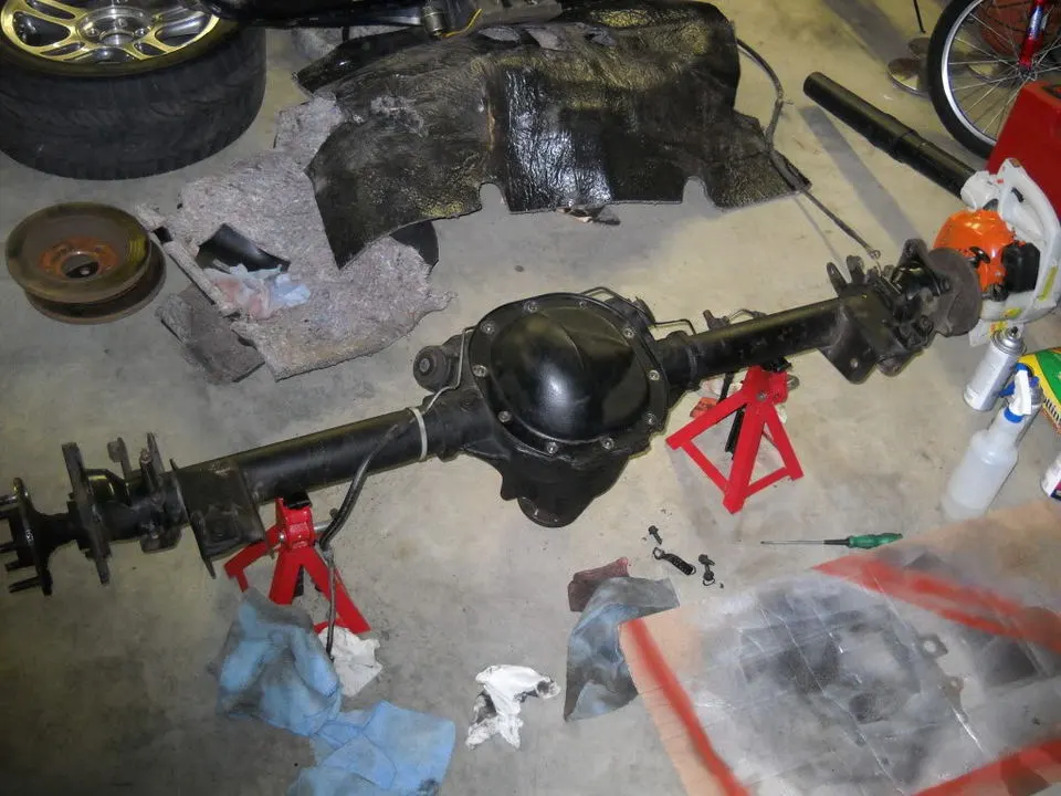

Got my 5 lug stuff. It consists of 95 spindles, 99-up PBR calipers, and a SN95 disk brake rear end.
I cleaned up the rear end a little. I'm going to paint my calipers and stuff silver and black. The rear end cover will be silver as well.
I was planning on swapping out the 3:27s for my 3:55s, but I really don't see a need to. I don't care if this car is fast or not. I just want a good driver.

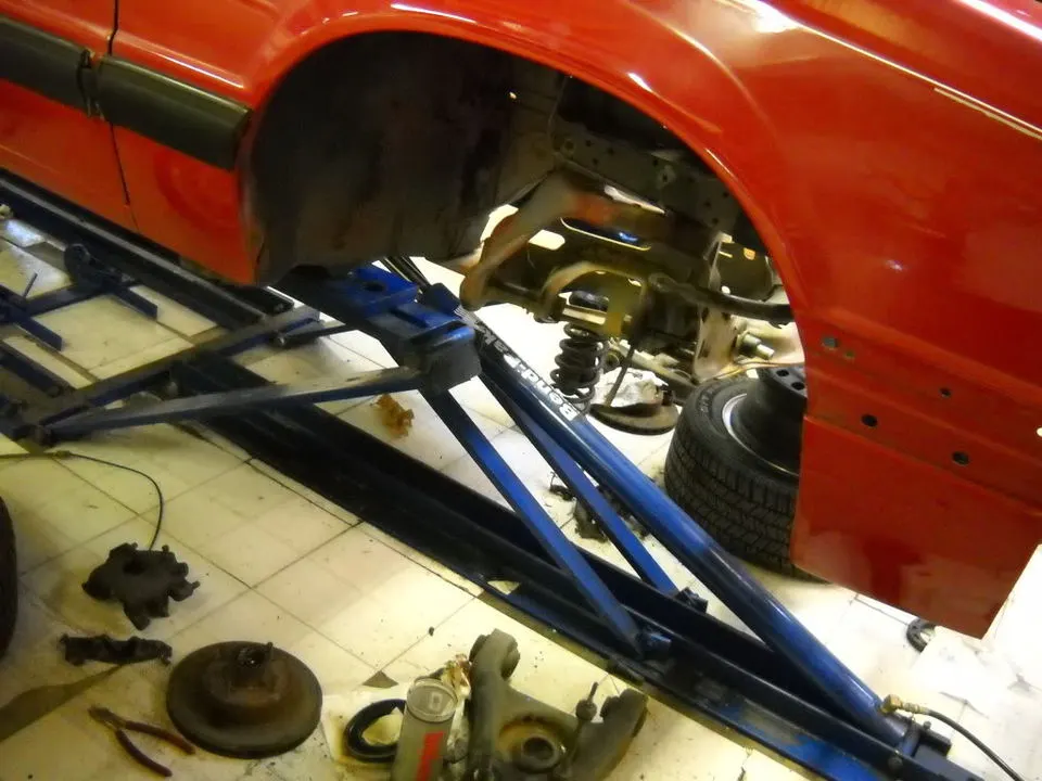

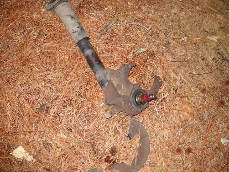

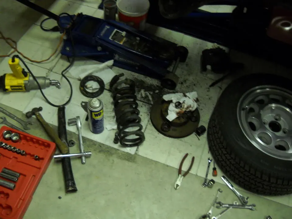

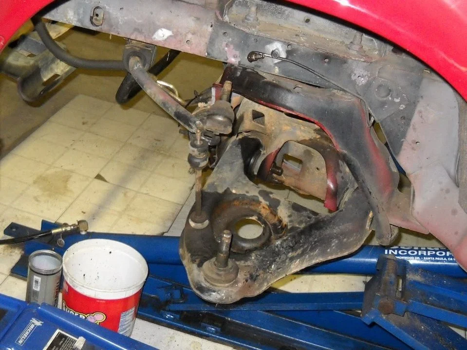

Got one side almost stripped down. The stock struts and all were still on there. None of the bolts have ever been turned. The dang things will NOT come loose!! I ended up having to take out the whole assembly. Springs still scare the piss out of me. They contain a ton of energy!

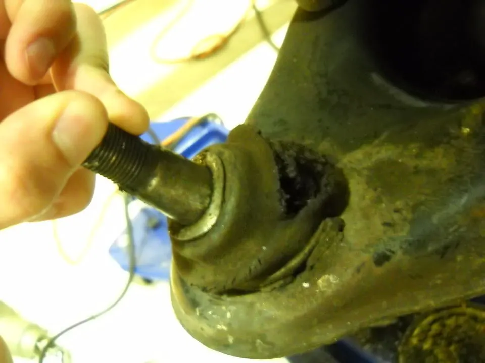

UMM I think my ball joints are almost done for...
Only one more bolt left on this side. It's wanting to be a pain though.

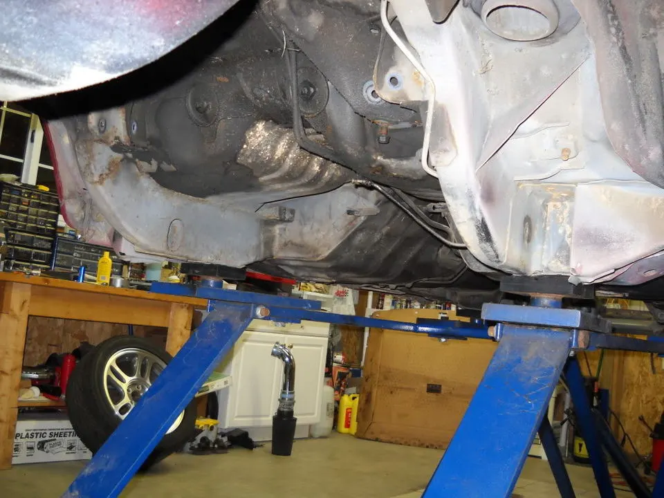

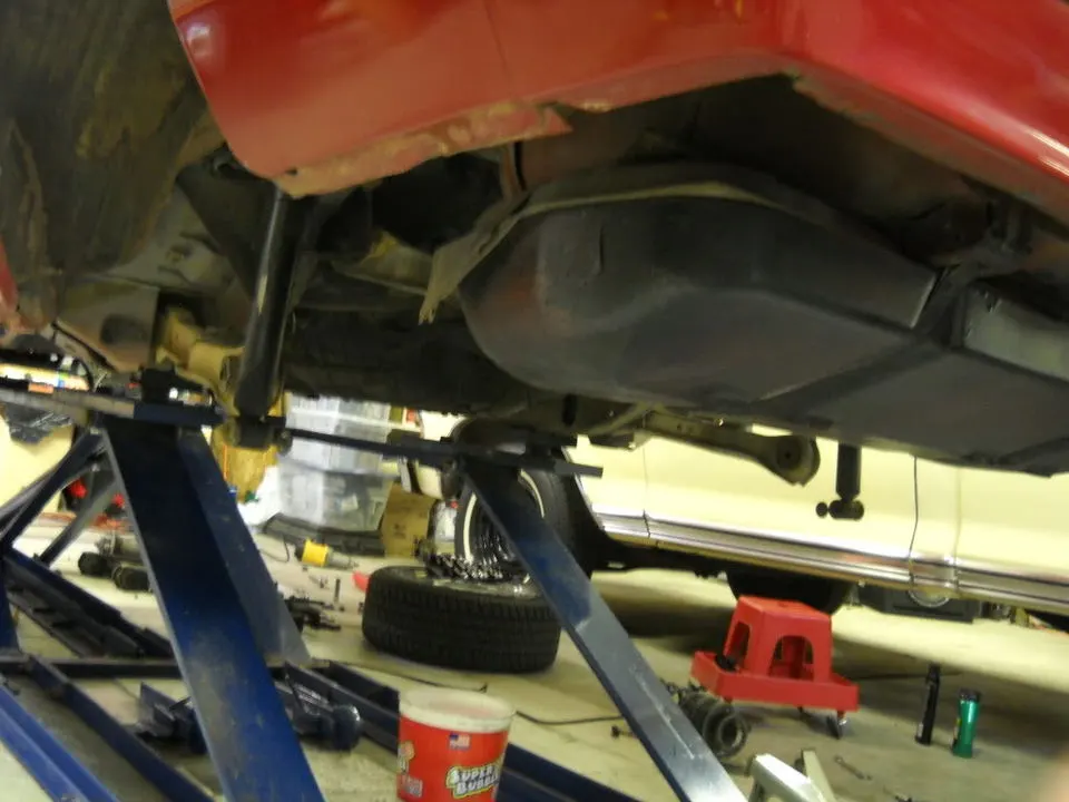

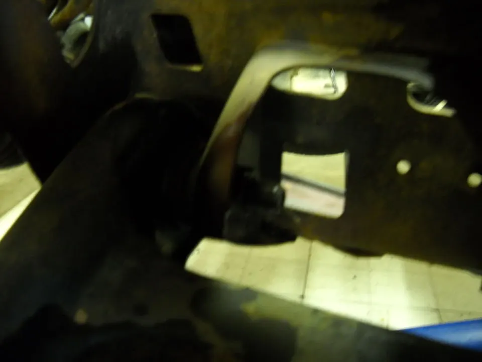

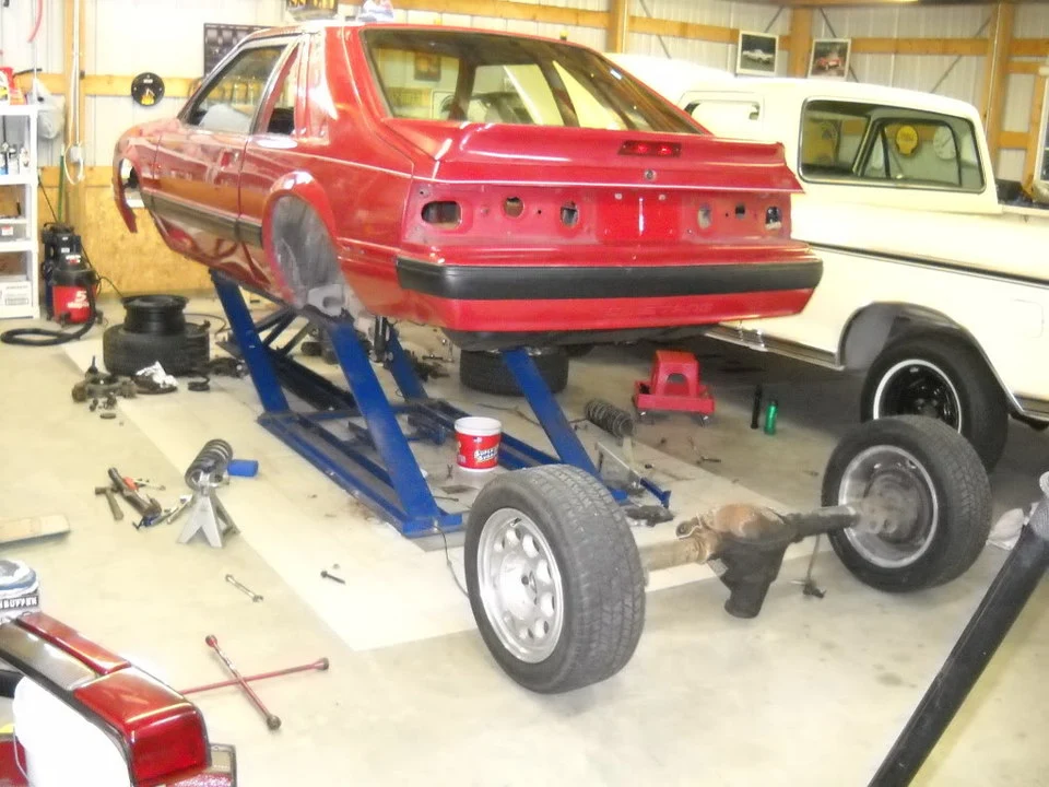

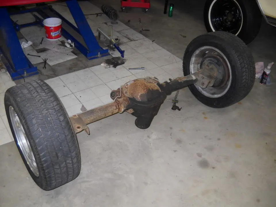

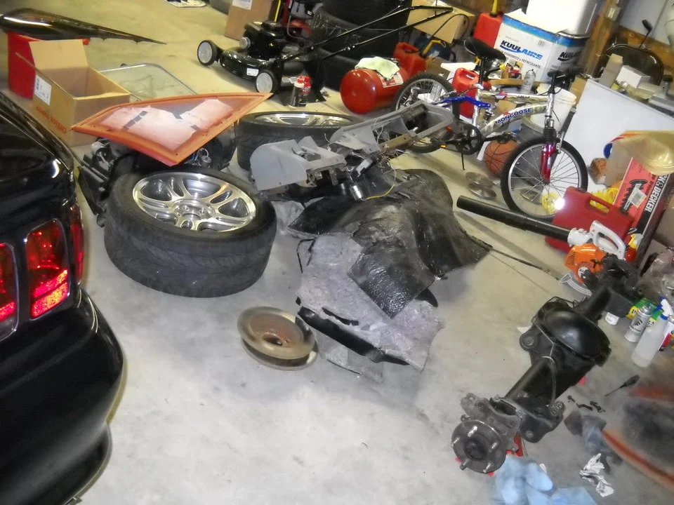

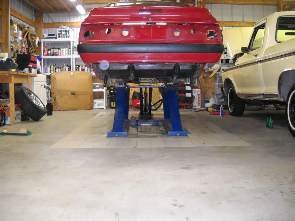

I got the rest of the crappy suspenion out today. This was my first time pulling a rear end out. The biggest problem I ran into was getting the E-brake cables out. They were a pain. Other than that, it was pretty easy.
I also pulled the other side of front stuff out.

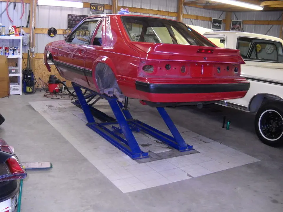

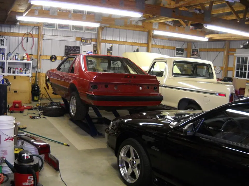

I then spent some time cleaning up the major mess I made. I love having that lift!

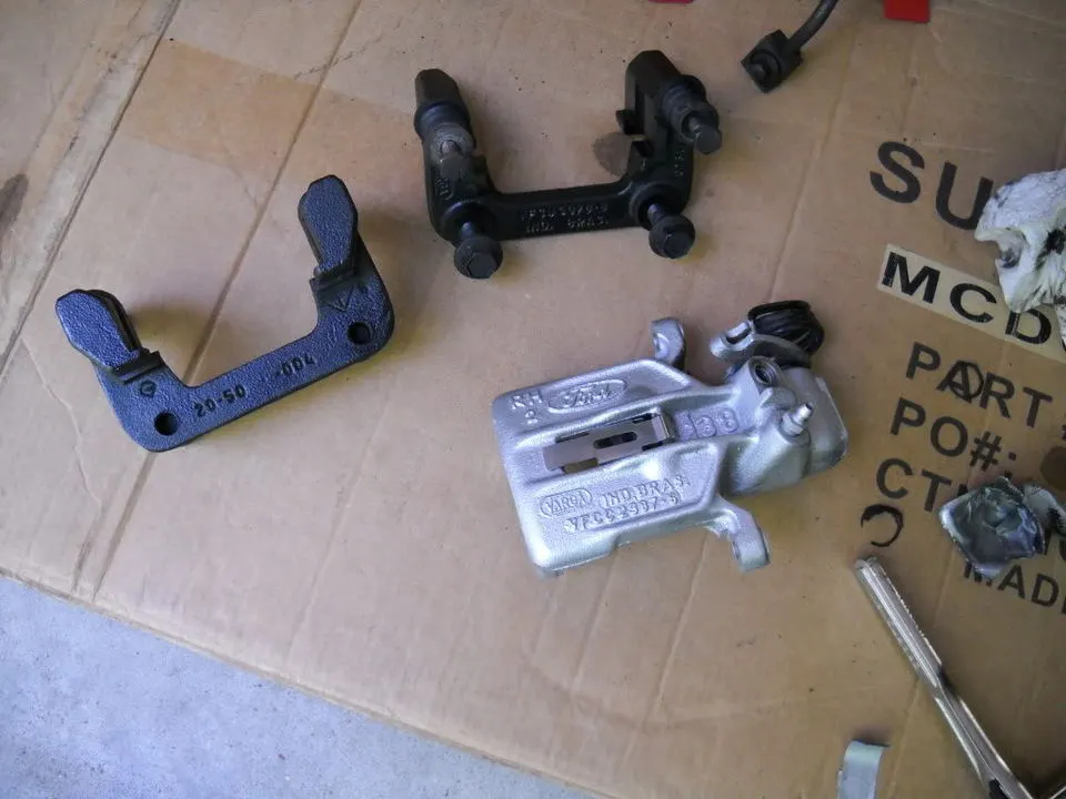

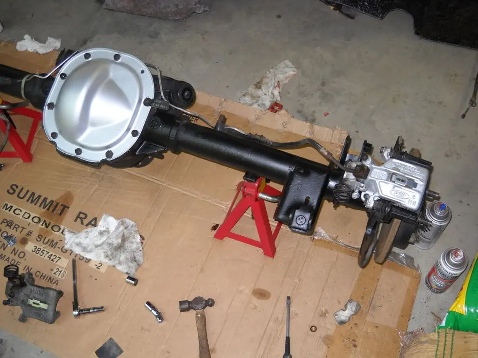

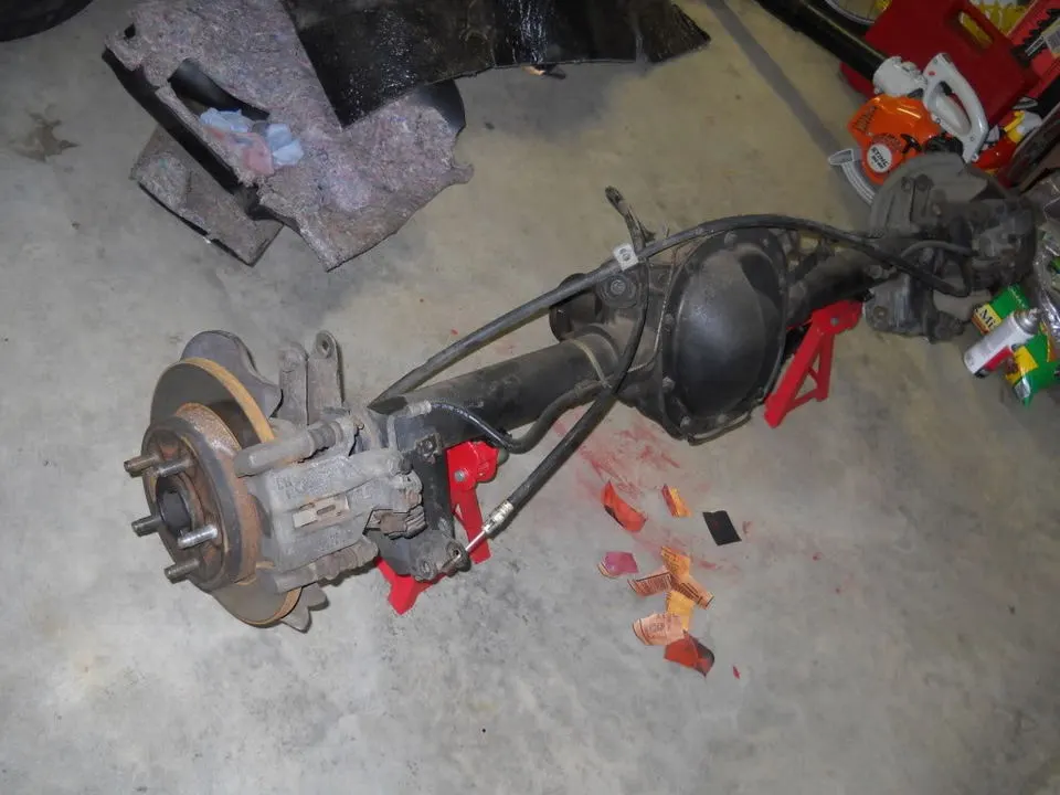

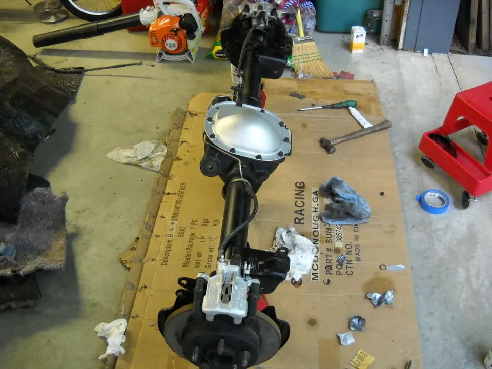

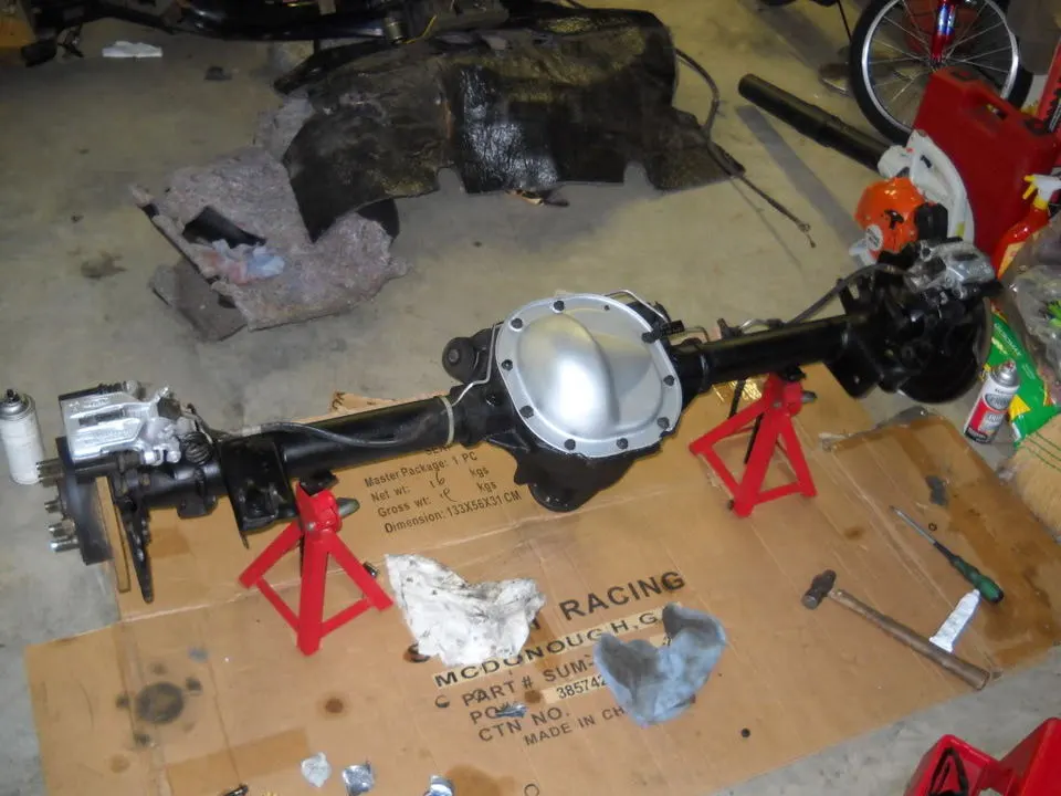

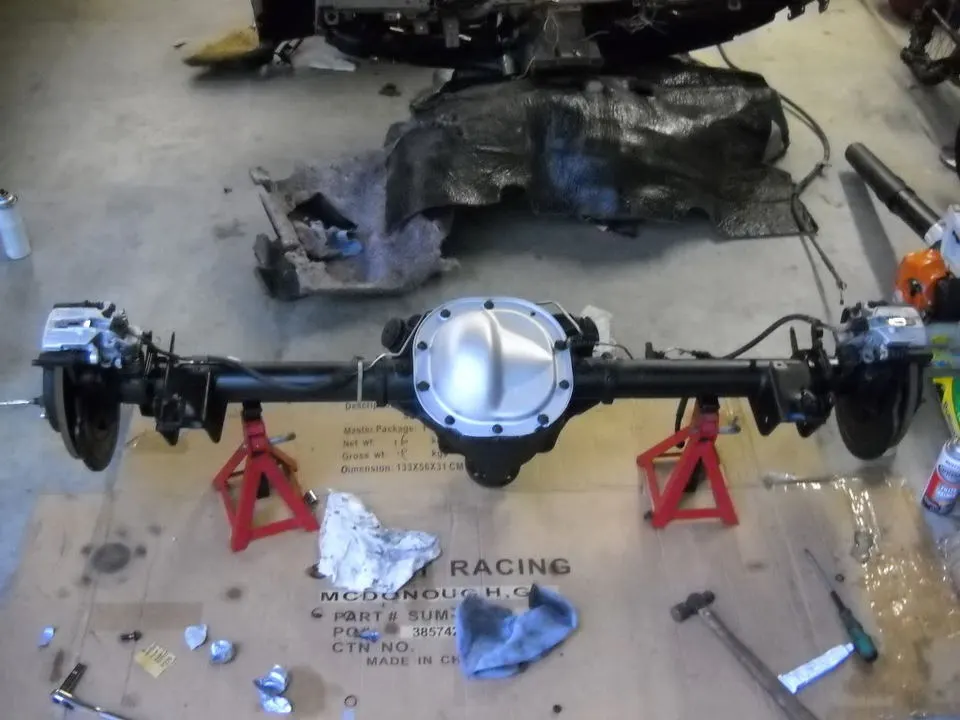

I spent most of the day on the rear end. I cleaned all of the parts and painted everything, and put everything back together.
Some of the parts after being painted up...
This caliper gave me hell. It apparently got stuck or something, and didnt want to compress all the way, I spent a few hours trying to get it to work, but I finally got it.
a few shots of the completed rear end...
