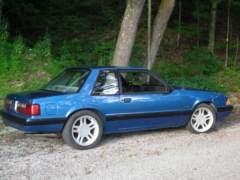

You are doing a great job on that rear end, but I'm with Mustang5l5 on it. Did you see it on your buddy's car with 17x8 wheels? If it is a 99-04 model, you may not be happy with the way it will look with those split 5 spoke wheels. The 99-04 rear ends move the wheels out over 1.25" further than the stock Fox rear end and axles. That will put the edge of the wheel about even with the outside of the rear wheel wells, and depending on your tires, you will need to roll the fenders and may still have some rubbing. I have a friend with a SVO rear end (and that is narrower than a 99-04) and he has 17x8 Cobra wheels. His rear end and wheels just look out of place IMO. Just something to keep in mind.
