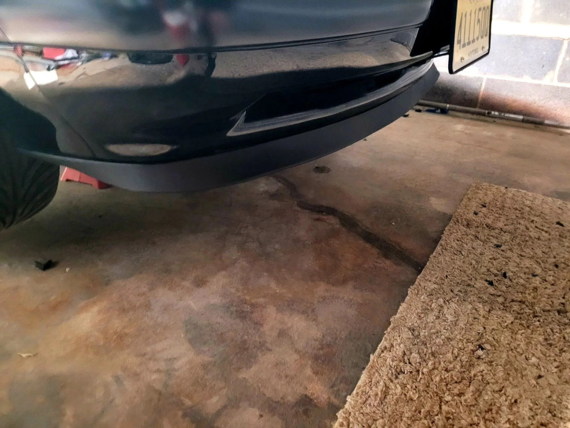

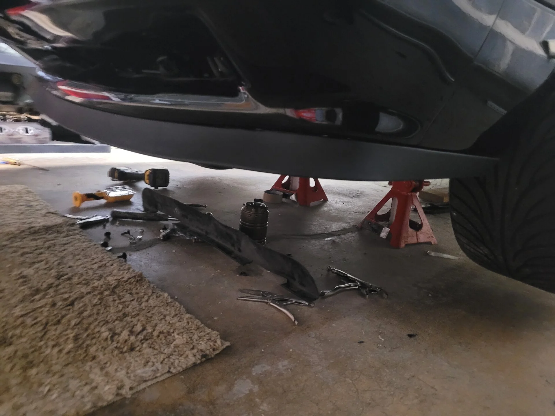

I've had this Mach 1 chin spoiler sitting in the box for over 3 years, wasn't thrilled about making it fit or drilling a bunch of holes under the nose. Well due to boredom from being stuck in the house due to hurricane Henri, today is the day it gets installed. Better pics when it's completed.

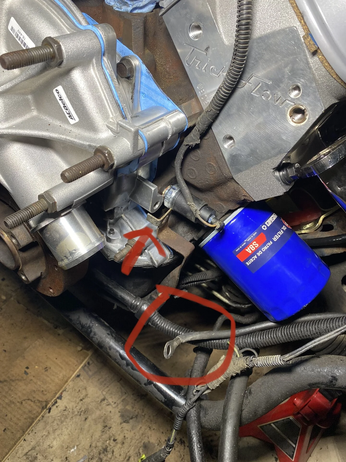

i am currently installing the same Trick flow top end kit on my 93 lx. This thread has been very helpful and i felt your pain with the vague TFS instructions. I’m at the point where i’m getting ready to install the accessories back on. I bagged and labeled the bolts but i did this months ago so my memory is failing me. There is an area on the bottom drivers side timing chain cover. Do you recall what bolts into it? The metal bracket looking thing in my picture along with the ground wire that comes off the fender by the battery? Does the power steering pump bolt into it along with the ground? Any help?

I believe it's just the two things on there, the bracket and the ground. Don't recall anything else
attaching there.
