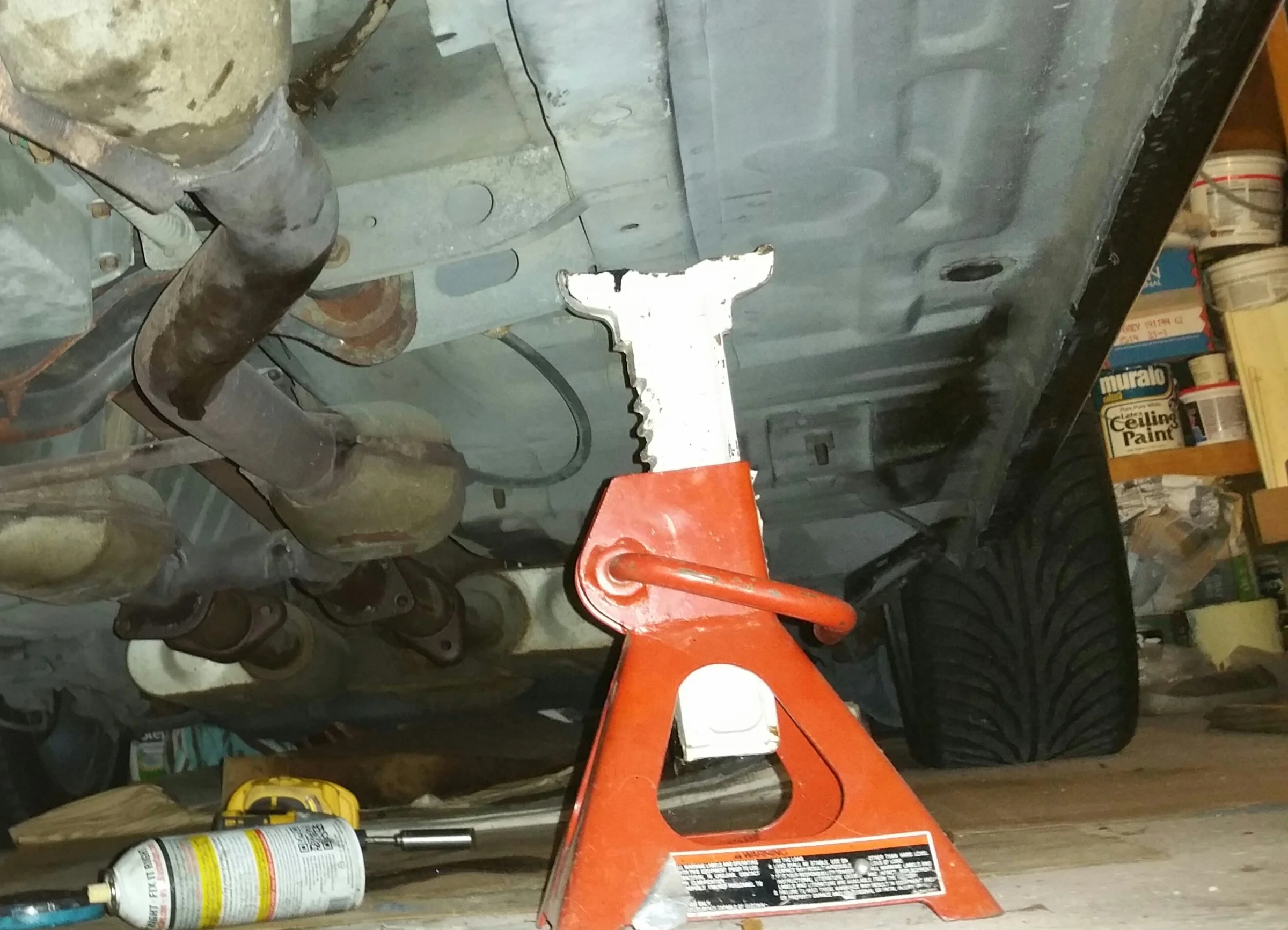

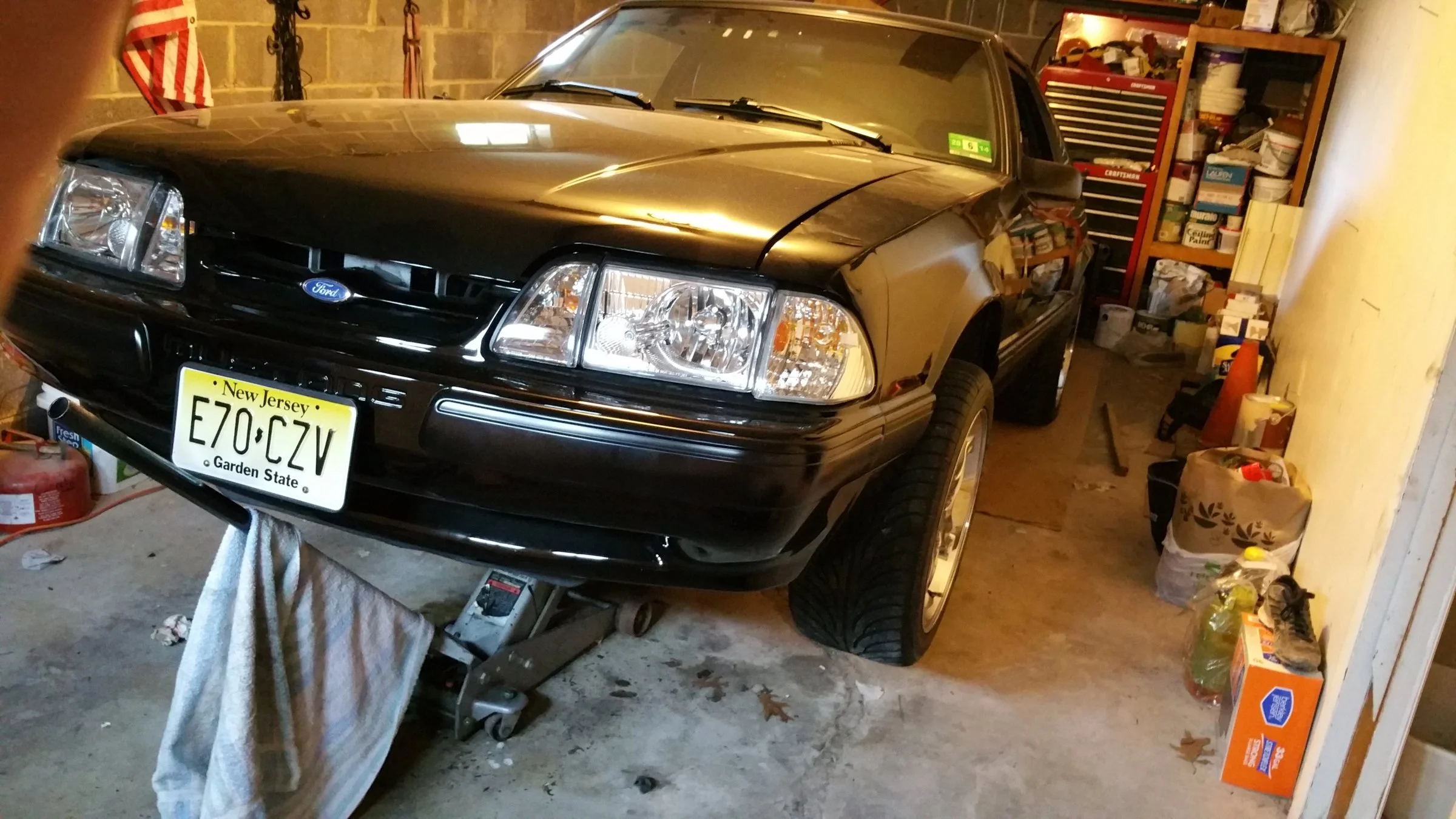

Yea I got more than one under there, actually that one aint even making contact, it's one of them just in case things,and the jack.Do yourself a favor and move that jack stand to under the kmember right behind the control arm. Will make for a more stable (and safer) setup and won't crush the wimpy factory frame rail.

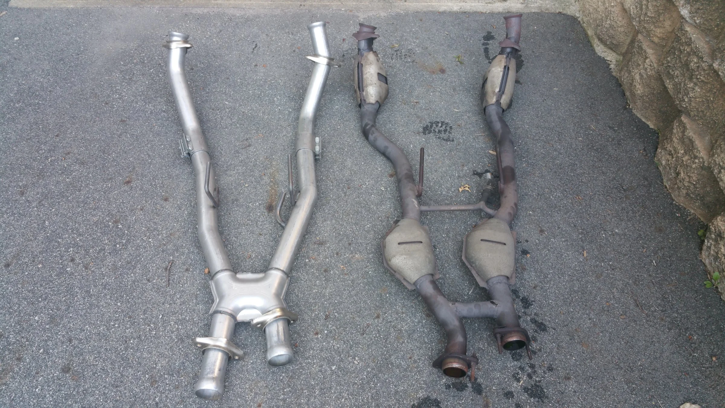

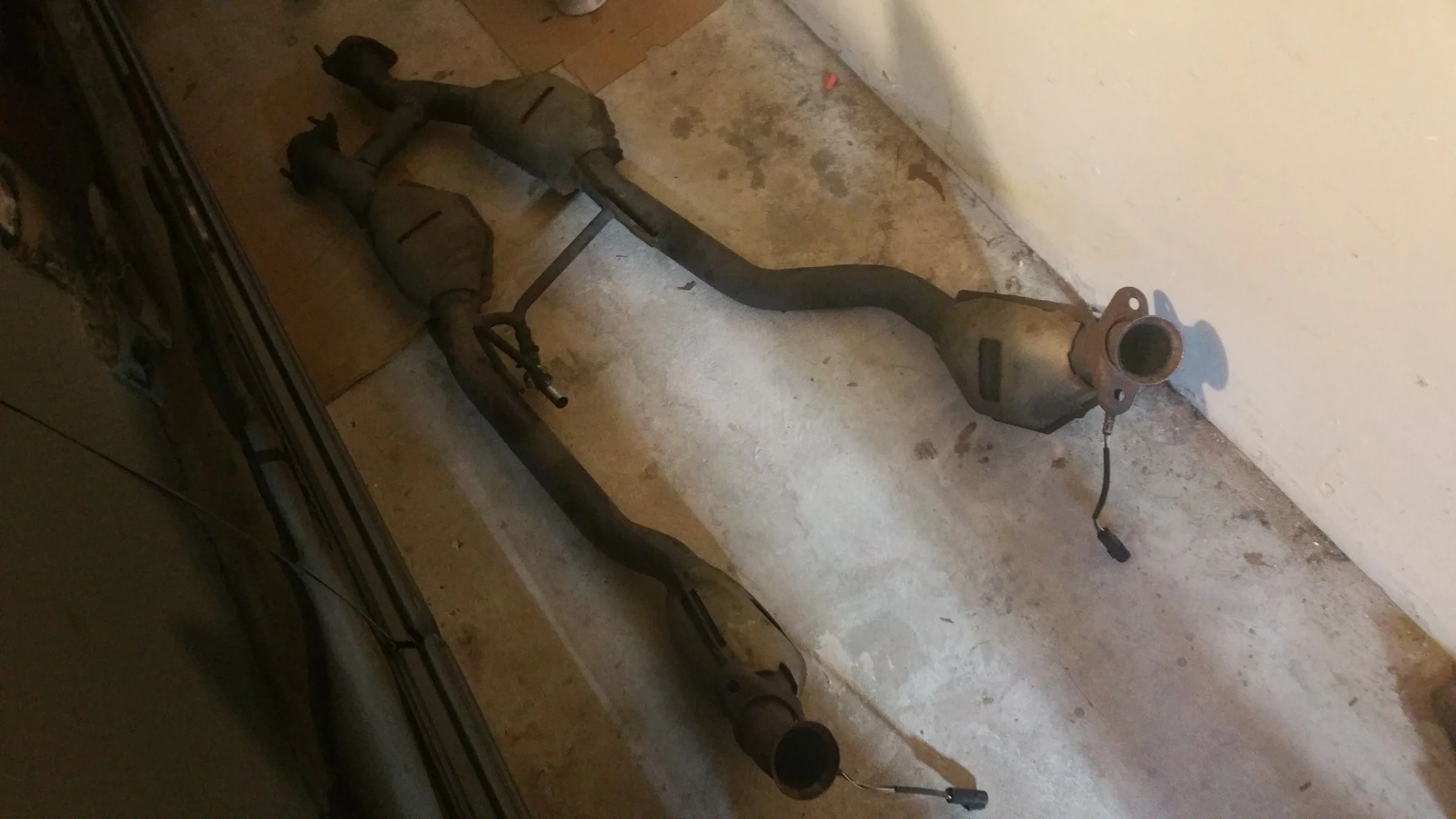

Your right it is in pretty good shape, I'll keep it around for as long as I can stand it taking up space hahaI would recommend hanging onto that h-pipe. It doesn't look very corroded at all.
These cars are nearly classics in their own right. They're already getting to the age that some need restoration, and factory parts have long been discontinued. You can just about built a factory-correct 1965-70 Mustang with only aftermarket parts, however, such is not yet the case for foxes. Until it is, it might be a good idea to start stockpiling any stock parts you come across.Your right it is in pretty good shape, I'll keep it around for as long as I can stand it taking up space haha

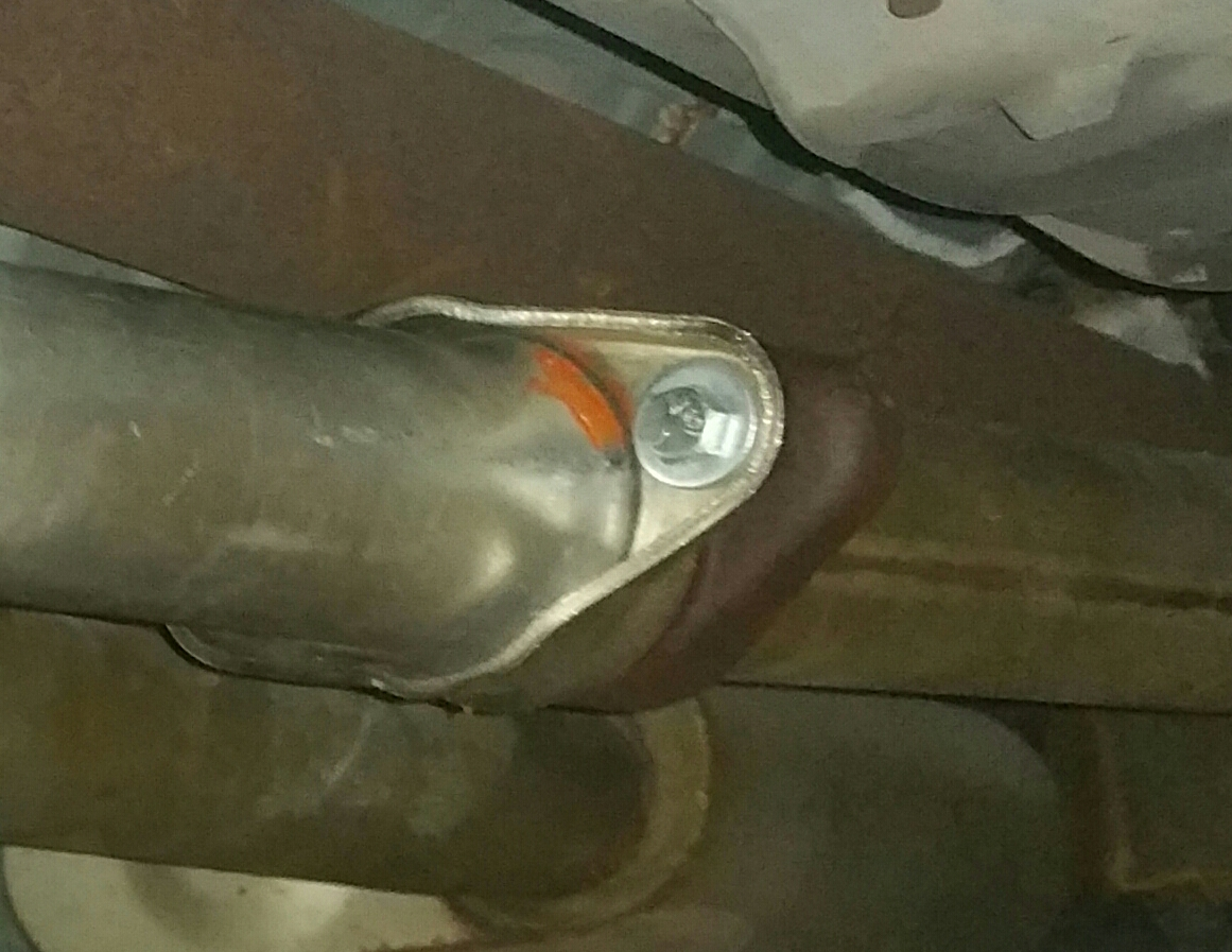

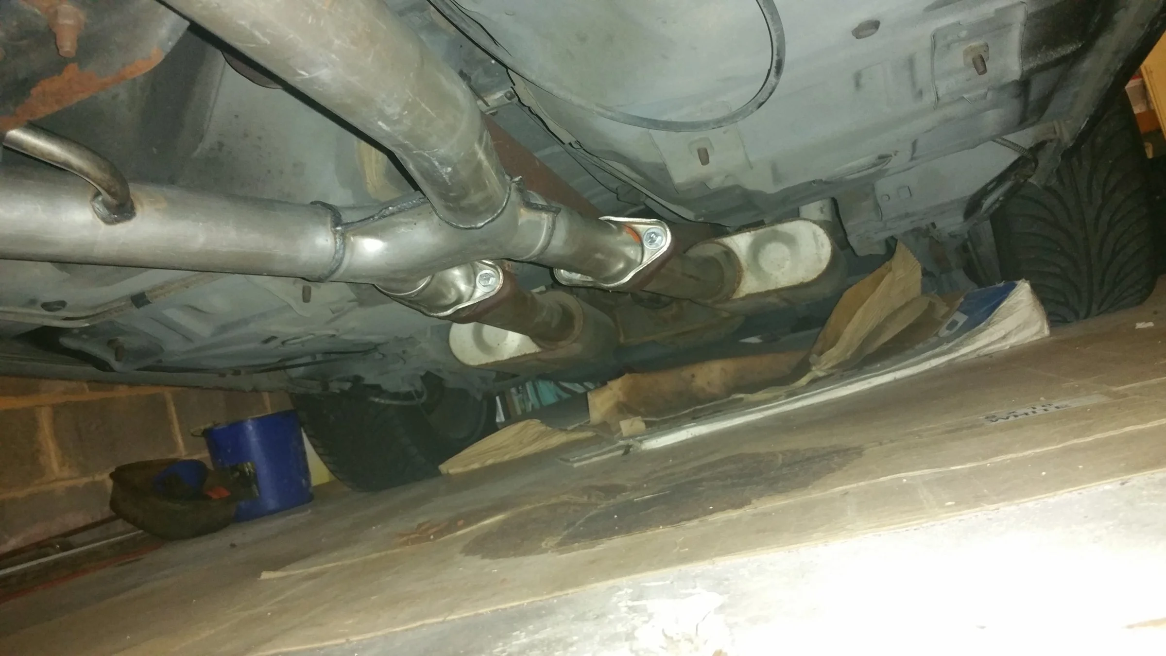

When you get the new battery in just take the car to an exhaust shop. For about $20 they'll get your exhaust lined up right. An exhaust shop had to shorten most of my hangers on my mid pipe and tails to get everything tucked up high and all ball sockets sealed up. They can do it way better and quicker on their lift than you will on your back.Looks like another delay, I managed to get the X pipe in, it wasn't so bad but I'm concerned about the joint between mufflers and x pipe, it has a really small flare on the mufflers but a huge one on the X , concerned it's gonna leak but I'll just have to wait and see, second problem is the stupid battery won't hold a charge and now is leaking, so tomorrow I'll get a new one and see if this journey is finally coming to an end.![]()
