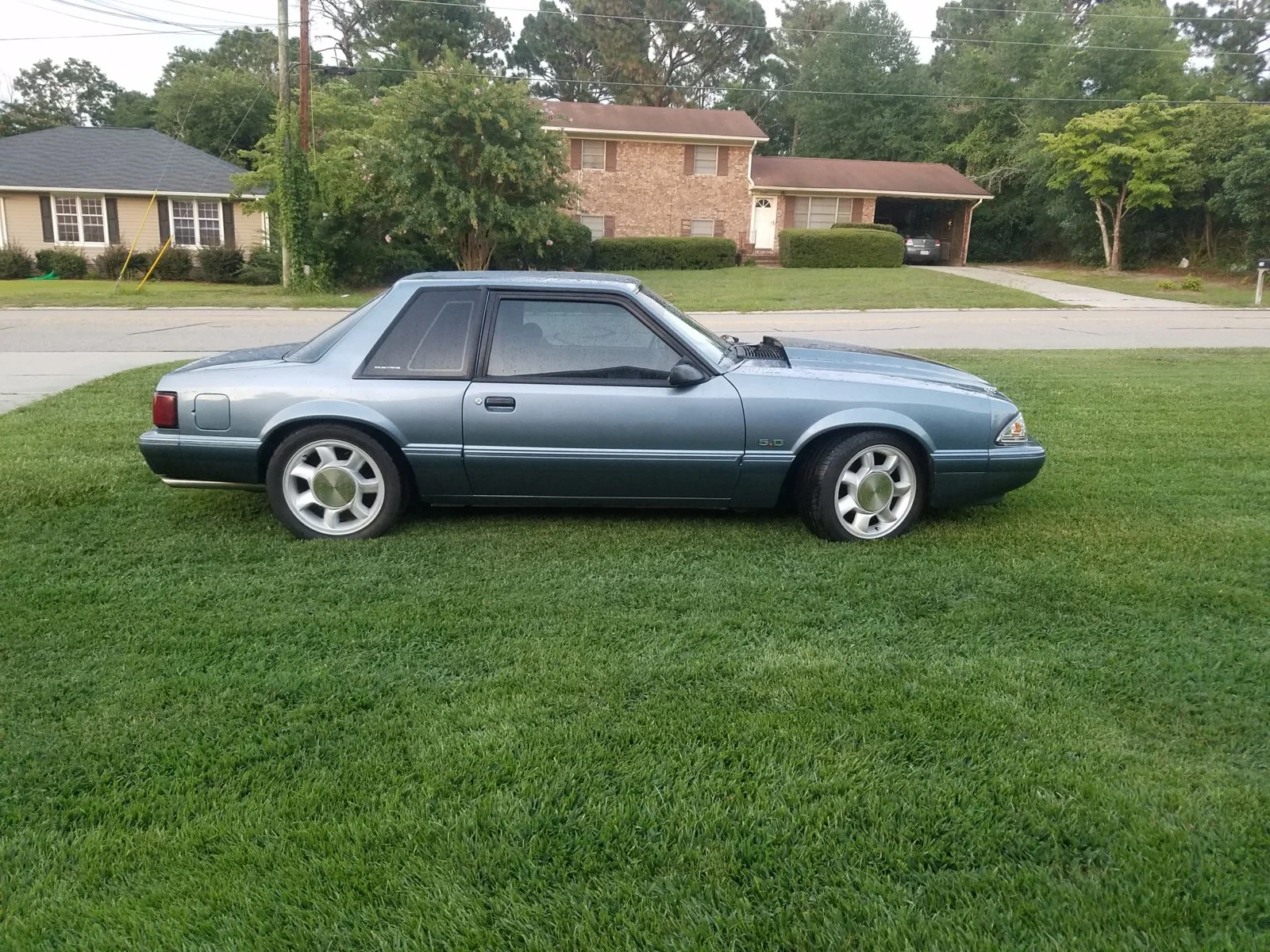

My 1st Mustang - the one that I always wanted..I almost bought a 1987 Brand new. I was just coming back from oversea's and test drove a Black 5 speed coupe. My finances weren't good at the time and a new family helped me pick a T-bird coupe instead.
So fast forward to last year. I saw this on face book Market and I decided I had waited long enough. I like very simple and clean.
so I'll let this go for now and try to fill in where I can.Here is a picture on the 1st day I saw it.
