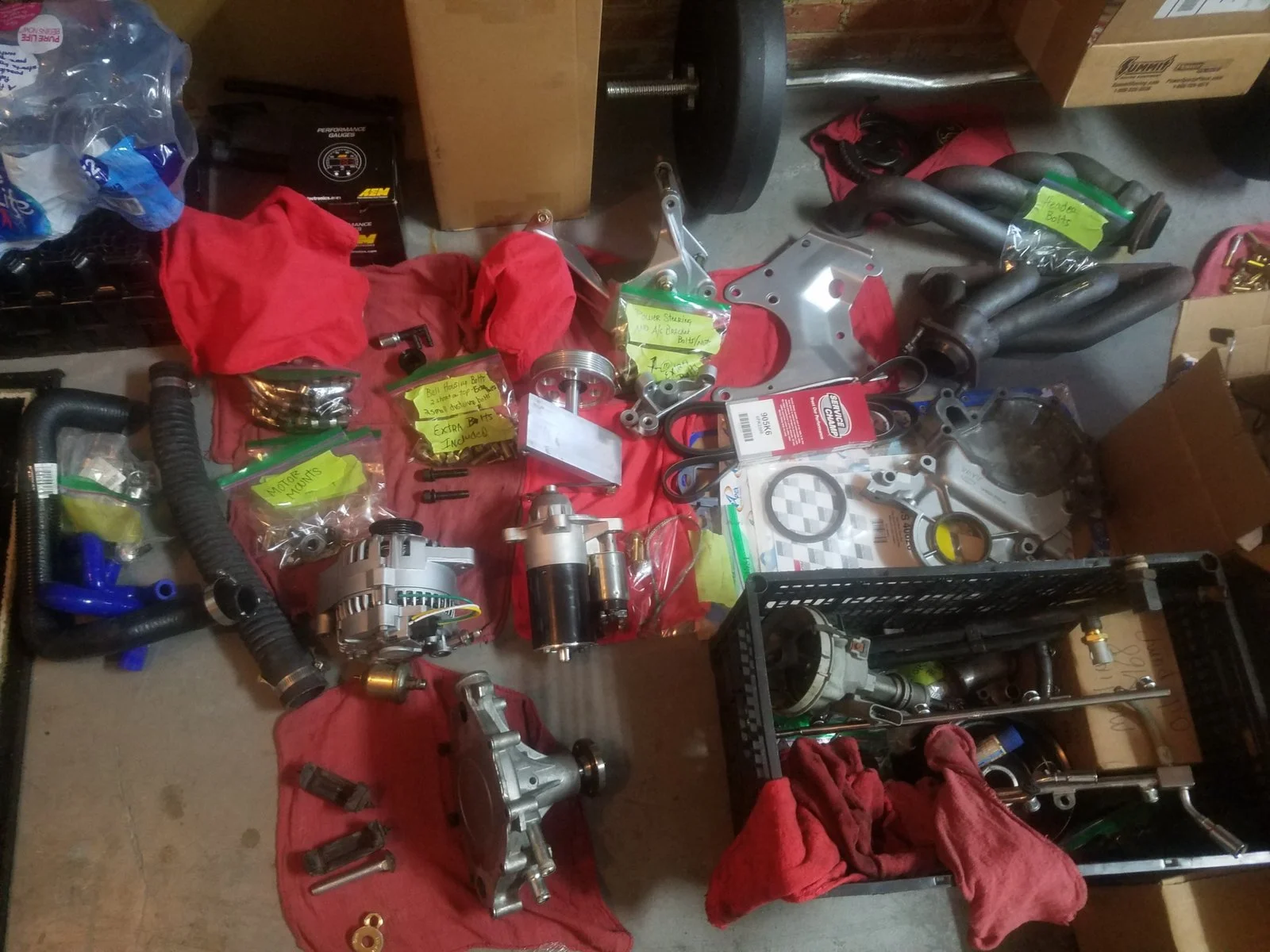

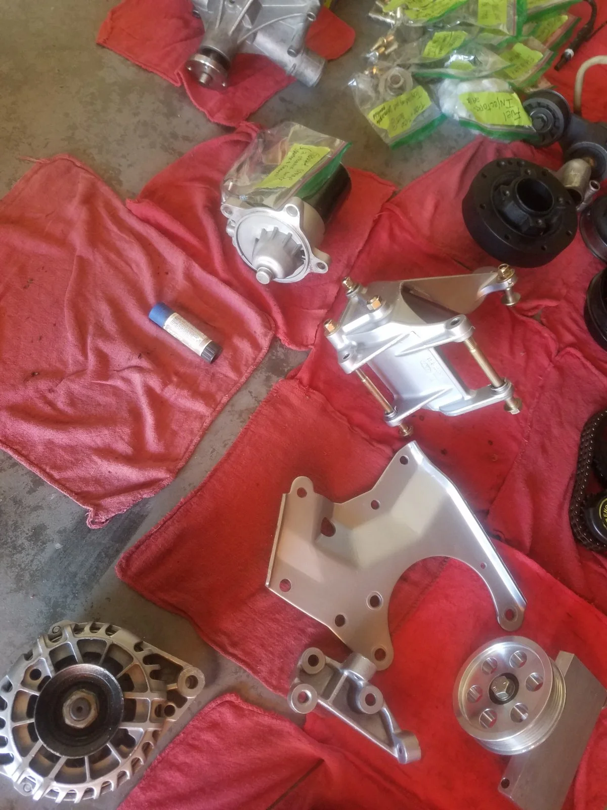

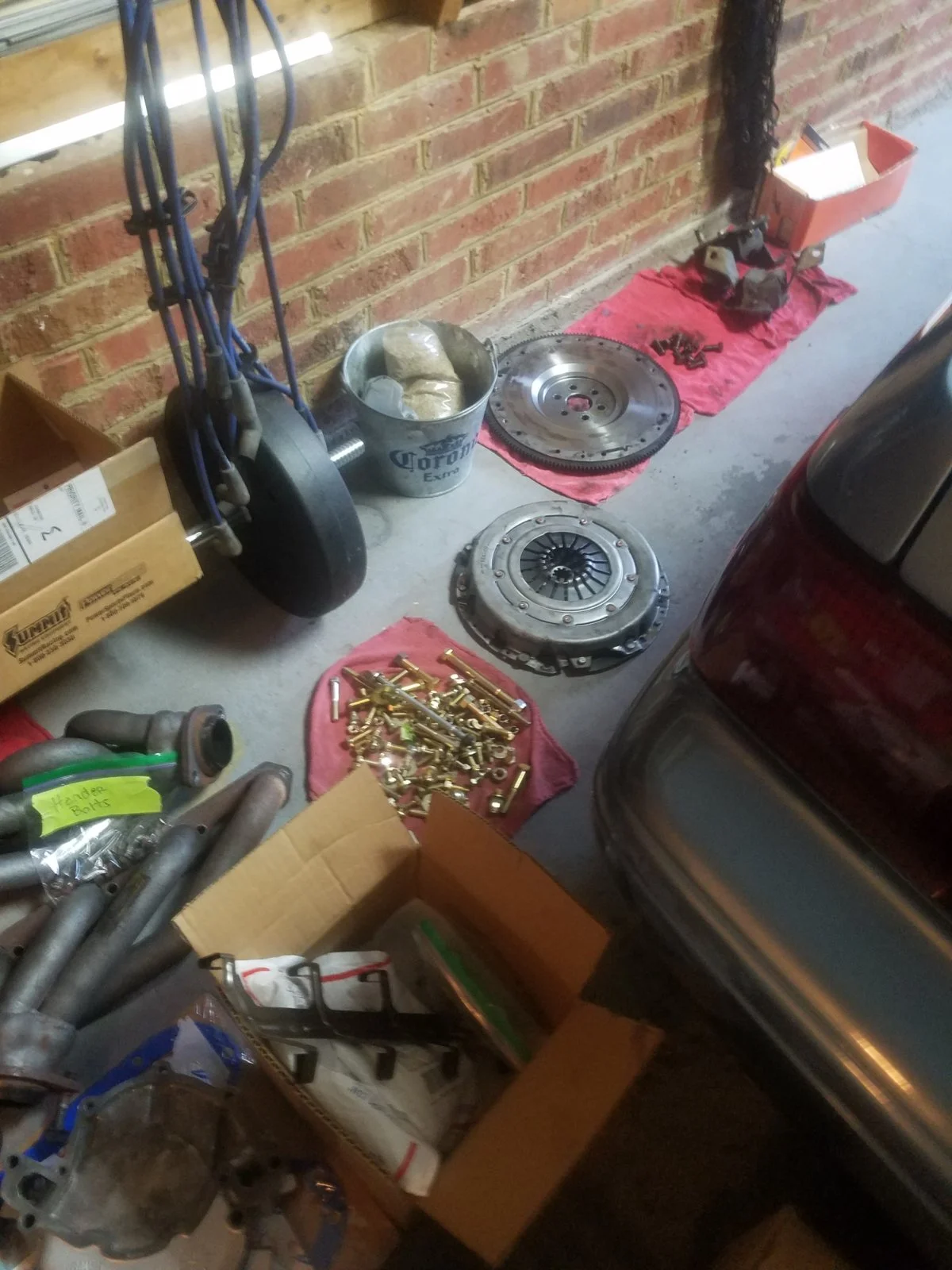

well I bit the bullet and called Summit. I ordered the
Trick flow top end kit.
EGR gasket and stud kit.
Trick flow Valve cover stud kit.
oil pan gasket
timing chain gasket set
Trick Flow roller lifters
This adds to what I already have on order:
melling oil pump - standard
water pump
alternator G6 and wiring
crank pulley
alternator-smog bracket
smog pump delete
smog pump small bracket
upper radiator hose
heater hoses to heater core kit
drive belt
fuel lines
MAF and injectors - 24 lb
cold air intake
starter
temp sensor
spark plugs
PCV valve and hoses-vacuum line
I did find the stock MAF wiring tucked in the fender
WHEW !!!
I took the money from the sale of the supercharger and applied it to this - so I really did not come out of pocket for much at all.
I cannot think of anything else that I need at this time.
Everything should be here by the end of next week - I Hope...

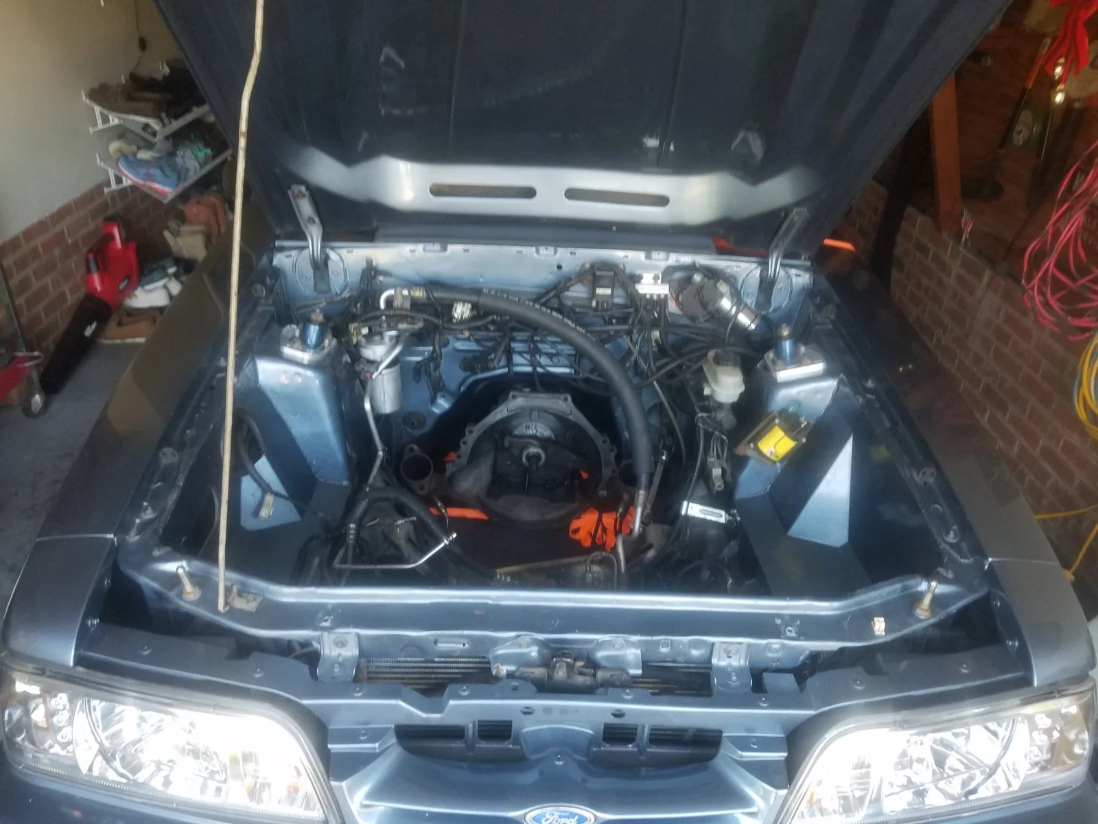

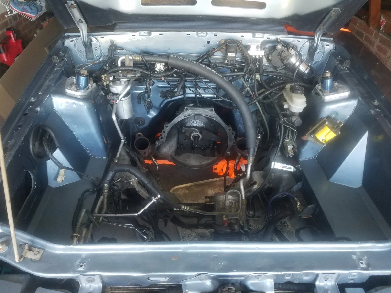

Here's where I'm at now. I pulled the motor and sent it to the machine shop. The cylinders do have a ridge at the top. Not bad but I think an overbore is needed. I am going to put forged pistons in.
