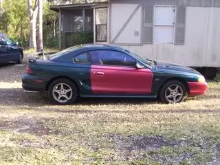

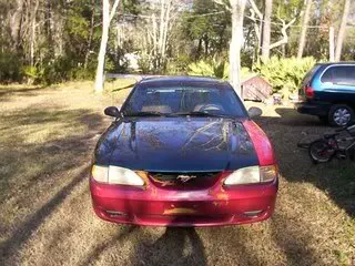

I just bought this car and figured I'd document my progress as it's in pretty rough shape. Most of the panels have some sort of damage on them, so I'll replace what I can and fix what I can't replace. I was going to do a 99 up body swap, but it's funner to spank all these newer cars with a 94, most don't really expect any kind of power potential from these cars! shame...
Anyway, I found it on craigs list and I paid 1600 bucks for it. Drove it home on it's hopeless wheels and tires, which I just replaced today with a set of 99 17" wheels and tires. What a difference! For the record, don't get any aftermarket design wheel unless it fits your hubs!!! The offset was horrid looking on the aftermarket "Eagle" rims and they were just plain ugly.
The car is about 3 different colors, it runs really well and shifts perfectly. But I can't STAND AODE cars so I'm about to convert it to 5 speed. The trans was rebuilt supposedly recently and the previous owner claimed that he had a few mods done. It does feel like it shifts alot more crisp than my previous slush box 'stangs.
Interior will be changed to black over time because I don't like tan, as most don't. I'll be dying pretty much everything and swapping in real black parts as money and availability allows.
For the most part, it seems to be a good investment, no rust or damage underneath at all. Everything is completely stock except for two Flowmasters welded into the stock system. The cats were also gutted out by the previous owner, sounds ok, but an O/R H and headers are in the works.
So, without further adieu, here's some pictures. Please don't laugh too hard, I think it has potential!

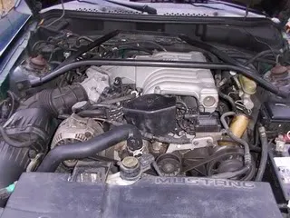

bone stock engine, even has orginal, labeled "1994" plug wires. I did pull the silencer, but I'll be fabbing my own CAI using parts I had left from my 95.

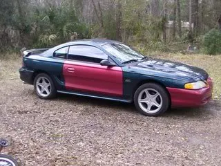

and with the new wheels:
That's it for now, I've only had it 2 and a half weeks! I still have some charging bugs to work out, but other than that it's coming along nice.

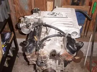

Still haven't gotten to the interior, but I went and picked this up on Friday:
It's an early 97 non "P" Exploder motor.
I'm gonna freshen it up some by changing the bearings and gaskets, maybe throwing some new rings in there and some minor port work on the heads. Hopefully I'll have a noticeable improvement in power with this motor. I'm also going to go with a Steeda #19 cam. I wonder if I'll need new springs to use that cam?
Does anyone know if a comp. valve job is really worth it for heads like these?

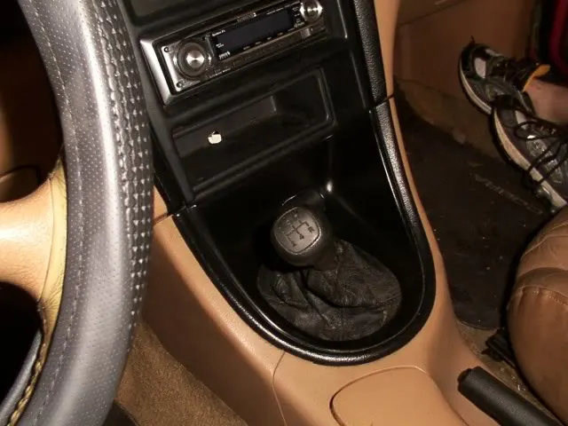

I've completed a 5 speed conversion. I also added a set of BBK shorties and offroad H pipe to the mix.
