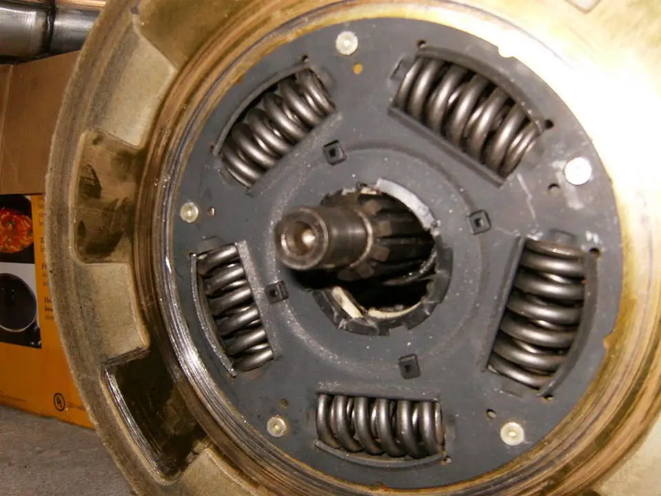

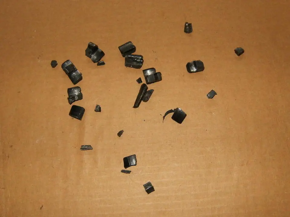

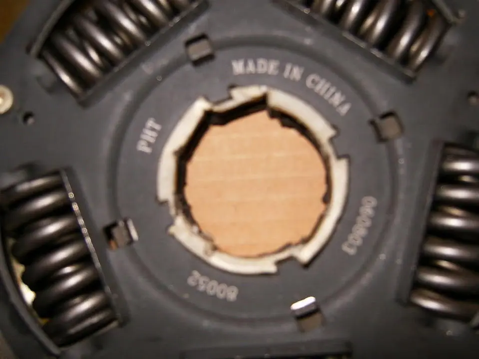

Have you ever heard of anyone breaking (obliterating) their clutch disk splines? Check this out. This happened a couple days after my first trip to the local track after my mods. I was driving down the highway and it let go. I replaced this POS with a McLoed.
There are supposed to be mating splines!!!
Made in China!!
