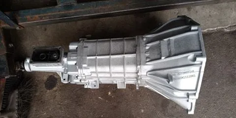

We just rebuilt a 3650 and the customer put it in, all the fwd gears are fine but it won't go into reverse... and ideas of what could have happened? How do we remedy this? Are we going to have to open it back up or can it be fixed while installed? Thanks
What's a joke about it. We are a reputable transmission rebuilding shop, but I am not the builder, I am the social media marketer and GM. So with that said, I haven't the slightest clue of what's going on in it. It all went together nice, It shifted when tested, but somewhere between leaving the shop and the customer installing it, the reverse isn't working....
