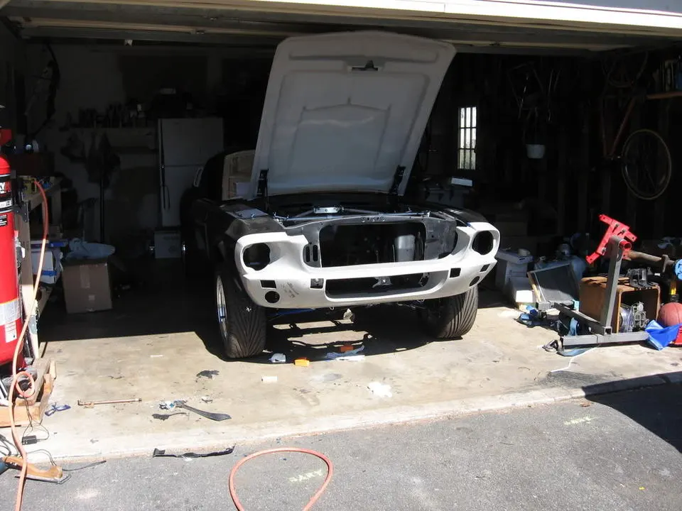

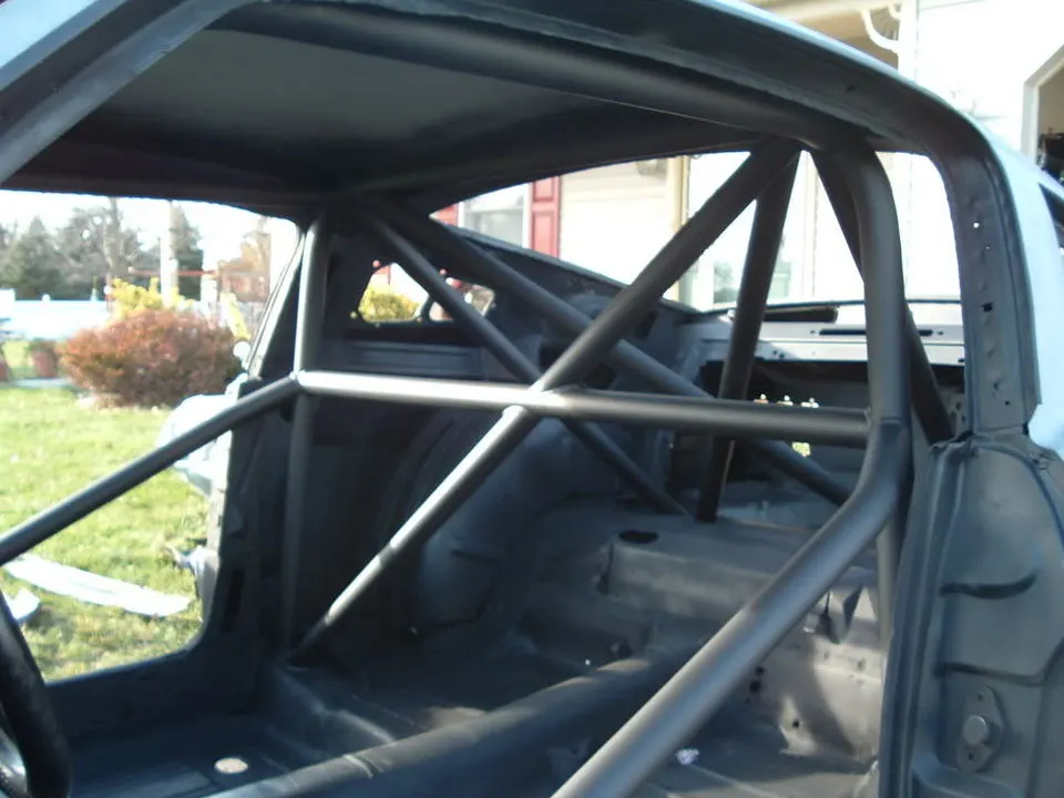

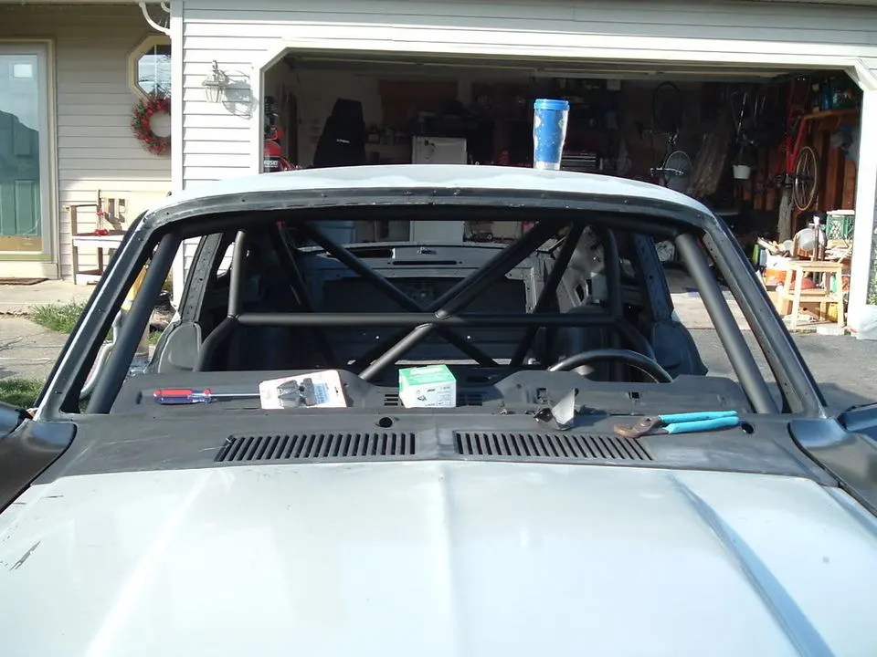

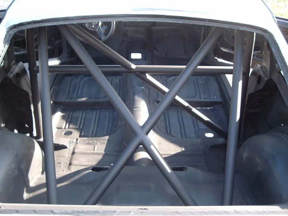

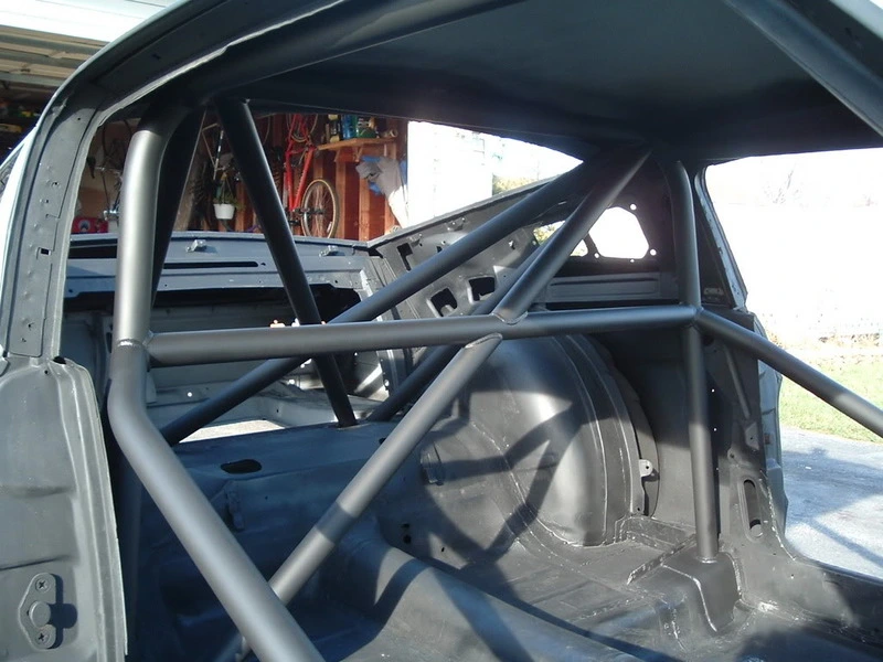

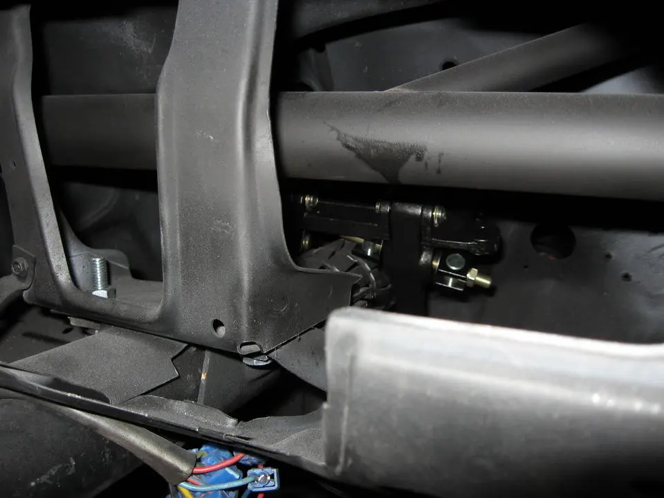

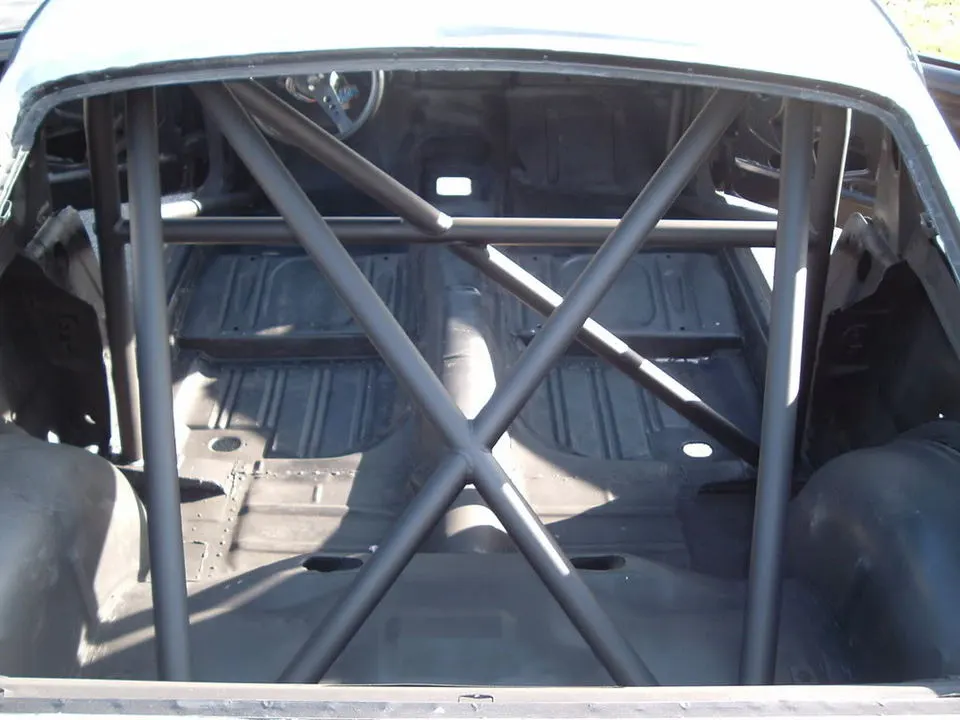

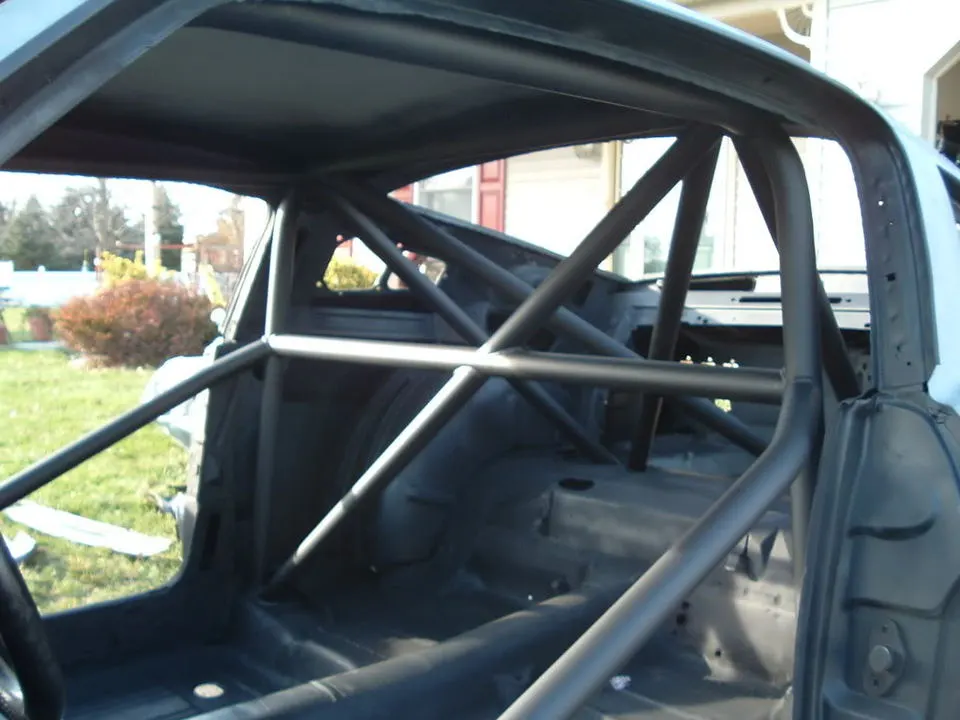

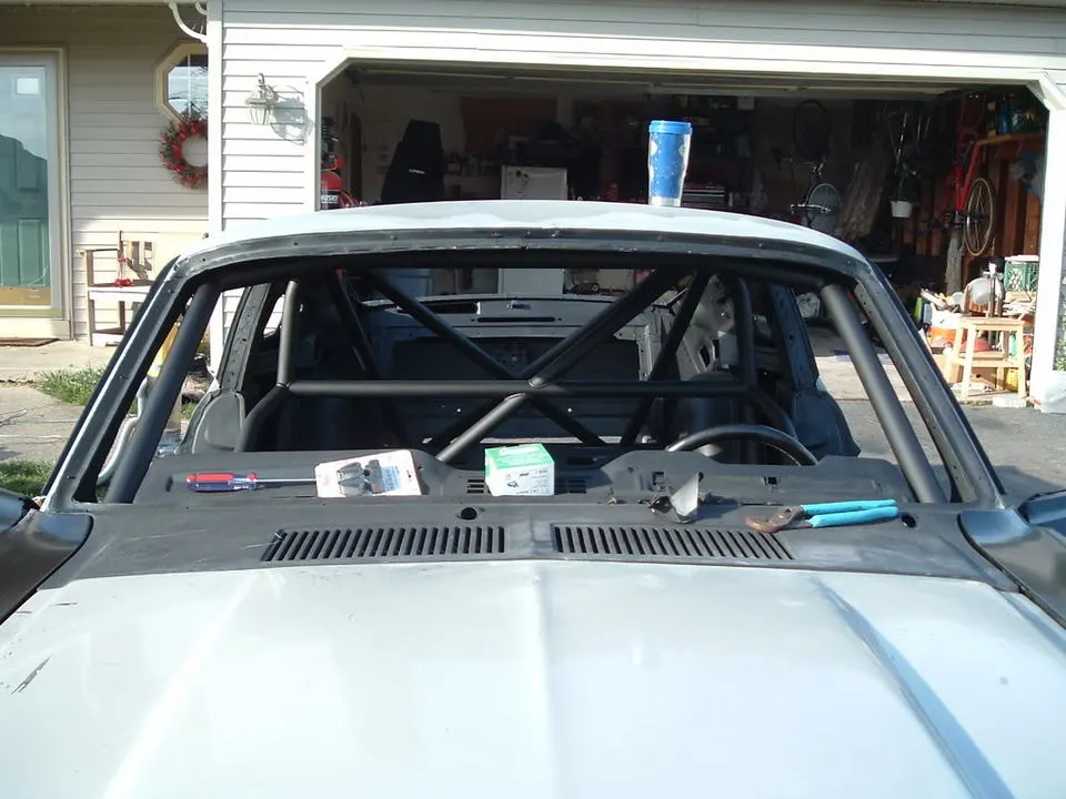

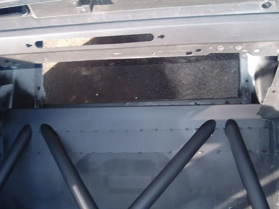

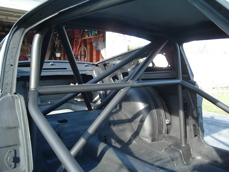

Just finished painting the roll cage, and talking with Chepsk8, about future possilblities with the car. Here are some pictures of the cage painted.
Thank god for the nice weather, i can push it out side a clean in the garage.

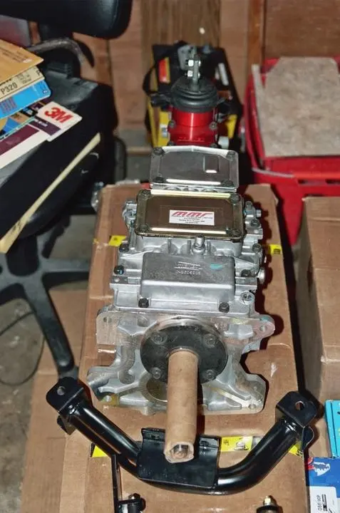

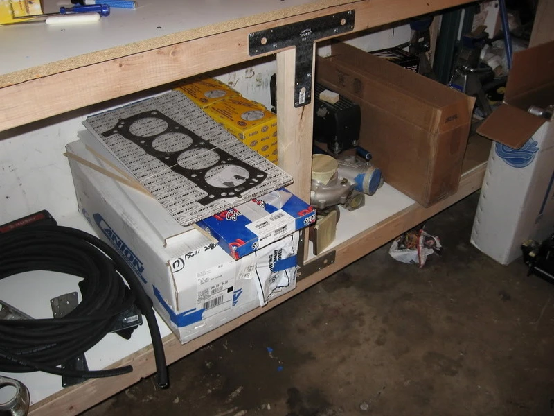

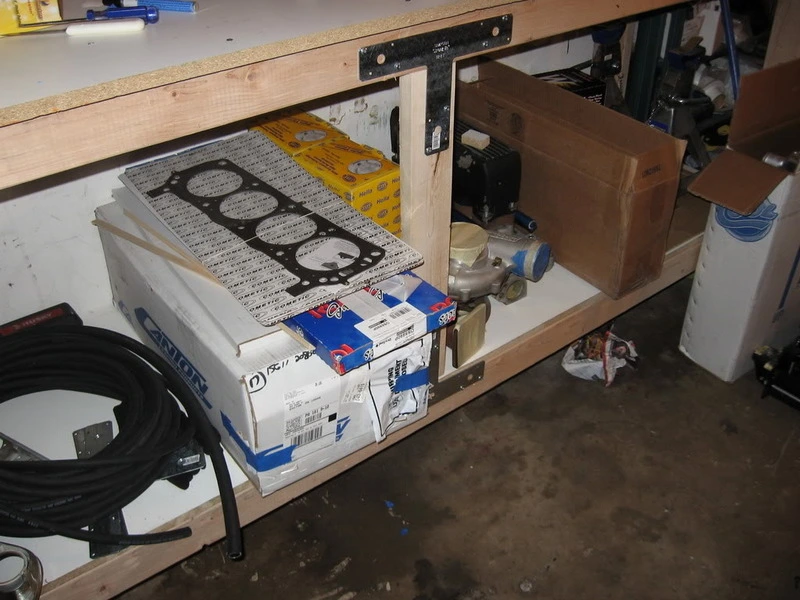

Here are some pictures of the parts SLOWLY trickling in... I must say it does suck waiting on one thing to get your motor together.

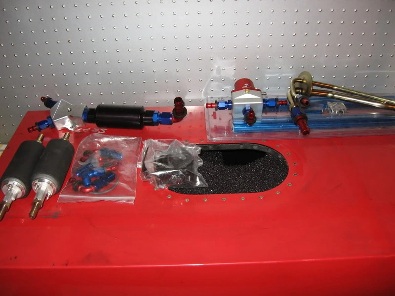

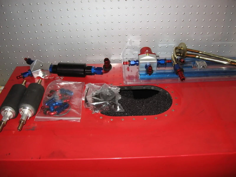

Here is parts of a MMR 900 Fuel system, and a used ATL 22 Gallon cell.
One 83 lb. low Ohm FI.

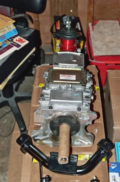

MMR TKO 900 with Tranny Bracket and Hyrdaulic Clutch Bracket.

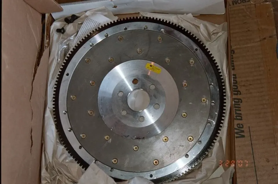

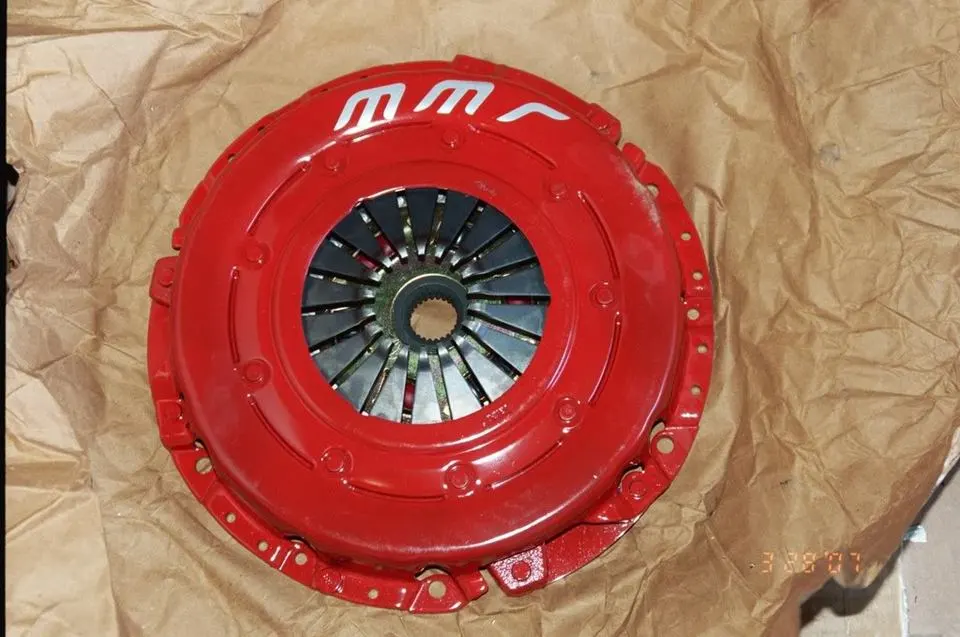

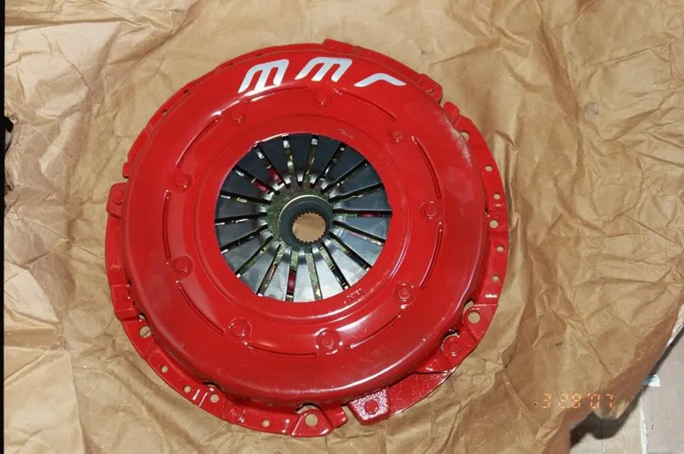

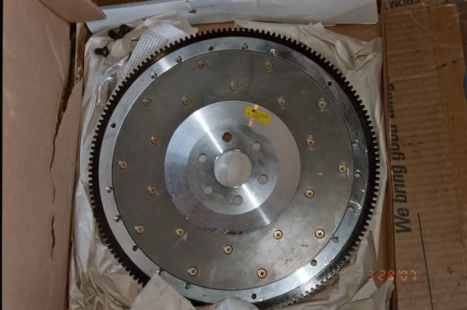

MMR 700 Clutch, and Aluminium Flywheel.
Caton 7 qt. Oil Pan, windage tray, misc Gaskets, Cometic MLS Head Gaskets, Fuel lines, 4 Hella H4 Lights for HID conversion, Downs Intake, Percision T76, and Shelby Tail Lights in the long box.

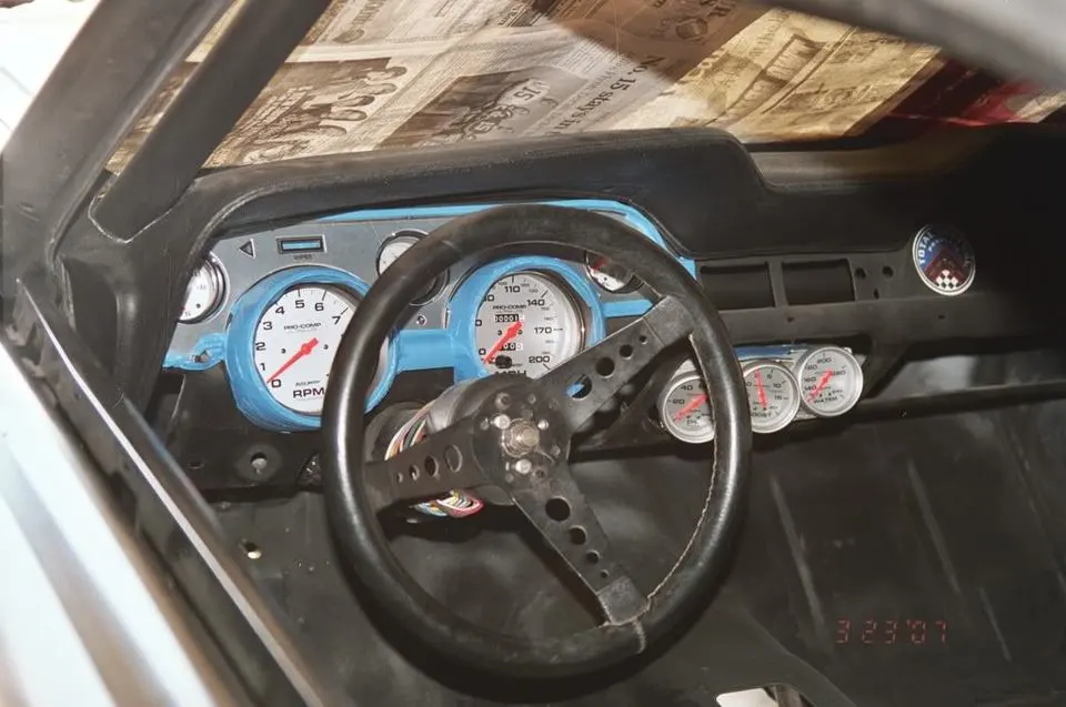

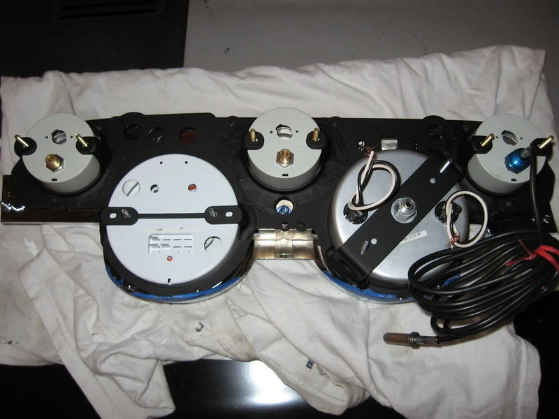

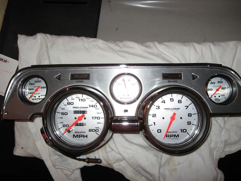

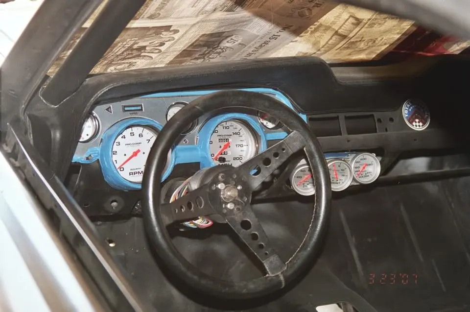

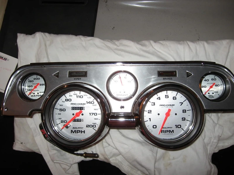

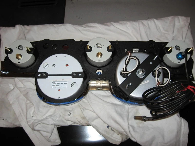

Just Curious, and seeing how much room I have to work with mounting the other guages.

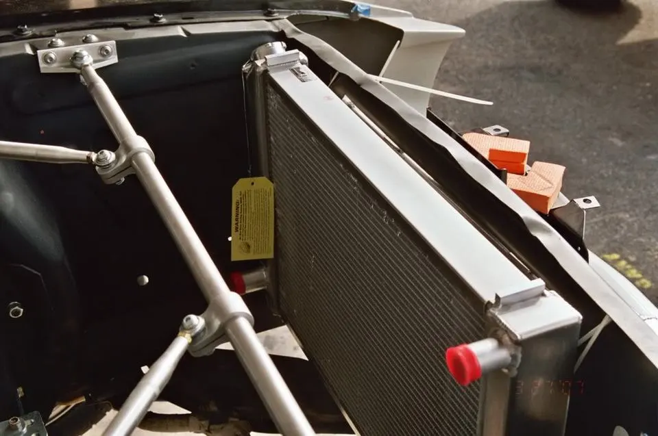

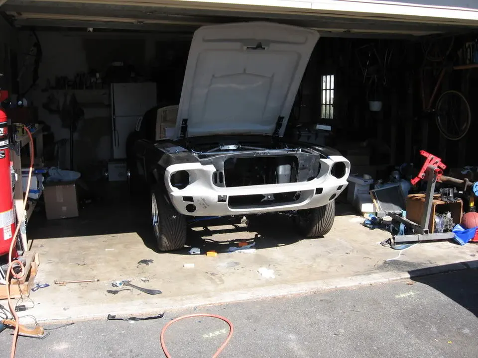

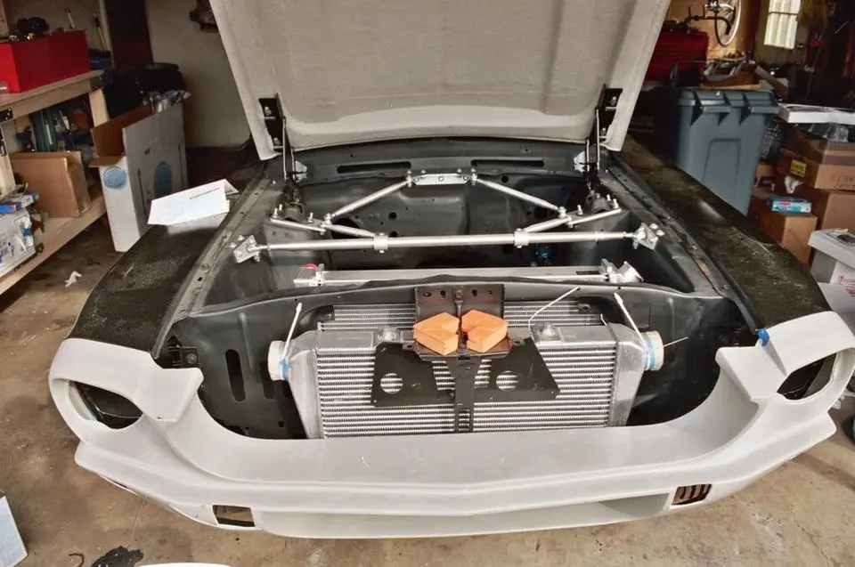

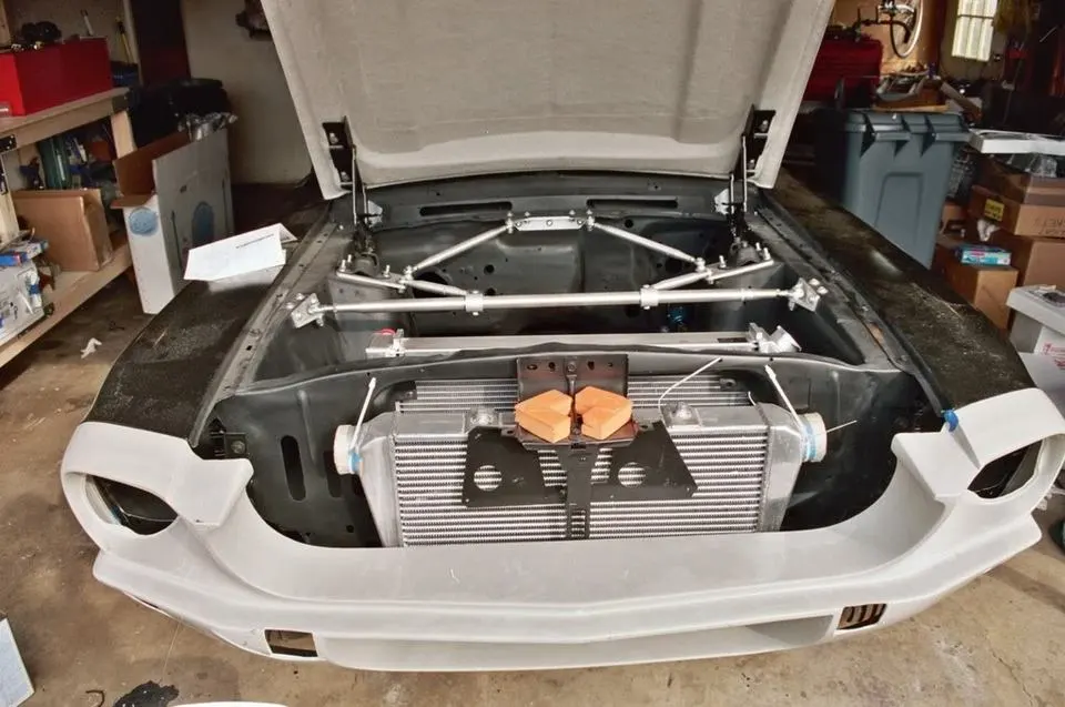

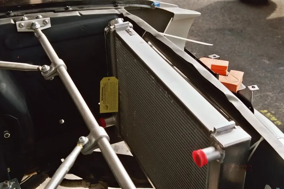

Just before starting to modify the Rad Support.
Modifying the rad support. Making the opening larger and getting rid of the inward lip/mounting points to move the radiator closer, and give the turbo mounting area more room.

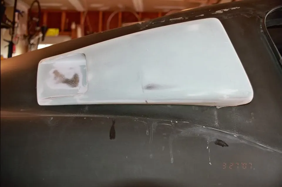

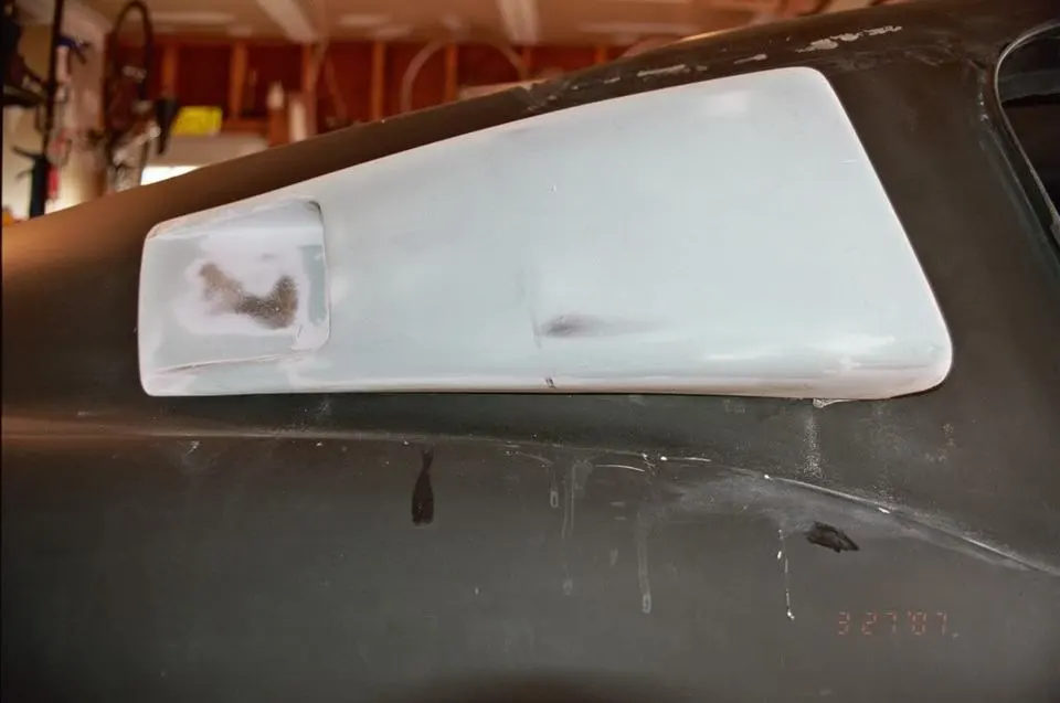

I had to cut the scoop inhalf and reattach it to get it to sit flush... you can see the mark at the bottom. The scoops are not yet finished.
Hopefully with in a week and a half the motor will be buttoned up, and I can bring it back, from my friends with the EMS and start the Turbo mock up and really get the car moving. The goal is to have it moving under its own power by mid summer.

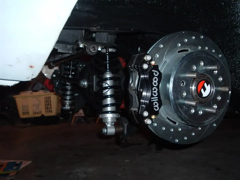

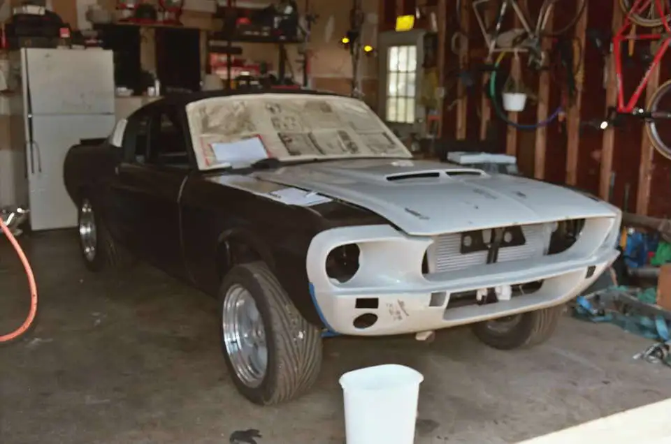

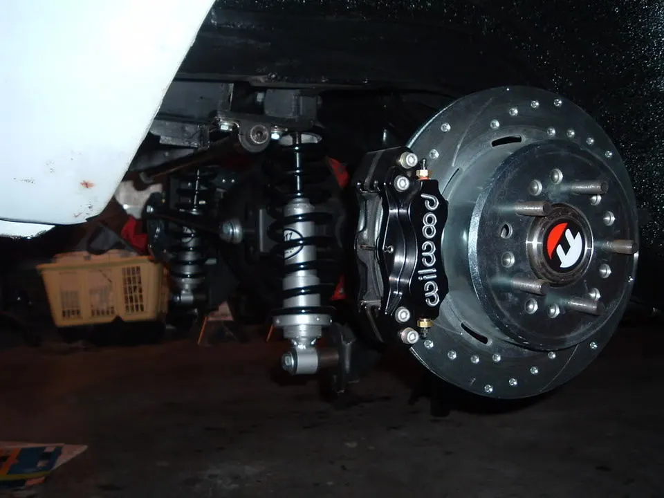

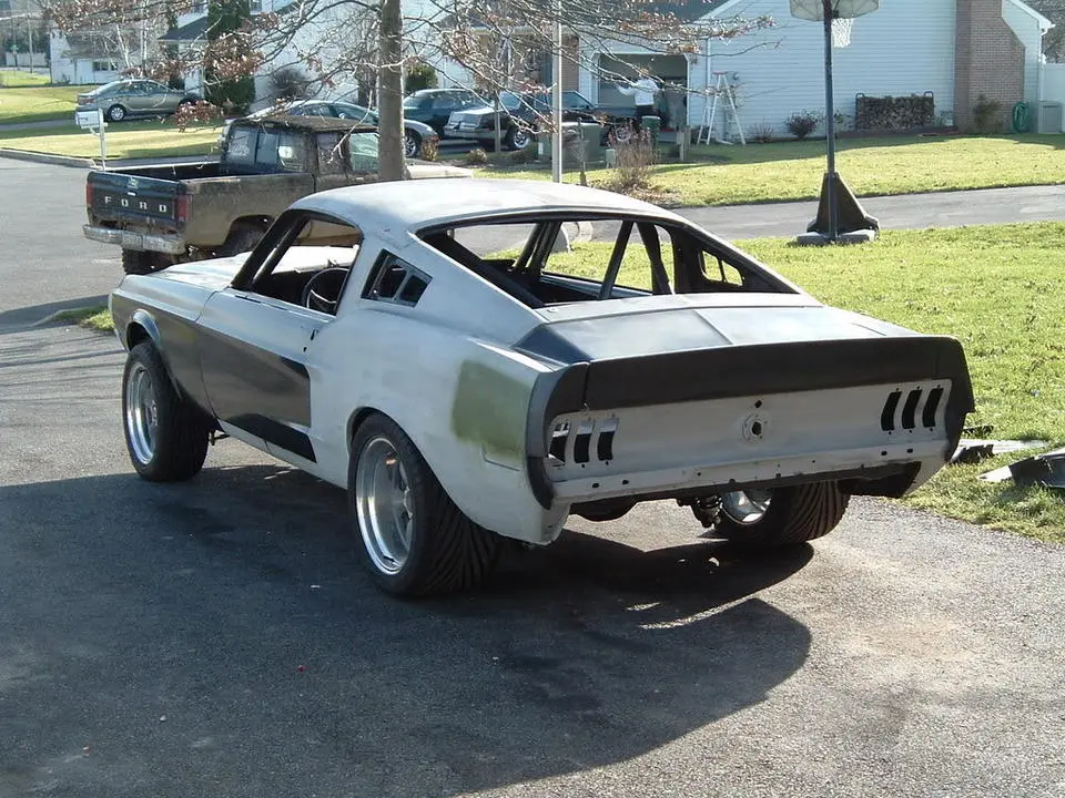

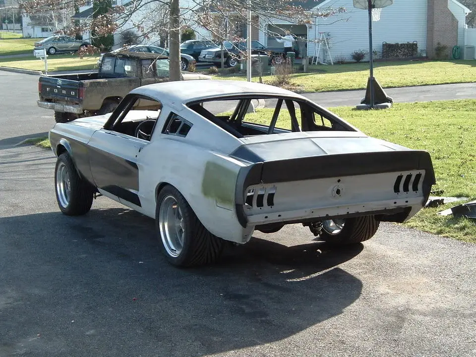

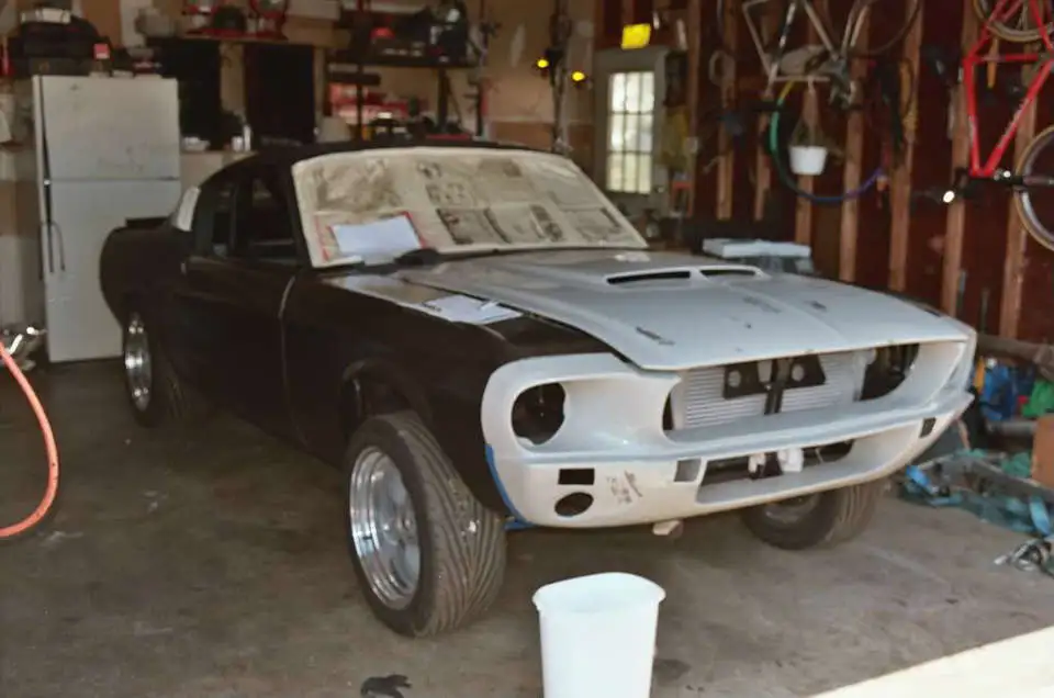

Yeah they are 315 35 17's, and the inner fender well is right up against the frame rail.
Awsome work on your car there Black GMC
Thanks for the compliments guys.
You can see here how close they are, literally right up against.

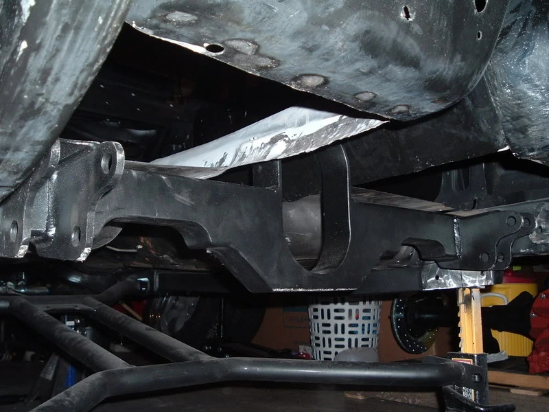

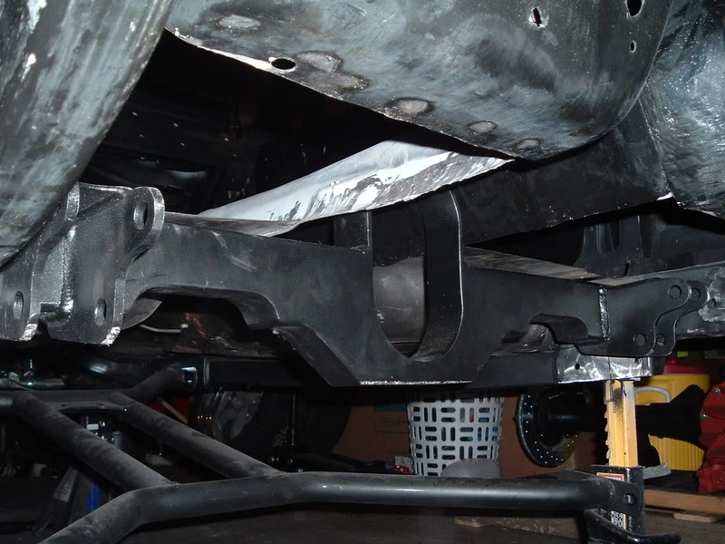

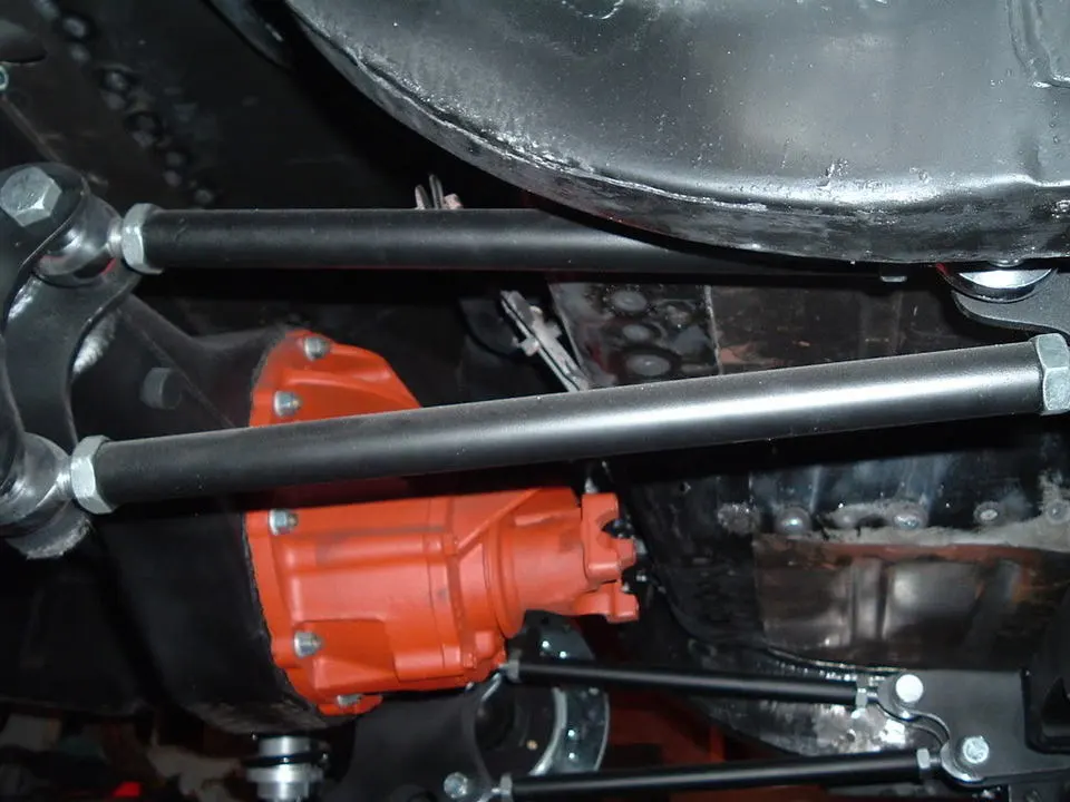

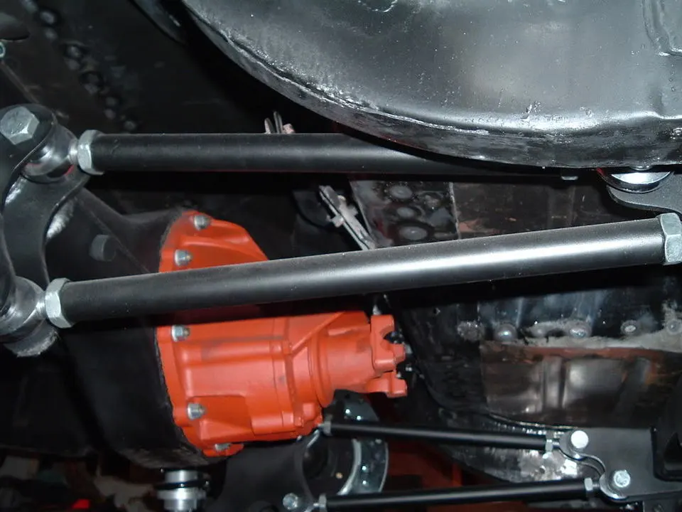

Its a Martz Chassis four link cut down to fit within my TCP Subframe connecters. If you need or want any specific pictures.
The rear is narrowed to 57" and I am pretty positive I ordered the 17x11 with 6" BS. Ill double check tonight when i get out of work.

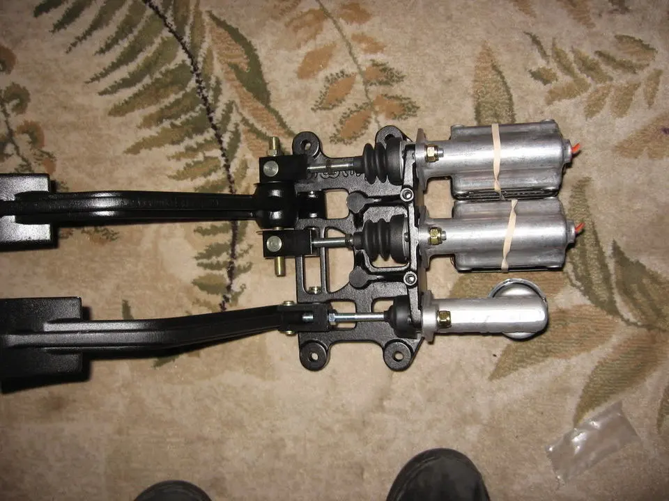

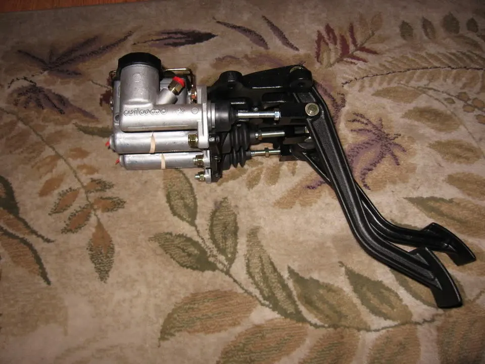

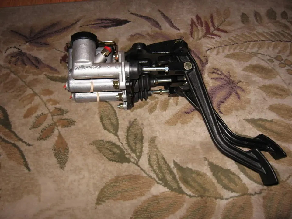

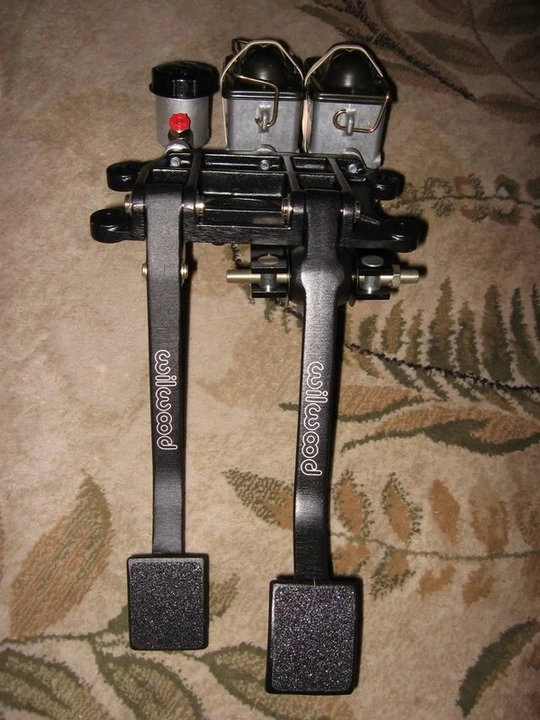

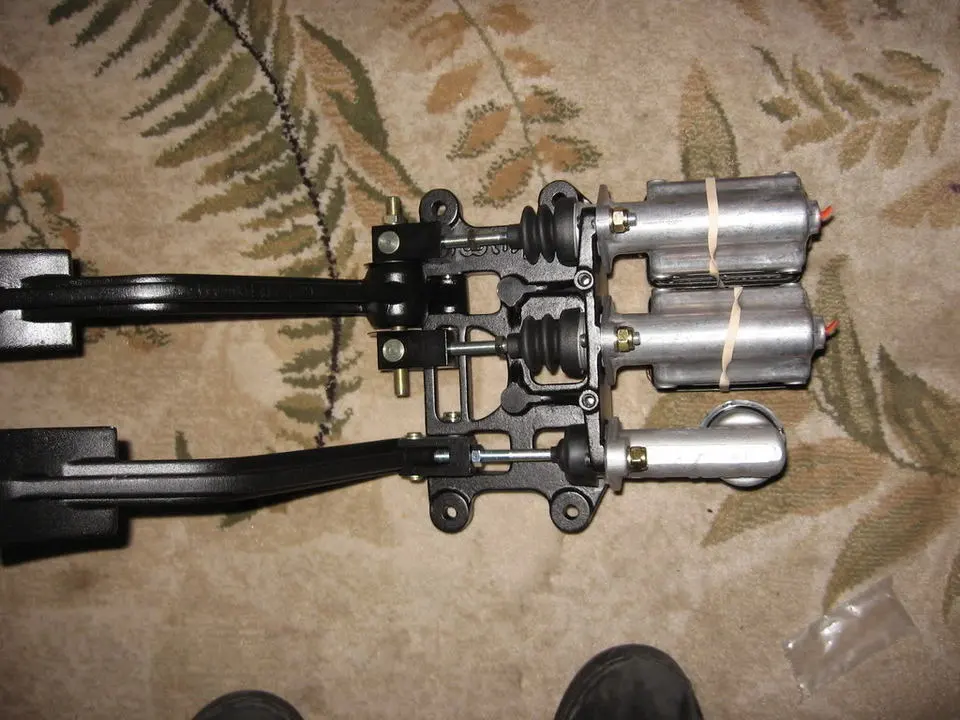

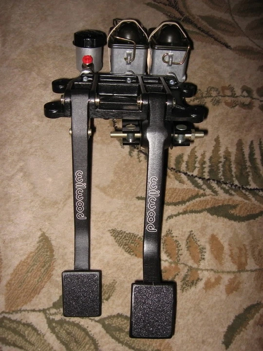

chepsk8 and I where discussing how it was odd you that can put together and aftermarket pedal assembly that is better stock in many aspects but cost less. There are manual assmeblies on Ebay for buy it now 375, if your lucky you can find a clutch pedal, or assembly cheaper. This is what i got for the same price.
Another perk is the balance bar which gives you adjustablity, and Wilwood says safety should one master cylinder fail, you can adjust the other to help comp. from with in the car if you have a calbe hooked up to it.
Dan you where right, it does look neat.

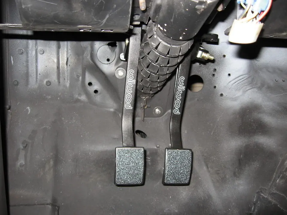

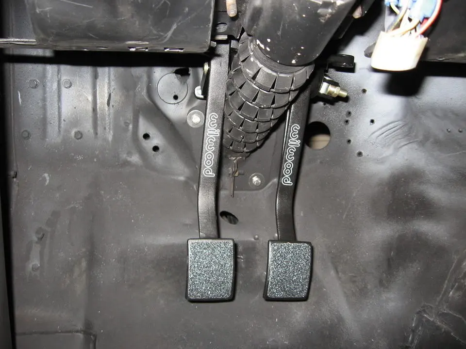

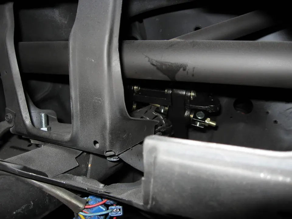

Since the stock column will not be use i should gain a small amount of room to move the assembly to the left some.
In addition to a plate on the firewall there will be brackets that go to the dash bar as well to add in providing ample support.
