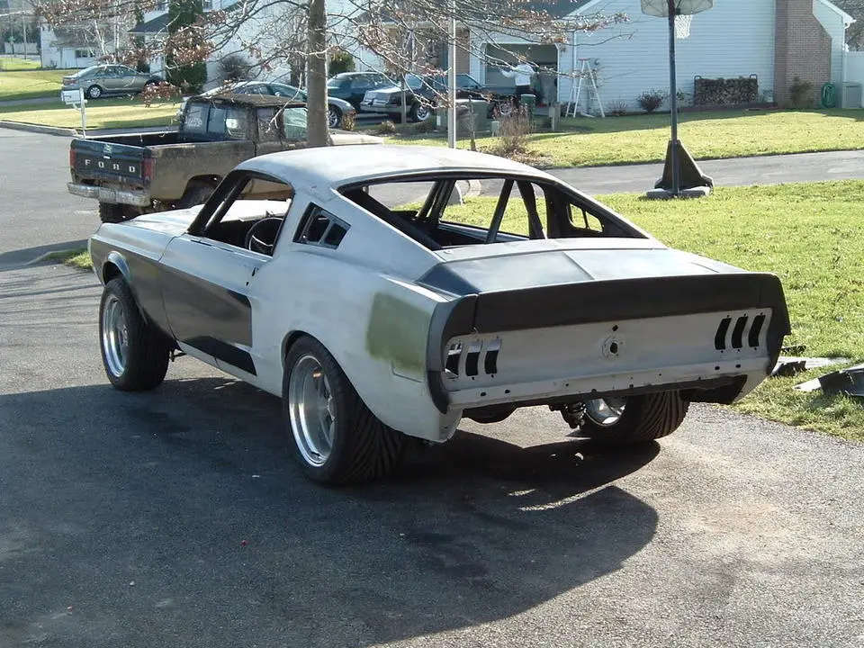

Well I have dusted off the cobwebs from the Fastback, I worked on it for the first time in 4 years...
I cut a coil mostly due to the fact I was tired of it stance, and I am glad I did, my hour of effort has left the car with a much more aggressive stance. though the cars power train will be changing. I will be selling the built low compression 331, in favor of a naturally aspirated Aluminum 351 based stroker shooting for at least 500 and 500 at the wheels. I also plan on replacing the TKO 900 with a T-56.

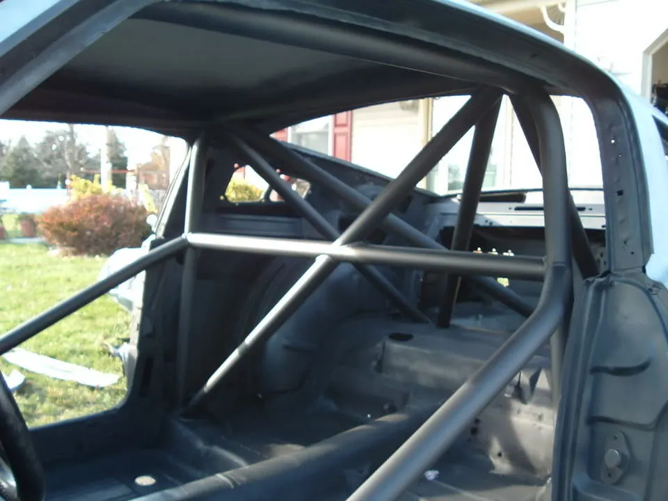

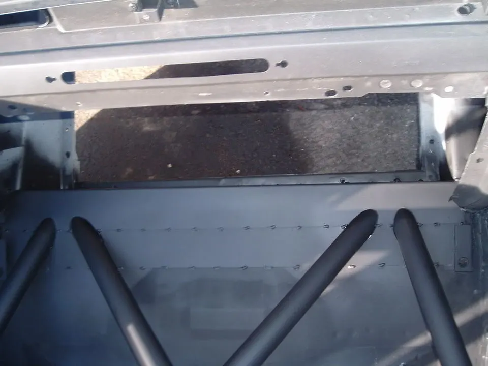

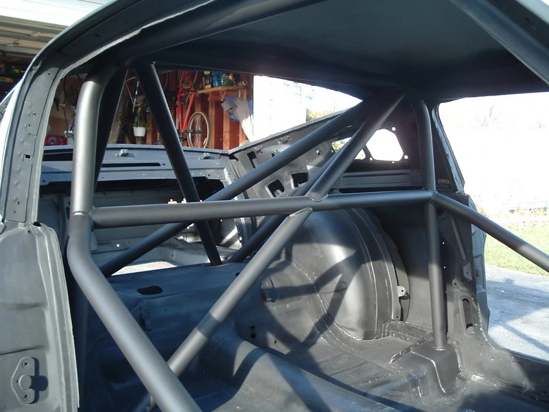

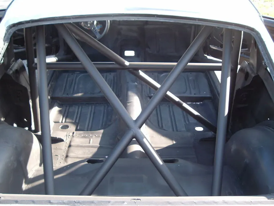

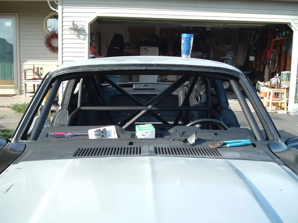

Just finished painting the roll cage, and talking with Chepsk8, about future possilblities with the car. Here are some pictures of the cage painted.
Thank god for the nice weather, i can push it out side a clean in the garage.

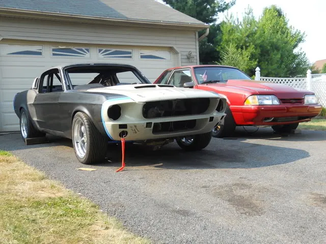

It looks like your neighbor has a cool Oldsmobile Hurst. Is that what it is?

Unfortunately a new front suspension may be in order. I am concerned that the likely fact that the 315's will push hard through the turns as I am only running a 245 up front. I may be able to over come this by running an 18'' wheels which will allow me to clear the god awfully tall classic spindle.
18's present issues of there own, though I don't foresee the increased brake or engine load as real concern. Not to mention I can get lots of free used tires from a buddy who works for a Mercedes Benz, as they replace tires prematurely and often.... He has garage bay full of tires off high end Benz's to feed his Blown Mach 1's Big Smokey Burnout habit.
If I go this route I still will probably swap out some of the suspension components to allow for the coil overs to mount to the LCA to aid in the handling dept. Although this setup would likely out drive me initially, not being restrained by adequate suspension pick up points is nice.
