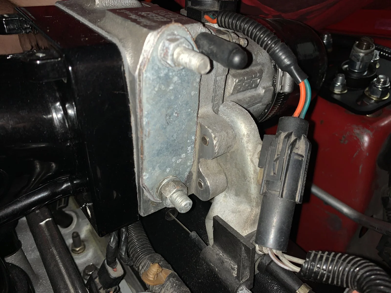

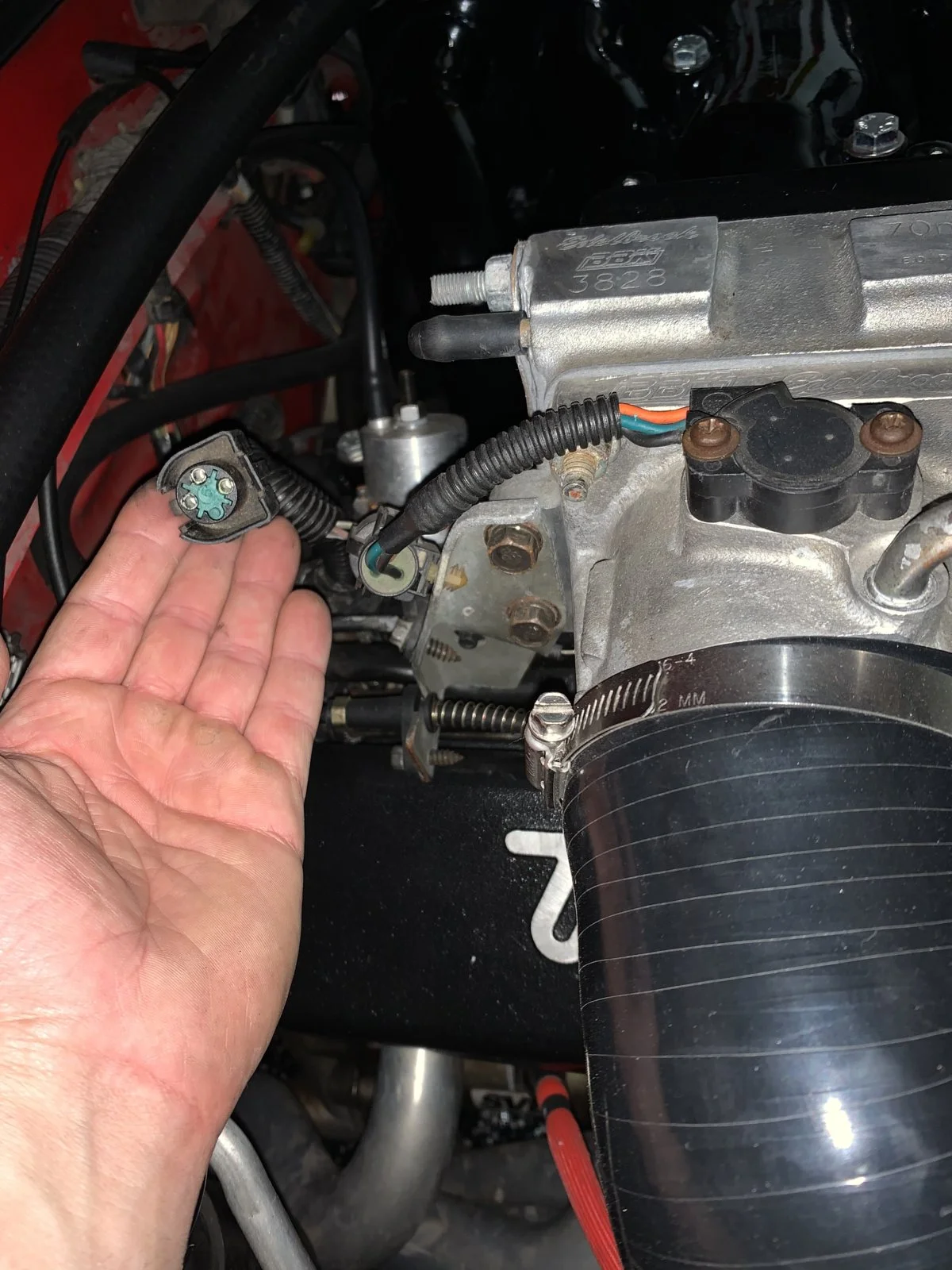

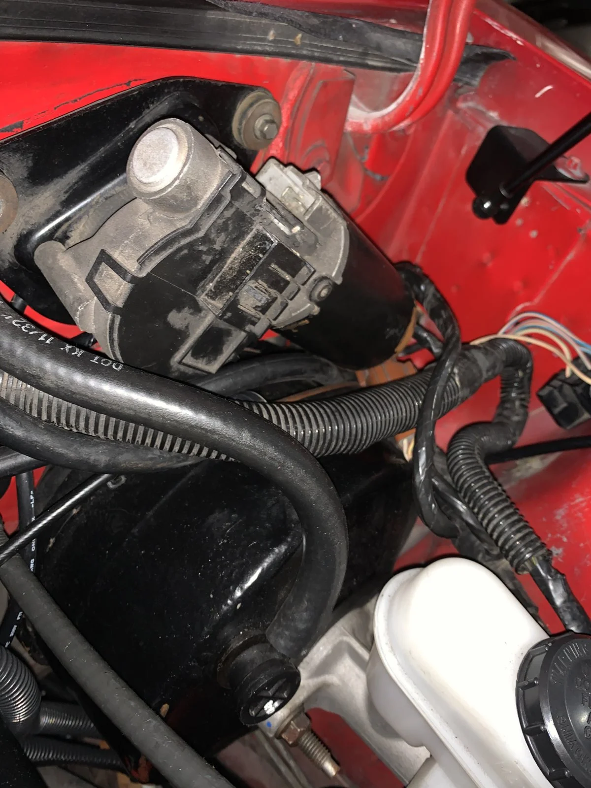

Guess that could be idk I don’t run my wipers and only reason the motor is back in it’s place is bc I was gonna reconnect it for inspection.Is that line your washer fluid line? Looks like it’s running over that way.
And the connector went to the EGR valve that’s no longer there, from what I can see.... or is it the other end of your TPS harness. Hard to tell if the other half of TPS is there in the pic.Guess that could be idk I don’t run my wipers and only reason the motor is back in it’s place is bc I was gonna reconnect it for inspection.

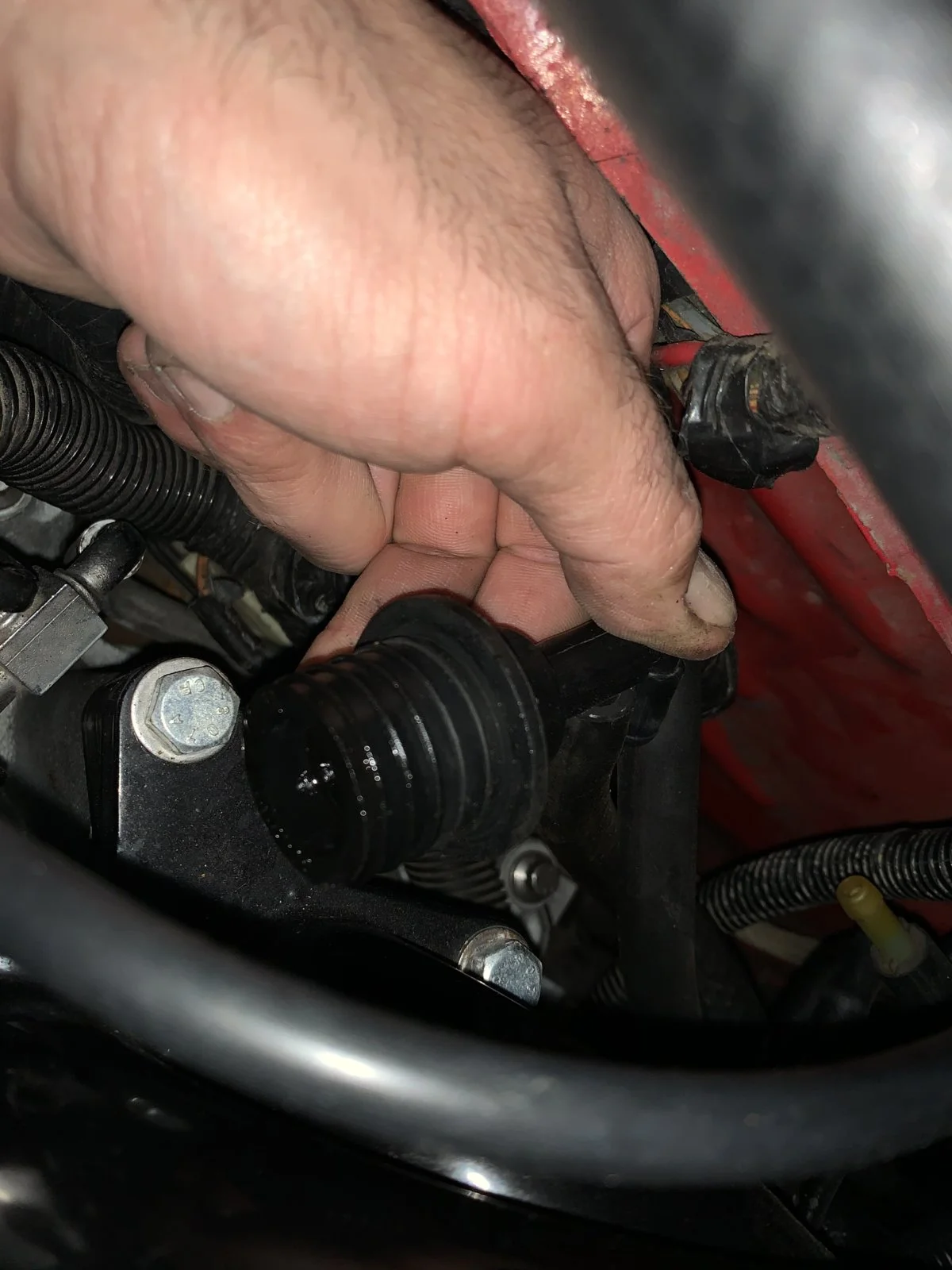

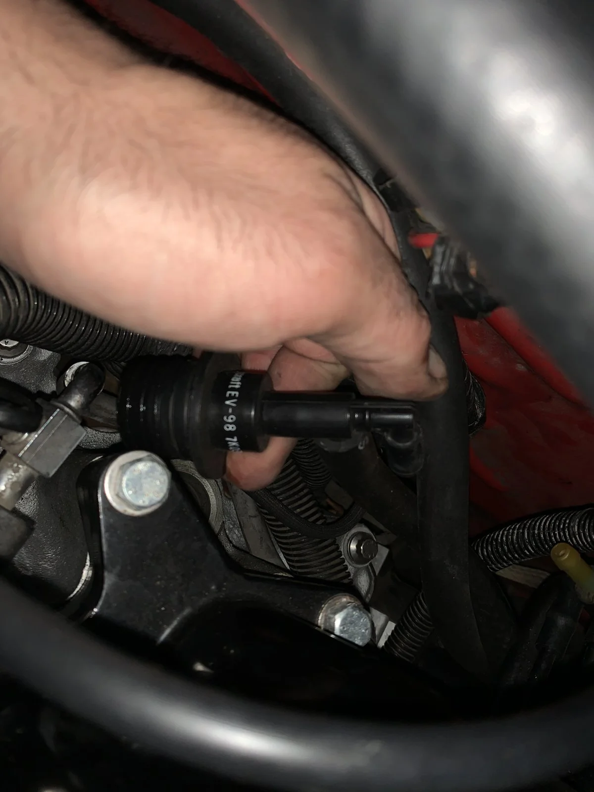

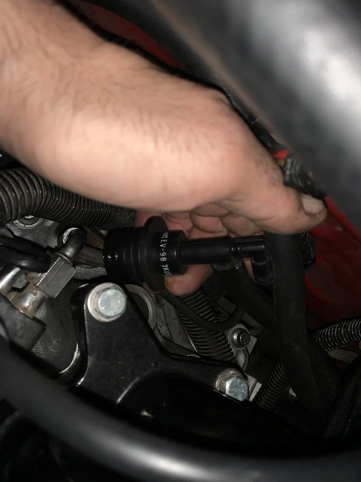

Yeah it’s not the original, I ordered a new one when I swapped intakes and like I said it’s not tight. It easily just comes out, not snug at all.That thing in the last few pics is the pcv valve and should be stuck into the lower intake it goes down in the center between the firewall and the upper intake. That being out can cause issues. The replacement grommets don't fit well at all.
Yup it was tuned and has a SCT chip in it. I took it to a shop and they then took it for me out to McKinney tx at True street motorsports. I do have cruise control but since I swapped to a momo wheel that is gone now but I didn’t do anything but take the old airbag wheel off and put this one on after the tune was done. So rtv the grommet ok bc that think literally isn’t snug at all which I would guess it’s suppose to be. I noticed it seemed oily as well, is that bad?Did you say you had it 'tuned'?

The rubber grommet for the pcv looks kinda oily, clean it and use some rtv to seal it back into its hole, also check the screen under it.
NA with plans for a blower.The oil on the grommet is not bad.

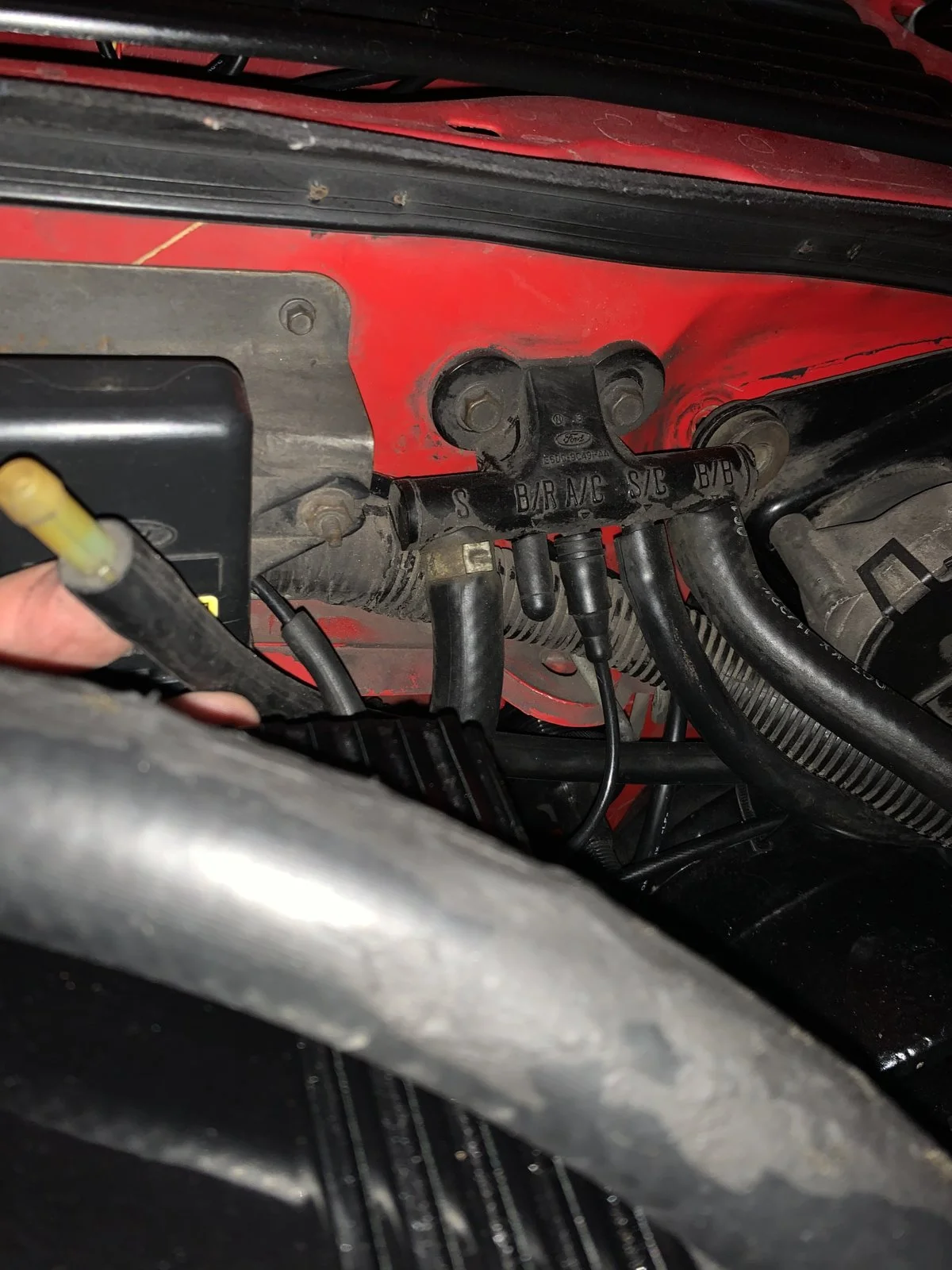

Picked up a brand new eibach rear sway bar off FB market for 120 so couldn’t pass. Slapped that sucker in last night and started to snoop around the engine bay to see if I could find anything out of the ordinary. I think @General karthief asked about the egr valve then remembered last night I deleted and blocked it off as well as all the smog stuff. I found this vacuum line to which I’m not sure what it’s for but maybe it was hooked to the egr? You can see the line and it runs back behind the brake booster. I also noticed this plug on the back of the lower intake, I am not sure if I knocked it out or if it was already out but i plugged it back in and it’s not very secure it just easily flops out with out any effort. @90sickfox asked about my idle and since I’ve gotten it back from the tune it’s always idled right at 1k, will hold at that and doesn’t fluctuate. My next step will be to try and spray the brake cleaner around the intake etc and see what happens. I checked the codes and what I got was 15, 67 o, 85 o, 10, 29c, 66c, 96c. From what I gather the first 3 are the key on codes found, then 10 is meaning the end of what it found and last 3 are constant memory codes found. Like I said car starts and runs fine, I can run out and cruise for awhile then I’ll get to a random light, sit in neutral idling and I can just tell it’s gonna happen. It will idle funny, kinda fluctuate, I’ll here this loud whistle sound and it will turn off, unless I rev it and get moving again then it runs and drives and at this point I try and time lights so I make it through them and get back home. Could it be a heat soak issue with the tfi? I’ve seen more ppl doing these tfi relocation kits.
