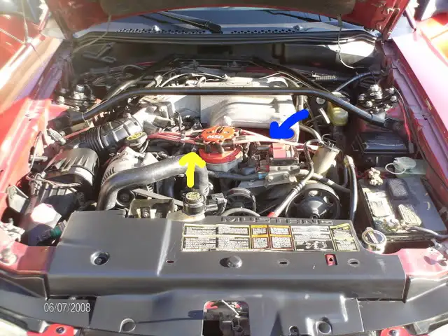

the temp sending unit is located on the lower intake manifold,screwed into it on the drivers side,it has one wire attached to it(blue arrow)
this just sends a signal to the cluster.
the engine coolant temp sensor(yellow arrow)is how the pcm reads the coolant temp.
its on the coolant hardline.
i would get a real temp gauge,the stock one is not all that accurate.
