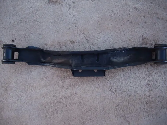

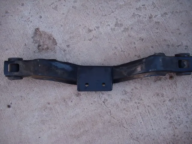

my last problem was the trans crossmember was interfering with the transmission pan itself... and the transmission mount was about an inch or two behind the crossmember... so it needed to be modified.. also, the transmission crossmember to frame mount was about 2 inches shorter on the 80... so i had a friend of mine modify my stock one and make it work... it may not look pretty... but it fits perfect and functions well..
