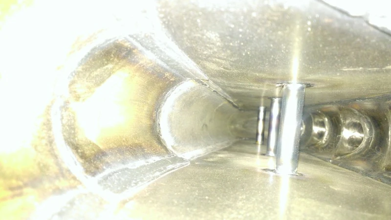

As far as that intake inflating at 18 psi, It'd be some weak ass steel if it did. Now,..if I was forcing double that into it,...then I might be worried.
As for the buzzing,..i could totally see how that could happen. There would be enough flexibility in the sheetmetal to move in/out enough have some harmonic effect at idle.
Well,...there was enough flexibility.
but then I welded these tubes between the top and bottom.
I call this pic "Bender's Colonoscopy"
I never like Eddies anyway.It will be interesting to see how the internal aerodynamics of this work out. Swirls and eddies you don't need, but a smooth even flow to each runner is what you are looking for.

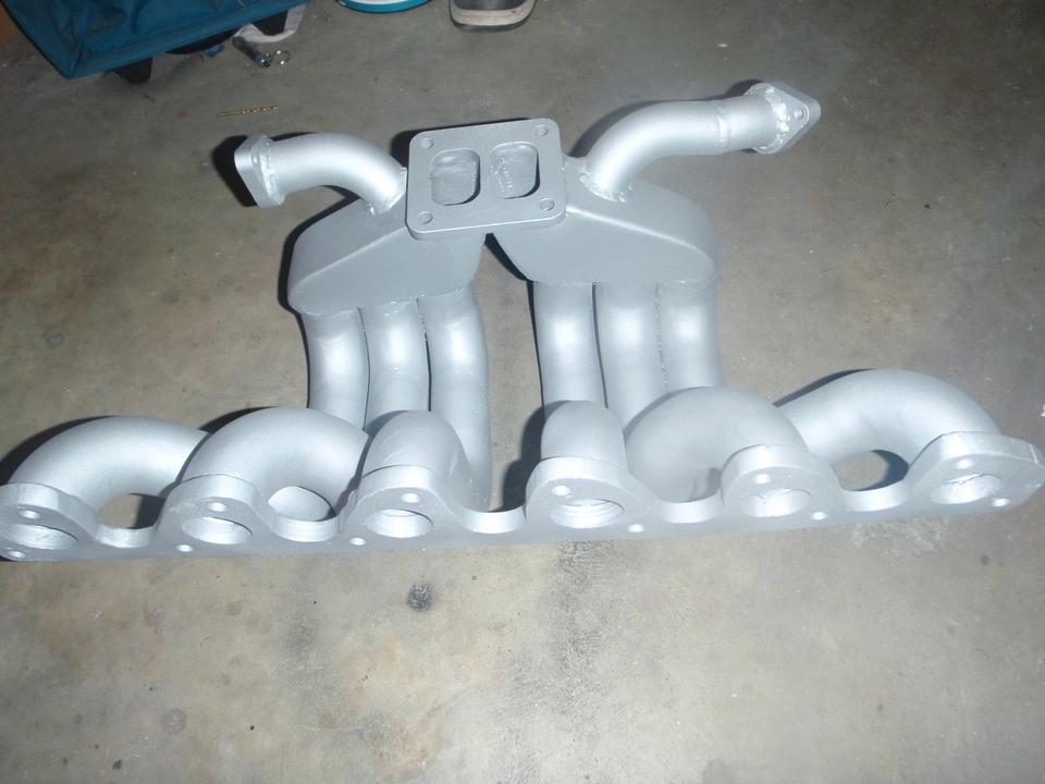

No. Sorry, No TR ever.Question:
Wasn't there a tunnel ram idea being kicked around at some point Mike?
It's a flow or no go from this point Joe,...If the motor is way down on power, and takes a buttload of boost to make any power, I'd consider it. But for now that bitch is going on there.Mike, your project, your money. But it would be cool if you could have it flowed before installing it.

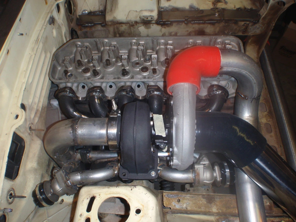

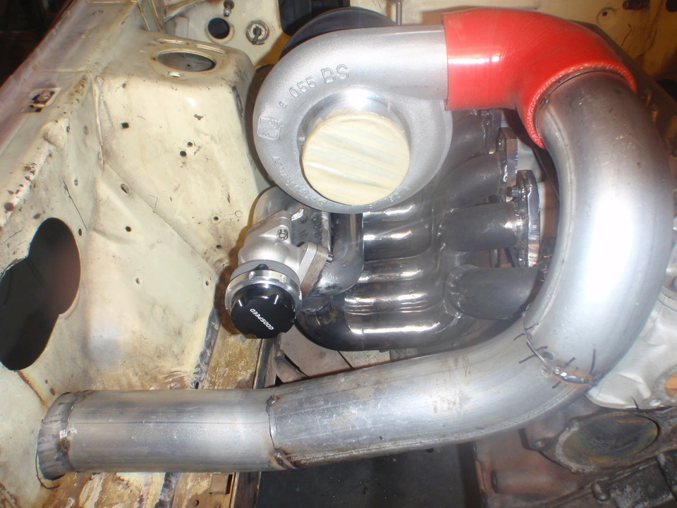

What? You haven't been paying attention have you?What plans do you have for exhaust? Came across this on fb
