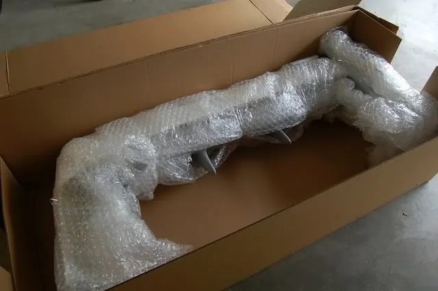

Here's a pic of the box right after I opened it...
It seemed like it was well packaged and there was no shipping damage apparent. Unwrapped the parts and here's what they looked like.

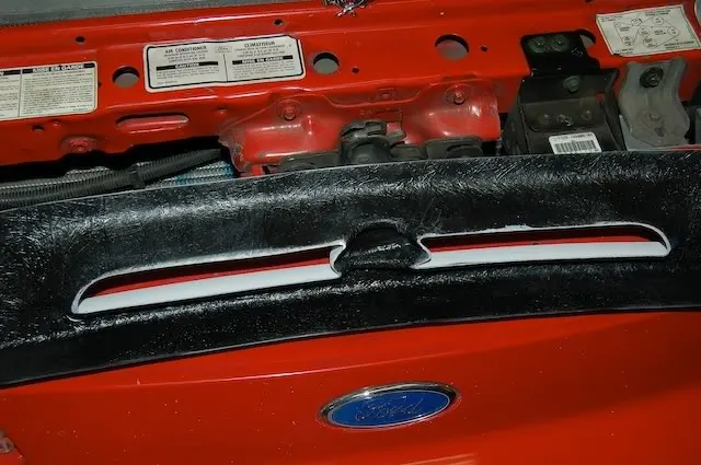

The cobra grille had zero instructions or hardware. It was basically a fiberglass piece with a chrome horse. There is a wave in the fiberglass in the hole on the passenger side - not sure how noticeable it would be on the car, but I sure noticed it right away.

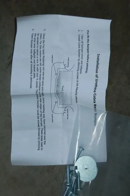

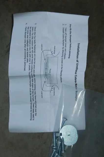

I've saved the best for last - the cobra bumper. Here is the total instructions, and hardware that it comes with...
No mounting holes are drilled anywhere on it. There is a fair amount of trimming that needs to be done to get it to fit. In the picture below, the horizontal lip will need to be trimmed back to get it to mount flush with the body. You will also have to trim another edge to allow it to fit under the rear lights - they have left too much material there that if you didn't trim it, the whole bumper would stick out backwards about 2-3" - hope that makes sense

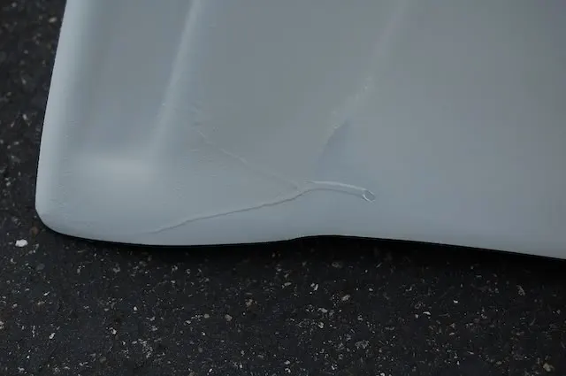

Probably the worst part of the bumper is the moldings - these were just terrible - there is no sharpness to these at all - there must be way to much crude stuck to the inside of the molds that were used. It will take a lot of body work to get it to look anything like OEM. I hope these come out okay...

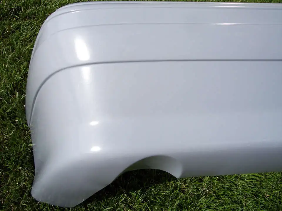

For comparison, here's a picture of a Cervinis cobra bumper
