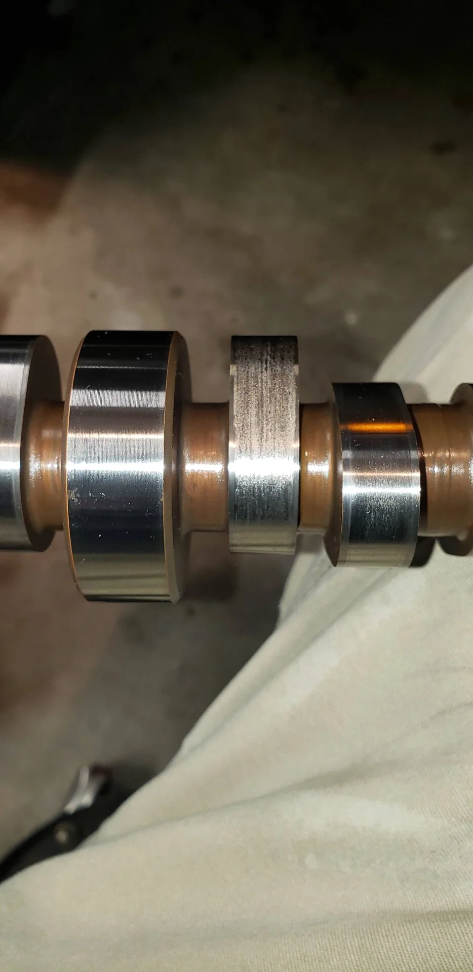

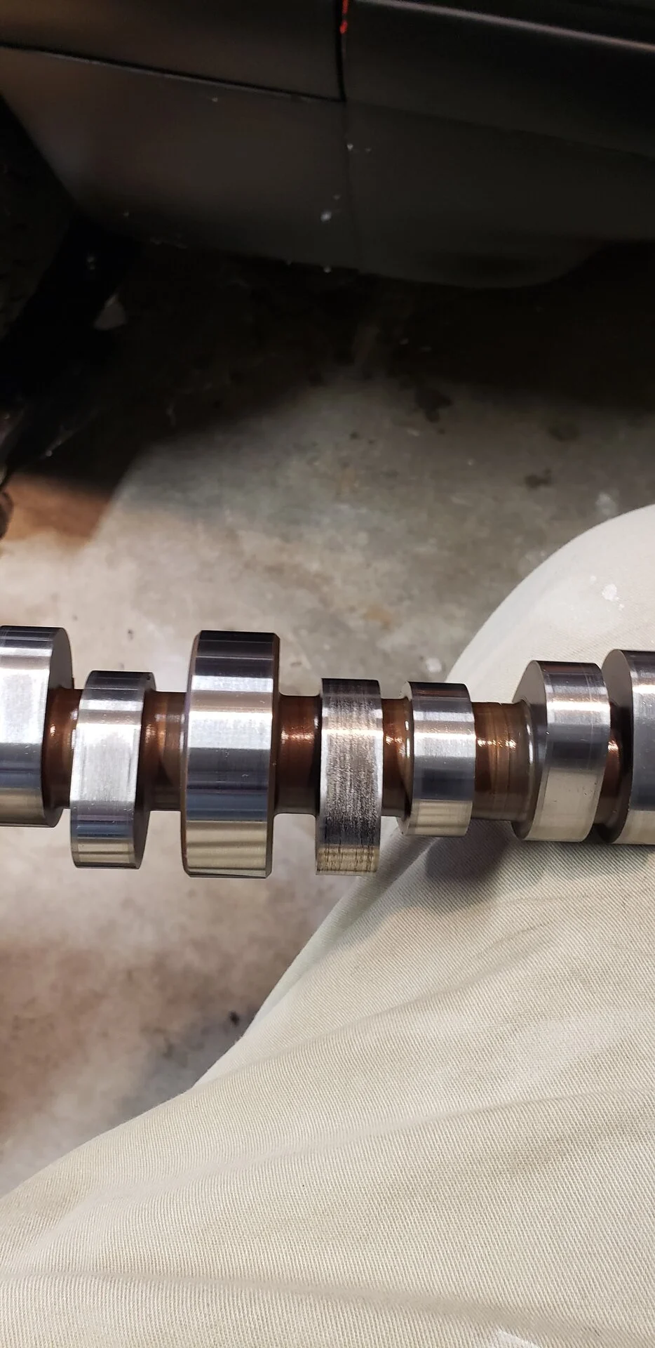

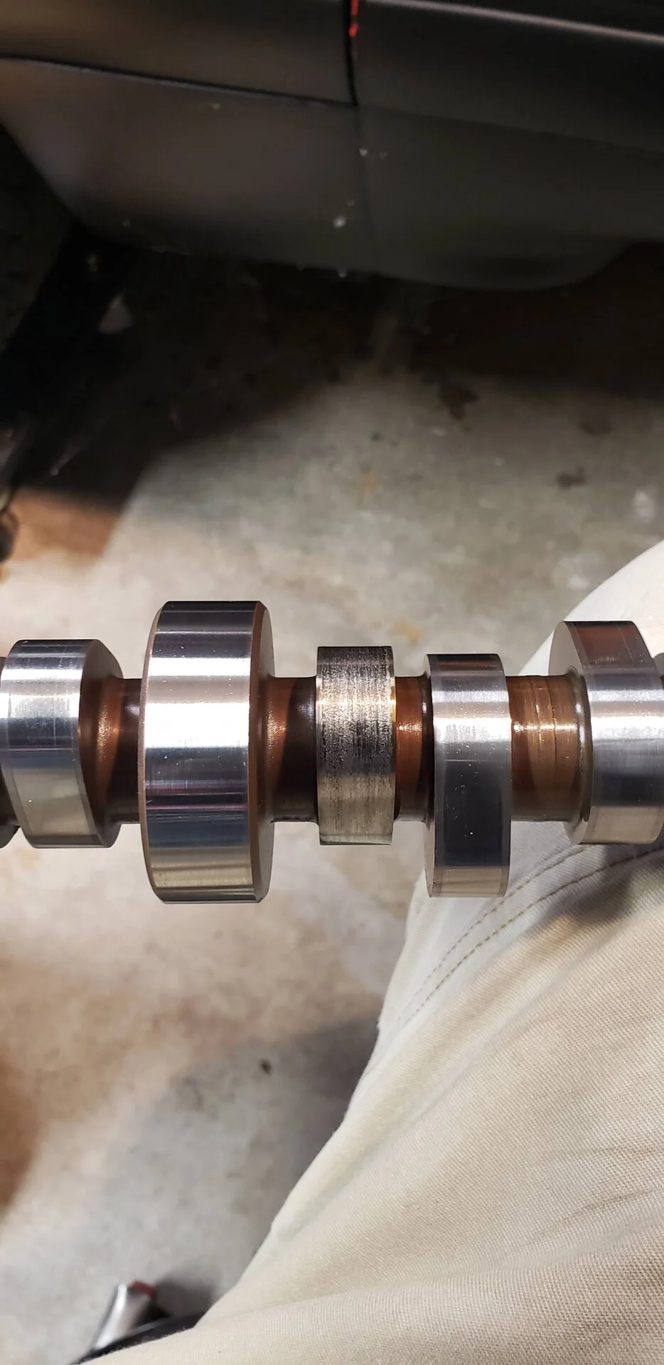

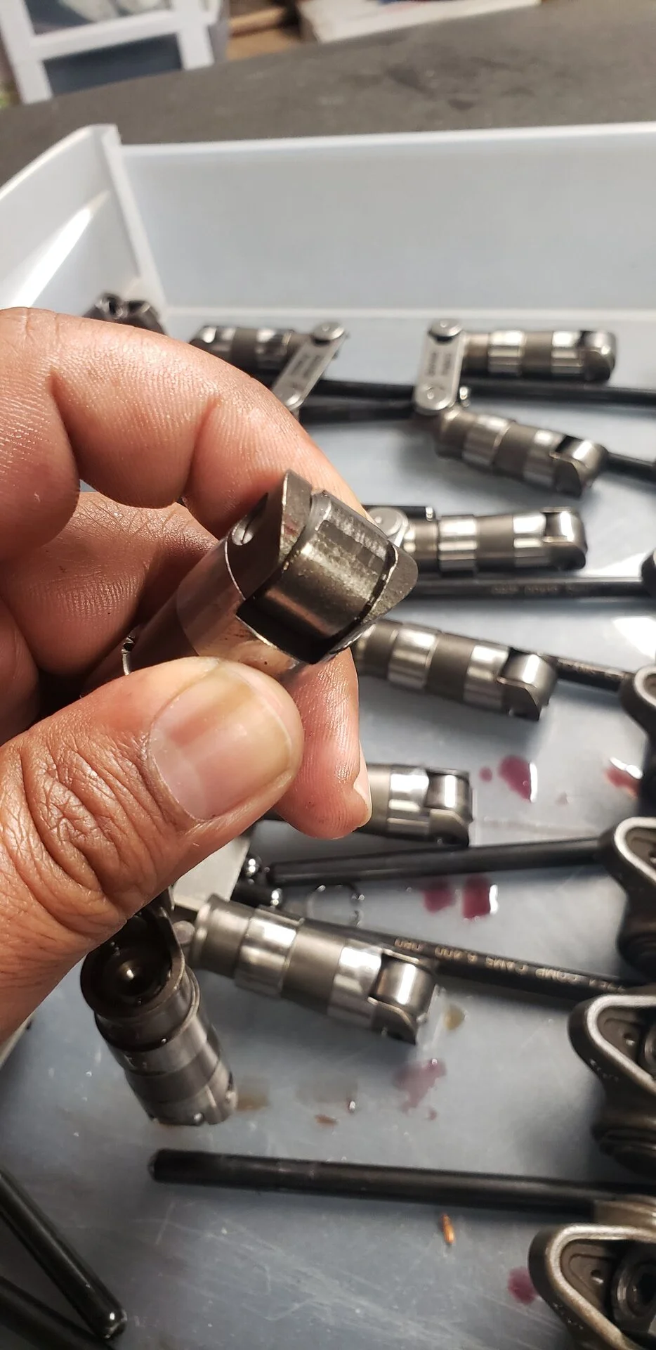

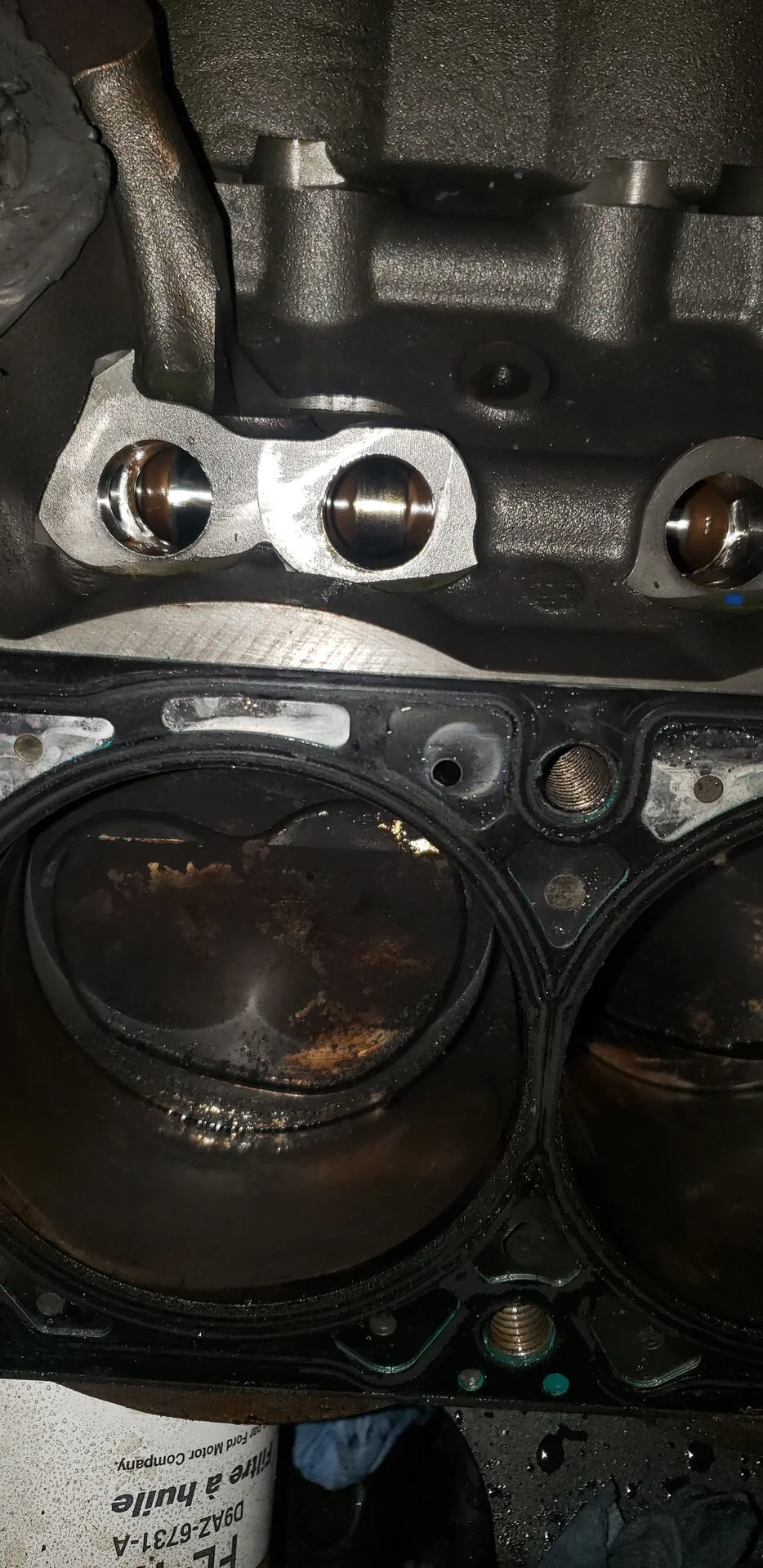

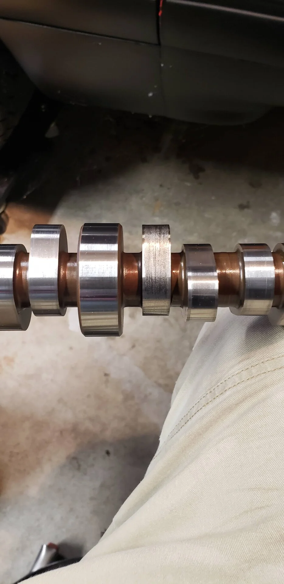

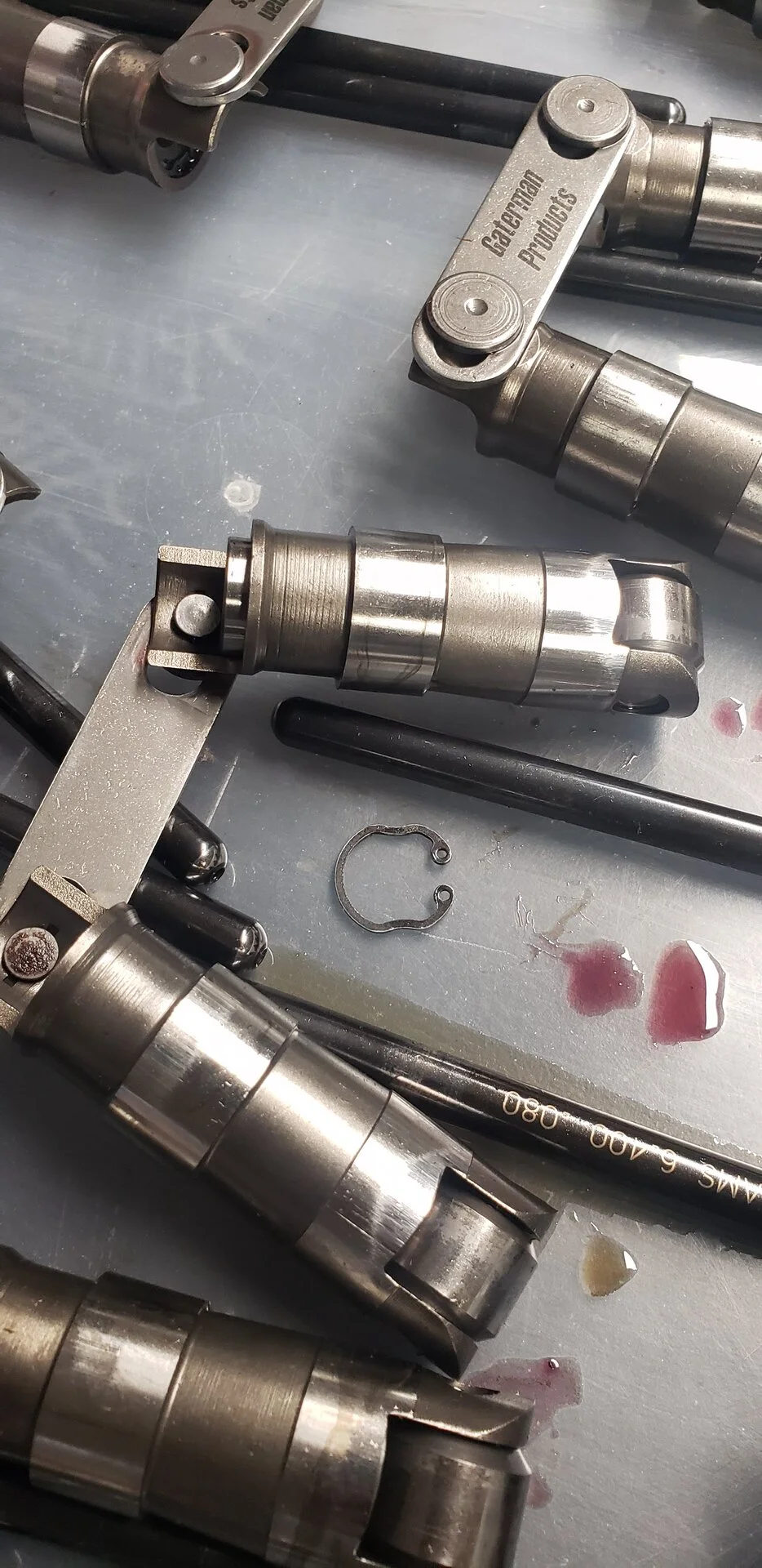

. It was a few months after moving in before I had a chance to do anything to the car. Finally took the heads off to get to the lifters.
I took that with a grain of salt so I called to confirm that they actually had them in stock. The lady said yes they would be drop-shipped from Morel immediately....
**...but CamMotion said...*. "Great!!! Place the order!!" They arrived Tuesday AND CamMotion called and said my cam was ready that same day!!
