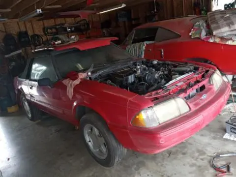

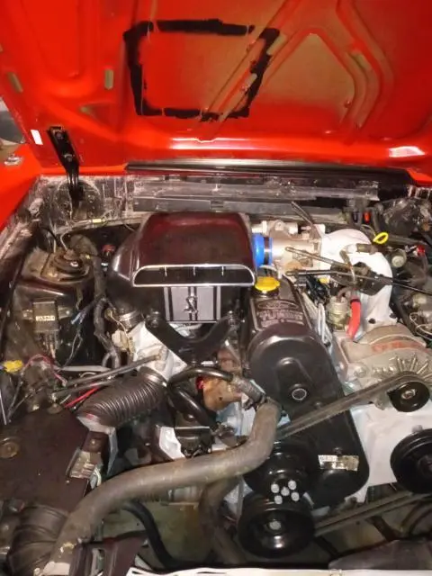

My 93 LX with 84 GT 350 T2.3 engine n W.C T5 trans, T.C big VAM, Brownies ECU, Xhaust manifold, clocked compressor housing to use a SVO intercooler with a fabbed adaptor from a DODGE V8 thermostat housing, XR4Ti S.A harness, power steering pump
4 got to say I had to repin the XR4Ti s.a harness n add a 2nd ACT circuit after the intercooler n the intake just after the T.B for the LA3 ecu n runn STINGER 3" pass side exhaust out the back
