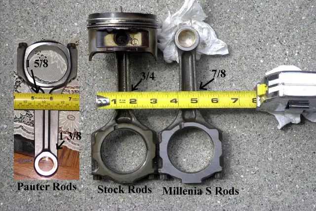

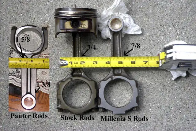

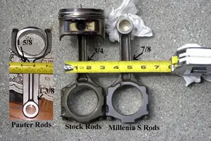

No we use Pauter rods, they are a lot stronger than Millenia S rods
WOW!! AND it is different meaning not like every other car out there. I did not know that was what made rods stronger but the larger size makes sense. Your pics are excellent and educational. Wonder what it is putting out? I had a mazda 2.5L (164HP stock) and it was smoooooth excellent sounding power especially with that DOHC. Your car must be putting out double that I would assume? In that little car? LOL!
