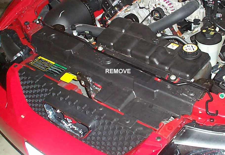

Remove the black plastic cover mounted above the radiator just rearward of the grille. Remove the hood latch bracket (4 bolts, plus one that retains a stay at the bottom of the readiator). Shim between the bracket and the top of the radiator support. Replace all bolts and fasteners.

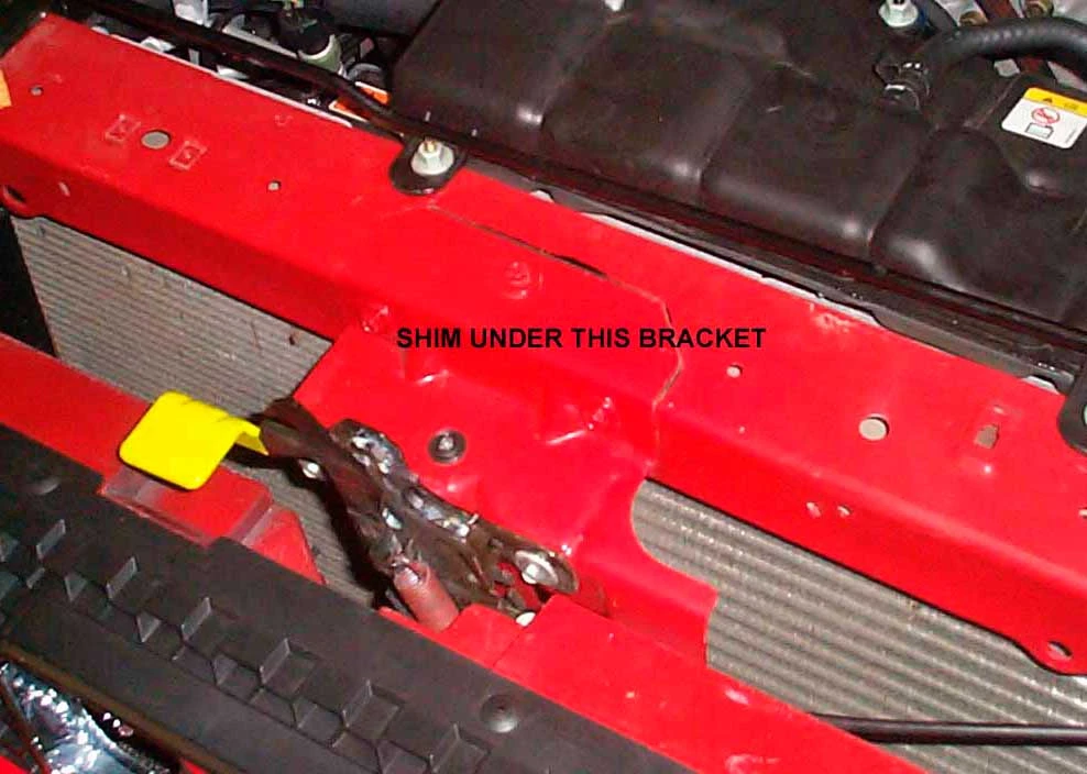

Image with the plastic cover removed. This was a trial fit before the shims were painted, so some of the original black color appears under the bracket. Total shim thickness in my case was between 3/32" and 1/8".
