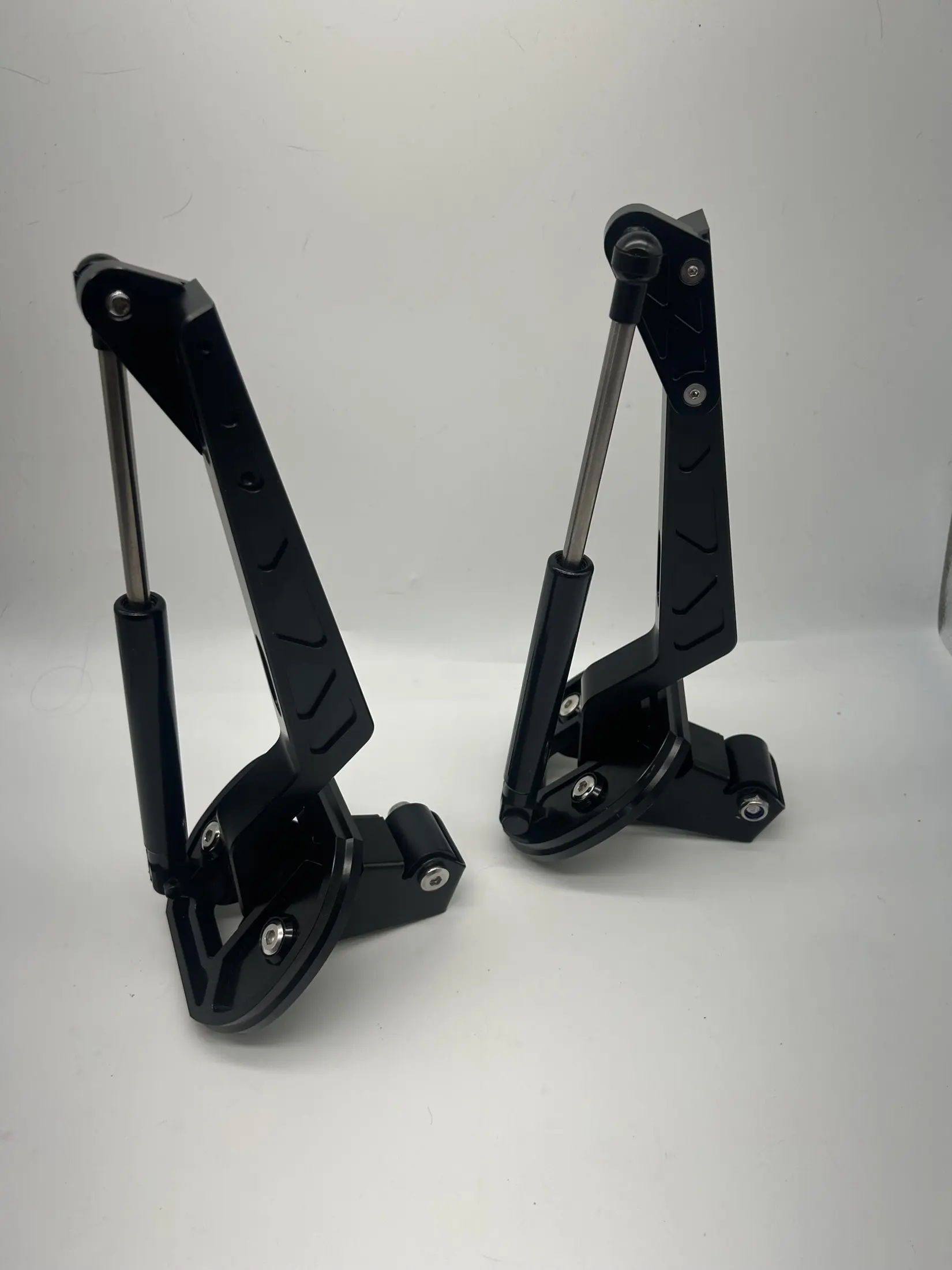

Has anyone came up with a Hood strut kit that works on our Mustang II? I want to delete the prop rod. I did a google search and they have strut kits for the Fox body Mustang. I even found a strut kit for the Pinto. But I couldn’t find a strut kit specifically designed for our Mustangs. Does anyone know if one exists? I’m tempted to order the Redline kit for the Pinto and modify it to work.

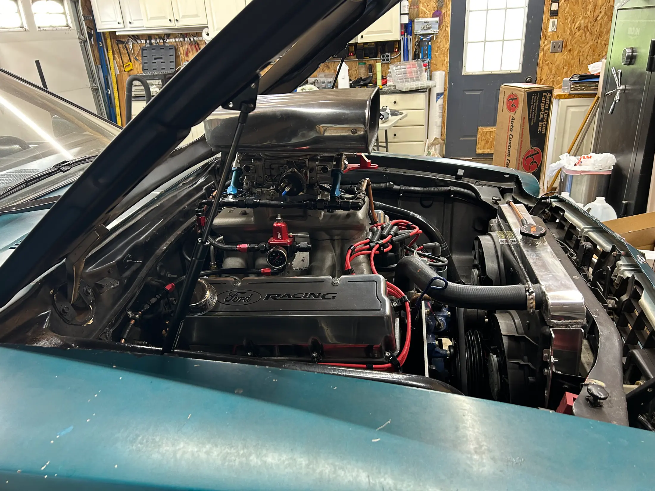

Got around to installing the hood struts today. Probably my favorite easy cheap modification I’ve done. Ignore the dust, I’ve been working out wheel and tire fitment issues.
I used the same struts as you suggested but went with a slightly different bracket. I used an L bracket on the hood end to keep everything straight and prevent any side to side forces on the hood. Below pictures show the strut and bracket parts I ordered from Amazon.
I think I started off with those L shaped brackets before opting for the flat ones. Either way, though, it's damned nice to not have the prop rod in the way, huh? It's one if my favorite cheap upgrades too. Now we just have to convince @Blackhawkxx to join the club! Maybe @2Blue2 too! C'mon guys! I'm telling you you'll love it! :stick:

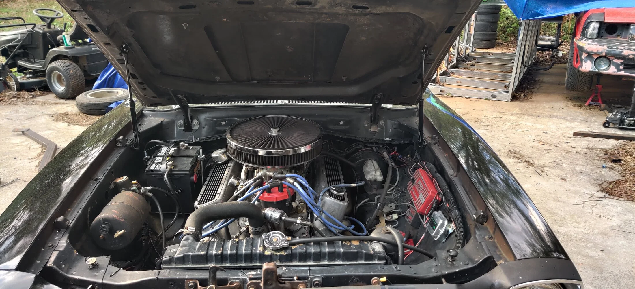

There are still struts but they are in the way of [nothing].
II hinges look a [lot] like Fox hinges to me. :shrug: If there's a variation, I bet Fiddle Fart could accommodate that.
The hinges are very similar, but I've not had them both off at the same time to compare. The only thing that stands out is the bolt spacing on the firewall. I suppose one of these days I could get off my lazy ass and use all of this free time I have and take some comparison measurements.... ;)
