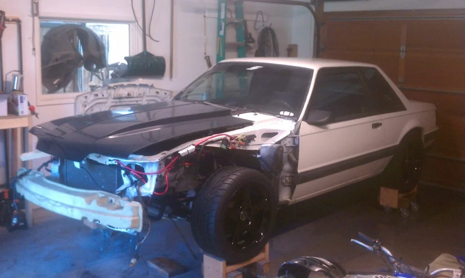

Progress Thread My Kenne Bell Twin Screw'd Foxbody thread, (new addition to the family)

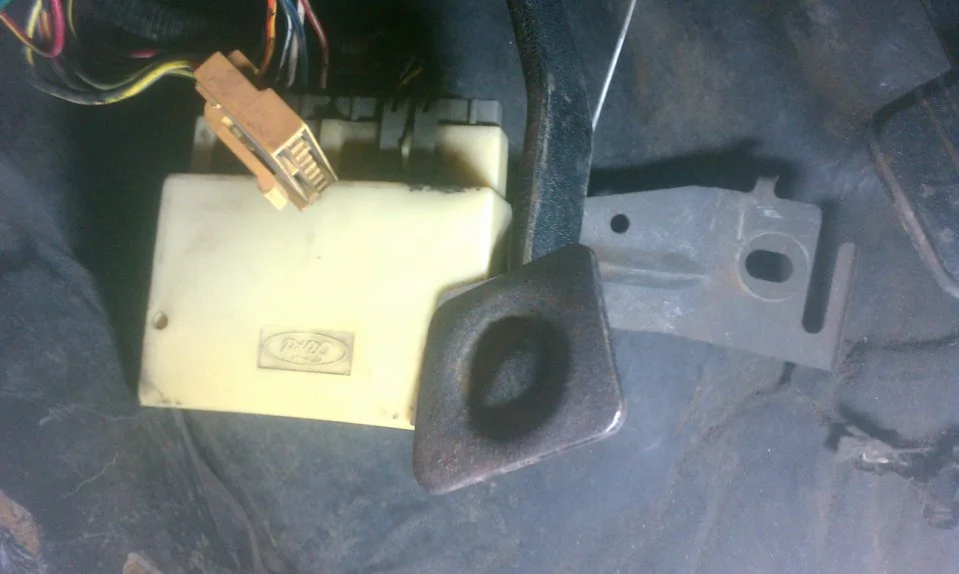

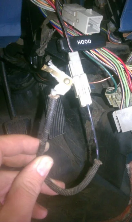

I removed this a long time ago and now forget where it went. Can you please post a picture or tell me where this mounts up? It's near the clutch pedal under the dash.
Also, anyone know what this wire is? It's broken. The wire is black/pink. @jrichker
If anyone can also post a pic of the brake switch mounted on the brake pedal that would be great. I need to know if I installed it correctly.
I ended up finding out that the first picture in the post above is the cruise control module and it mounts to the lower left bolt for the brake booster. Was under my dash for longer than I'd like today tying up loose wires and my clutch cable. As others have said working under the dash is the worse place possible for these cars. O'well, at least I got a little progress done. I should have my battery cut off switch and PiMP installed next weekend and start up following shortly after.

I got the E-fans wired up today. Going to control them via Stinger PiMP which gives me complete control to kick on one fan at "x" temp and the second fan just above the first one at whatever temp I want. Wired each fan through a 5 pin relay and then to the ECU which will trigger the relay on and off. I still need to wire up my wideband O2, align my front wheels, install new key & trunk lock cylinders, redline hood lifts, and some interior and that's about it.

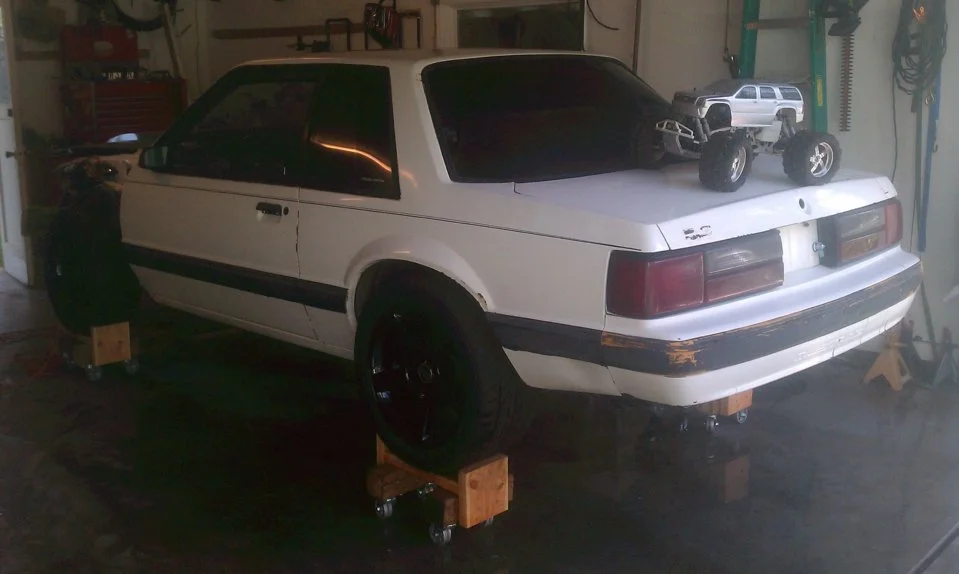

Decided I would give the Notch a bath in the garage, it was really filthy.

I'm going to finish up with my wideband O2 sometime today or through the week so next weekend should be when I install the jumpers for my options, connect the laptop and start going through the pre-start check list that PiMP has. As most people probably are at this stage I'm really excited yet terribly nervous at the same time for the first start up. I'll keep you all posted.

It's been a weekend of 1 step forward and 2 steps back!!
I ran some wires through the firewall on the passenger side for the PiMP vacuum line and my battery cuttoff switch wires to the ALT and this happened....broke the dang brake line trying to move it a little to get my hands in there.
Today I install my jumpers for my engine configuration for my Stinger PiMP microsquirt
Turns out the PiMP does not support dual fans (low fan, high fan) for the V8 since the high fan is shared with injector 8. So this only works for a 4 cyl. I should have read the instruction closer.
Now I'm left with a decision to make, run a single fan through PiMP? Or maybe use the flexilite fan controller that I already have that has soft start to run my dual fans?? I really don't want to look at that ugly fan controller in my engine bay. Maybe I can hide it?
