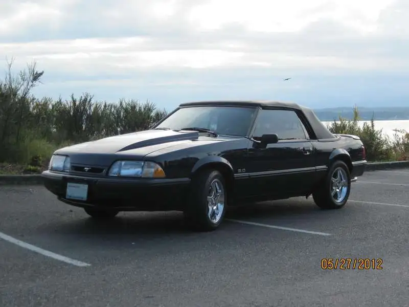

Hello folks. I have lurked around this site for quite some time but never really introduced myself. To be honest I felt she had a ways to go before you could see her. Well we have gone a ways I suppose though the road still stretches into the future..
Her name is Brenda and life is slowly changing dramatically for her! Years of being neglected and living life solely to transport are being erased as she has moved into the home of one who would be her lover.
1990 Ford Mustang 5.0 LX Convertible
25th Anniversary Edition

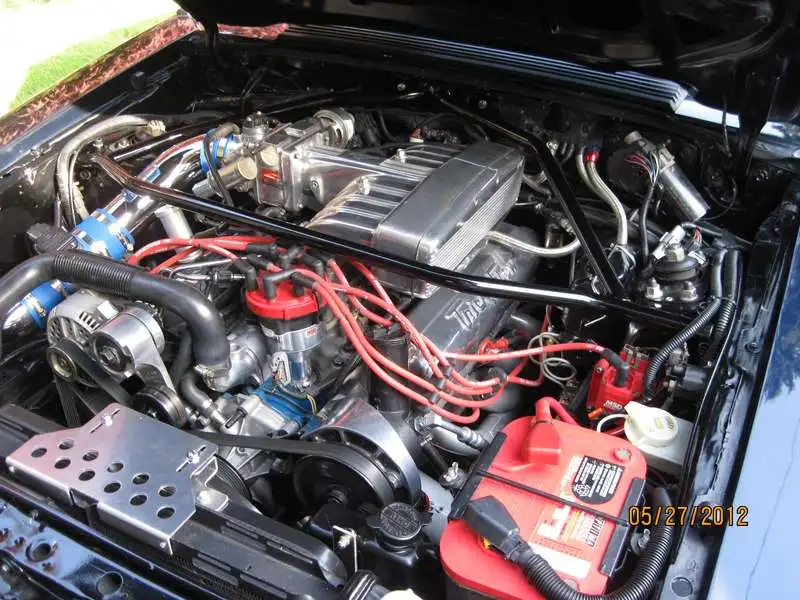

Building Power
347 stroker - AD Performance built - Digitally blueprinted and balanced ( sportsman block - fully forged scat rotating assembly - Probe pistons - clevite bearings - etc......)
Trickflow 2.02 twisted wedge heads
Trickflow stage 1 camshaft
Trickflow 1.6 Roller Rockers
Ford Racing Hydraulic Roller LIfters
Trickflow Chromeoly Pushrods
Ford Racing Double roller timing chain
FMS A/C Delete
APS Underdrive Pullies
BBK Cold Air intake
76mm C&L Mass Air Sensor
PP 70 mm Throttle body and EGR spacer
Performance Products Typhoon Intake Manifold (ported/ and "smoothed"
runners upper and lower)
Holley 190 LPH Fuel Pump
Accel 24 lb Fuel Injectors
Holley Fuel pressure regulation
SCT performance chip
MSD Pro-Billet Distributor and TFI
Ford Racing 9mm wires
MSD Blaster II coil
Good Year Hi-Miller radiator/heater hoses (Black is hard to find!)
3-core radiator
Stewart High Flow water pump
Black Magic Extreme 185 Electric Fan
Powermaster 130 Amp Alternator and upgraded wiring
MAC Ceramic coated 1 5/8" shorty headers
BBK catalytic X-pipe 2.5"
Flowmaster Force Cat-Back 2.5"

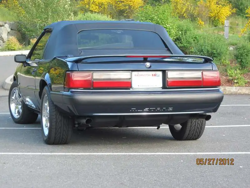

Looking Pretty
20% 3M Window Tint all around
All exterior trim resurfaced or replaced and painted satin black
Re-paint with a lot of clear - Midnight Blue metallic
All new 6-piece headlights
'93 Cobra Grille
New smoth deck lid
Low rise sport wing with internal 3rd brake light
2" Steel cowl induction hood
Polished Aluminum 16"x8" Cobra R replica wheels

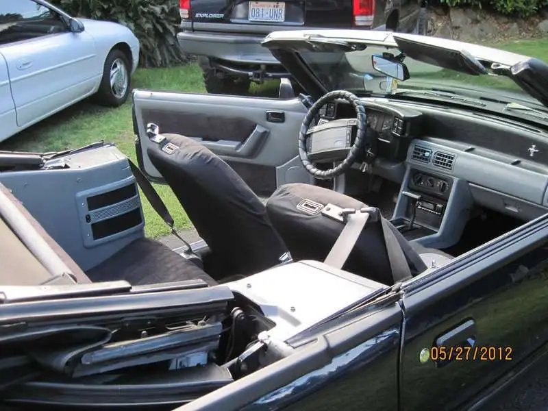

Her soft warm insides :)
All interior panels and such panels were either resurfaced or replaced
color matched to an 89 smoke grey color. or black...
All cloth body panels were recovered in Black microfiber (suede like)
Replaced carpeting with black custom fit - also cleaned up the floor - repainted it - added a touch of sound deadening to rattle areas
Black Husky floor coverings. (gotta love the northwest)
Rear seat recovered in Black micro fiber
Custom Black and smoke Grey micro fiber seat covers
All interior instrumentation converted over to Blue and red lighting.
All Door hinge pins, door latch strikers, and top latches replaced
All weather striping replaced
Relined trunk and reinforced molding with aluminum
Pioneer Multi media friendly head unit
replaced all stock speakers with infinity kappa series
Viper 350HV security system

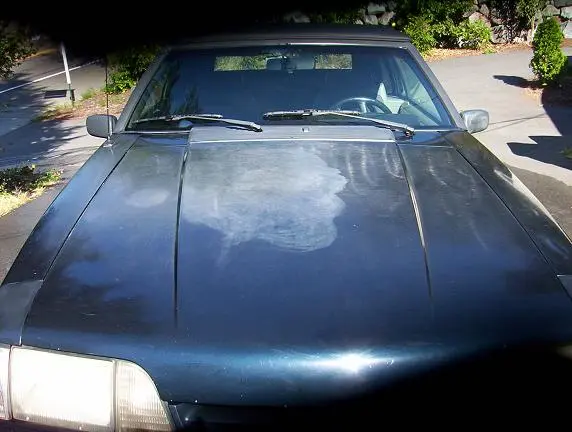

For a little perspective here are a few from day One
