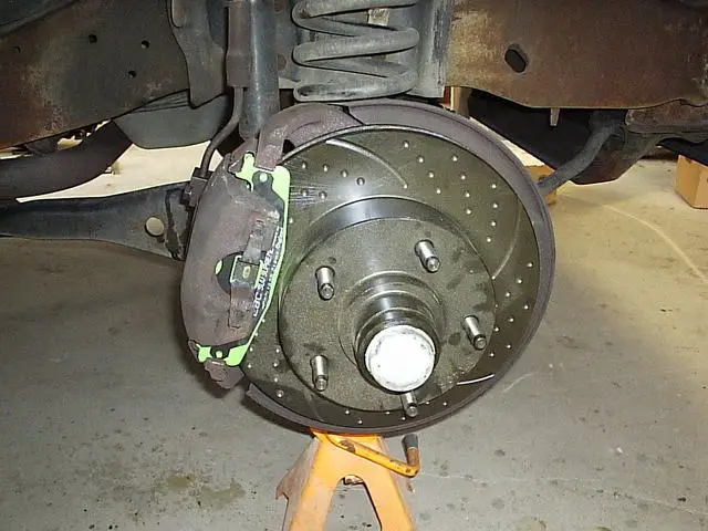

Have them on my F-150.
I put just the drilled units on the Mk VIII. No problems and no noise.
