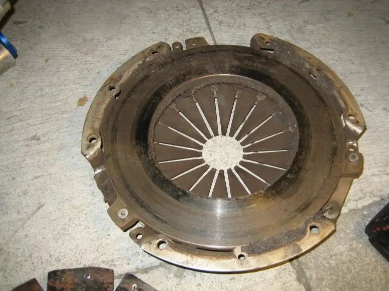

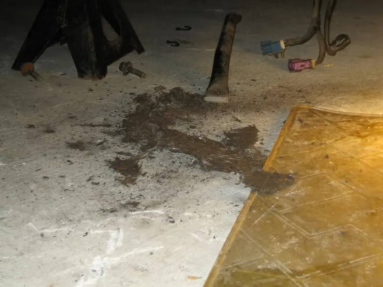

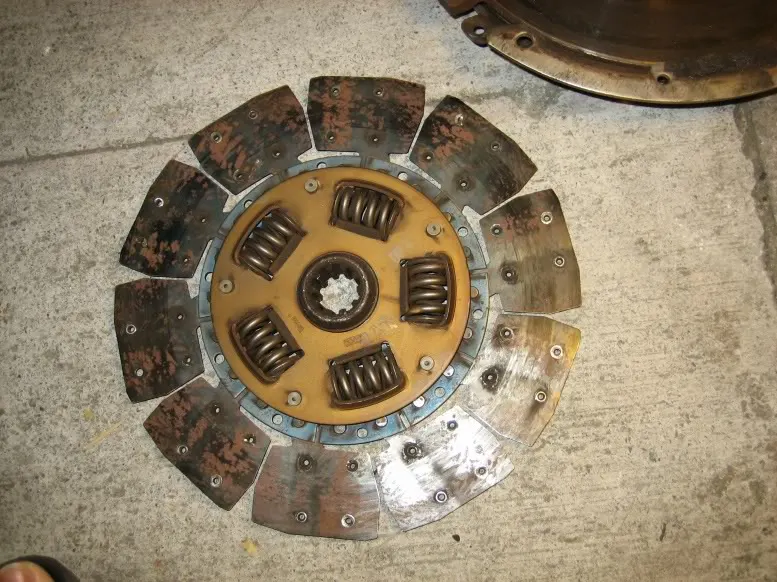

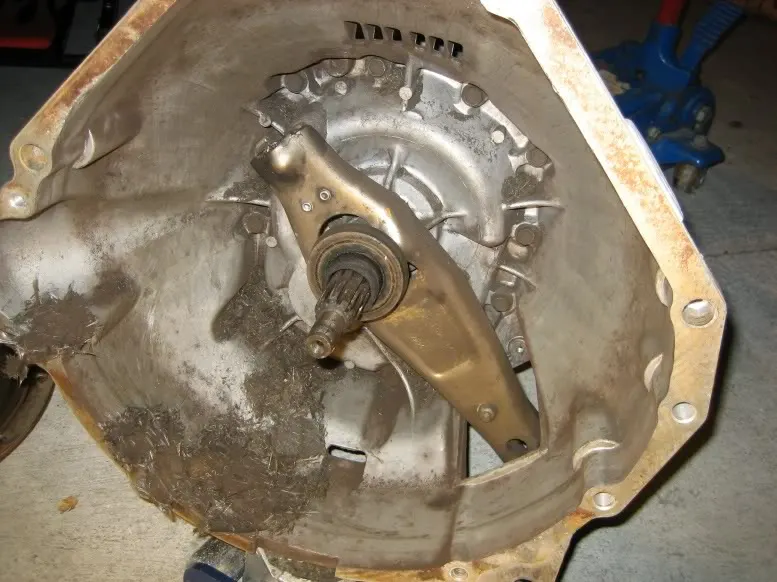

Within 5000 miles, the plastic intake cracked, I had the tranny out twice...once to change a bad throwout bearing, and the second time to change the clutch. Not sure what even happened, but I was coasting in 1st with the clutch in, felt a jolt and then there was nothing else. I thought something broke in the tranny but was surprised to see that all the friction material for some reason flew off the disc. Put a new clutch in, 300 miles later It spun the rod bearings on the 2 rear rods. This on a Ford reman engine with 30k. Not sure why it'd do that. All this in addition to a bunch of other stuff that isn't worth mentioning...
You can see what's left of the old clutch and all the shiny specs are metal.

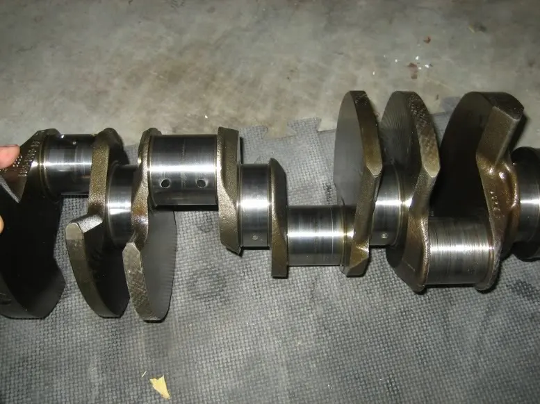

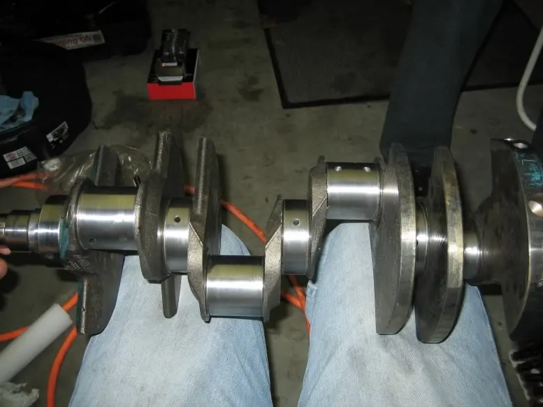

The good news...I dropped the crankshaft off to get turned. Only 90$. Gotta get some bearings and it'll be good to go again.

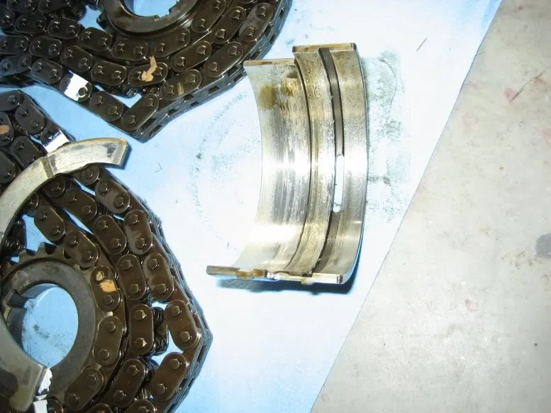

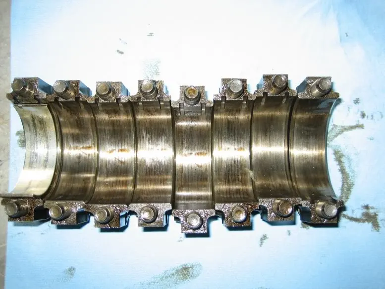

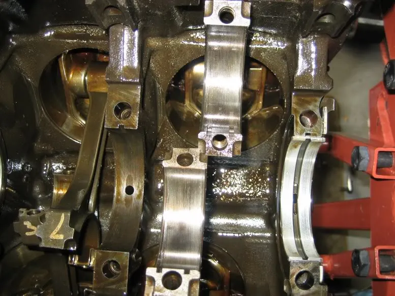

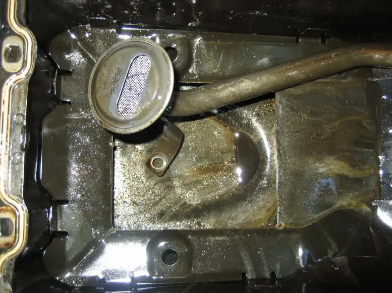

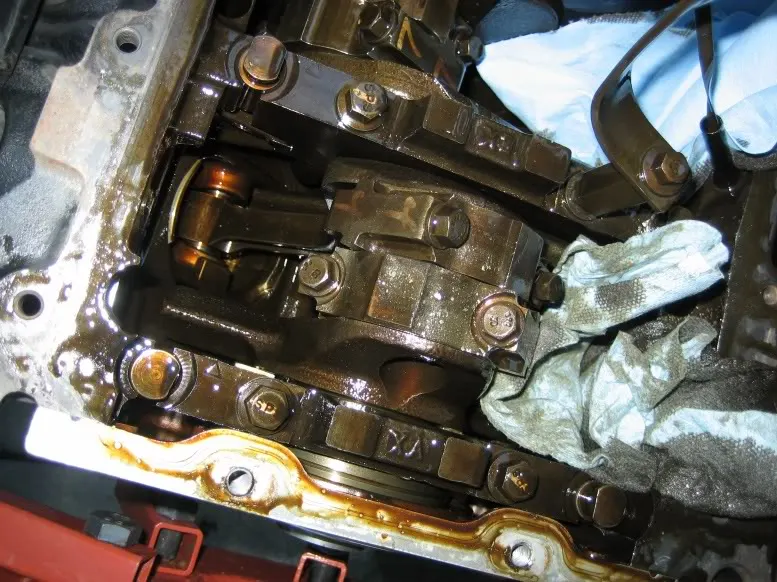

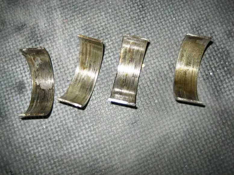

Here are some more pics...every rod bearing is damaged and two are spun. Also, one main bearing is damaged. I did this one in right :nice: My connecting rods are all ok though. Good thing I cut it off quick.
Slight amount of metal in the oilpan.
Main bearing
Some well done bearings.

Got the crankshaft turned...

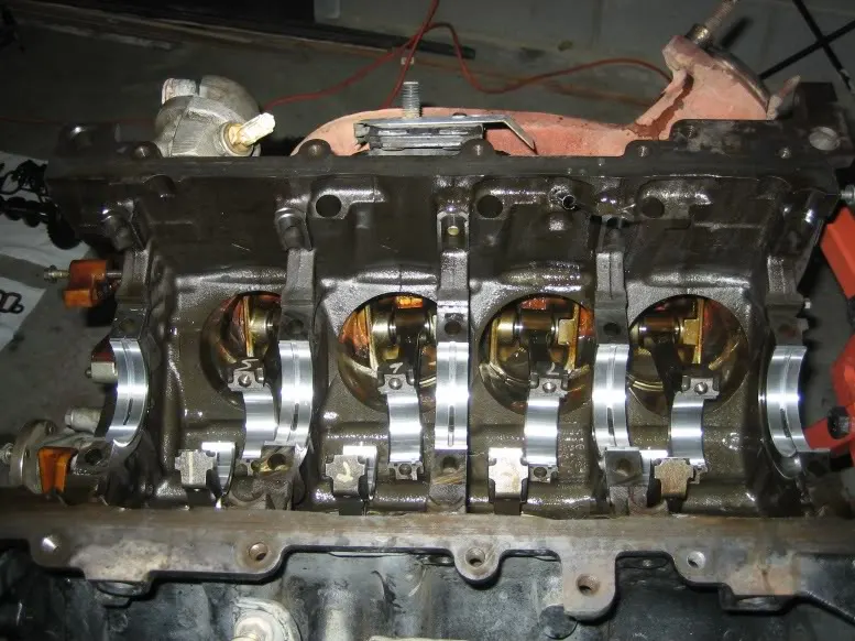

New bearings...

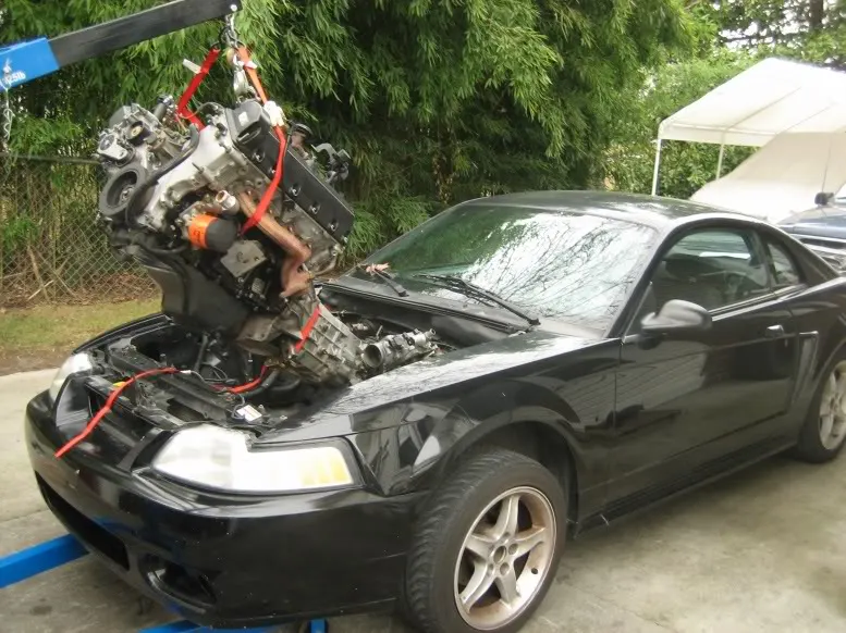

Got it all together, fired it up found it knocking above 2000rpm. Thinking something was for sure wrong with the bearings again, I pulled the engine the next day. Only took me 2 hours to pull the engine the second time though and 4 hours to get it back in.

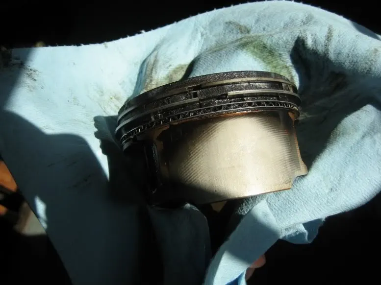

Took the engine apart, found nothing wrong with the bearings. Found one one of the cams a tooth retarded though. Not sure how that happened. I tripple checked it all. I think it may have jumped before the tensioner got filled with oil. So the noise was PTV. Then I was doing leak down tests to see if the valves were ok. All the valves were fine but but one piston had really bad blowby.
Did a compressions check and all had 180s, this one was 90. That explained the vibration it had when you floored it at low rpm. It was like that when I bought it.
Got a new piston and rings, got it back together, and the engine sounded great exept it would run and idle like crap time to time. My sensor VREF voltages were going crazy. I spent the whole next day tracing wiring trying to figure out what was going on. Finally, I took out the ECM and the connector to the ECM(inside the car) was filled with water. No idea how it got there. Also found a Diablo Delta chip :mad: I'm sure whatever tune they had on it was responsible for the broken piston. It would ping before. Yanked the chip out and it runs perfect. Going to be the first thing I'll check on the next used car I get.
