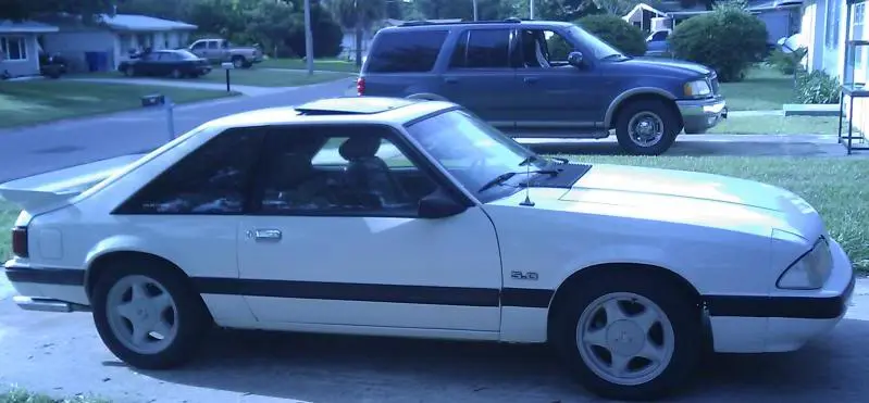

theres already a pic of it in the thread of oblivion, but heres two more of my new hatch. Just picked it up yesterday. I bought it from a friend down the street that is moving to Oklahoma and cant take it with him. He got it about 6mo ago and I have been helping him iron out all the bugs in it so I am already pretty familiar with its quirks. Right now it has a surging idle that I am working on. Now that its mine and can do as I please with it I am sure that I will have it all ironed out by this weekend. Anyway here's a couple of crappy cell phone pics.
87. its all stock except for some mickey mouse CAI. I am going to try and find a stock airbox to put on it. not sure if I am going to keep it so I want to make sure everything is original or as close to original as possible.
those are leaves in the second picture above the blue oval, not rust
tear in the front driver seat, gotta really clean it to see whats underneath all the dirt. Ill post more pics when I get it cleaned up. it may come out nice, it may not. we'll see. if not I have an entire garage full of fox parts I can throw at this thing
