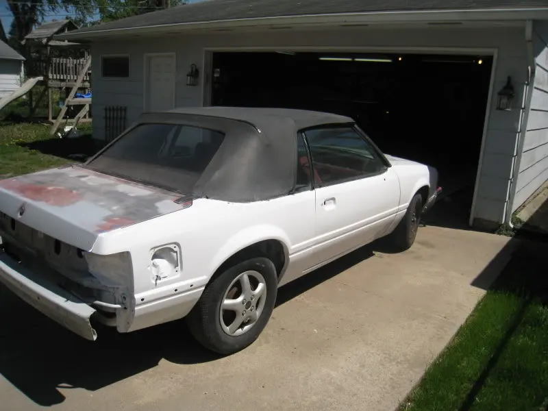

Anyway three weeks ago I Was at a friend's son's 1St b-day party and they forgot their camera so I ran home to grab ours. On the way home I noticed the 88 LX drop top that has sat at the Barber shop up the street had a for sale sign in it. Took a peek and saw the price and knew I had to have it. Told the wife and she was all about it. Drove back by on the way home and bought the stupid thing. I was thinking of a nice quick flip, But Kim loves it and claimed it. Sigh.
Car was from FL when it was new, moved up here and was stored winters. it is so clean underneath. Has a crap-o paint job on it, newer top, and a 2.3/A4ld combo.
Trans leaks (front pump)but it still moves fine. 98K on it, and got it for the pittance of $300 [Smile] Guy also gave me an extra mint nose with lights, a T5, pedal assy, shifter plate,drive shaft and a bunch of other stuff he got for it over the years.

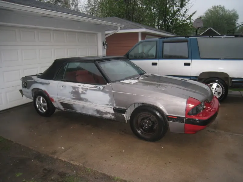

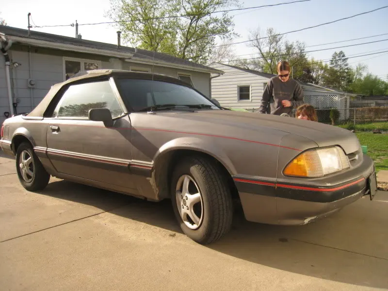

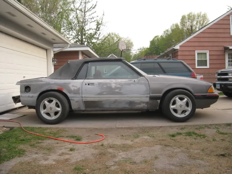

as it looked when I got it home
My daughter Jillian and Wife Kim playing with trying to Buff it
paint removal

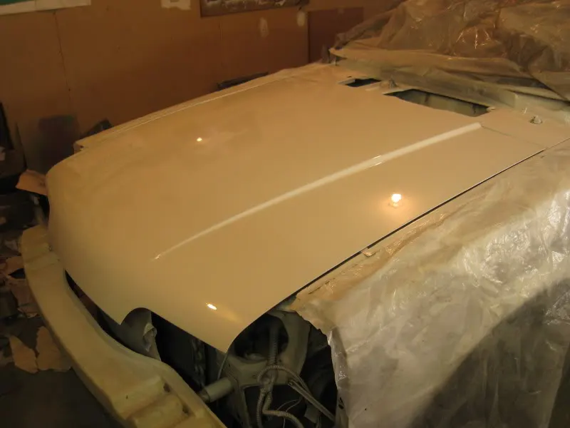

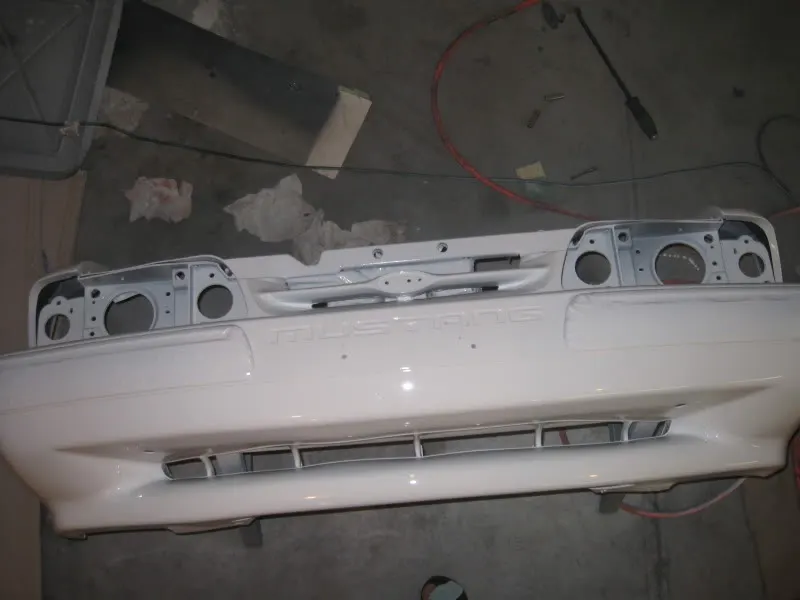

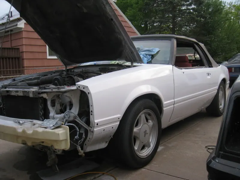

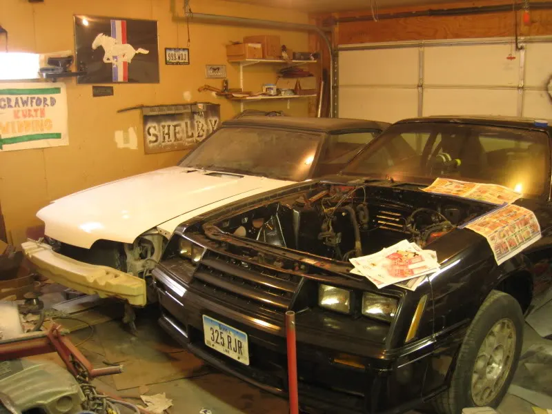

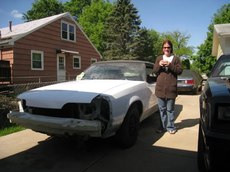

The third night we had it Kim was blocking and feathering it, and here I have the fenders fit up and new nose set on it

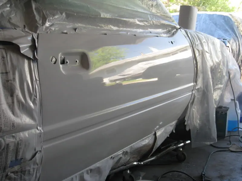

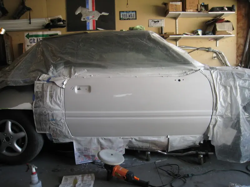

Shot the door as a test panel Saturday to make sure Kim liked the color.

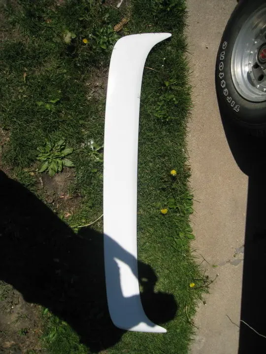

And the feature car style wing for it

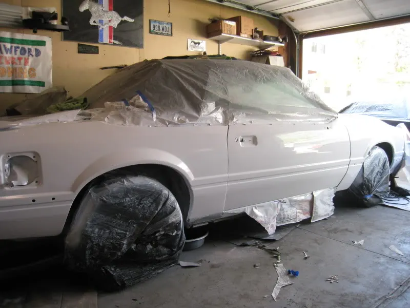

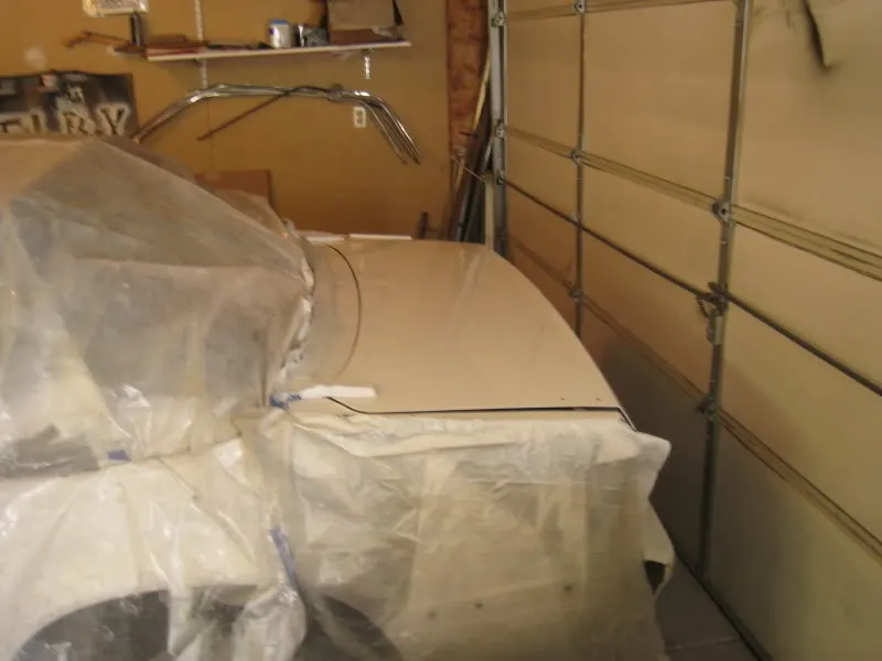

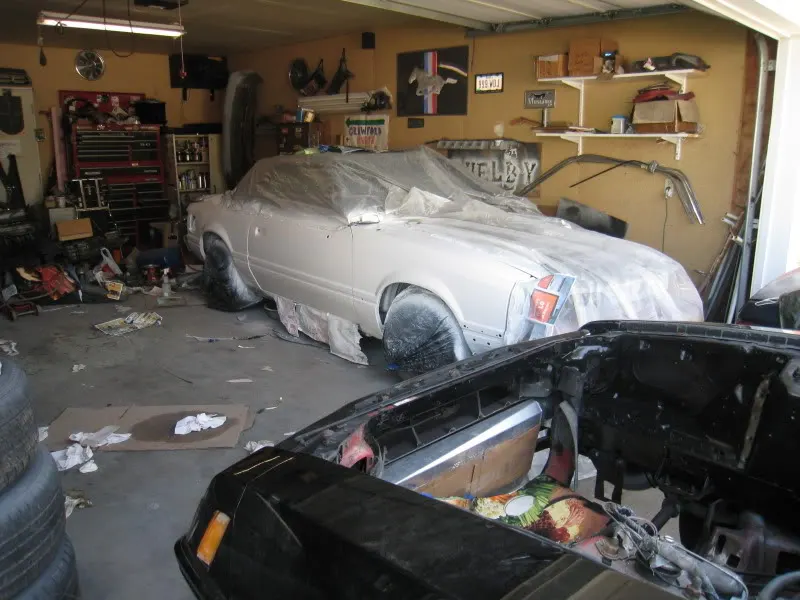

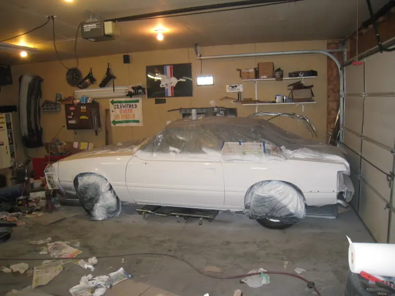

Tonight I shot the passenger fender& 1/4, tomorrow I will turn it around an start shooting the driver's side. ( god I love shooting solid colors that can be panel painted and match) Have to panel paint it as I have to run the cobra in every night when I get done. More pics to follow tomorrow!

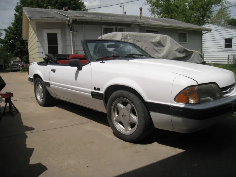

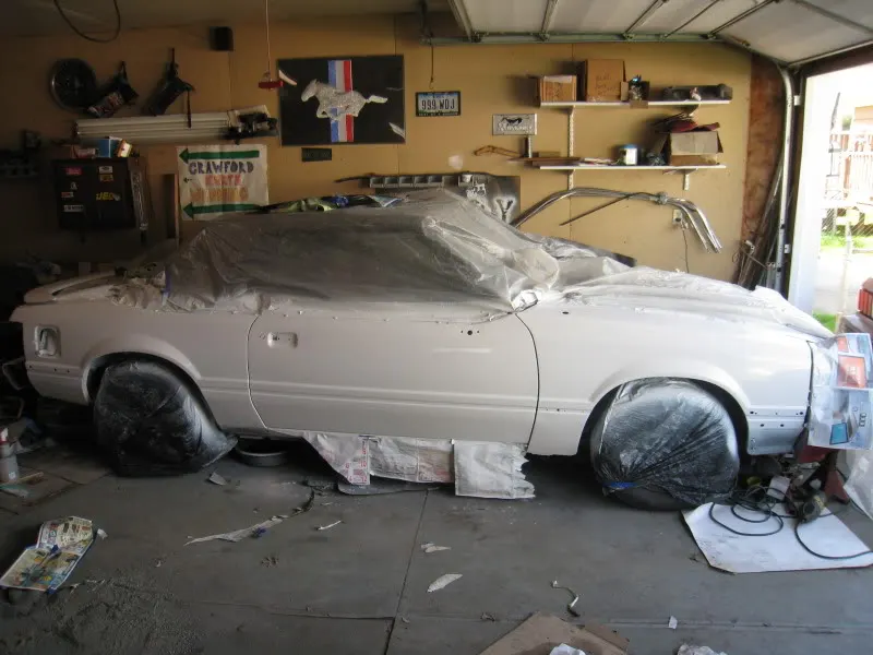

here is how the vert sits, the door moldings are currently laying flat to get a couple little hiccups out of them

How did you take the side door moldings off and what are you doing to repair them??
Slight heat with the heat gun and a plastic trim remover chisel.
They had been off the car before and the metal piece was a bit rippled. have them under some 2x4's with weight on top of them to get them to lay flat.
