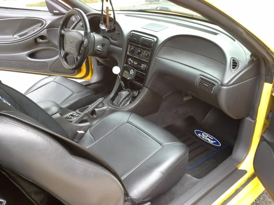

Thanks first off. Secondly the shift know fit the stock threads and snugs tightly. And it feels great as it did in my 06 Stang. Yeah I ws glad to get rid of those boy toy tail lights and headlights. I prefer function over looks. And even saying that, those were ugly to start with. And yes thry did go into the trash.

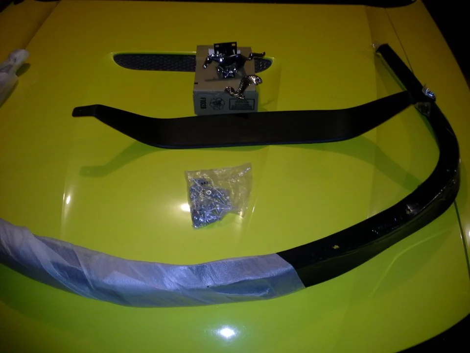

Well got some new parts in tonite. Looks like I will be busy in the morning. Got the Mach 1 grille delete and chin spoiler in from AM. Just in time for next weekends mustang run here on the island. Still waiting on my windshield lettering to come in that will say GRUMPY in yellow 5" lettering.
I was shocked to see the chin spoiler come with bolts/nuts/washers instead of plastic push pins. I even went out today to Home Depot and purchased a 20 set of bolts/nuts/washers thinking it would not come with them.

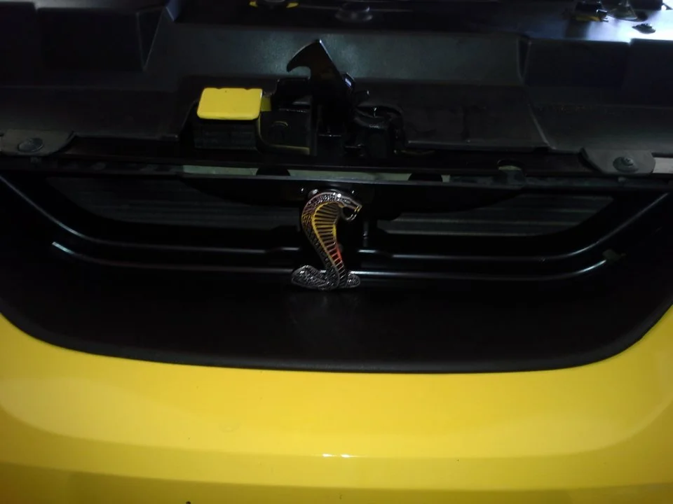

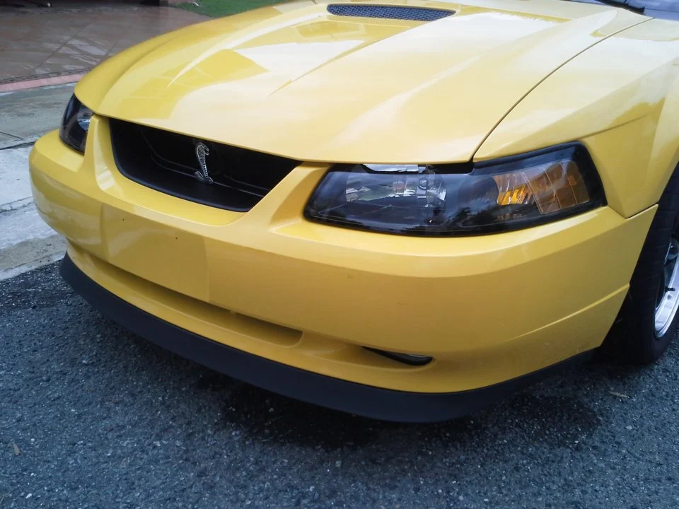

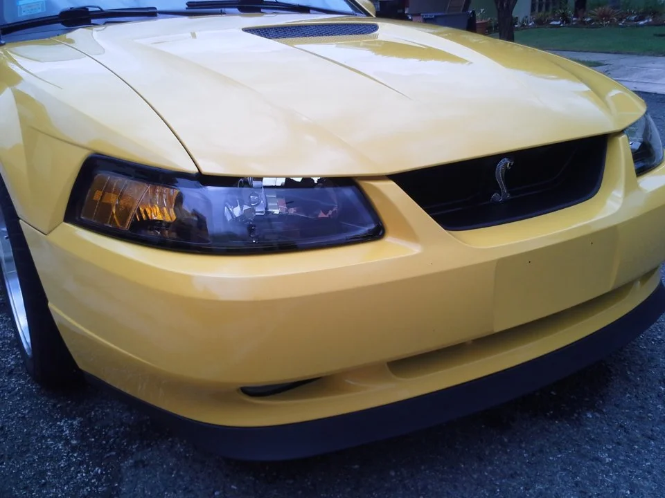

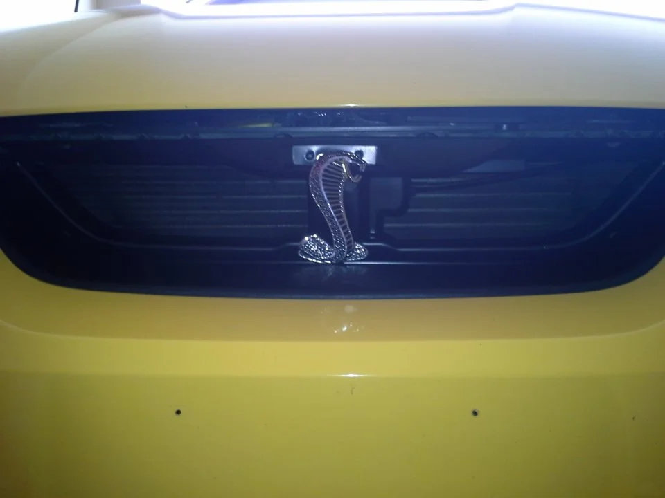

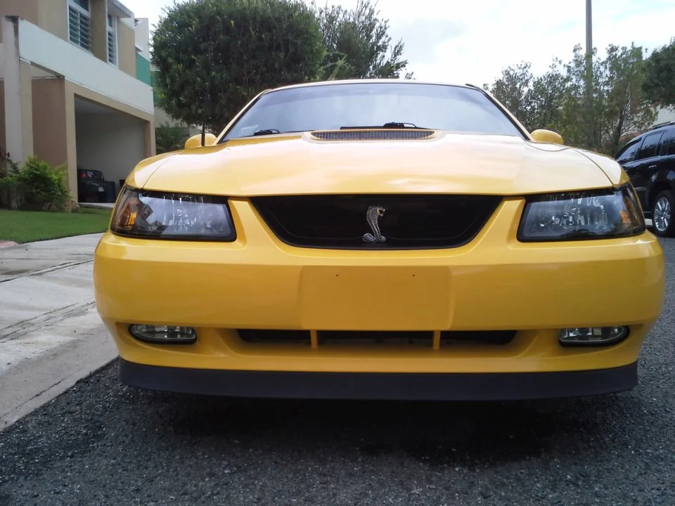

Well I got the chin spoiler on, and the mach 1 grille delete on with the Snake in the center.
The chin spoiler went on pretty quickly and no problems with alignment. I just marked center of bumper, ad then that point around on each side and then drilled my holes. It came out perfect for being the first try.

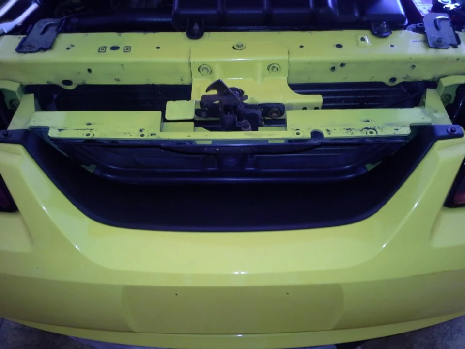

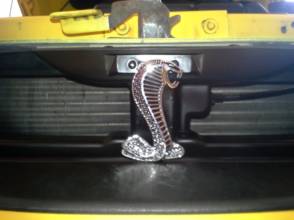

The grille delete was a different story. The original grille had 4 screws that faced upside down and were a PITA to get to, especially with my fat fingers. Then the grille came out and I installed the grille blank for fitment first. What I found out while I first fit placed it to make sure there were no fitment issues I found that there were some design flaws.

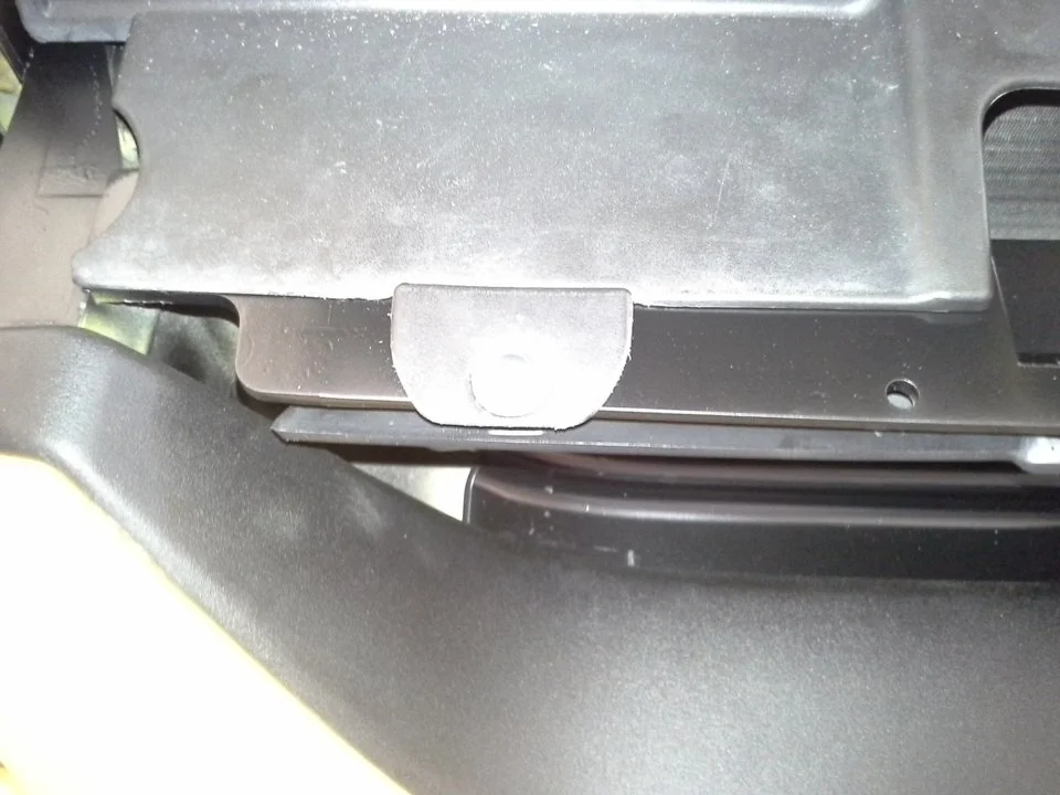

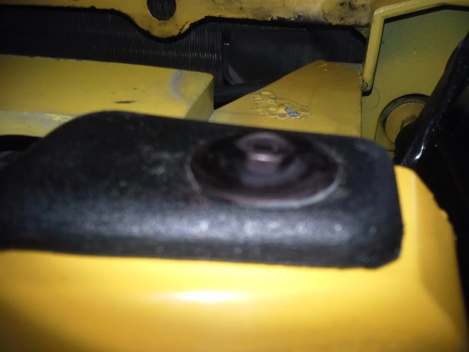

First flaw I saw that did not look right to me was after you installed the flat base, and then the radiator support cover went on after that. Once I placed the support cover on, I noticed that the tabs that have the front two screw tabs over hung the grille delete by at least 3/4", which looked stupid ugly. Also, the push pins that secure the grille delete in place were too short to allow the plastic screw to go down all the way, the grille delete was too thick. Then there is the body color that is under the radiator support that is exposed once all is in place.

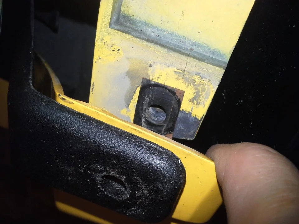

So, to fix the support screw issue, I used 2 of the original grilles slider nuts and slide them on the core support tab, then used the 2 screws of the grille to fasten the whole assembly down. That thing is not moving now. Way stronger than the original setup.
Then there was the core support yellow paint showing through and made the install look ugly. I taped off the area above the grille delete and where the plastic core support cover goes, and painted it all black so everything blended instead of the yellow standing out inbetween the core support plastic cover and the grille delete.

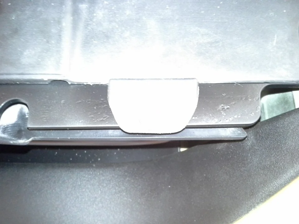

Then there was the core support plastic cover that had the forward two tabs that overhung the grille opening where the old grille would of been. Which made for a eye sore of sorts. So I trimmed about 1/2-3/4" off the tabs and rounded them and smoothed it to look like it was like that from factory and then I used the push pins to secure it.

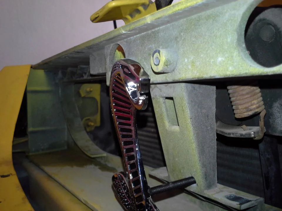

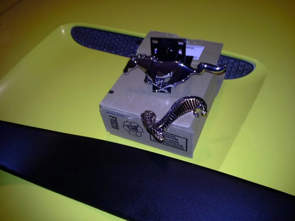

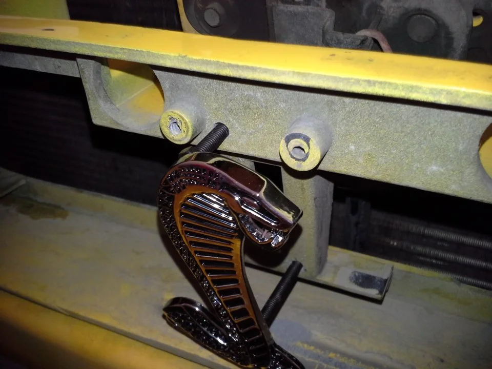

Then the horse emblem and mount that came with the kit I put aside for a snake. I fabricated 2 screws that I cut the head off, then tapped 2 seperate holes in the back of the snake at top and bottom, drilled two holes into the center piece of the core support and pushed the upper and lower screw through each hole and then installed a nut on the inside, then a lock washer and nut on the backside so to tighten against the front nut. Came out like it was supposed to be that way from factory I think.No other way I could think of to mount it since it is not an OEM snake for the cobra front, but a larger 5" snake.
Then there is the finished front grille. I did more fabrication then I ever imagined to make this look halfway sharp. It actually with the hood down, and the blacked out painting I did, made the whole thing look awesome.

Looking good! I bought the same Mach 1 chin spoiler and grille delete kits from AM too. The chin spoiler went right on like yours but I didn't have any issues with the grille delete at all. The mounting screws were a pain though, I do remember that. Just keep an eye on the grille delete black insert. Mine started to fade in spots soon after I installed it. Not sure why. It's garage kept.

The chin spoiler did not give me problems, just design flaws that I had to address like the radiator support front tabs overhanging too far forward, and the 2 plastic screws and sleeves that were not lng enough to go down far enough to secure the 2 top mounting points for the grille delete. But the way I fixed it made it 100 times stronger and secure than if I were able to use the plastic screws.

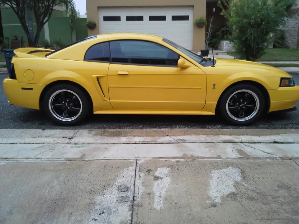

Don't take this the wrong way, but IMHO putting cobra snakes and svt emblems on a GT isn't really cool. It's kinda like false advertising. I do however think that where the car was vs where you have it today is pretty impressive. It went from ricer back to mustang... Now Fobra? I could understand swapping to cobra bumpers / rockers, so long as the 'cobra' was smoothed on the rear bumper... But hey, to each their own. Beauty is in the eye of the beholder.
Never thought of doing what? I am going to take the Cobras off. I do agree that it is a Fobra wantabe. I have a new set of GT badges coming in for the front fenders. I was not trying to be something it was not, just a different look vs the boring running horse and the god ugly 35th anniversary badges. But found OEM new GT badges that I think will look good.

isn't your car a gt? why advertise it as a cobra? it doesn't even have any cobra body panels..
It is a 35th anniversary edition and I totally disliked the badging, so I put on snakes as I like those better than what was on there. But, a couple of weeks ago I received my running pony for the grille delete and I installed GT badging on the front fenders and rear truck. Now it is back to a GT look without all that 35th crap.
