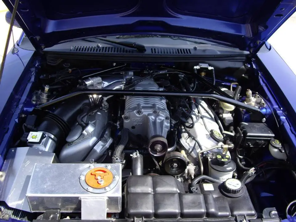

No, I said what I ment. And my engine bay is in a building process. New coolant tank on order, new CC plates about to go in. New coil covers about to be ordered and soon to have a Whipple sitting on top and all sonic blue billetflow pullies :nice:
Get some real mods and stop being cheap.
Whipple or go home lol
"Coolant Tank Looks Go and Goves me 10HP"
...Yeah right
