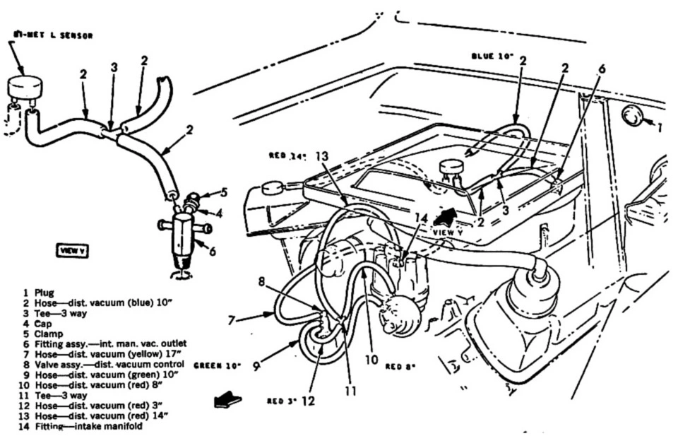

Hey guys I need help... Can someone tell me exactly where the Vacuum hose for the Shaker Door Motor is supposed to be connected. I have tried several different locations and even purchased a CD of Vacuum and Wiring for the 70 Mustang but it isn't in the CD. Does someone know where it is SUPPOSED to connect. 70 Mach 1 351C 4V "M"Code. Thanks

Too easy…
Blue hose (#2) that seemingly terminates nowhere at the right rear corner of the shaker is the shaker servo motor connection.
