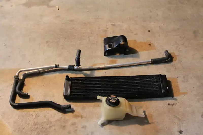

Ive already bought the first of it though. I found this on a local forum and ended up getting it all for $80. Stock Cobra heat exchanger, intercooler resevoir, and Auto Meter steering column gauge pod.

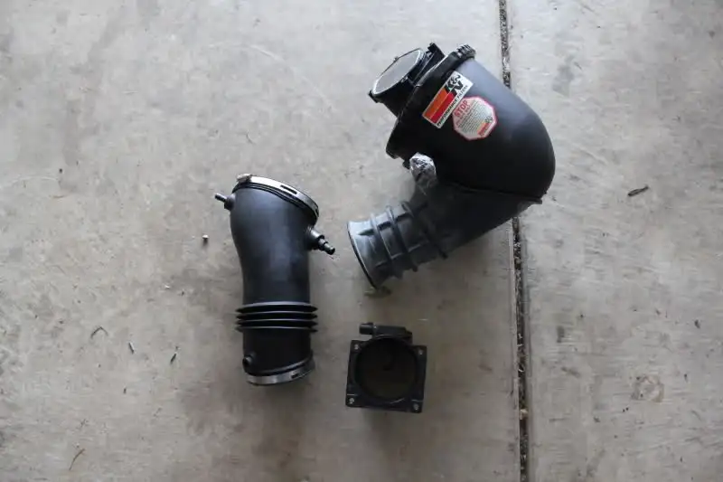

My Lightning MAF arrived today. I got the oem Cobra intake for $25 shipped, and the maf for $50 shipped. I ended up buying a pair of oem Cobra fog lights for $10 locally. Sold them for $60 shipped, so basically the lmaf was free. :D
