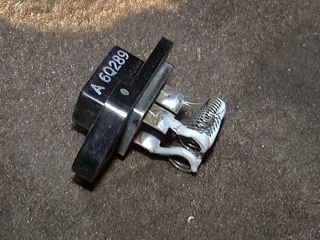

According to ford, it's considered a blower motor resister block. It controls the speeds to the fan according to what position you have the switch set at.
If yours only works on high, Then it's stuck in an open circuit. The blower can still work on the switch's highest speed because it bypasses the resistor block completely in that mode.
You should be able to get one at the dealer for less then $20. here's a link to one online. Resister Pack
It should look similar to this one:

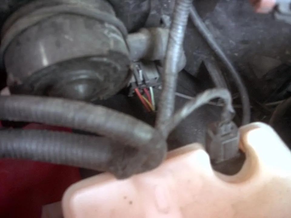

Here is a pic of where it's located in a Ranger. It's the plug in the middle of the pic, right under the blower motor.
