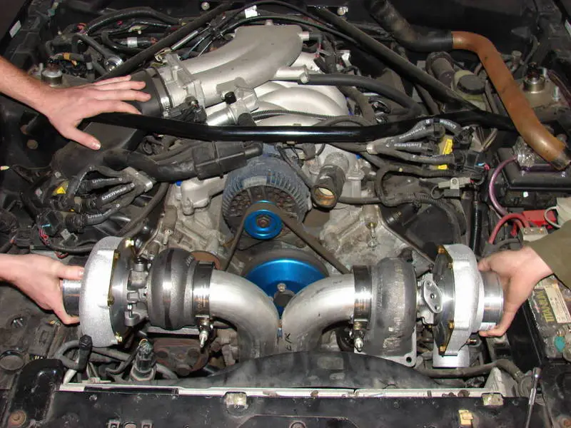

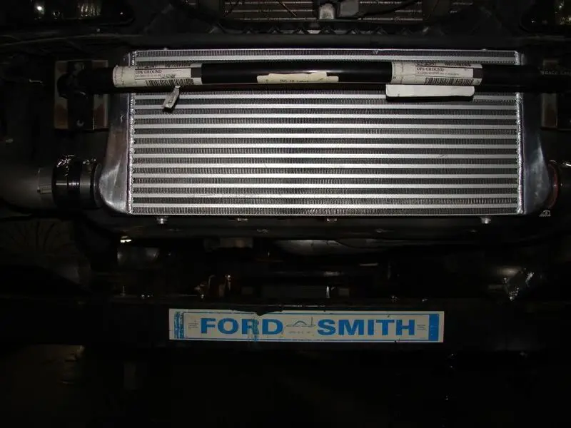

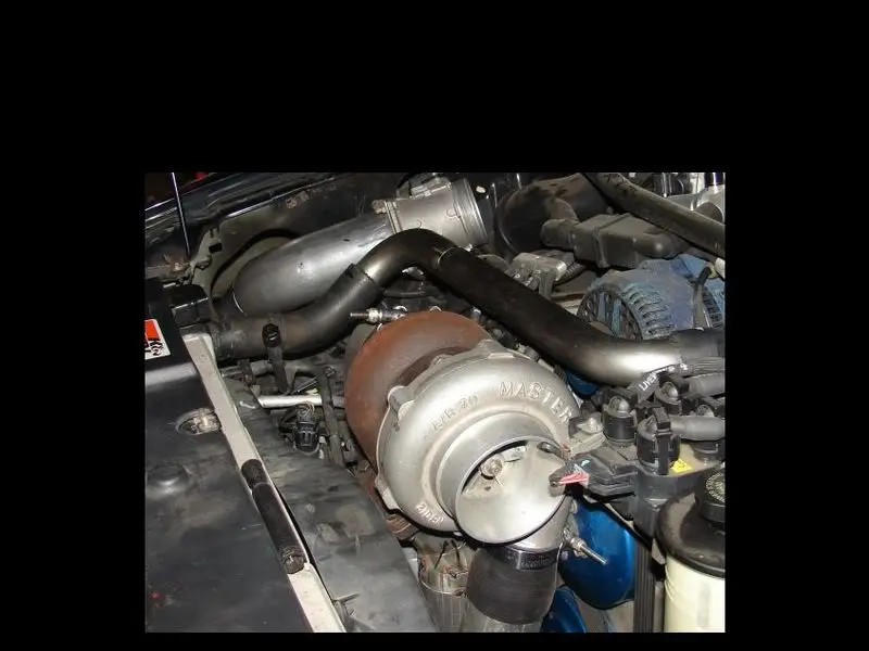

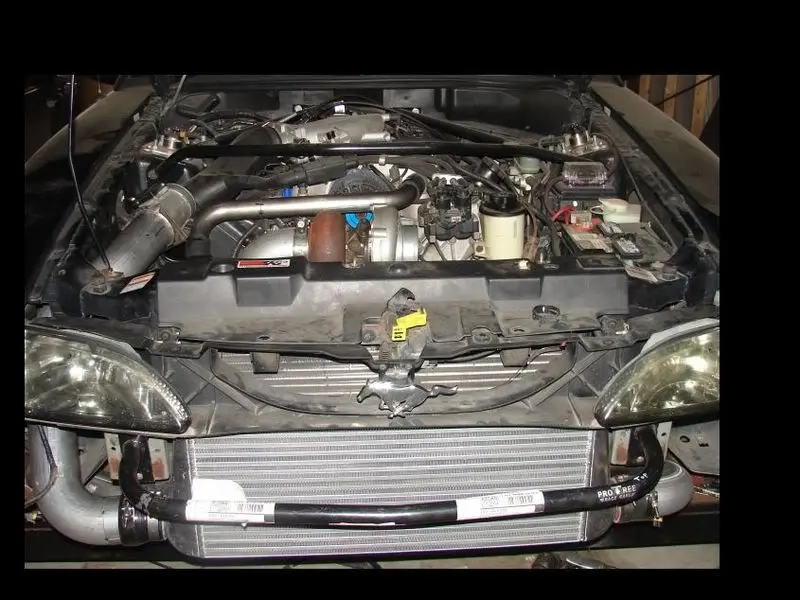

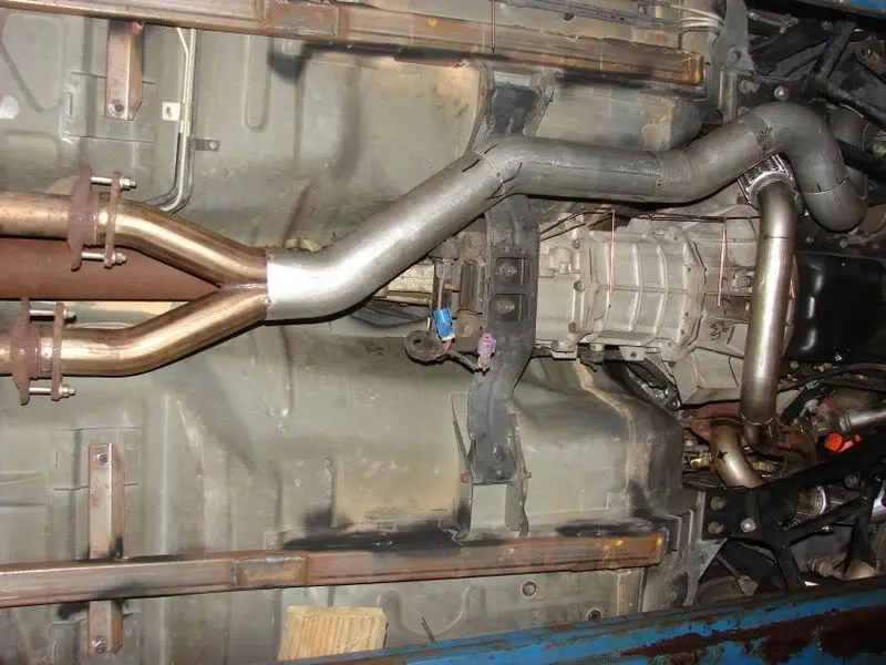

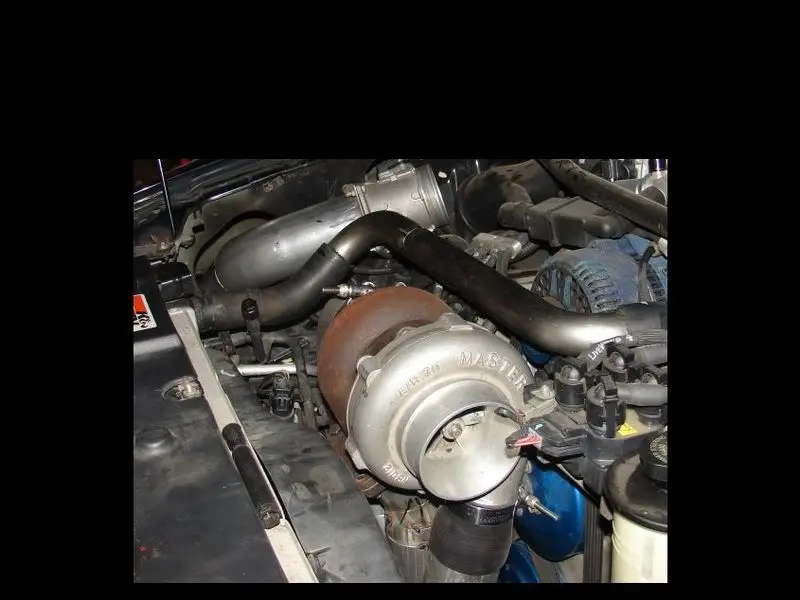

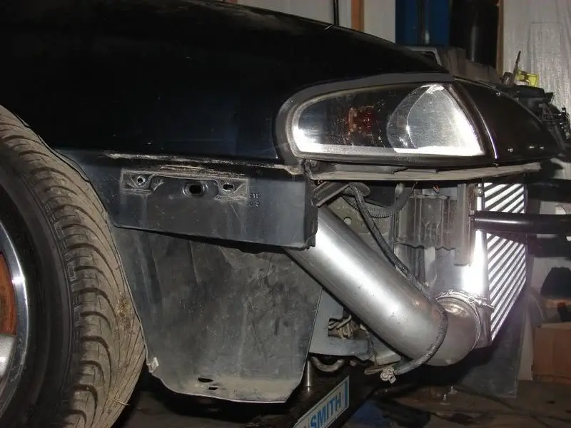

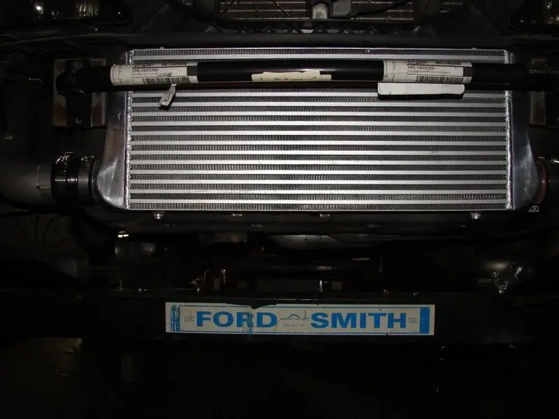

Though I would share pics of the turbo build on my ride

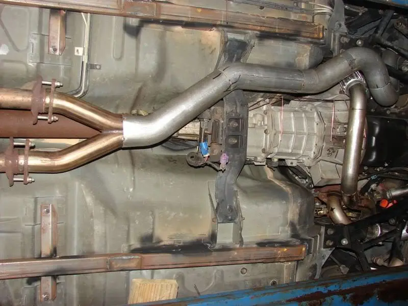

Stock bottom end with SVO heads, intake and PI cams. I am sure I can break all the stock parts without going to a bigger turbo but will probably limit it to around 425ish and 6-8#. I am hoping that it can be finished before I get out of the desert.

Nice :nice: you need a big electric cut out right on that 4inch down pipe
I have really been thinking about a cutout maybe not electric, since I have heard the butterfly has had a habit of not shutting all the way after a little while.
The turbo in the pic is a MP T70, it is there for mock up, I can run from that up to a pt78 if I choose
I think I will actually like not having full boost really low in the tach, I won't have to worry about the tires hooking as much. Besides I figure I will see full boost by 3k in the tach so I will be doing better than some of the centri guys
