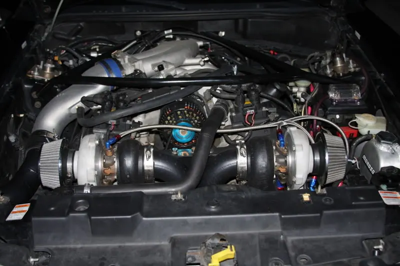

My turbo build

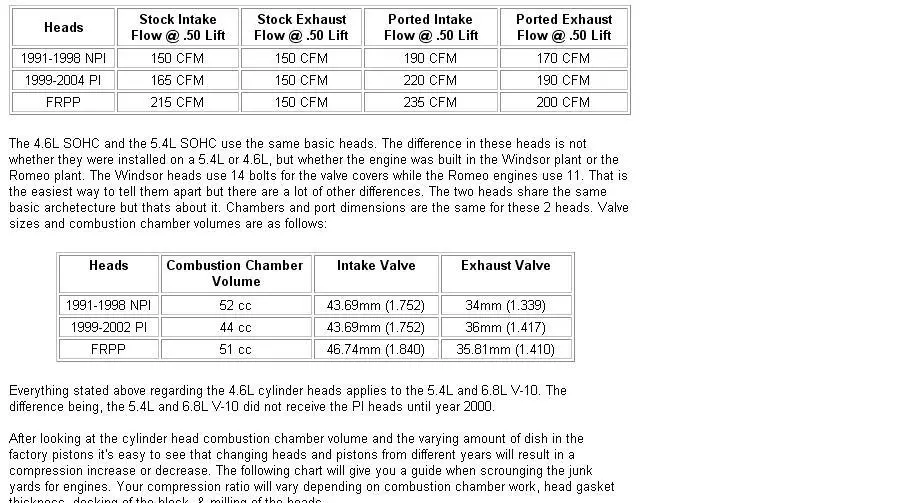

SVO heads rock, and ported SVO heads are drool worthy
Most newbs dont even know what they are. They came out in the 90's, ok. They are still the best 2v head available........... So call them archaic if you want.
love it, considering I was the second on this board to ever run a PI headswap, and the first around to run 2v regrinds in a mod motor! Take your newb comment and .......
You girls need to not let your panties get wedged up there, it was nothing derogatory. Just saying they are not common like they were in the late 90's. Archaic doesnt mean bad, if anything, I was intending it to be a comment that was positive though I can see how I didnt explain myself. They use to run over 1500 bucks a set, and it was hard to get a set used since not many people bought them. Good luck on the build.
