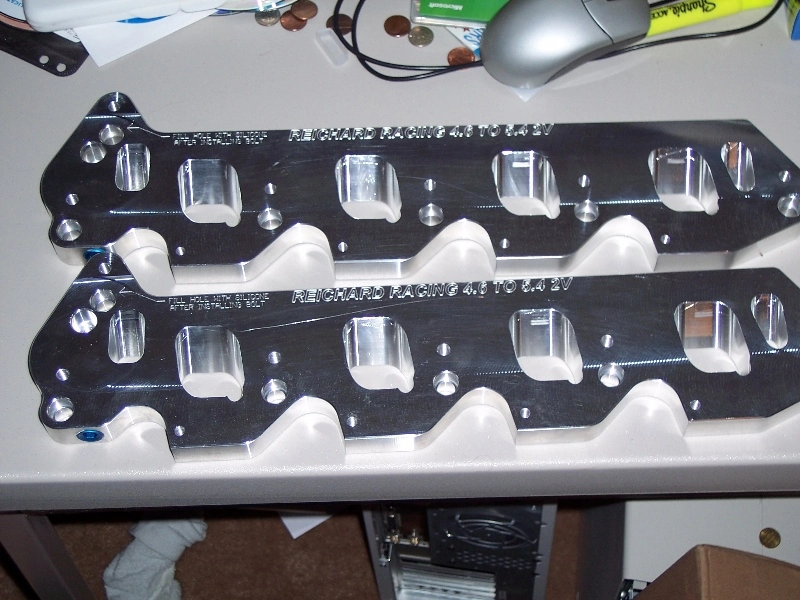

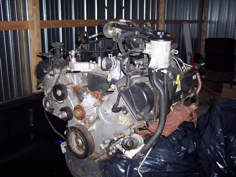

Here's what we have so far.
Nice. I think you guys can pull it off in one weekend. I did a 4.6 swap in a 97 GT a few years back. Pulled the old, seized one out, dropped the new one in, and had it on the road in about 12 hours.

I have that engine... in an F150.
260 hp, 330 trq. Should give quite a kick in the butt from 2K to 4k. Runs out of juice around 5k.

why do you need the intake spacers again? i used to know the reason when i had my 1996 and was contemplating the 5.4 swap ...

5.4 block is diff. so the intakes need an adaptor...kinda like the 351 and 302 intakes deal. The 5.4 should have PI heads and with the mustang intake they are supposed to really wake up over the truck intake.

Yeah, it's a SOHC. The 5.4 DOHC was too much $$$. If you're doing a 5.4 swap DOHC is the way to go, but it'll cost you about twice what a SOHC runs. I believe it was around $1500 for the complete 5.4 SOHC with ~15k on it.
The intake spacers allow you to run a 4.6 intake on the 5.4. With a little notching, it'll fit under a stock hood. :)
