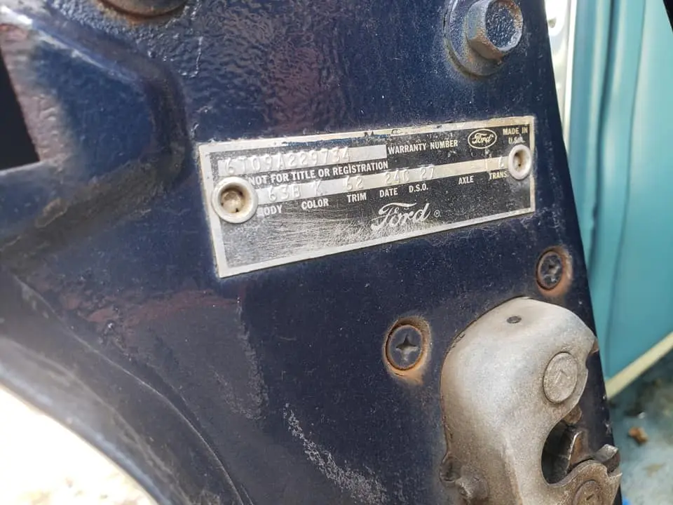

I have a Question, a guy over in my area is selling a 66. He has a photo of his vin and I cannot decode the D.S.O it is “27”. Any ideas? I will try to post a photo Thank you in advance! Ross

Yeah in all that I have looked up, none of them show a 27 at all. Clearly on that tag it is in the right location to lead you to believe that it is a DSO Code.

I'm still getting Cincinatti for DSO27 for 1966 from 1/1/66 through part of ' 68
First half 66 year there is no 27 DSO
Last half of 1966 production, I think the date code 24C puts you in the right spot for this.
From website 'The Care and Feeding of Ponies'
24C is Mar 24 so definitely after Cincinnati DSO was changed from 31 to 27.
Five other DSOs changed sometime between the begining and end of the 1966 model year...
Buffalo: 12 --> 37
Louisville: 36 --> 28
Philadelphia: 23 --> 16
Pittsburgh: 14 --> 38
Washington: 26 -->17

Hello, i have a 66 gt k code automatic, yes auto, now this is where the fun starts, DSO is 84
Vin 6F07K317223
65B R 68 18D 84 5 6
BODY Color TRIM DATE D.S.O. AXLE TRANS
Anybody have ideas on why the dso 84
Quickie on-the-fly answer without research: If I remember correctly; the "Home Office Reserve" DSO (84?) was for company use and "employee leases". For example: Engineering test mules, "World's Fair" display Mustangs, Iaccoca's and Henry Ford II's cars, etc.
Was probable a give away to some sales office for winning there region sales goals.
