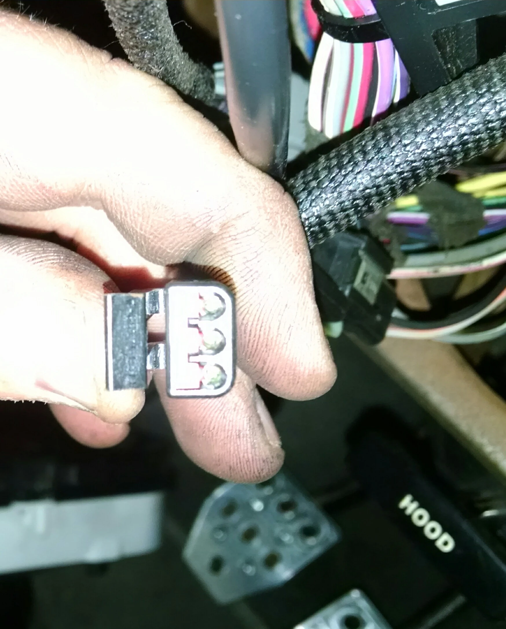

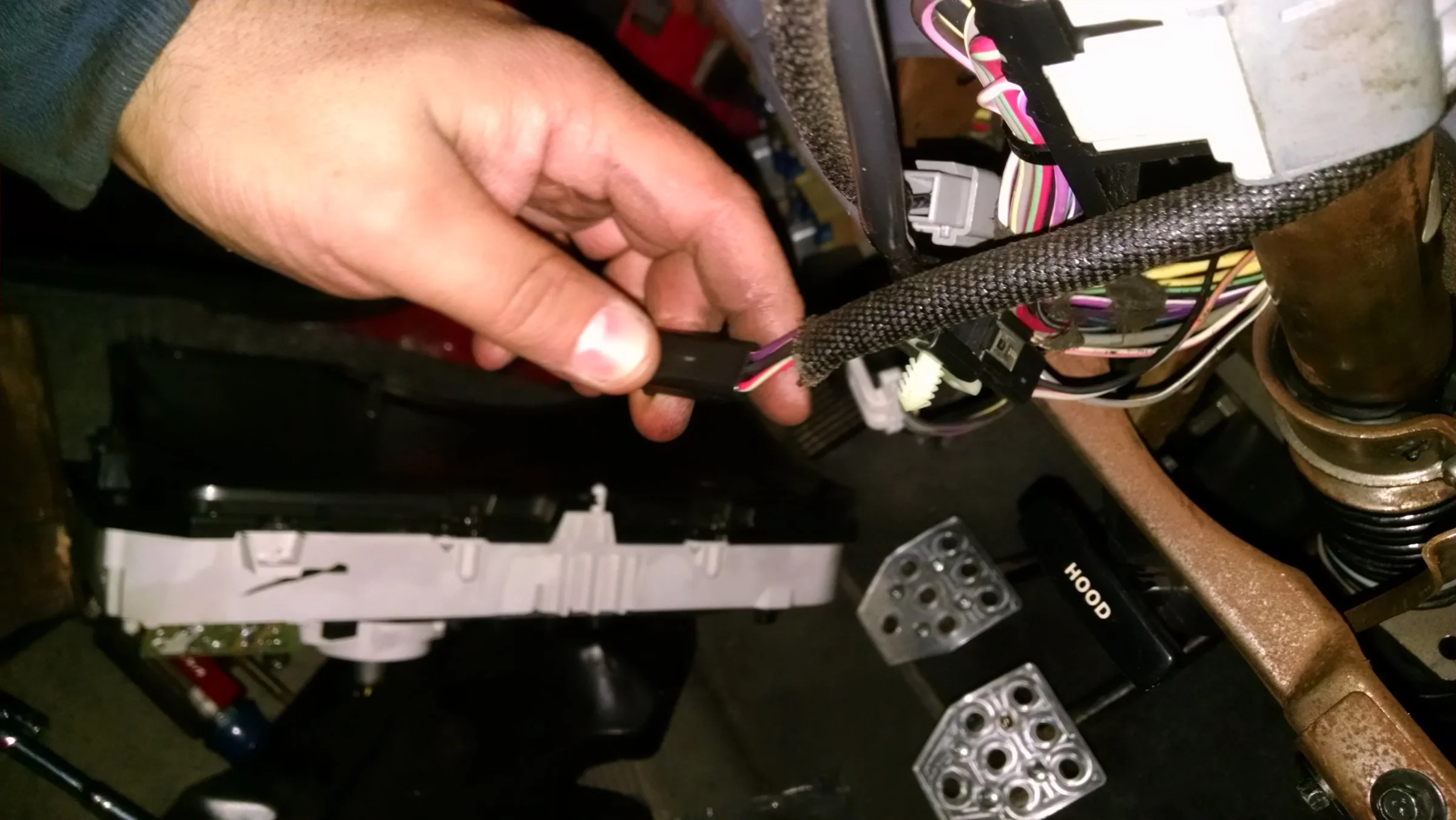

So I'm in the middle of a 93 four banger conversion and during the peddle swap I yanked the steering column out. Once I went to button everything back up this wire had no home to return to. I looked on my 88 and it's not present on that car. I don't recall ever seeing this wire on any of my previous foxes as well.
The wire comes directly off of the dash harness that runs along the bottom of the cluster area by the column. Nothing missing off the multi switch or ignition switch area

Yeah a 89 main harness would not connect up right to a 93 dash/body harness. The car is a 93 coupe auto and I have a 93 main harness and o2 sensor harness i'll be using but haven't got that far yet. I just finished the engine bay, front suspension, peddles, throttle and clutch cables etc.

Clockspring connector? Also i know there is a harness for the verts that was unused in anything other than the vert...
Nah clock spring connector is all good. Yeah i've heard of this harness that wasn't used as well but no one knows what it looks like. This may be that none used harness though
The colors of the wire are Purple/Orange, Red/Green, and Black
