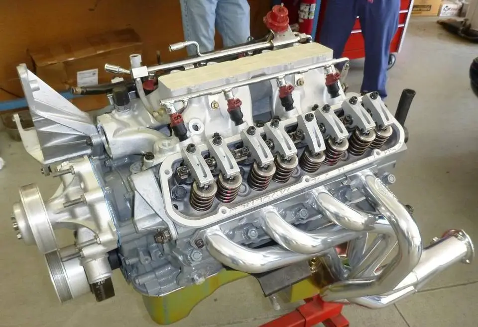

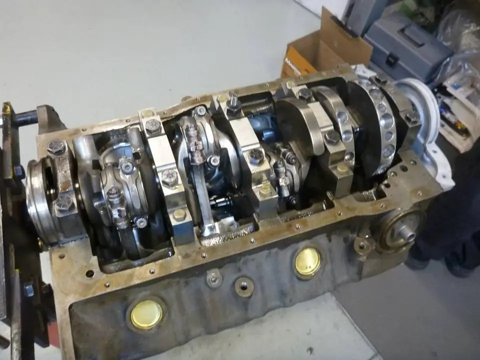

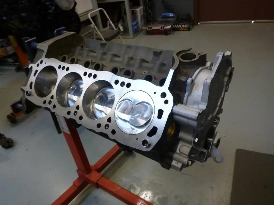

I do have a GoPro, once I get my Mark Williams driveshaft (current FoMoCo is warped), 4.56's installed (soon) and get new rubber (budget pending) for my strip wheels I'll oblige.
Until then I'll be walking it out of the hole on dr's.
When I was running the totally stock motor, 5500-6000 was part of the drill in my quest for 12's.
R block, scat super light crank and rods, srs pistons (all received attention by the builder)... rings and bearings I do not recall, tolerances, no idea, engine builder likely has record tho. I remember a fair bit of talk about ring package and possibly needing to run a pump. So far so good. Windage tray, canton pan with oil control... builder says it'll be good for 7500 under load, 8000 free rev/missed shifts will be just fine. Currently have limiter set at 7500, but should be shifting below that.

I got wood looking at that

Nice build, I'm sure the port work is awesome to let the E7s breath like that. The real magic here is running the solid cam, setup properly it adds well over 1000 RPM of good power up top. Even on an otherwise stock motor.
