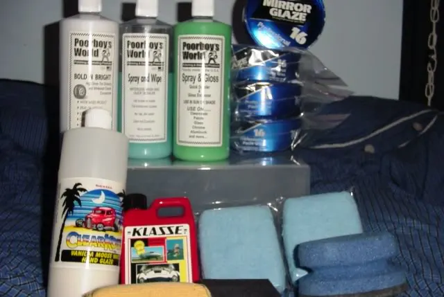

Tell me about it...this hobby has been taking away from my modding hobby and it's adding up real quick.

gt96stanggt said:
Man i wish there was a time in az, besides winter, where i could wash my car and not have it dry befor i can walk over and grab the cloths
There is look at the pic I posted the middle bottle is a quality waterless carwash. Using a soft plush microfiber towel just spray a panel and gently wipe away. I've done it many times when I don't feel like breaking out the bucket and hose.
