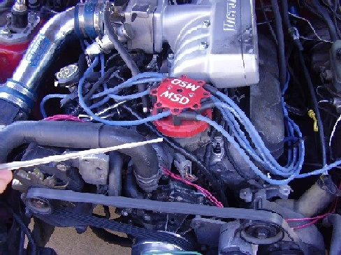

I have a similar problem, there is a small film of that goo forming under my oil fill cap. I've changed the intake gaskets and pulled off the valve covers but can't figure out where its coming from. I no longer have a PCV and all the crankcase gases are ventilated through a small hose (see pic) connected to a filter and the filler neck on the valve cover. Is that normal? I haven't noticed any coolant dissapearing or any in the oil.
